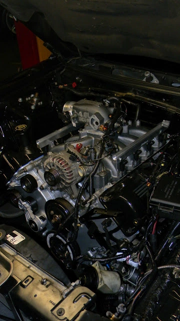

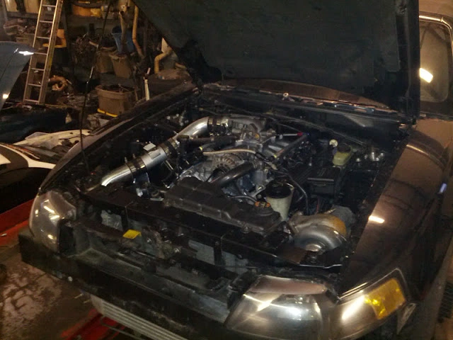

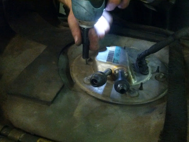

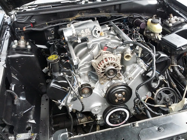

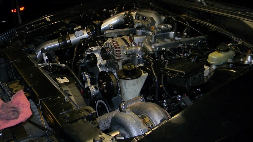

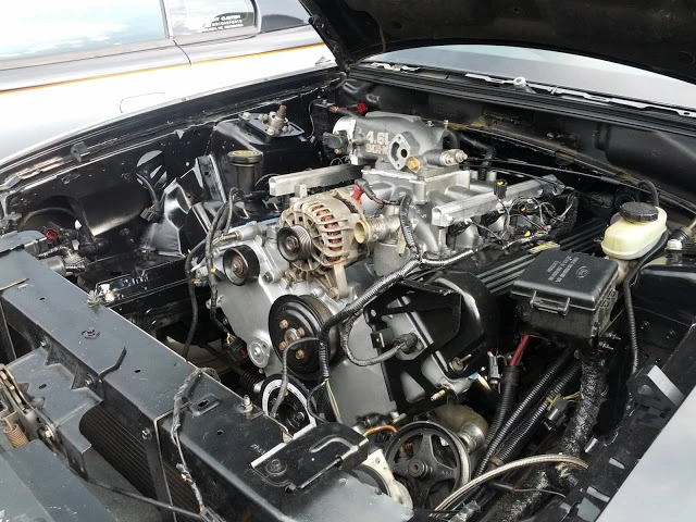

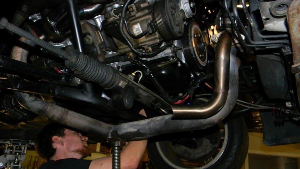

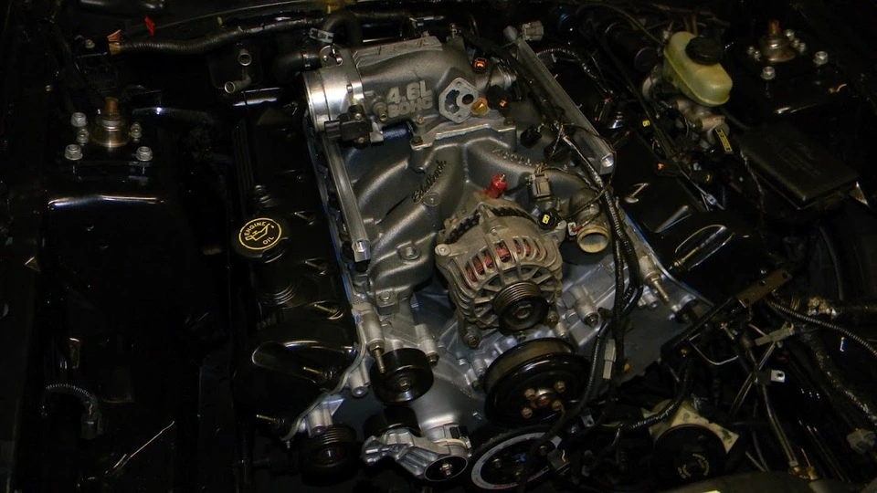

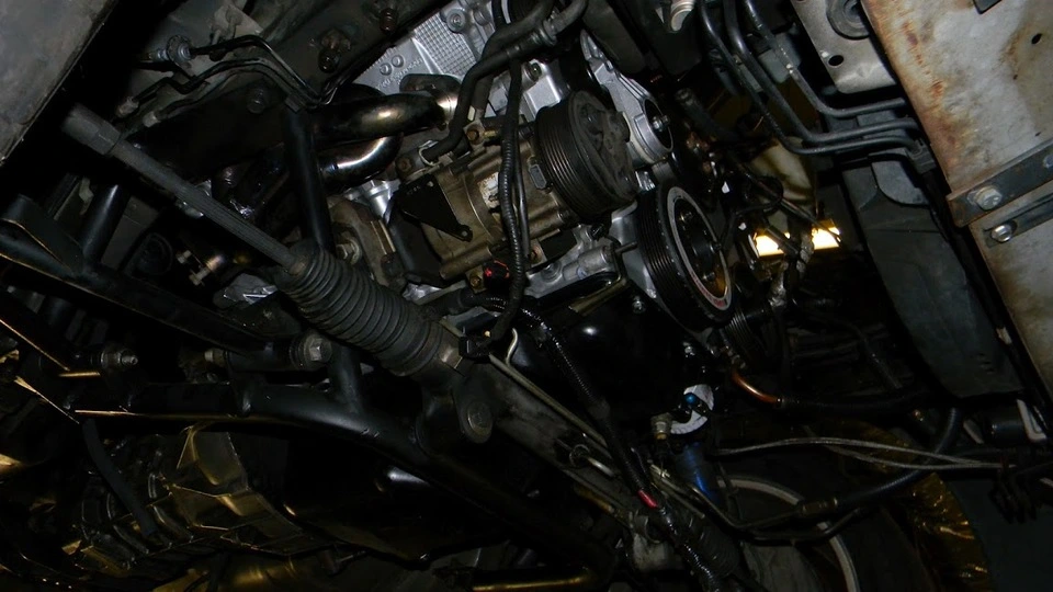

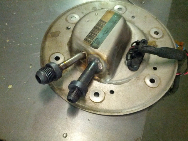

Well kinda had some issues with the engine, one the timing cover did not work out, had to swap that out... Two the engine would not build more than 20psi of oil pressure.. Pulled the timing cover off again and found an oil galley plug missing... After installing the plug all was good:D So intake, alt, power str, and ac compress all installed. Time to do the fuel lines and turbo next!
MORE PICS, so what do u guys think?

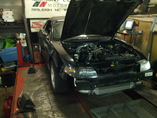

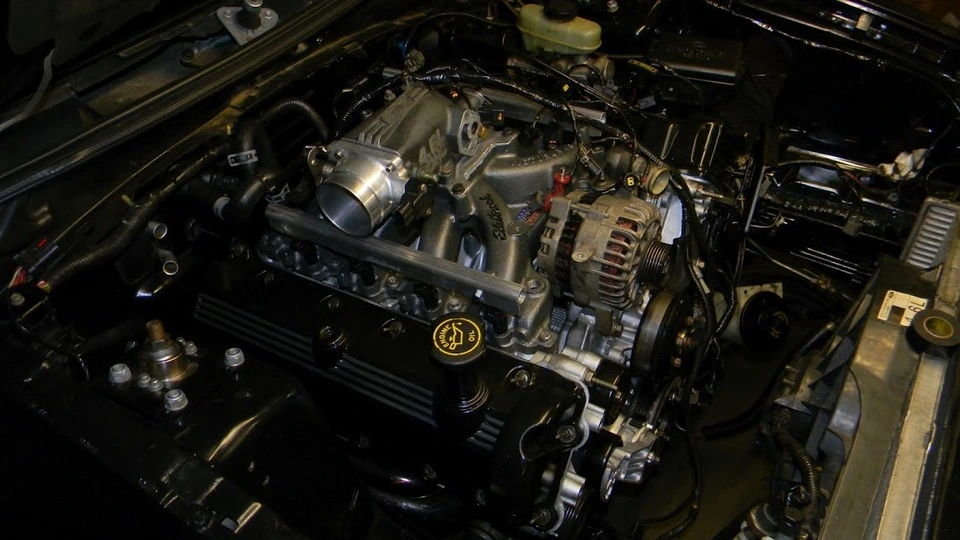

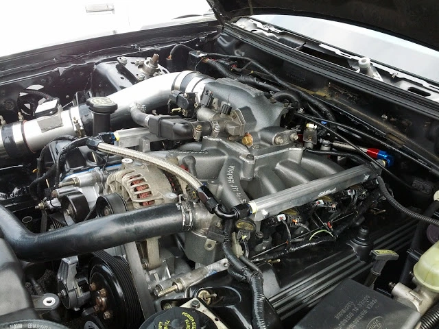

Fired the mustang up, having some issues.. Its miss firing on 4 cylinders, checked the compression and all was well. Checked the coil packs, samething all were good. Right now im thinking its the injectors or the wiring harness. But we will see.

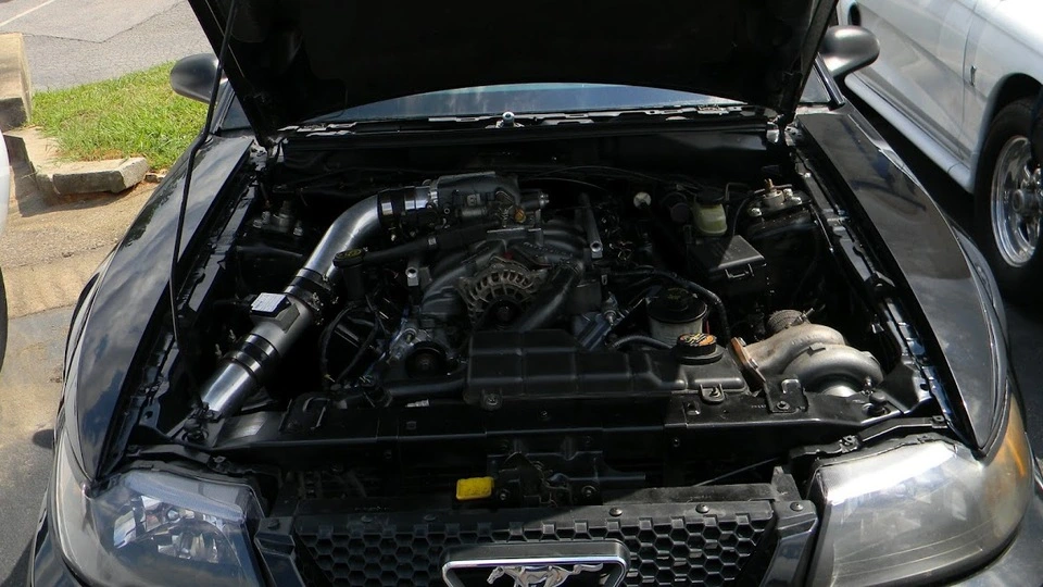

mustang is back on the road, base tune on 13lbs of boost made 460rwhp/521rwtq. about the same as before. After getting some miles on the car, 110 race gas tune w/ 20lbs of boost:D I will take some video later if the weather clears up.
