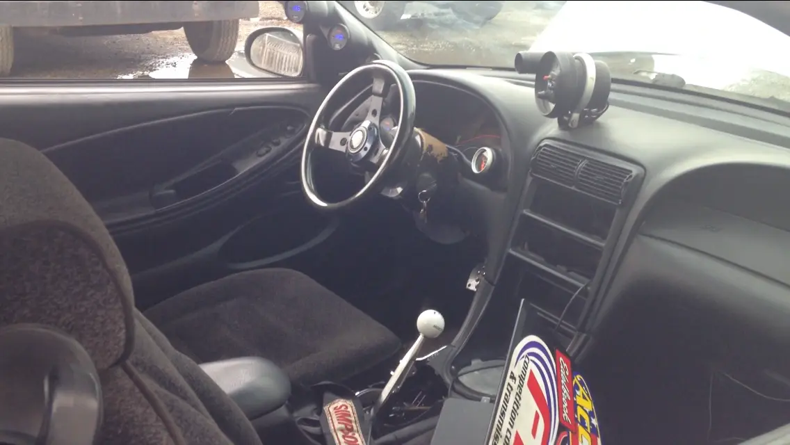

Alright, here we go again
Most of you know I built a 98 car and finished it up, oh i dont know, 2 weeks ago.
Well, here it is now
driveline out, hood gone, sittin on jack stands....

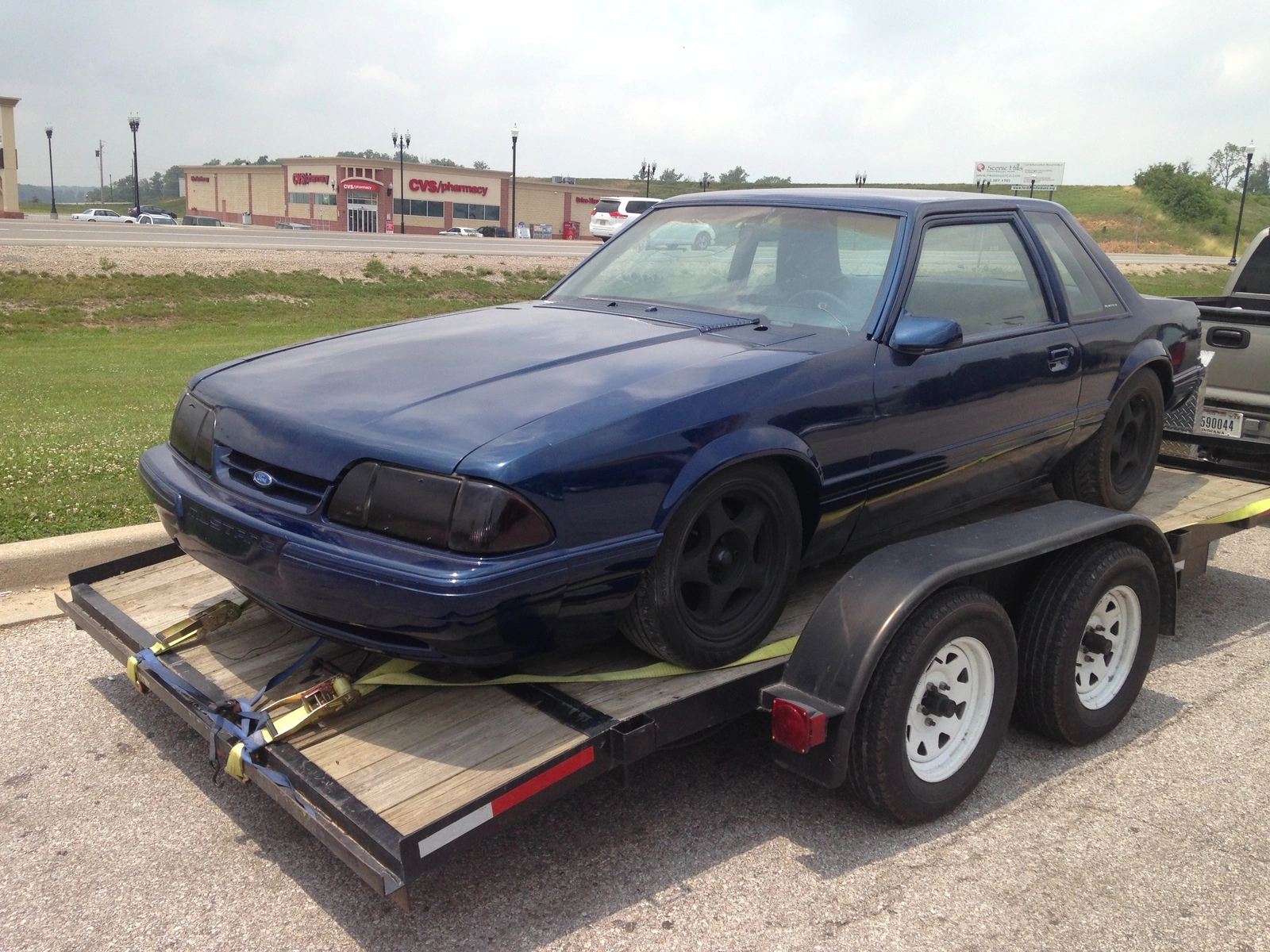

Because I bought this
89 LX Coupe
Car has power brakes, power steering, 4 lug with some sweet drum brakes, BLACK pony wheels and an 8.8 with 3.73s. Which is gonna be perfect for the pile of junk I was hoping to start. Its all getting tossed.

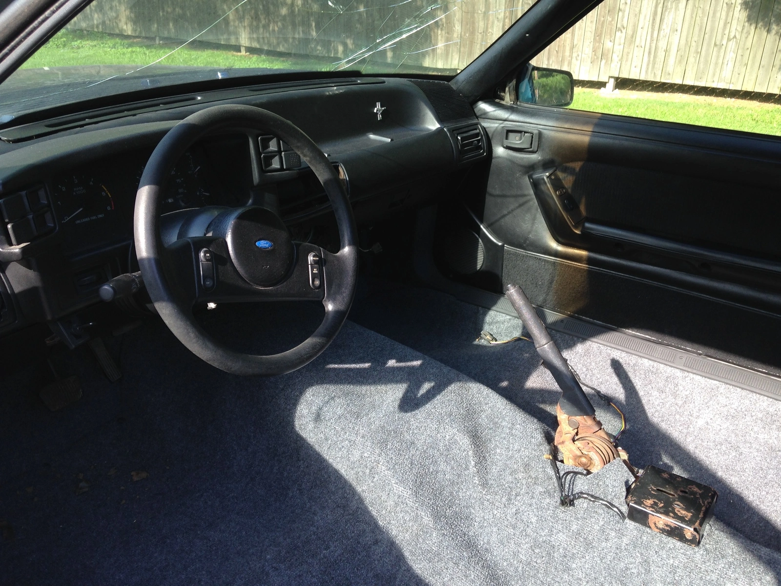

Current interior
Current dash is actually in great shape. Carpet is new but useless for my project

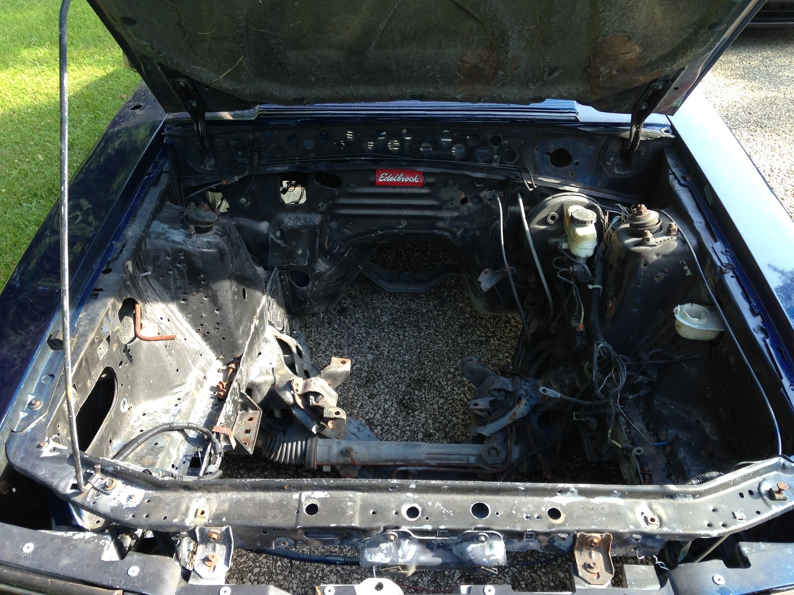

Engine bay is clean, just going to give it the same treatment the 98 got

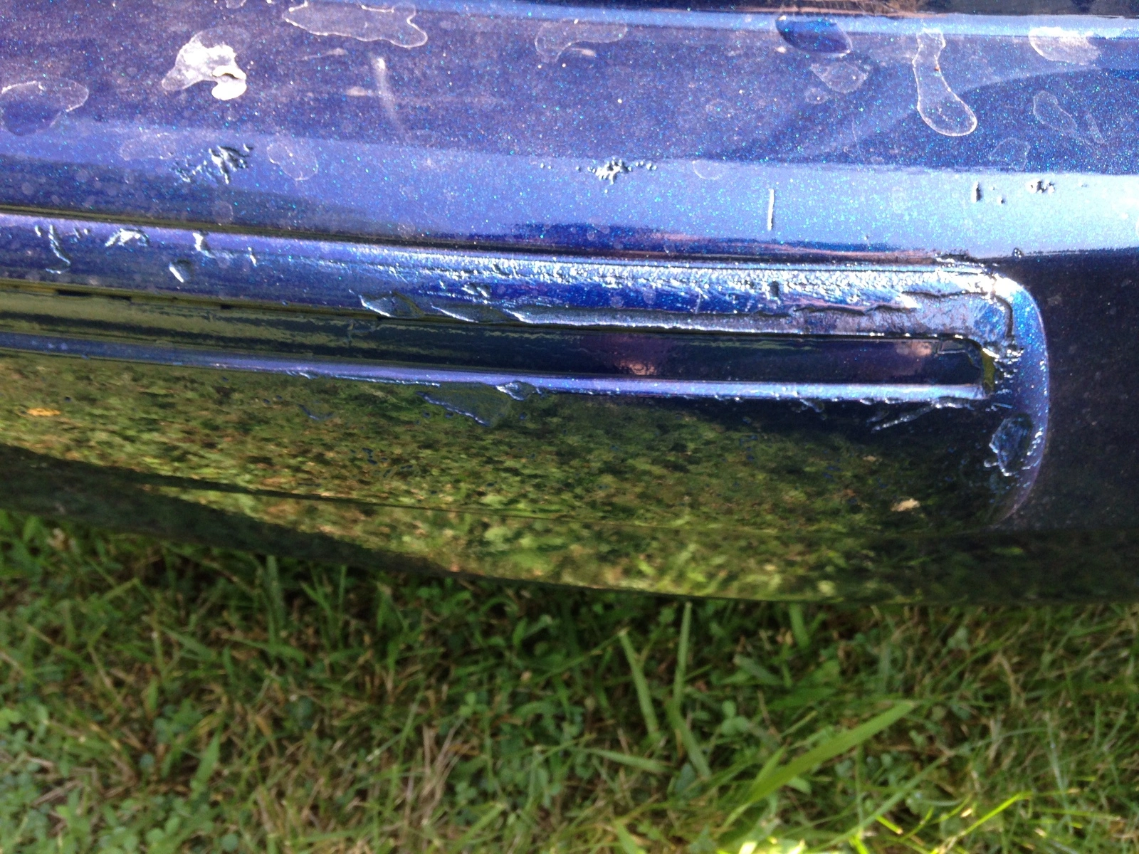

What you cant see is the bumpers, although the paint is only a few weeks old, they really sh it the bed on the bumpers in my opinion. ignore the water spots if you can
you wouldnt notice it at a glace or even 3 feet away, but i do. The car has to have a cowl hood painted so getting new bumpers done too isnt a big deal.

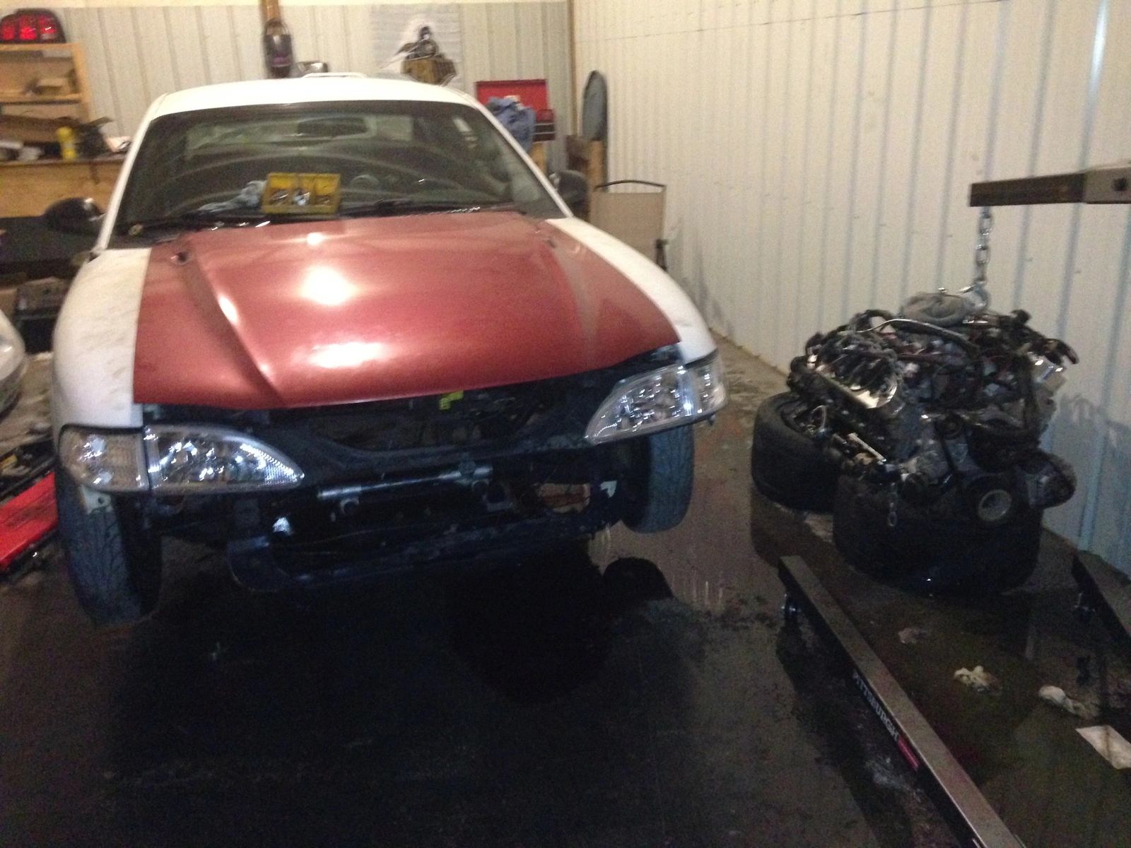

thats all ive got for now. Just picked up the car and its supposed to be hot as hell this weekend.
hopefully theres enough beer and shade to get the white car completely stripped and off to its new home
