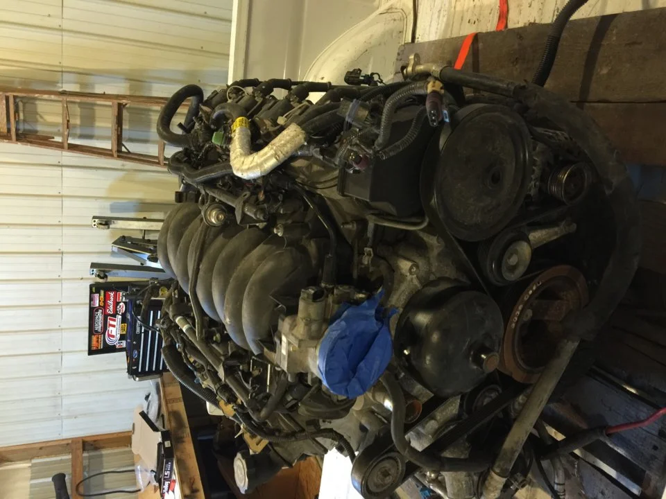

Engine made it to indy. To be delivered tomorrow. I went ahead and ordered my fuel fittings and the Holley EFI setup. Kicking around buying a blower cam to run NA for now too. Gotta kick the wallet while its down.

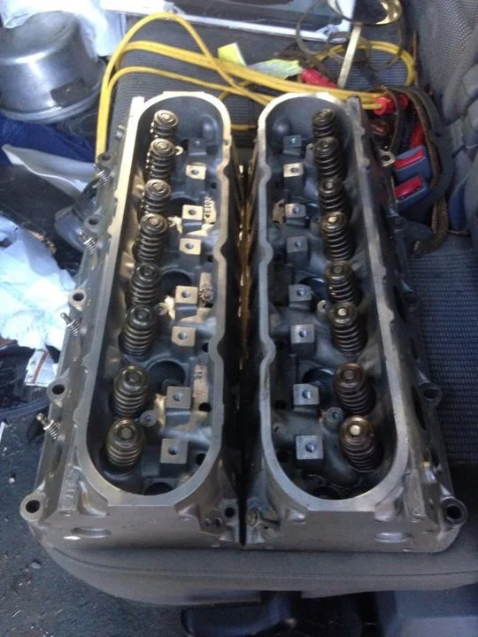

Bought a fresh set of 317s.
I love the Internet.

A5literMan said:
You're talking Greek to me! Lol not up to speed on LS stuff but assume they are good heads?
I forget I'm on a Ford forum sometimes.
They're a GM casting 6.0 head. Same as a 243 (c5 z06, LS2 head) or a 799 (truck head) but with bigger chambers to lower compression a bit. Will hurt a little NA (compared to a 243/799) but be beneficial boosted. Much better flowing head than a stock LS1 head. Also had a valve job and been milled a hair for flatness. Just wanted to be able to put the motor together once and not have to yank it back out.
Reactions: A5literMan
