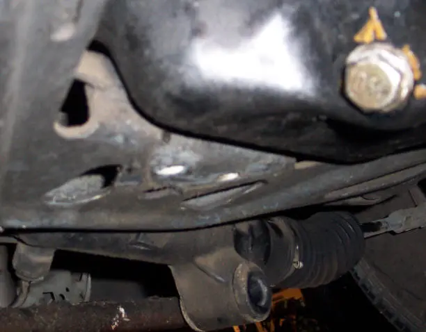

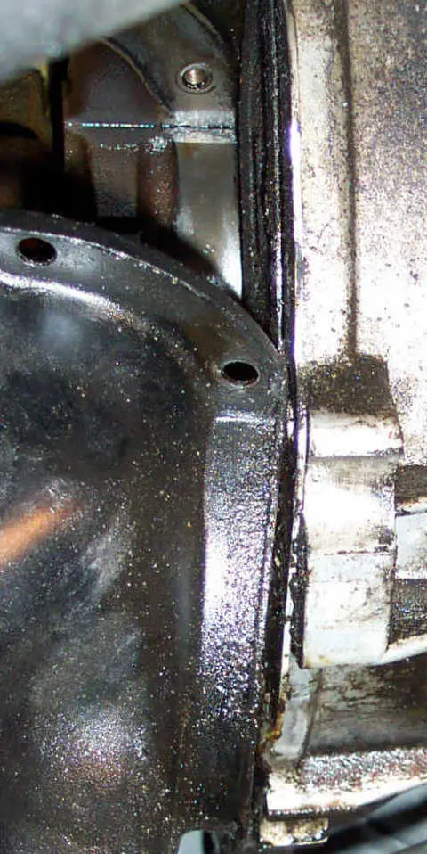

The noise is there all the time but quieter. The plan is to drop the pan and clean it and the pickup of any sludge. I followed everyones instructions and everything is off or loose. The engine is against the wall but the engine and transmission won't go high enough.
I even used a transmission jack to help lift everything a little higher but it's a no go. It won't clear the automatic transmission bell housing. Here's some photos.
Now I think I'll take out the pickup and wipe out the pan where it is.

Well, I got up in there and the pickup screen was already clean, so was the whole inside of the pan. :(
I guess the two flushes worked. It's all back together. I'll let you know.
