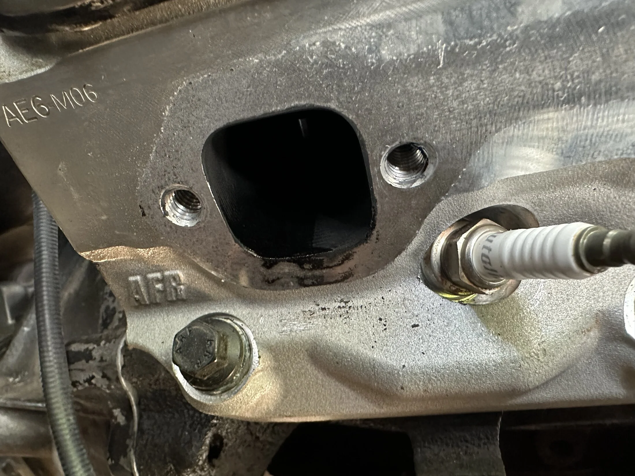

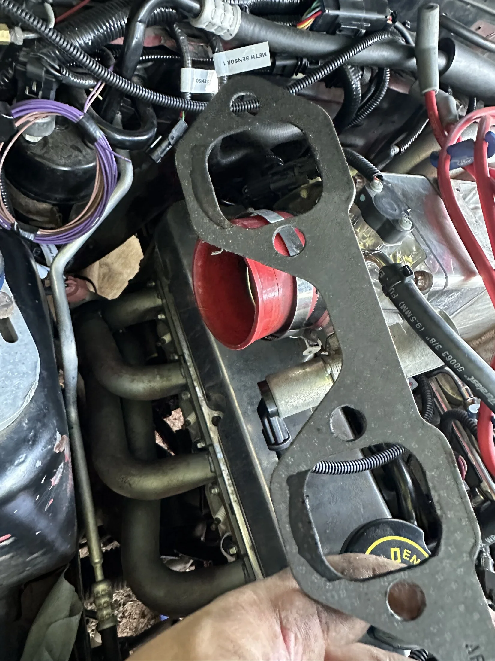

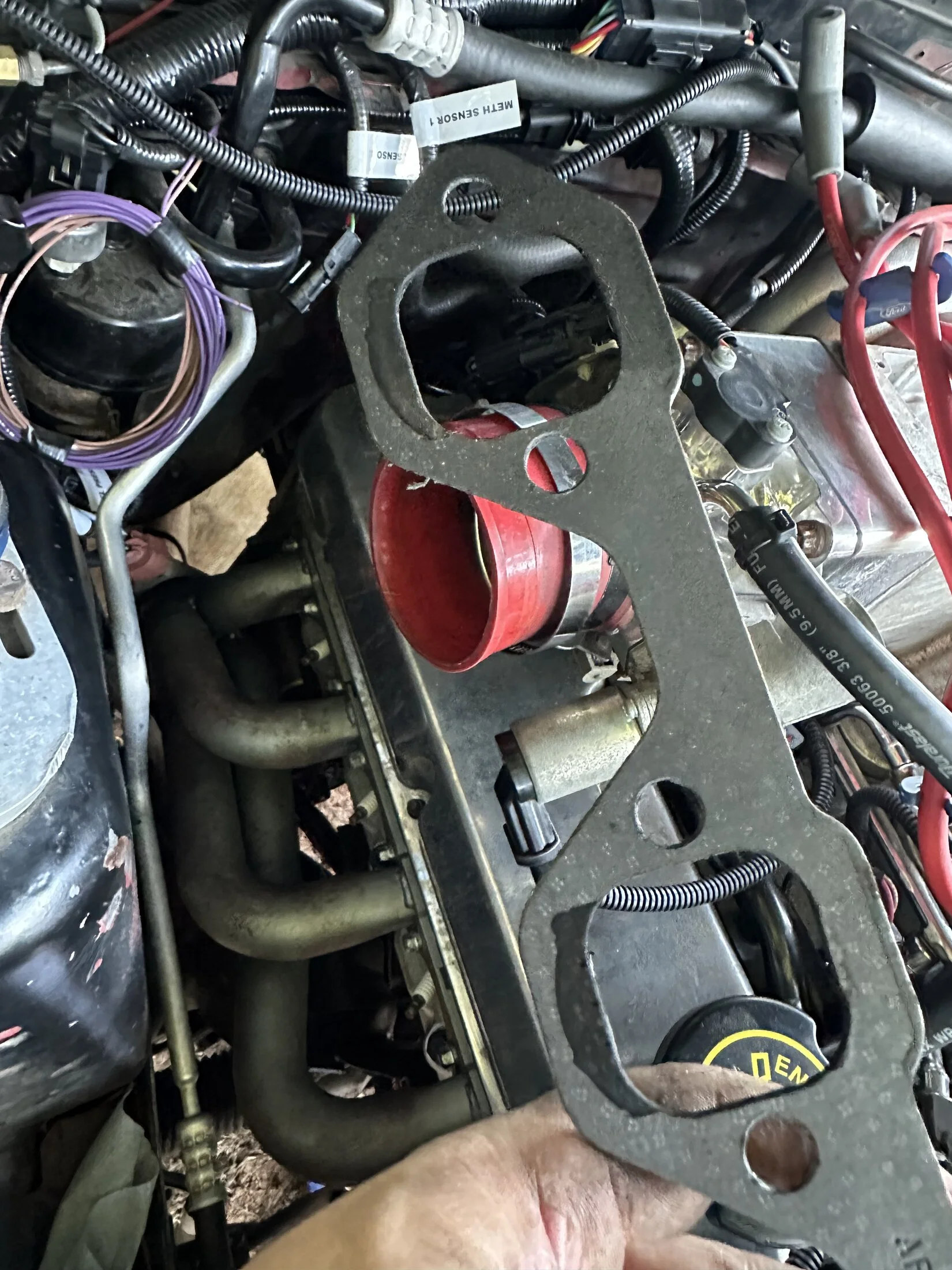

Popped the header off this afternoon and at first everything looked pretty normal but then I saw that there was a buildup of some sort on the bottom of the exhaust ports on the head and the gasket itself. Header was clean oddly enough and didn’t require any scraping.
It appears that there’s a small “ooze” of oil coming from the valve cover and my guess is that it penetrated the exhaust gasket and caused them to blow out at the bottom. I’ll fix that before the car is even fired up again. I also put a thin layer of copper rtv around where H pipe meets the collector ball.

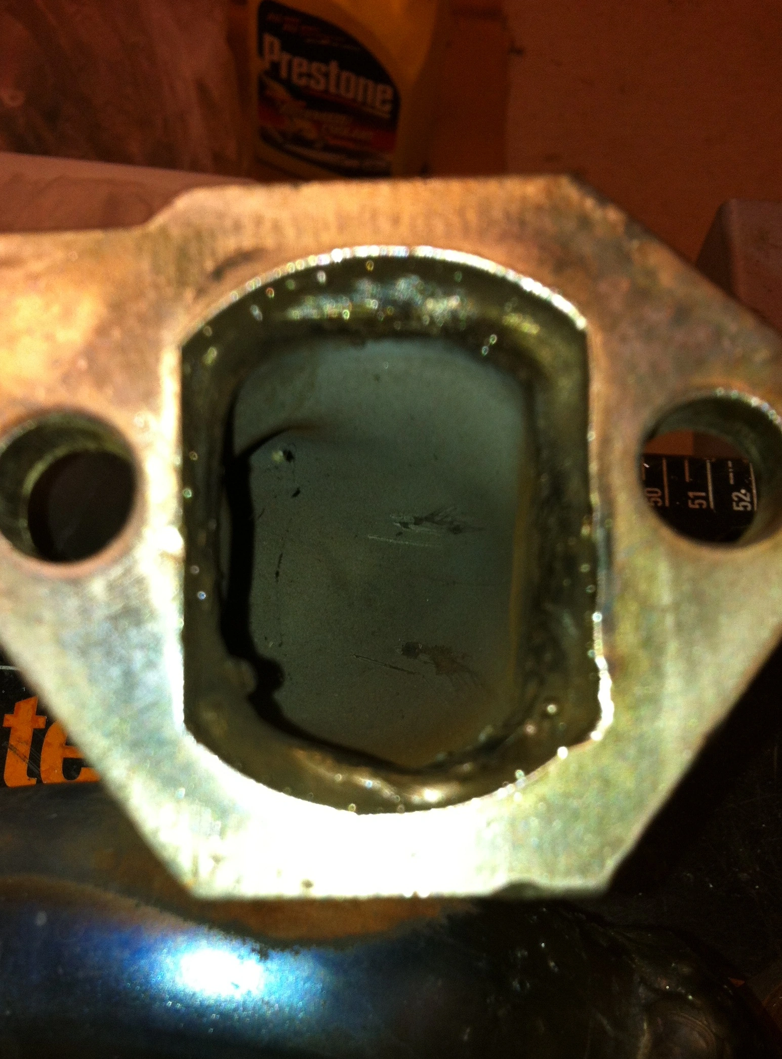

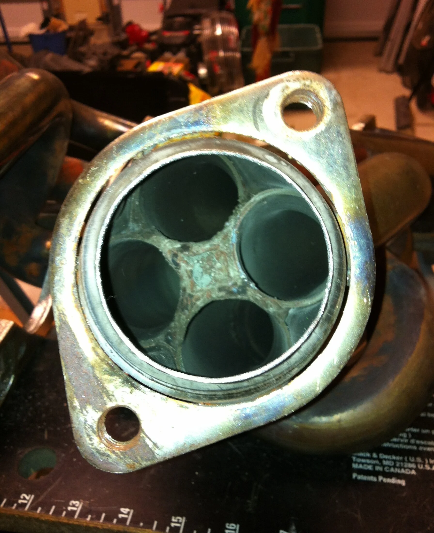

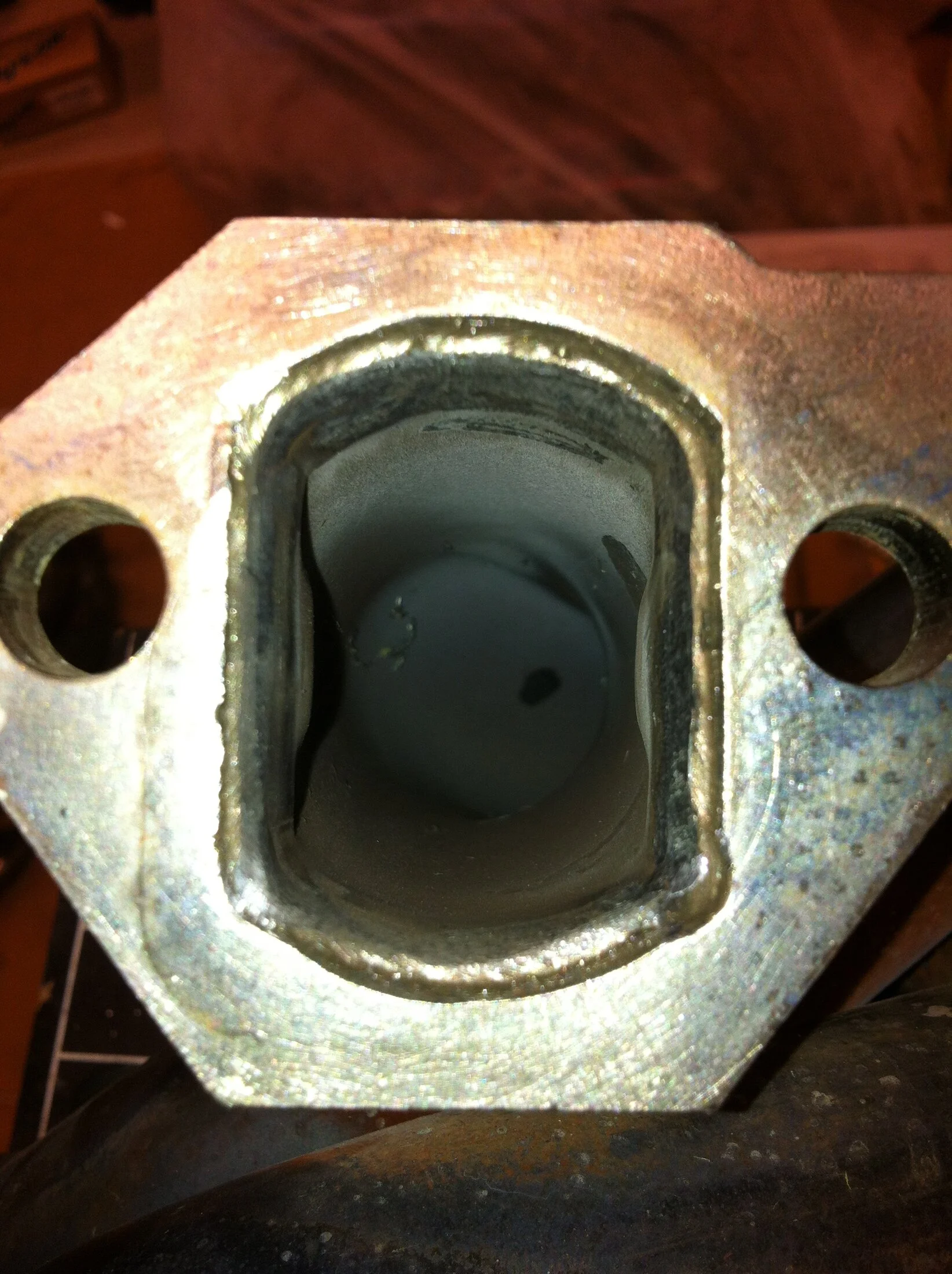

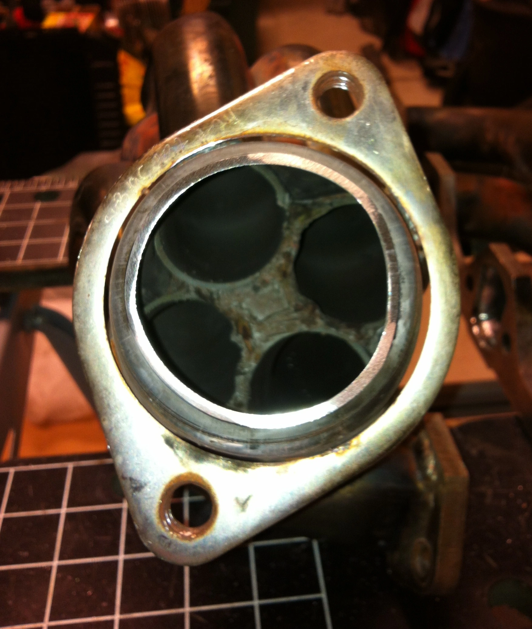

I ended up "porting" the headers as the welding from the primaries to the flanges was not great and the fire cones were more like 2-1/8" vs 2-1/2". Opened the primaries up and then opened the fire cones up to 2-3/8". I had time to kill over the winter when I built the motor so that was my excuse for doing it.
Before: After:
______
Fire cone before (I started grinding on it and then
realized I had not taken a picture): After:
______
I am sure I gained 1 hp and 1/2 ft-lb of torque...ha ha ha!!! Again, I had time and it was over the winter so the car wasn't going anywhere.
