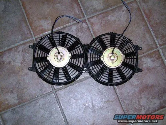

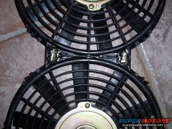

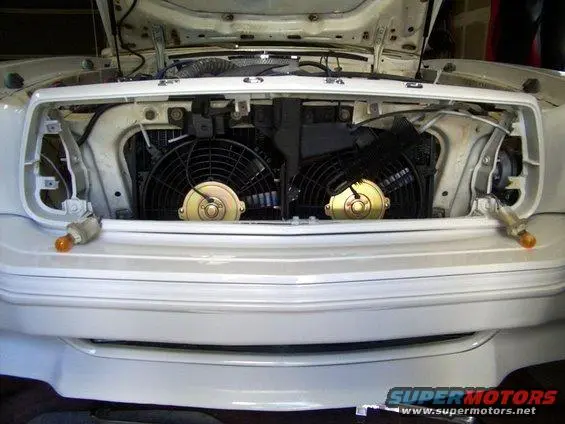

OK here are some pics of my fan setup. Dual 10 fans siamezed together setup as pushers and advertized to deliver between 2500-2700 CFM. They are just held in by zip ties until the new radiator shows then I'll mount them permanently.

jeffnoel, That's a nice dual fan setup. It looks like I'll still be installing the Taurus fan. I misunderstood how it was to be installed on the II.
You have one of the cleanest Cobra's I have ever seen. It's sharp. Thanks for the pictures.

Who makes the fans you shown and where did you get them from? I'm looking at putting an electric fan on now and I'd rather go with a pusher setup rather than a puller. Did you have to remove or cut anything to get those guys in there?

I got the fans on eBay check the link below for a current auction of the same fans. I don't know the manufacturer. They come setup as pullers but all you do is either flip the fan blade or reverse the wiring (one or the other not both, I flipped the blade) to make them pushers. As far as fit, I temporarily removed the secondary hood latch until the fans slipped in place. I have only tested the fans but they do move some serious air.
http://cgi.ebay.com/ebaymotors/ws/eBayISAPI.dll?ViewItem&category=33600&item=7906282006
One more thing, The fans come as two seperate fans. This is how I connected them together, using 1/4x1/2 bolts with nuts (the bolt/nut combo almost fit purfectly) and then filled the slots with some leftover 2-part clear plastic epoxy (same that I used on my all-red taillights) to ensure they don't come apart.
