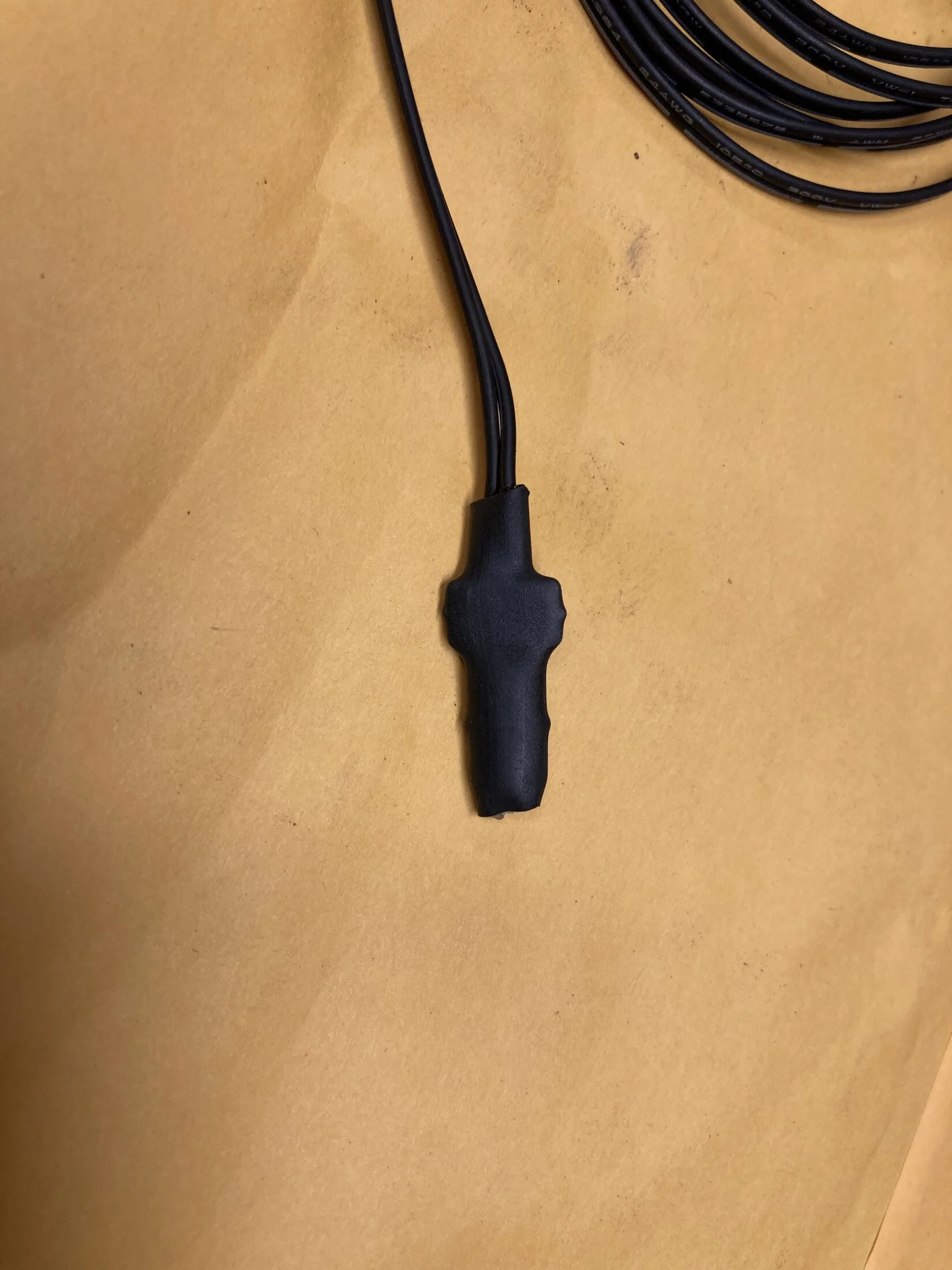

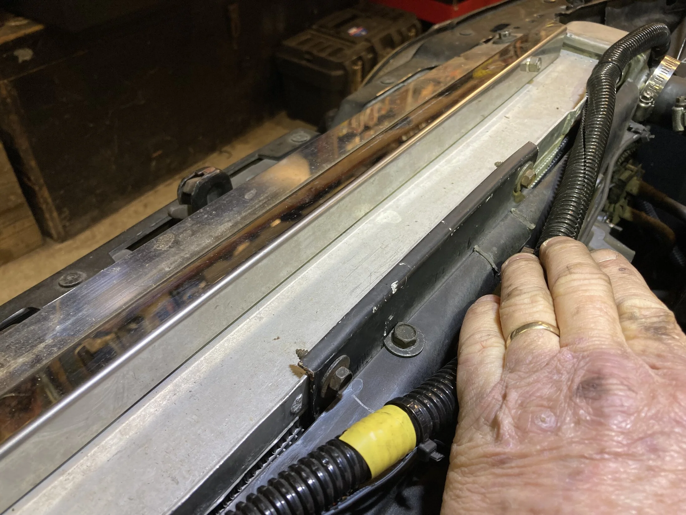

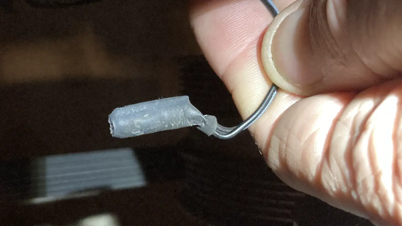

Just a follow up. I got the new sensor today but I need to do a little work before I put it in. I also discovered why the original one failed. The fan assembly slid down and pinched the wires. I need to get the fan assembly better secured. I think I’ll install the sensor within the shroud just above the bottom edge instead of below it. That too should help prevent damage if the shroud moves down again. Here is a picture of the damaged sensor and one of the new showing how it’s supposed to look.

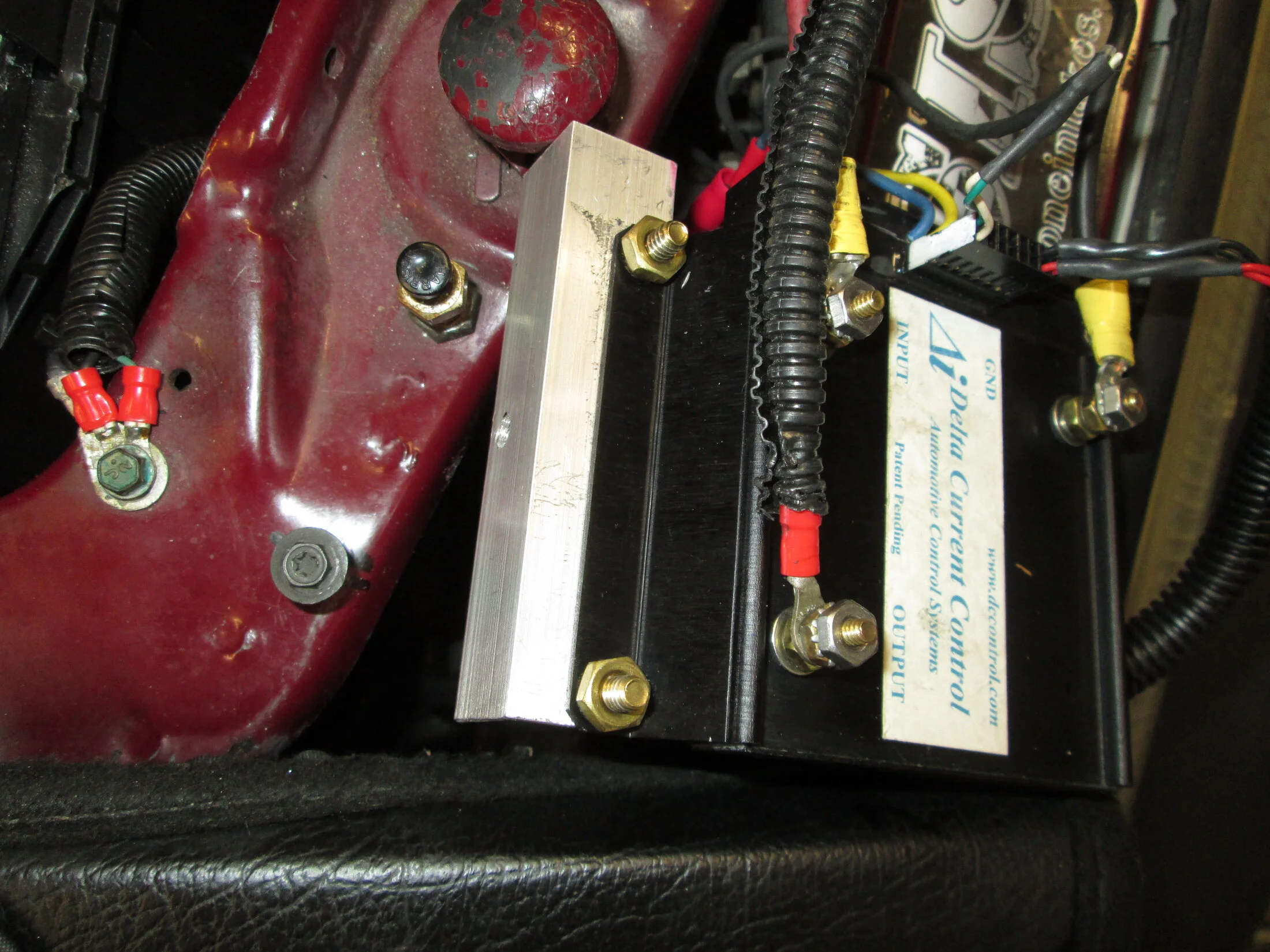

The LMR kit for Contour fan install is nice for sure. It’s too pricey for me at the moment though. No worries because I solved the problem of mounting for zero dollars. I rummaged through all the junk I keep and found a drip rail bracket from roof rack. It’s perfect for the task and I didn’t even have to modify it. I just drilled some holes and sifted through my fastener stock and done! Here’s what it looks like installed.
