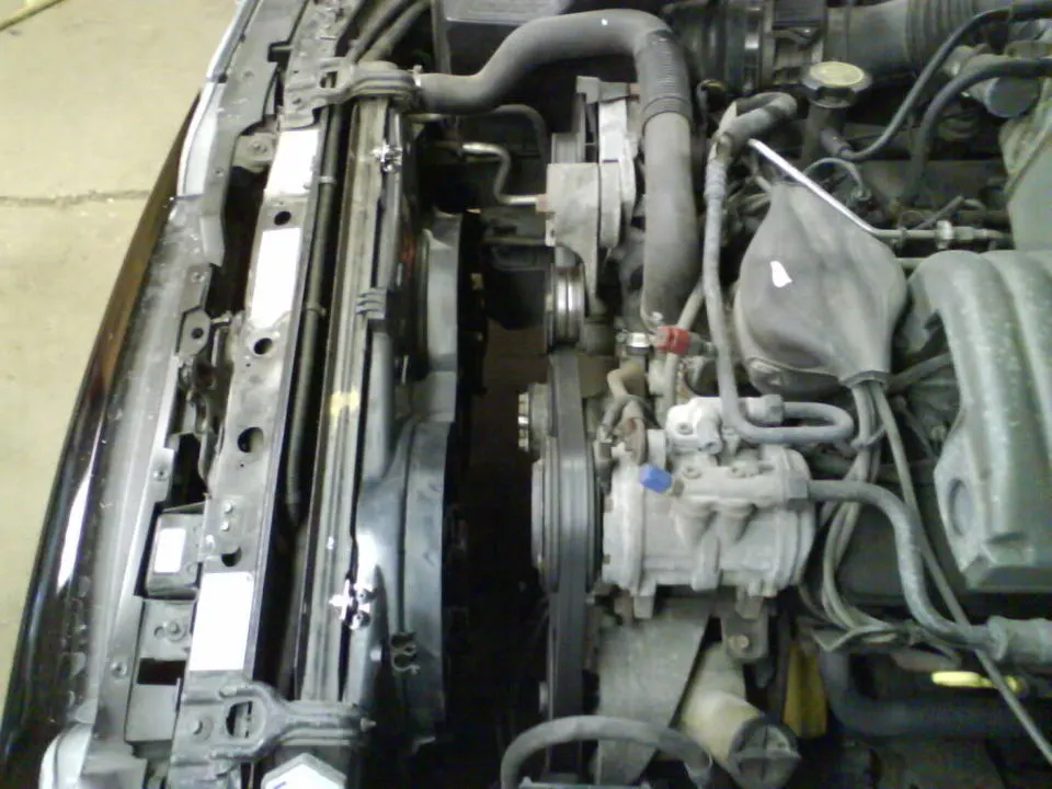

In my quest to make my engine bay look asthetically pleasing, i've come to the fan.
Right now, i have an SN95 e-fan with a big red summit bottle (i guess i could order the black one) . Looking for ideas to change this.
attachment.php
I have a 3.8L Taurus fan as well, but i also have the stock OEM fan shroud and been debating installing an E-fan inside for a clean look with the OEM rad overflow. I think the 3.8L taurus fan might be a cleaner install, so this is why i am looking for pics. I just have no clue where to put the coolant bottle.
Needless to say, I need ideas, so lets see those e-fan setups and coolant bottles. I'm looking for asthetics, so hopefully some of you guys have clean installs.

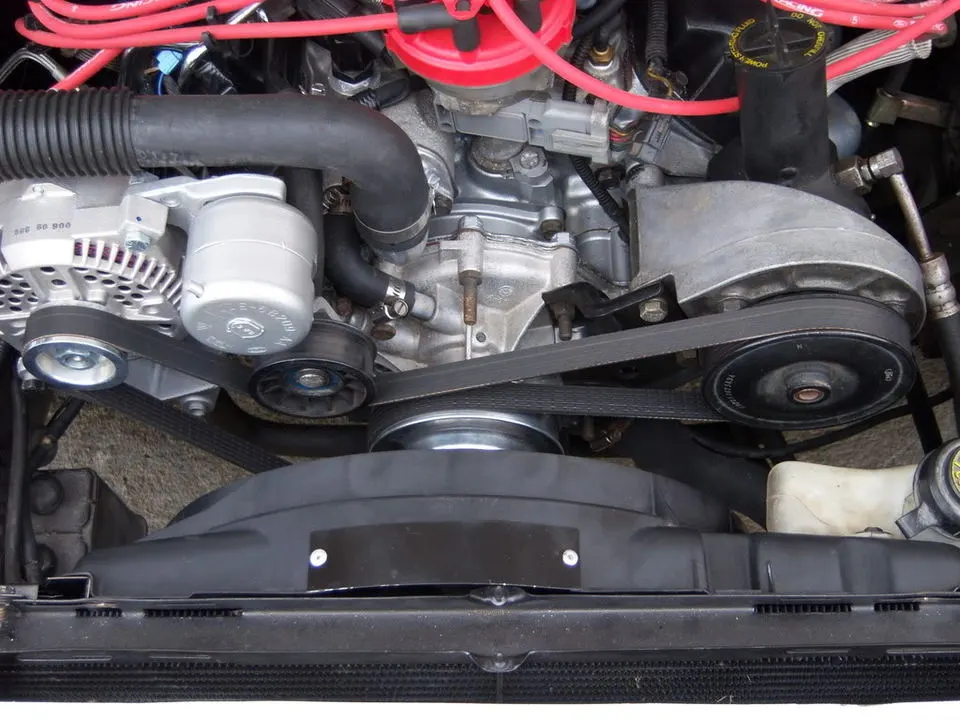

i'll have to take a pic of mine, i just used a taurus fan and a hayden controller (modified with a bigger relay of course). i also just used a generic parts store overflow for now. i had to set the fan off to one side (frpp rad), and it doesnt completly cover the rad, but it works pretty well (as long as the rest of the car doesnt set fire, only got to run it about a week this summer before my seat electrics died).
that looks super nice...
any more info on your setup?
what year taurus?
um, I believe it was a 93 V6 I pulled it out of... I'm only running it on low speed and it cools perfect... using a flexalite fan temp control and a universal 30 amp relay from napa. It required some minor trimming and then i made 2 brackets that run the length of each side top to bottom and attached it to the fan. Then I bolted it top and bottom to the radiator. Oh, and like many posts say, you have to cover the hole on the top of the fan, I used a piece of black plastic that I trimmed off and riveted it on to look factory. Hope that helps.
