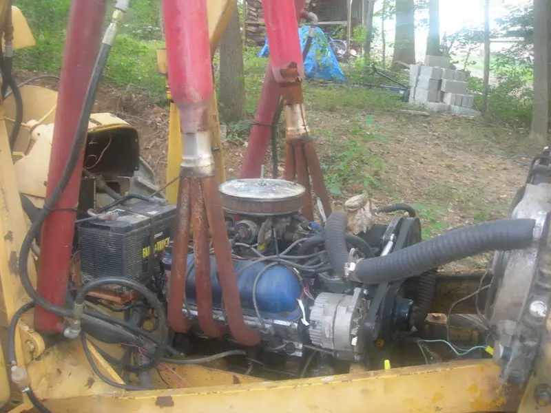

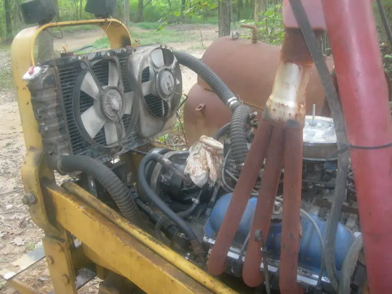

electric fans are on everything because they operate at higher efficiencies reguardless of rpm, i put a 3.8 v6 in my 1960 john deere 1010 backhoe and i cool it with a radiator from a 84 subaru, with two 12" fans, jsut put a toggle on it and walk away, just use the high speed also, if you have a gm alt. they are normally rated for 60 amps or higher, which is plenty for what you or i is going to do with it, then you wont have to worry about boiling it over because you forgot to toggle from low speed to high speed
