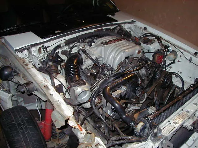

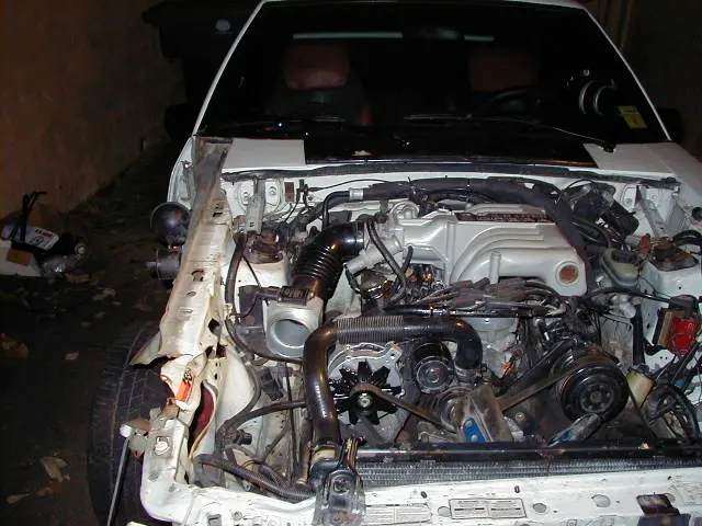

Here are the pics and thanks for the advice
I'm with richker - pull the codes and see how they help. However, if you've been trying to run it with the maf pulling through no upstream piping/filter/filter box, that could be throwing the accuracy of it's readings off. I'd try temporarily slipping the filter/box back on so that the maf sees the same type of air stream it did before the accident.
Looks like you got a new alternator atleast :) ...and where is the battery (mounted in the trunk/hatch?)...
Yeah atleast tape like a filter (since the body is a bit damaged...the box might not fit on right) to it to provide something for it to pull air thru...that fan or even the little alternator external fan might upstruct the air flow readings to be technical :D ...but just put a filter over it and try again and see if it helps...
Pulling the codes is always a good idea...
i would not disconnect the battery with the car running. future reference. :)
i second the above sentiments about being sure the plug wires are set up for the HO order. also, ya sure the dizzy was not installed out of phase? it can run out of phase.
if the battery was disconnect for long, the KAM would be cleared. but if the car ran off the alt, codes might still be in there (the KAM retains some residual power after the battery is disconnected - one normally has to discharge it). JR's links for pulling codes would be my next step.
good luck.

My son is fine, except for the fact that everyone at his school is giving him grief for wrecking such a fine piece of american muscle (ricers are laughing he said), and his old man is a little dissapointed in him. The battery is in the back. He got his voltmeter in dash working, and it showed a discharge, took the alternator to Advance and they said it was fried (0 output) That is the new one he put yesterday. Still does not read as high as it should. I am going to take it today to have whole charging system checked and the codes pulled. I'll keep ya'll informed. Thanks for all the good advice and please let everyone know that battery disconnected while motor is running = voltage regulator/alternator not happy.
