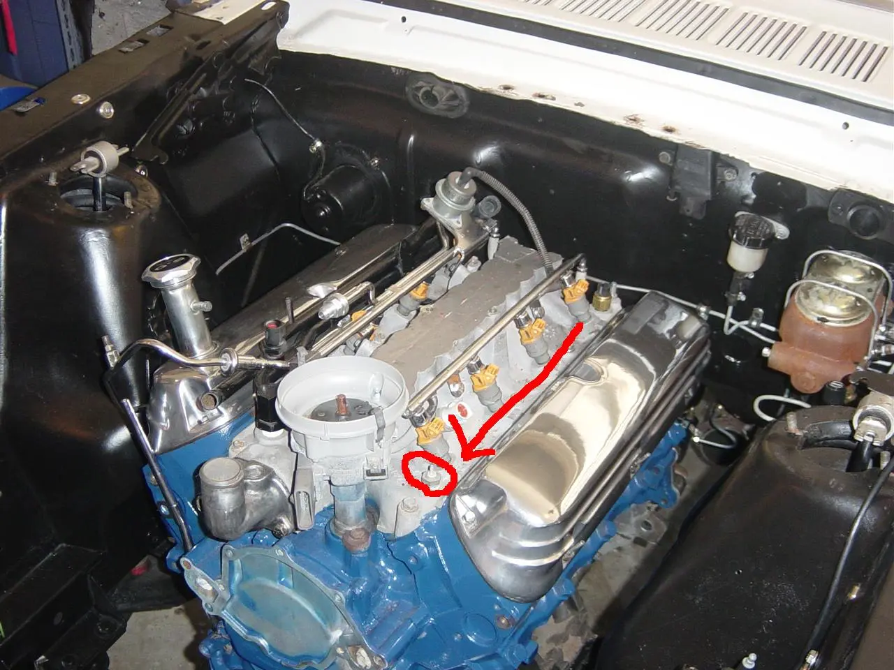

The sensor for the gauge is right here.
Verify the wiring is intact, and perfhaps replace it as I believe it's cheap.
