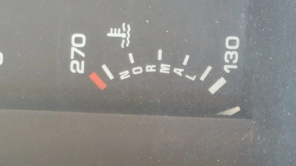

Notice today the need just sits on the bottom, way below the 130 mark. Could this be a sending unit? I can't remember where it's located???? Lower intake manifold? All other gauges work fine.

The sending unit is in the driver's side lower intake manifold; it has a single wire with a push on connector. Turn the ignition to Run and ground the wire against the engine block and see if the gauge indication changes..
