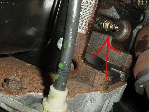

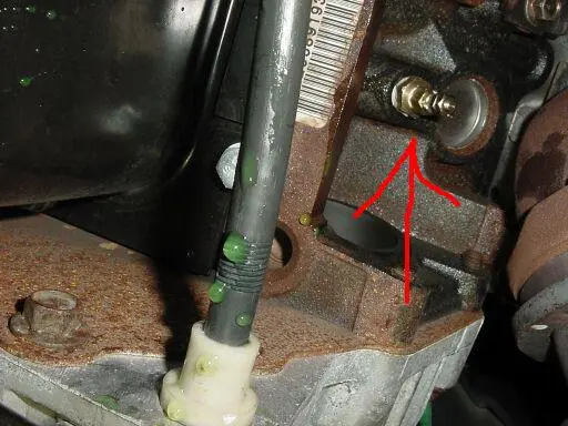

I put mine in the block. There is already a hole for it on the drivers side.
