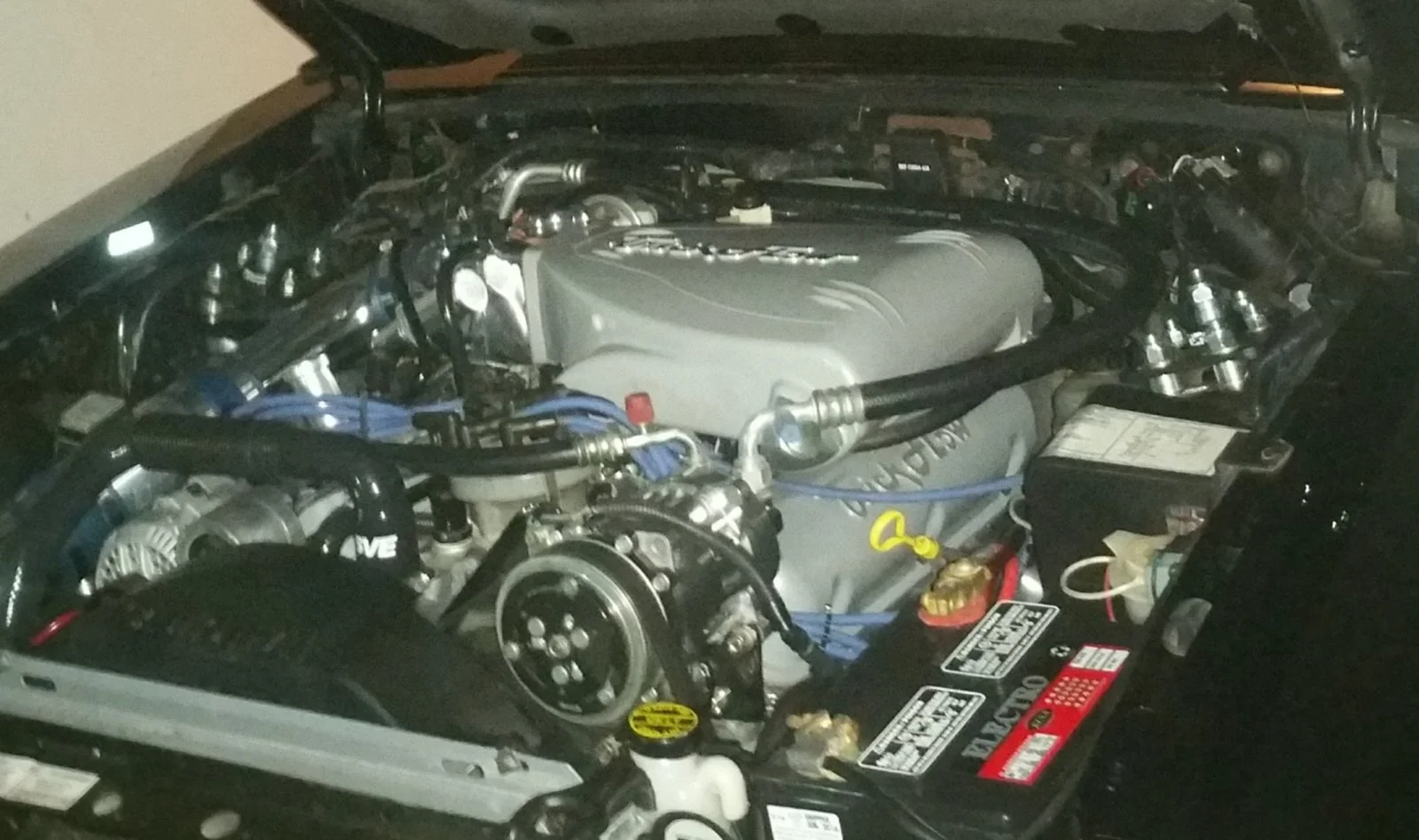

Heres the setup im doing
Cobra intake/lower 3/8s spacer
Trick flow stage one cam
New 1.6 RR "studs" upgraded springs
19lbskinnies 4holes might bump up to 24lb skinnies. But heres my pickle. Its either trick flow 170s or afr165s. 58cc chambers on both.. The cam has a low duration so my hopes for that is zero ptv problems on either set of heads. Might bump the cam depending on the clay test when i decide on what head to use.. Trick flows gonna have to flycut the slugs for more relief if i wanna go over the .550 lift and 230duration mark..
So anyone running a similar setup? Hows the port matching between lower intakes and heads? Any troubles and any suggestions on making safe power?
