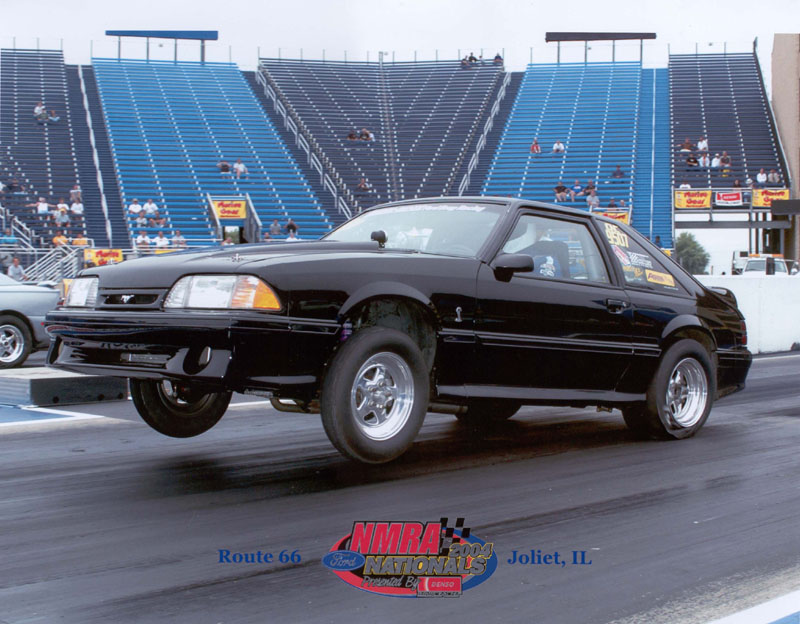

Here is Marc Arnold's N/A 347 that went 9.991 @ 135.29 mph with one along with a Pro-M 80 mm mass air. Think he put in on for the "Bling" :rolleyes: .
I think not....
The CAI on that one may not be blingin'
But look at that oil filter. It put the impin' in the Pimpin'
