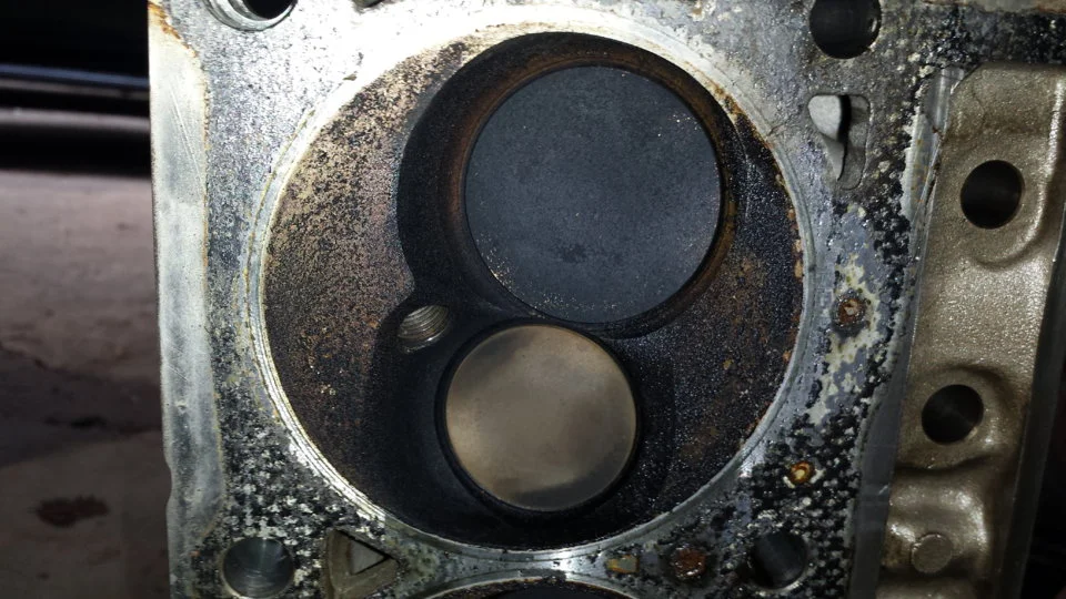

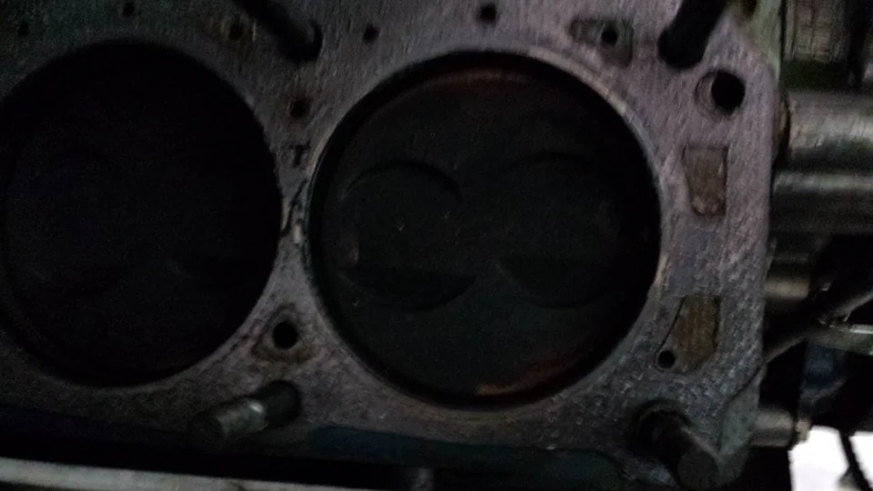

We took a short vacation and went back to Iowa over the weekend. We visited with my family who we haven't seen in a year, had her 20 year class reunion, visited her family, traded our Expedition for a Suburban, loaded the Cobra on a U-haul trailer and came back to Marietta. But the Cobra had an issue before we moved that I never had the chance to fully investigate until yesterday. About a week before we moved, I had the carb off to change an accelerator pump diaphragm that was leaking. We drove it into town where it developed a miss. We limped it back home and looked around a little. We found that the #1 plug ground was pushed against the electrode effectively grounding the plug out. It didn't appear to be physically damaged which is what threw me. We bought new plugs, but it just didn't sound right to me. We drove it to my brother's storage unit and parked it until this last weekend. In the mean time, I bought a cheap bore-scope. So yesterday I put the bore scope to work. Turned the crank until the #1 cylinder was at BDC and ran the scope into the spark plug hole. I couldn't see the whole piston, but it looks like something got in there. There are 2 marks in the piston that I can see near the intake valve reliefs. So it looks like I will be tearing at least one head off and probably the whole engine from the car. I'm kinda bummed....:(
Well, I finally tore the head off this morning. I'm not sure what I had seen with the bore scope, but I didn't see any damage whatsoever in that cylinder. What I did find, besides a little extra carbon buildup from running a little rich, was that the #1 cylinder had some kind of oil leak on the intake side. I am suspecting the intake valve seal, but can't rule out the intake gasket. I will be checking the valves in that cylinder just to be safe, clean everything up and put it back together! Sorry the piston pic is a little dark, didn't turn the flash on and was in a hurry to get to work....

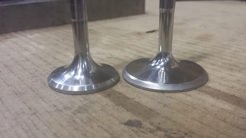

Another update: it's been slow going as the misses lost her job, but I've been making progress. I polished and lapped the valves and installed new seals in the Trick Flows. I now have the engine on a stand and torn down for a quick re-ring. Everything looks to be in order except for cylinder #3 which had a broken compression ring which scratched the cylinder. The hone has most of the scratch out as of now and should completely clean out without too much issue. I will be setting up my dial bore gauge and bring it home from work to check the cylinders before reinstalling the pistons, but hope to have it back together before spring-I'm hoping to take it to Mustang Week in Myrtle Beach this year.... :cool:
Only pic I have to show is of the polished valves....
