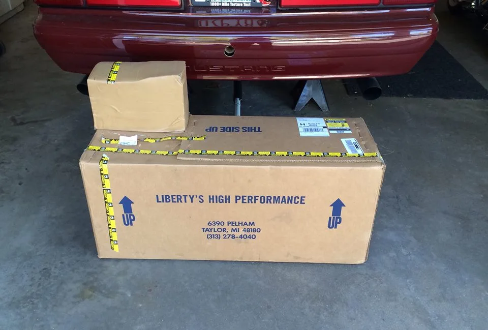

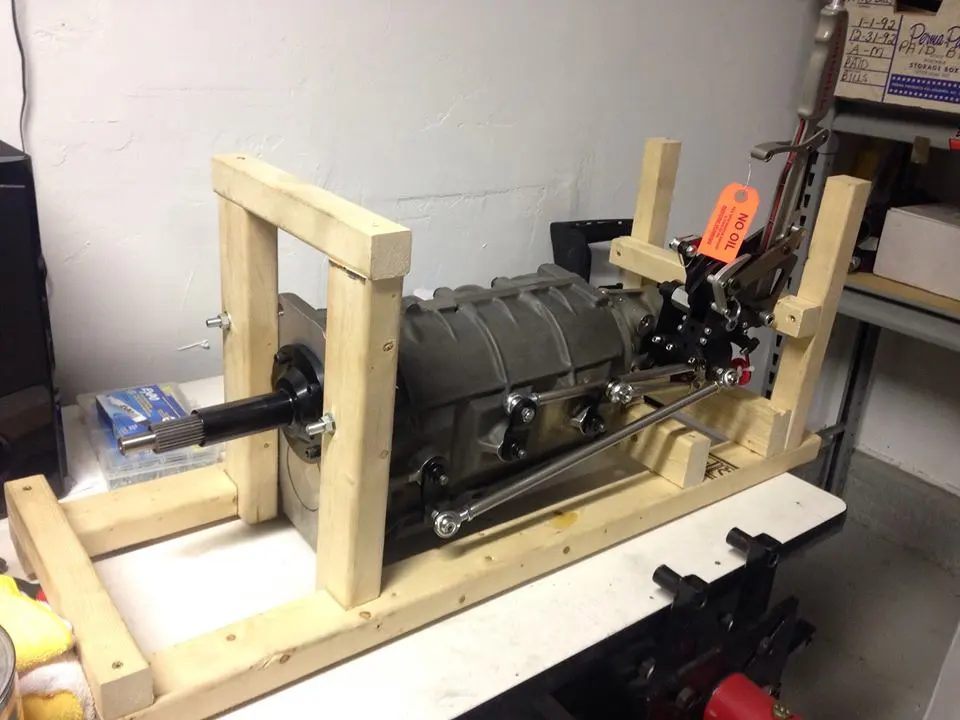

Title should read coolest thing the ups man has delivered to me, here it is, in all its glory, my new transmission, no more broken tremecs in my future.

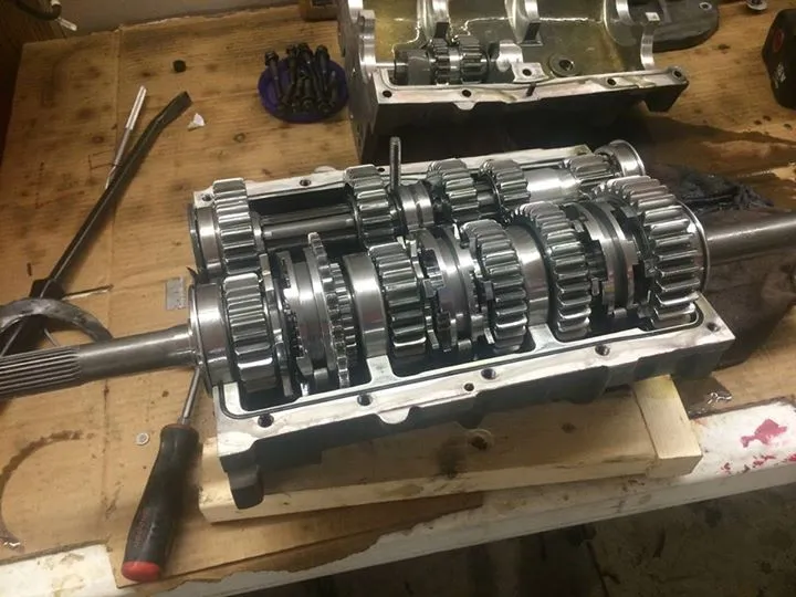

This is what the inside looks like, not mine, a friends transmission he had to take apart for some service. If you notice, no one piece cluster shaft like a tremec transmission so in the event of a gear failure, all that needs to be done is pull the shaft out of, take a gear off of the shaft and replace it with a new one. The last time i broke 3rd gear in my tremec it took out a total of $1080 dollars worth of parts alone...
