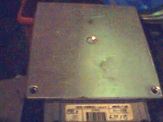

I got the engine timed properly earlier. But it still isn't streetable. The air fuel mixture is still way way off. The car will still run great at full throttle, but sputters and coughs at any thing less. I unplugged the TPS, and it got a little better, but would still do it. Then when I got to the house, it cutt off, and wouldn't crank back up, so I'm guessing it was flooded at that point, and the plugs had become fowled. So since the TPS, the EGO, the MAP, and Fuel psi Regulator are all new, and the TPS reads .94V at bottomed out throttle stop, I am left with only one idea... Bad ECM. It's the only thing left that is related to air fuel mixture. So can anyone tell me what is required for removing it? I have already scoped out the one in the 88. I see it, but I don't see a clear path for removing it. What holds it in? That little plastic strap? Or are their bolts? I didn't really feel like tearing the whole dash out to find out. GM is alot smarter about where they mount their ECM's, so much easier to get at.
Yay! It wasn't as hard to remove as I thought it was. Just two bolts, I was impressed. Now, if putting this in doesn't fix my problem, I have decided that I will just convert this girl over to carbureted. That way I KNOW where my air fuel mixture is set. Is the lower intake manifold the same on EFI as it is on Carbi's? Or will I have to replace the whole intake? Just want to have an Idea so I'll be ready. The idea came to me while I was asleep. I was dreaming about doing to convert for some odd reason, but when I woke up I said "hey, that's actually not too bad an idea" especially if I go with a high pro carb. Any of you guys running a carb setup? anyone have a performance carb to suggest if I do have to do this? Lastly, anyone ever converted an EFI over? is it harder than I think? I'd much rather stay efi, but I'm not going to just keep spending money for no reason...

It was the computer. Car runs perfect now. So, I think I'm gonna post a tech article containing the syptoms of my problem and the final cause, BAD COMPUTER. So that noone else will have to spend 500 dollars in new sensors and crap just to figure out their computer is defunk. I am SOOOO extatic, I can't even describe to you the joy of my car being right! OMG! Stupid computer. I'm gonna take it apart and see if there's any visually noticable problems. It looked like the computer has been changed once before in this car, if so, I may have a wiring problem to track down, no reason any one car should EVER go through two computers in it's life if all is well.
