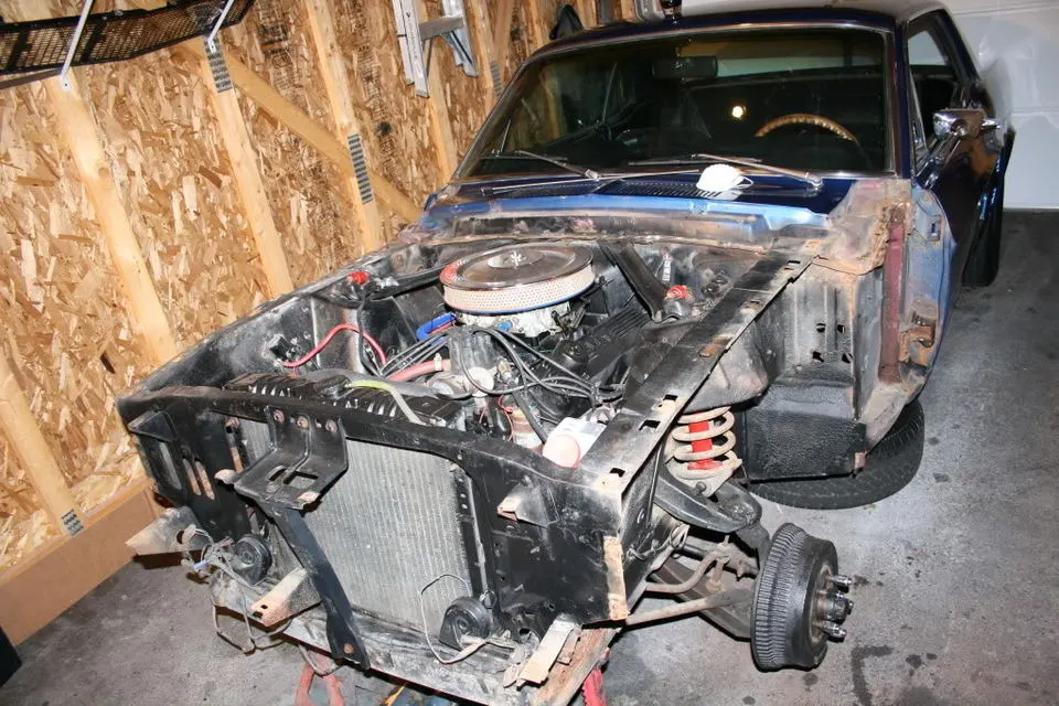

Under the hood had seen better days:

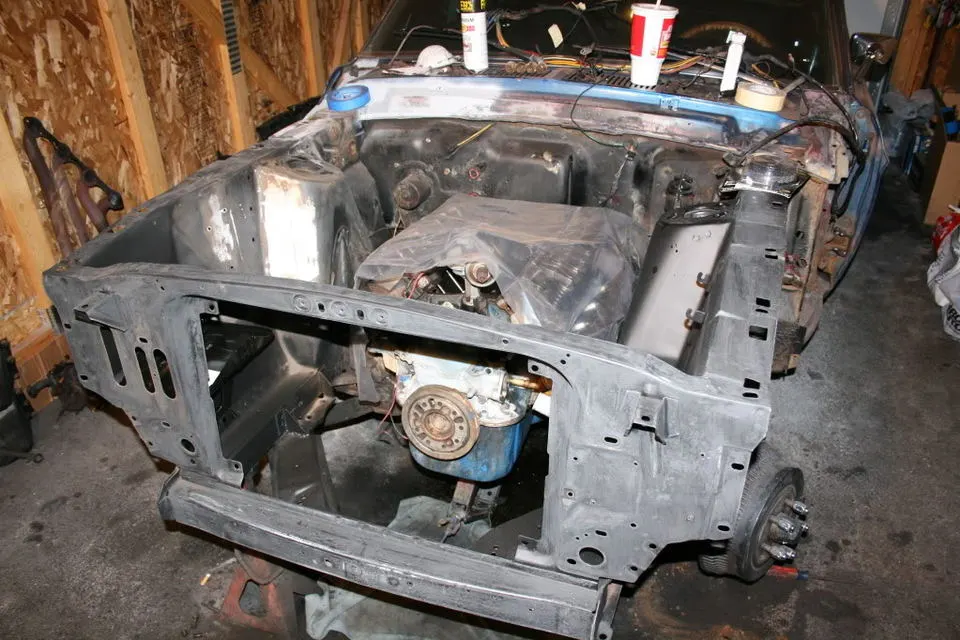

First cold day I started to unbolt some stuff just to look around. You dont REALLY know a car until you crawl around it for a few hours.

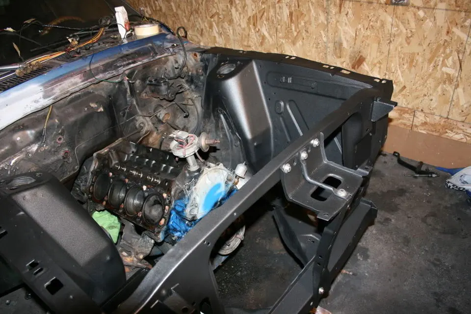

Next thing you know, the motor just started asking me to pull it apart:
Couldnt bare to put the old parts back on so...

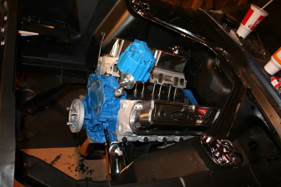

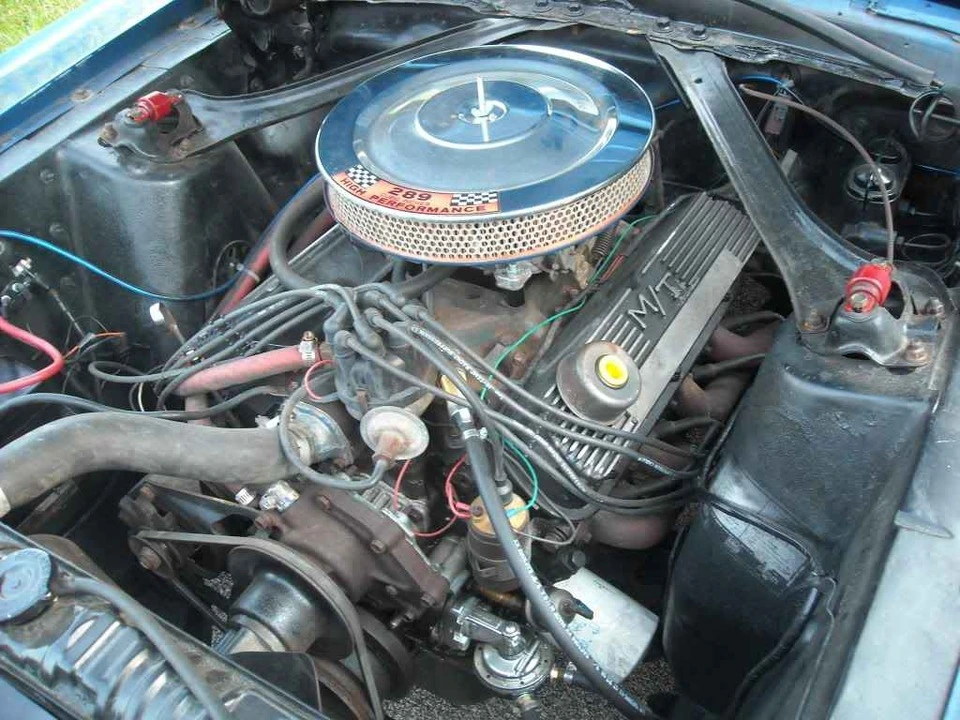

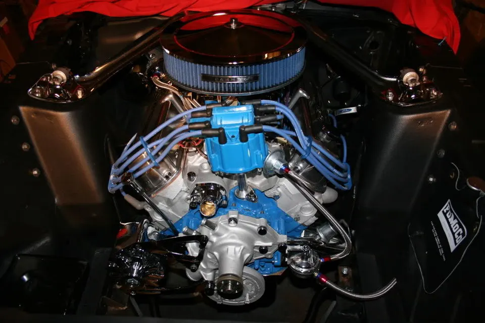

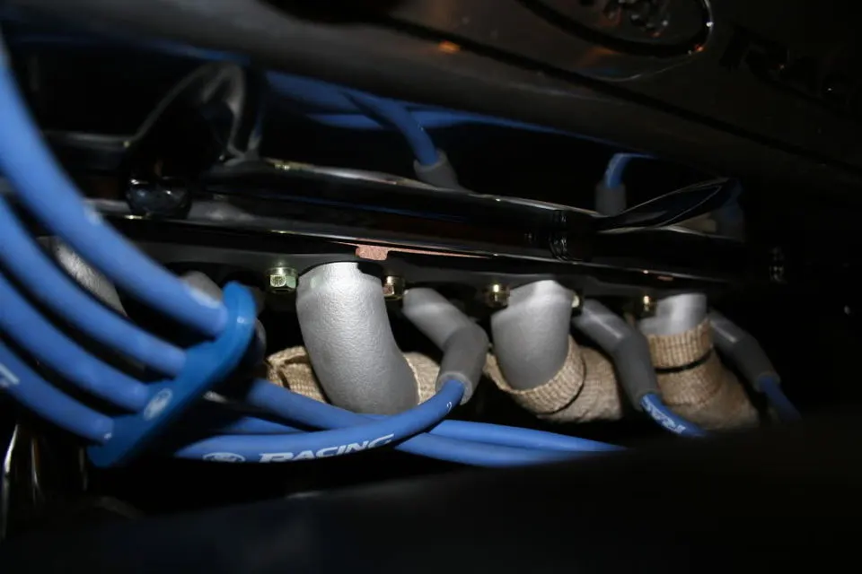

So now its a nicely built 302 with 351w heads (the good year ) mild cam, headman headers, 600 Edelbrock, High RPM high rise manifold from Proffesional Products ect. Bolted to a B.W. 5 speed with a Centerforce clutch and a 9" rear. Should go pretty good.

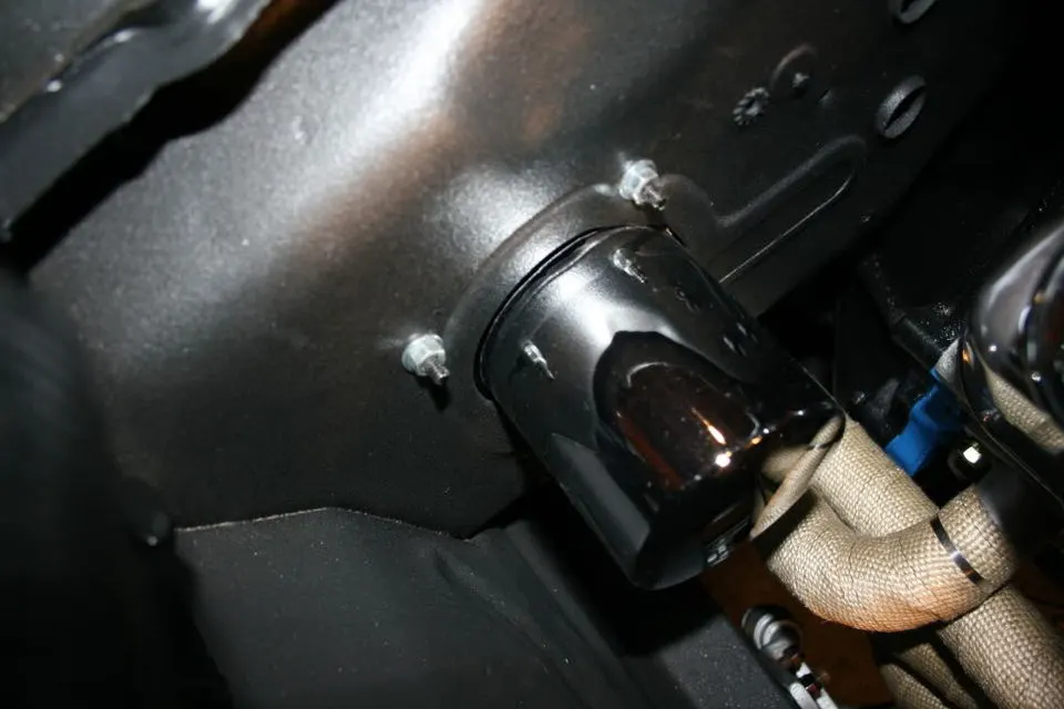

Made a oil filter cover into a chrome blower motor cover:

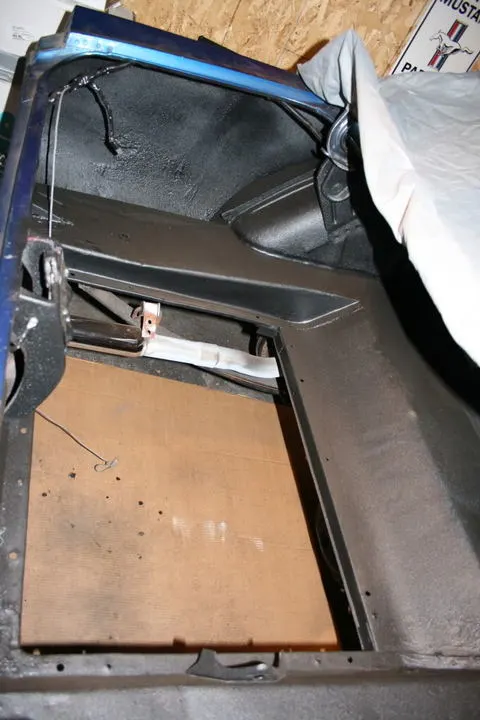

The interior was in wrough shape so that was next.
Did the doors and dash in Gunmetal with a bit of flake, cleared and buffed.

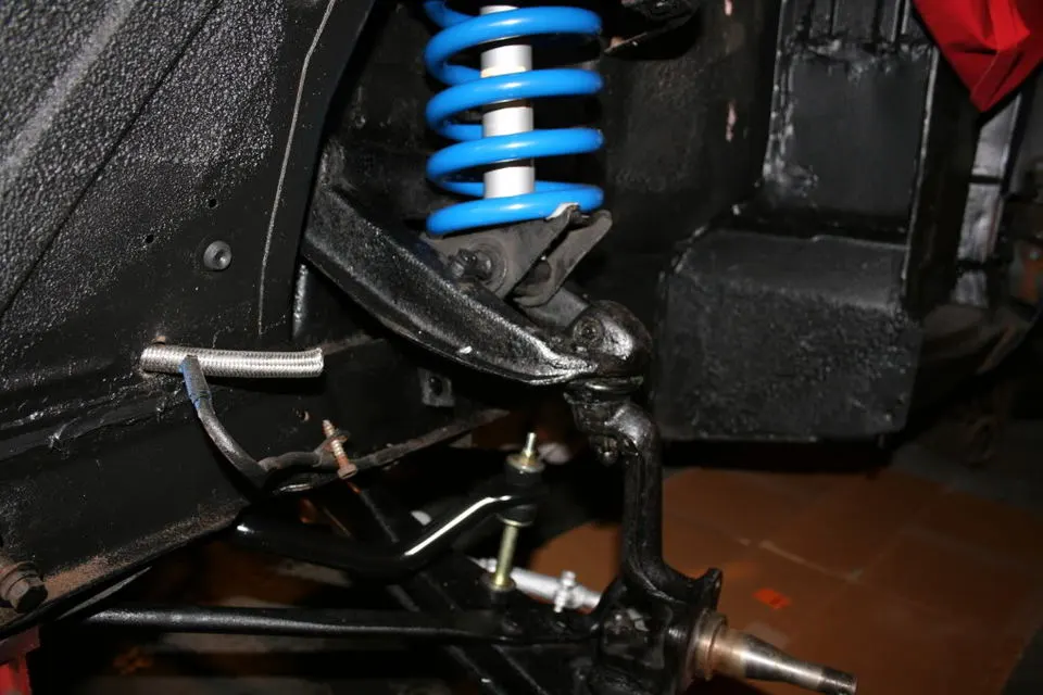

Just dropped in some drop springs, KYB shocks and a big boy sway bar.

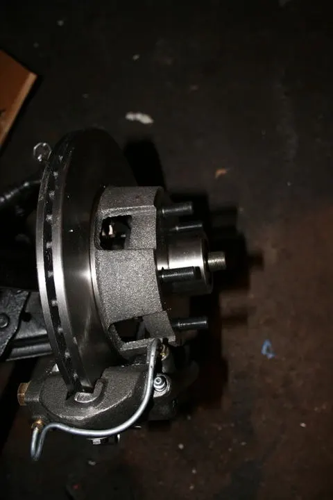

I have a brake question for you guys...The engine has a decent cam and will have a low idle. I dont want to run an electric vacume pump for a brake booster. Question is, how much of a difference will just swaping the front to disk make? Will that give me enough braking power or do I really need the booster?

If you swap to disc in the front you will need to add a booster. I have done this and the pedal will feel the same as the drum brakes until you add a booster.

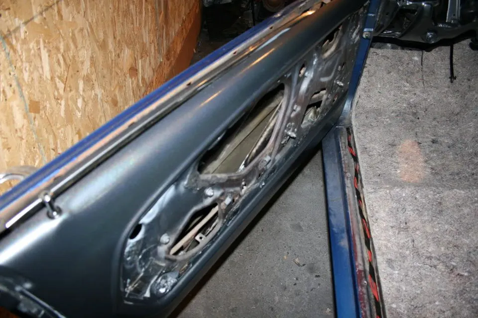

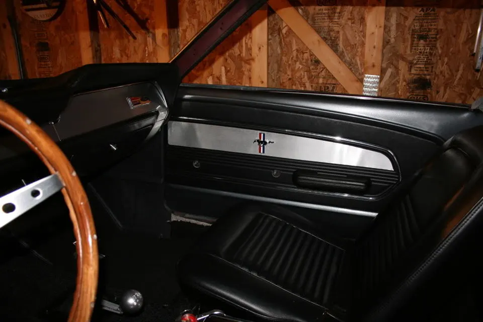

I took a set of aluminum door inserts and trimmed them down to fit the standard door panels. I think they look pretty good.

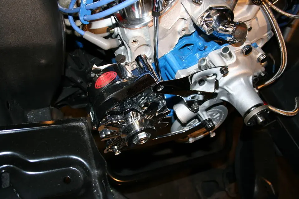

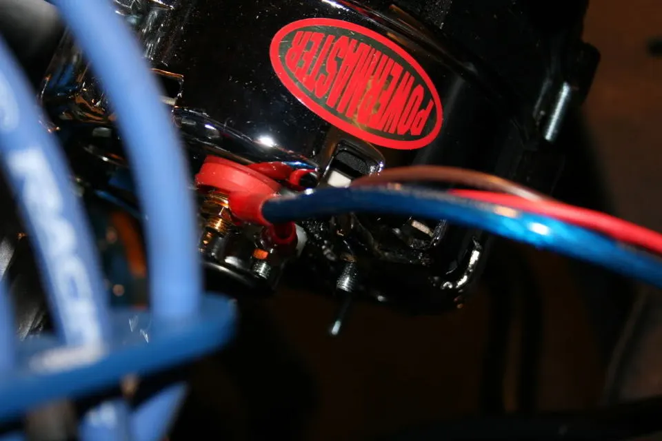

Wired up the new alt...
All the wiring is going between the inner and outer fender

you most defiantly don't need to install a booster if you go discs. how would the pedal switch to feeling like power brakes without a booster?? and the braking power is your leg if you can push the brakes all the way down.. then you're okay if you can't get a booster. i've had manual brakes on my car since i got it, installing front discs was the first thing i did.
the difference was very noticeable, a few years ago i swapped out the back drums for discs there too, and that made it just that little bit better. the pedal is still stiff, but that's how i like it, i don't like power brakes being all squishy.

You know, I kinda thought the same thing. My motorcycle (granted it weighs 600lbs and has 2 serious 6 piston Brembos on the front alone) stops with ease without power assist. Also keeping in mind your doing that with 4 fingers vs the strength of a leg. I may just try the manual disc swap first and see how it goes. The less hoses under the hood the better for me.

I'm going to give the non power a shot, its easy enough to change out later and since I already reinstalled the pedals and the steering I dont feel like swaping the brake pedal anyway.

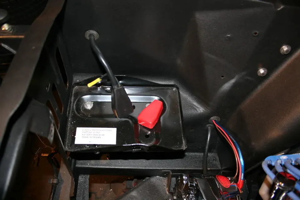

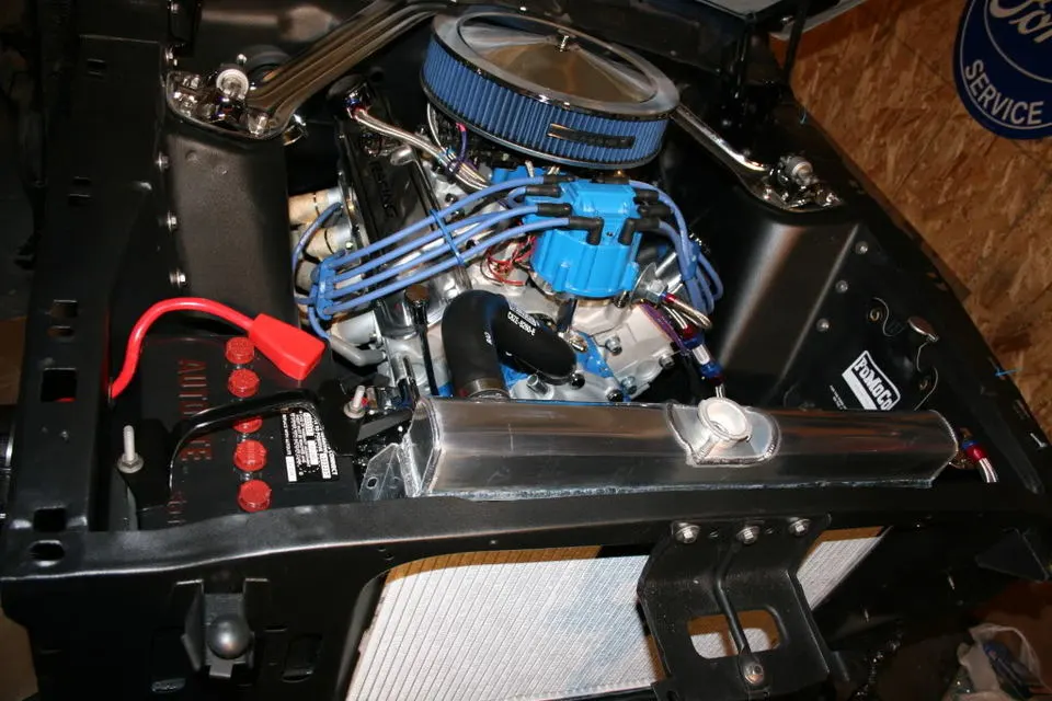

New aluminum radiator, little bigger then stock so I'm going to have to fab some brackets. I also installed the new (old) battery.

New radiator mounted;

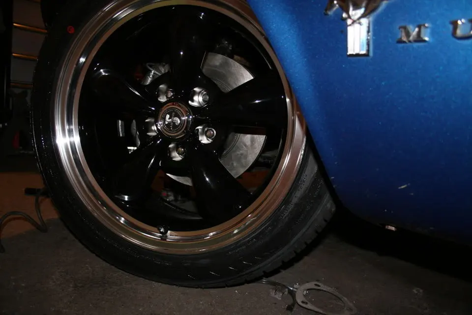

New disc conversion

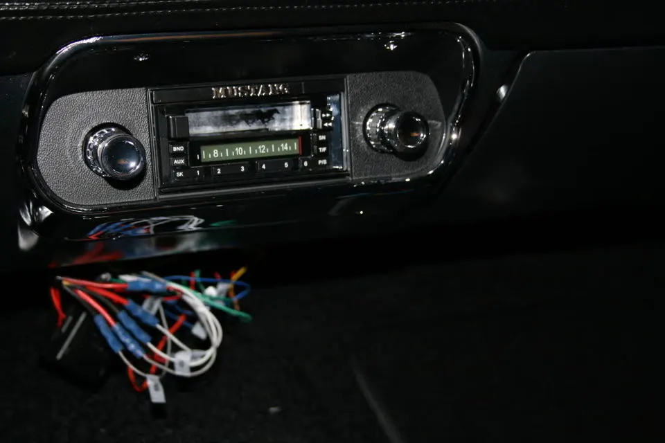

New radio:

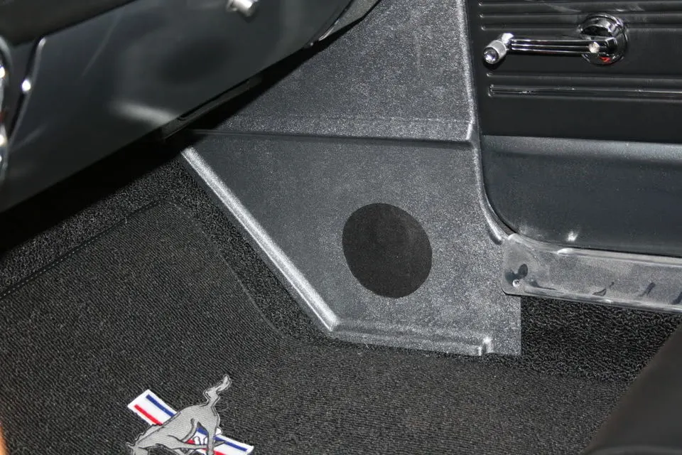

I didnt like the speaker "pods" poking out of the aftermarket kick panels so I made these and resessed the 4" in the door hinge. I think they give a much cleaner low profile look.

What kind of radiator is that? What are the dimensions of it?

Here is where I got the radiator from:

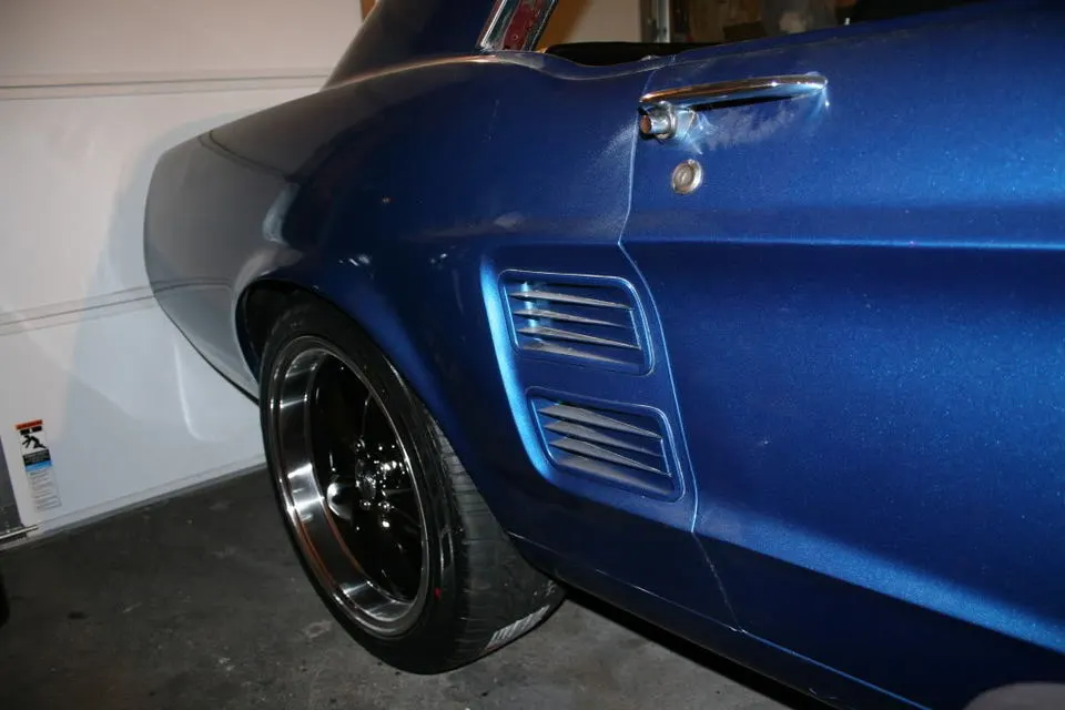

I also spent alot of time and took alot of measurments to find the perfect rims (well perfect for me anyway). They ar black with a pollished lip (the car will be painted gunmetal with a single black stripe...dont mind the blue )
For the rears:
I wanted 18"
As big of a lip as I could find
As wide as I could get
Still be able to tuck in the fender
I wanted 17"
Small lip for a staggered look
No turning issues
Here's what I came up with, 18x9" rears wrapped in 245/45/18 rubber. Front 17x9" on 215/55/17.
Sorry for the crappy cell phone pics, but here's a pic as it sits now, I will be dropping it 2" to get the car sitting right.

I finished properly seating the old girl tonight. 2" drop in the rear and a 3" drop up front. I LOVE the way it sits.
