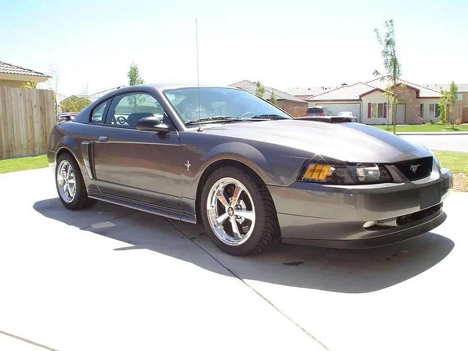

I guess i got lucky. Front dropped more than the rear. In fact i was thinking of taking out the isolaters in the rear to drop the back a bit.
