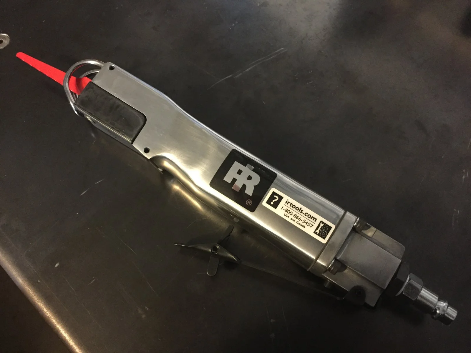

I also grabbed an Ingersoll Rand air body saw that I hope will perform better than the HF electric saw. That should be arriving by the end of this week.

I have the same saw a d i use it every day ,you will like it
It shipped from Dallas, so it arrived rather quickly. This thing is compact! I'm looking forward to trying it out. I mostly bought it so I could make more precise cuts like when I cut the dash to patch the ignition cylinder and radio opening.

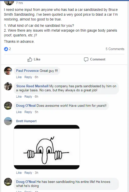

@horse sence @Davedacarpainter Need some advice! I found another local media blasting place that I didn't know about. Tons of five-star reviews from happy customers. I gave the guy a call during which I expressed my concern about metal warping with sand blasting (he doesn't do the dustless type). Well, he swore up and down that he's done "hundreds" of cars without warping metal because he "moves quickly" and doesn't "stay in one spot too long". What do y'all think? Is it worth the risk?
The best part is that he quoted me a price of $350-$500 to blast the whole car. I just have to bring it to him to get it done.
I asked on a local page and am getting only positive feedback so far. Nothing specifically from anyone who had a car blasted, though. Maybe I should just go for it and if anything gets warped, just go ahead and do a fastback conversion? :confused:
I don't know. I should probably just stick with my current plan of replacing the sheet metal and blasting it later on one section at a time with a HF pressurized blaster. Strip large panels with the DA.
