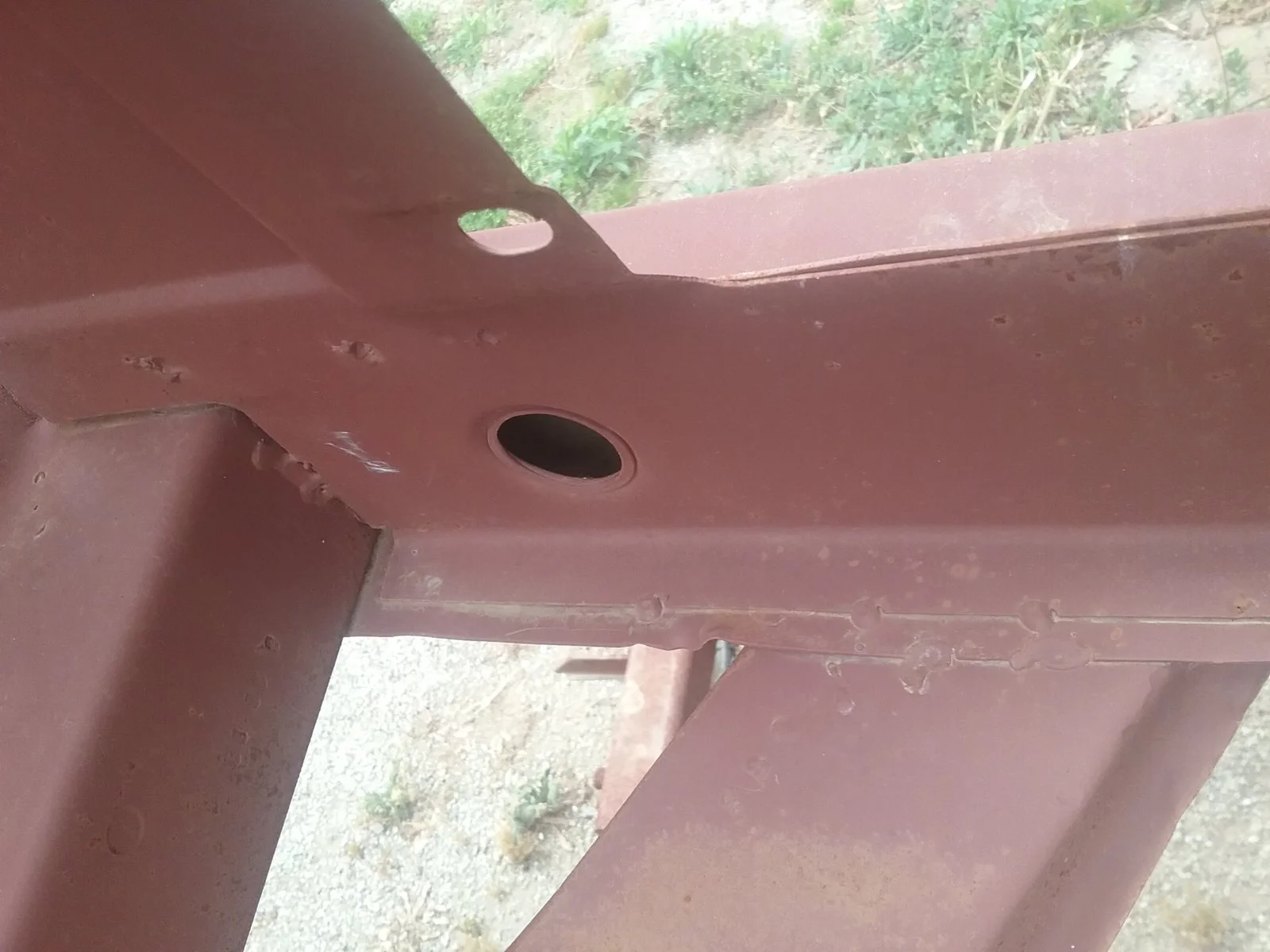

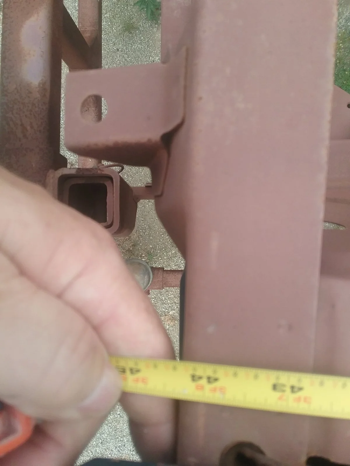

I need some clarification. When you say that I need to support the frame rails and make sure it's level, I had some issues I mentioned before where I tried to get the rear level along with the middle and front of the car. The middle and front were easy to get level, but I wasn't sure where to put my levels to do the same for the rear. I initially put my levels on either side of the fuel tank flange. The showed that the driver's side needed to come up, however, almost as soon as I started jacking the rear driver's frame rail, the car started coming off the stands on the rockers.
So, where do I need to jack the car in the rear to level it, and where is the optimal place to put my levels to ensure it's level out back?
Would it make any difference for the car's rigidity if I installed the new floor pan before doing the rocker patch?

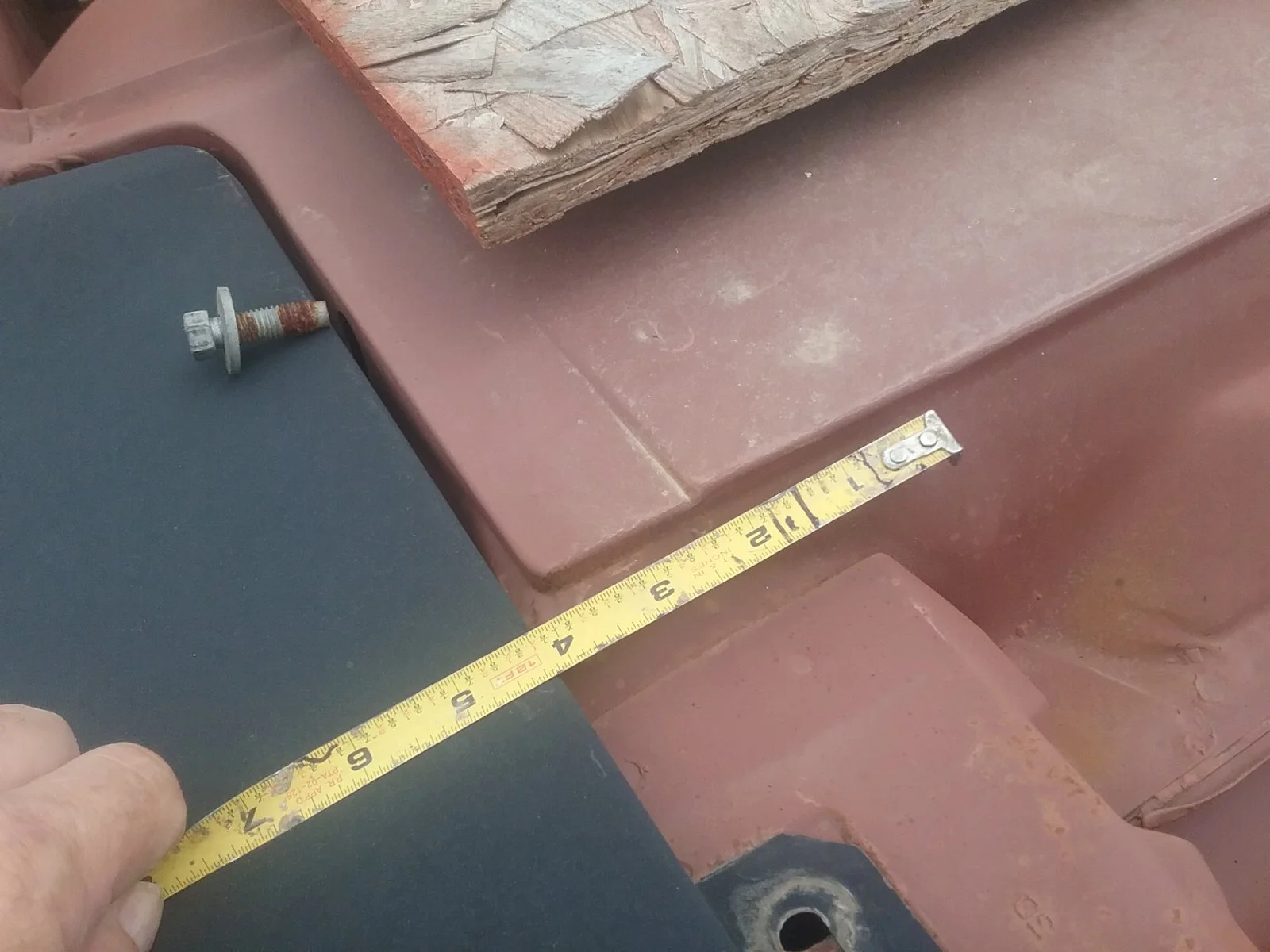

@horse sence Would you be able to get me some measurements off of your coupe (or fastback) for me? I wasn't able to get good measurements from the engine bay or the rear trunk support because of the damage.
I was wanting to try to get measurements from the cowl to the edge of both aprons, across the aprons, and diagonally across if necessary. Not sure where is the best place to measure in the trunk. All I really need is the measurements and the points to and from where they're taken.

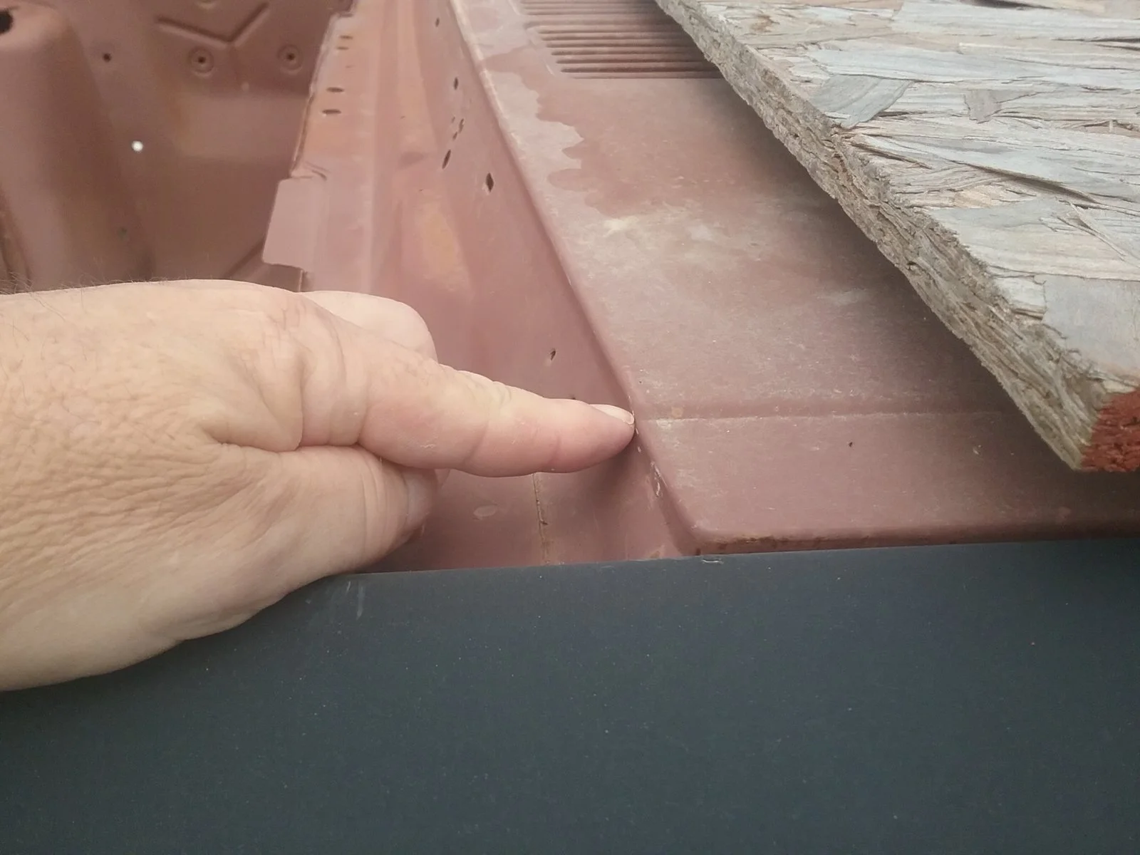

The rear aprons are 4 inches in from the side of the cowl to the flat part of the hinge aprons,not the bevel.
The rear trunk brace simply sets in place with the outer edges meeting the trunk drop off ,dont have a pic but set your new one in place and you will see

I can’t find two-piece front torque boxes anywhere for ‘65-‘66. Only ones I can find that aren’t welded already are ‘67-‘68 torque boxes. Is there any difference in the torque boxes for those model years? Seems like everyone who buys the welded versions has to cut them apart to get them to fit correctly.
Edit: I also need to ask, how difficult is it to install torque boxes on a car that didn't have them originally? It looks like the best time to install them would be when I patch the toe boards?
