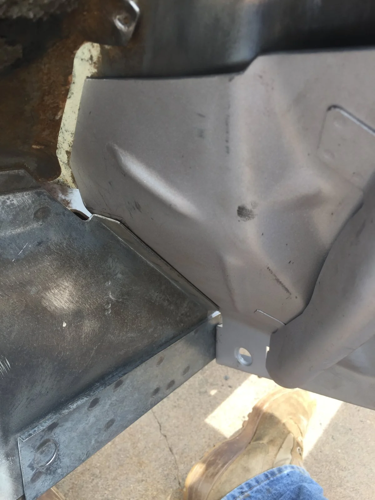

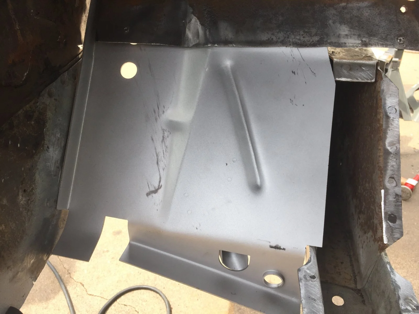

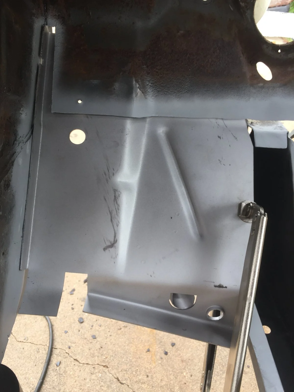

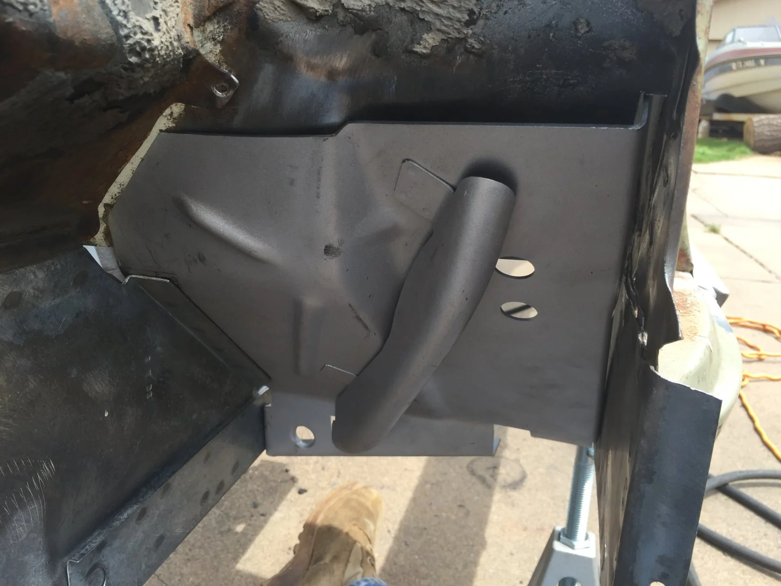

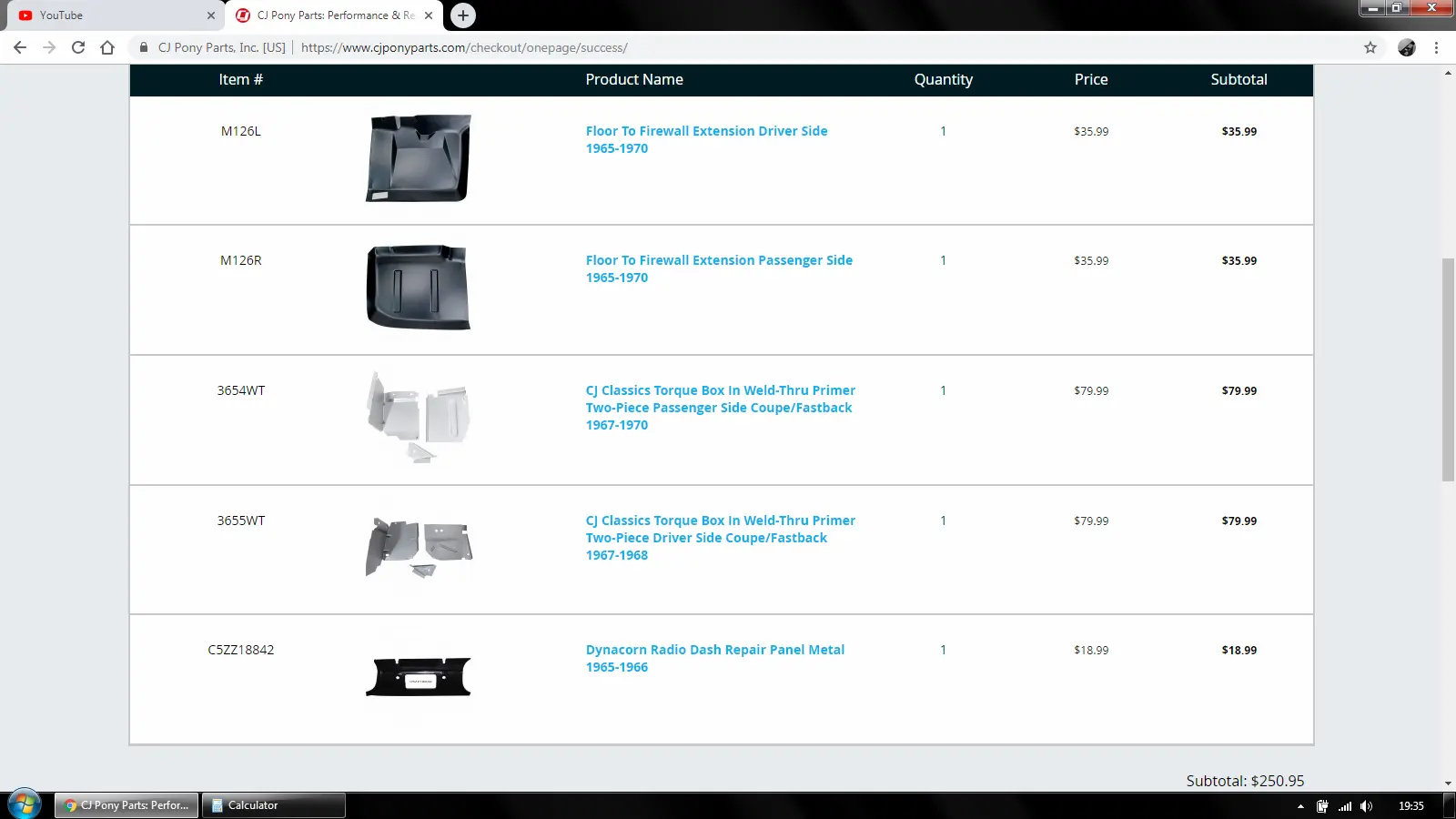

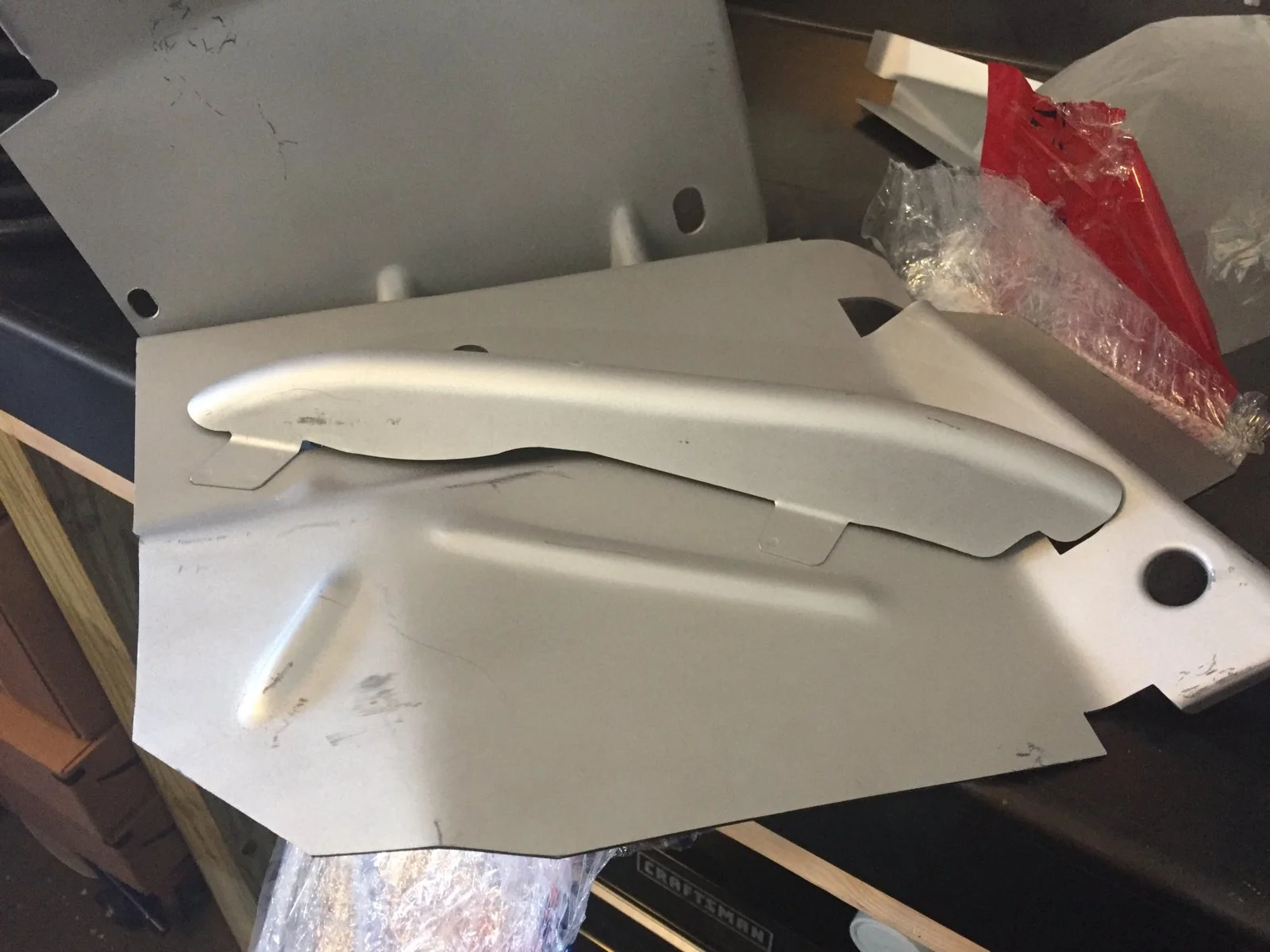

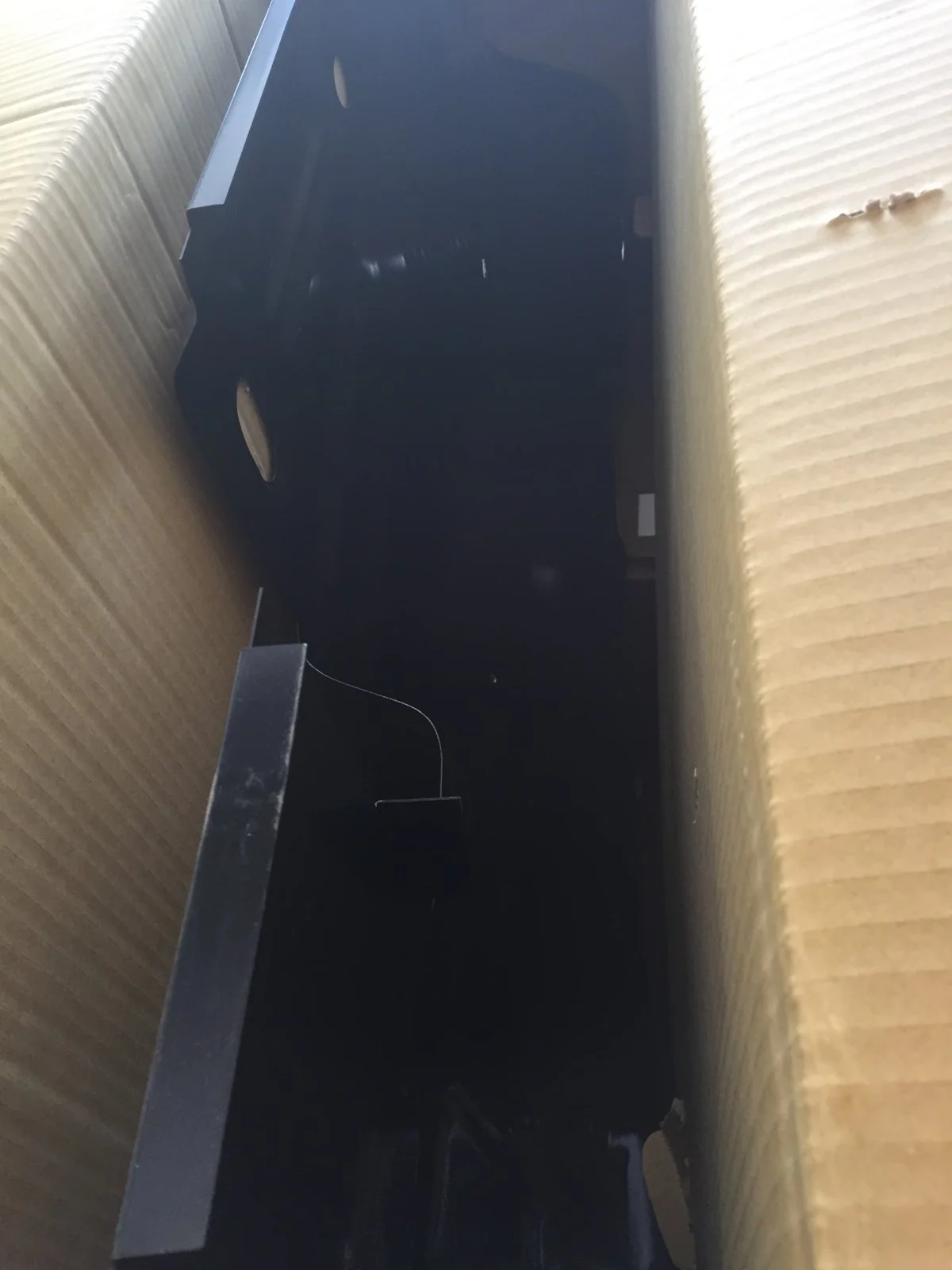

Sheet metal arrived. CJ appears to have sent a drivers side torque box for ‘69-‘70 though it was labeled as ‘67-‘68. Can I use this anyway, or should I send it back?

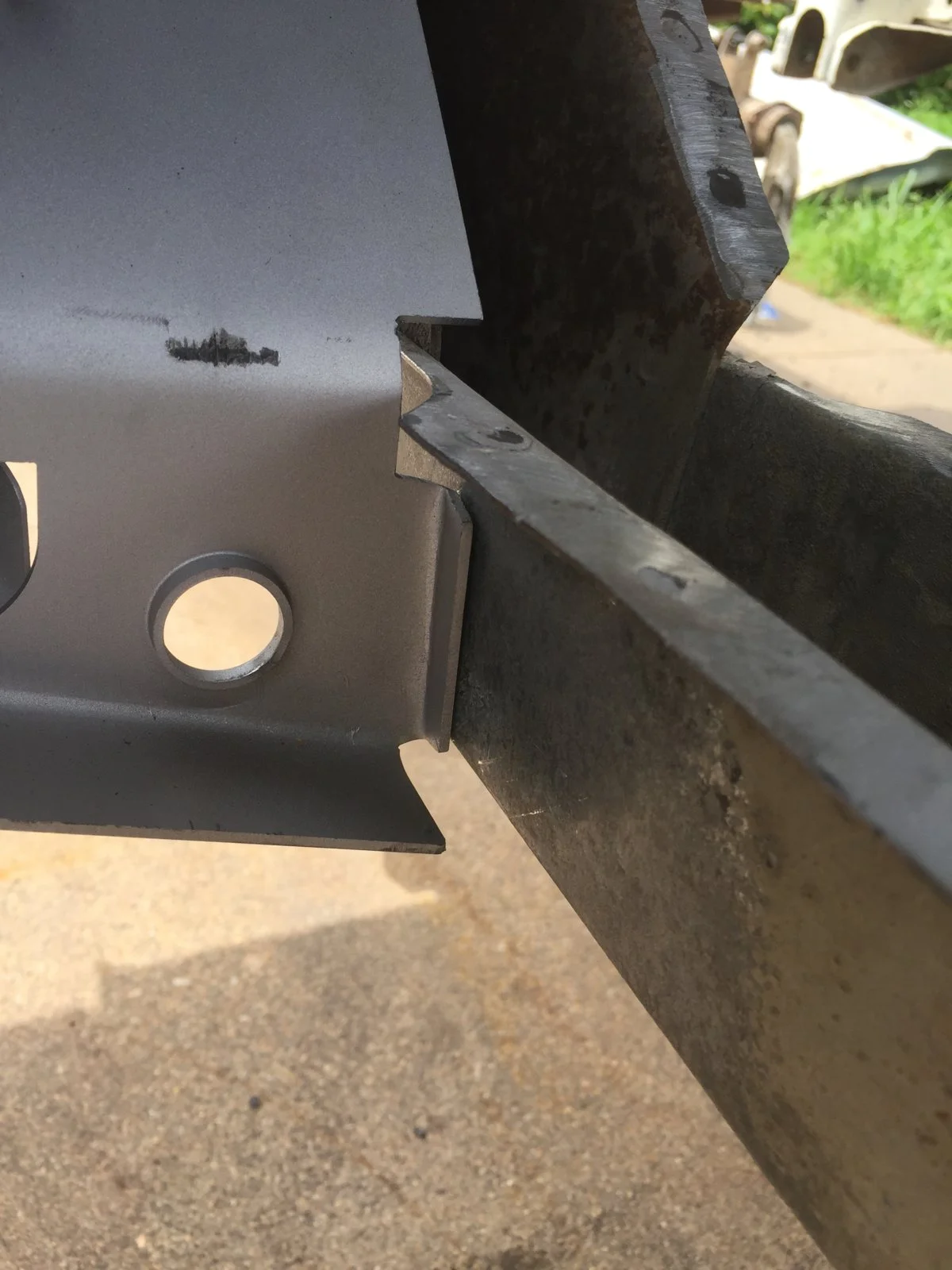

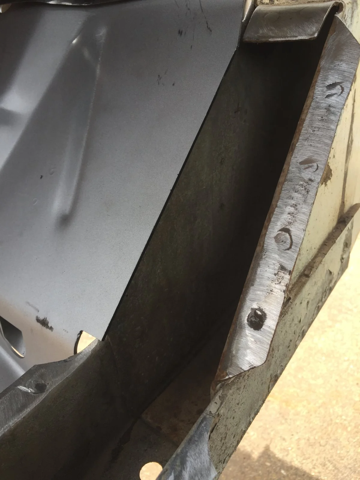

@horse sence Need some help. I’m trying to fit this driver’s torque box and it’s not lining up against the rocker. See my question above. They send a ‘69-‘70 torque box with the parking brake cable tube. Can I use this, or do I need to send it back?
35ECB3F7-0A15-4A1A-B7E0-D0BA38172C41.webp 61380D47-7F98-46C5-9142-F0437B10A5A2.webp 82951FBA-02D5-48E5-8806-2586785C26AD.webp AE76A51B-883A-40AD-962D-0F429627355D.webp 8FA44D54-D20F-455B-BC71-221067D4B0AD.webp
Reactions: 2Blue2

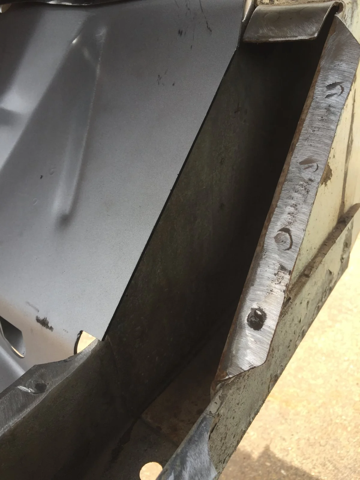

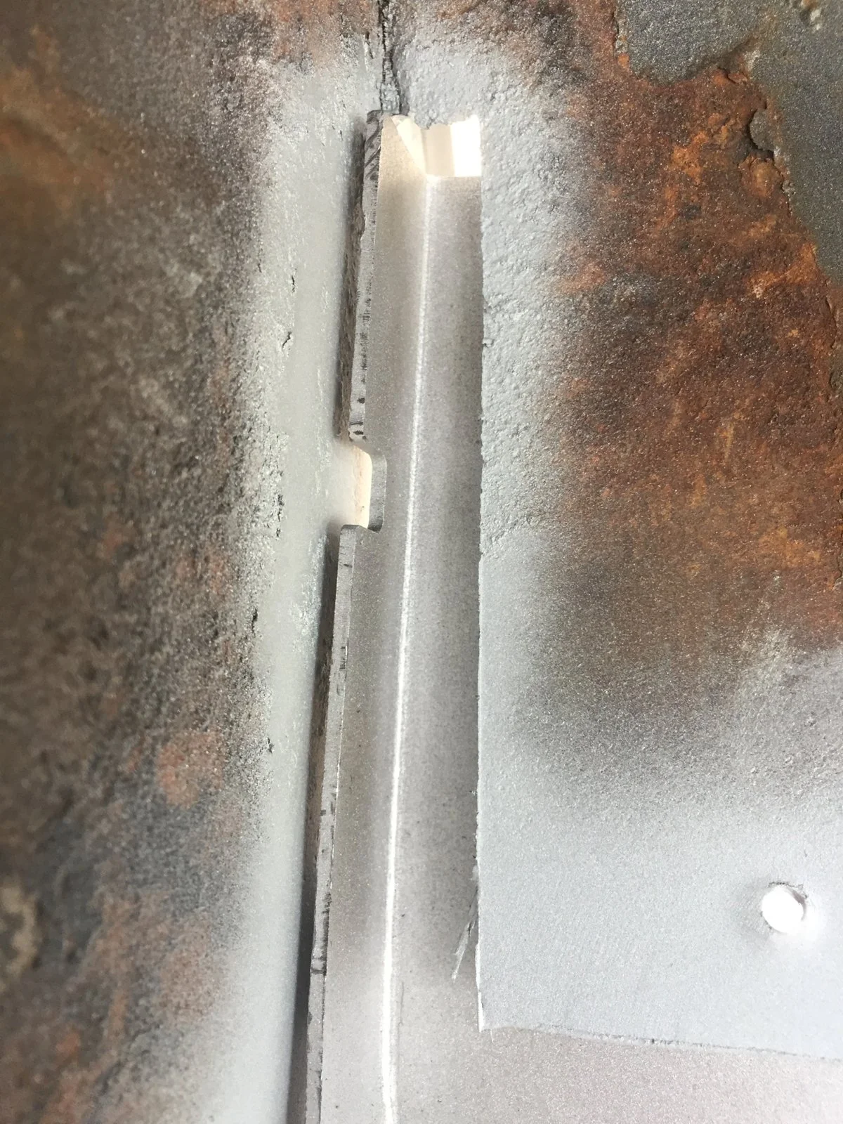

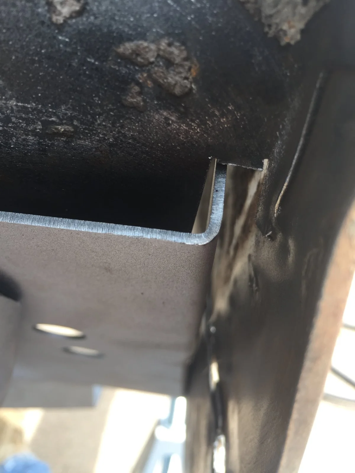

I was able to figure it out. There is, however, a gap at the top of the outer torque box when I put it in place.

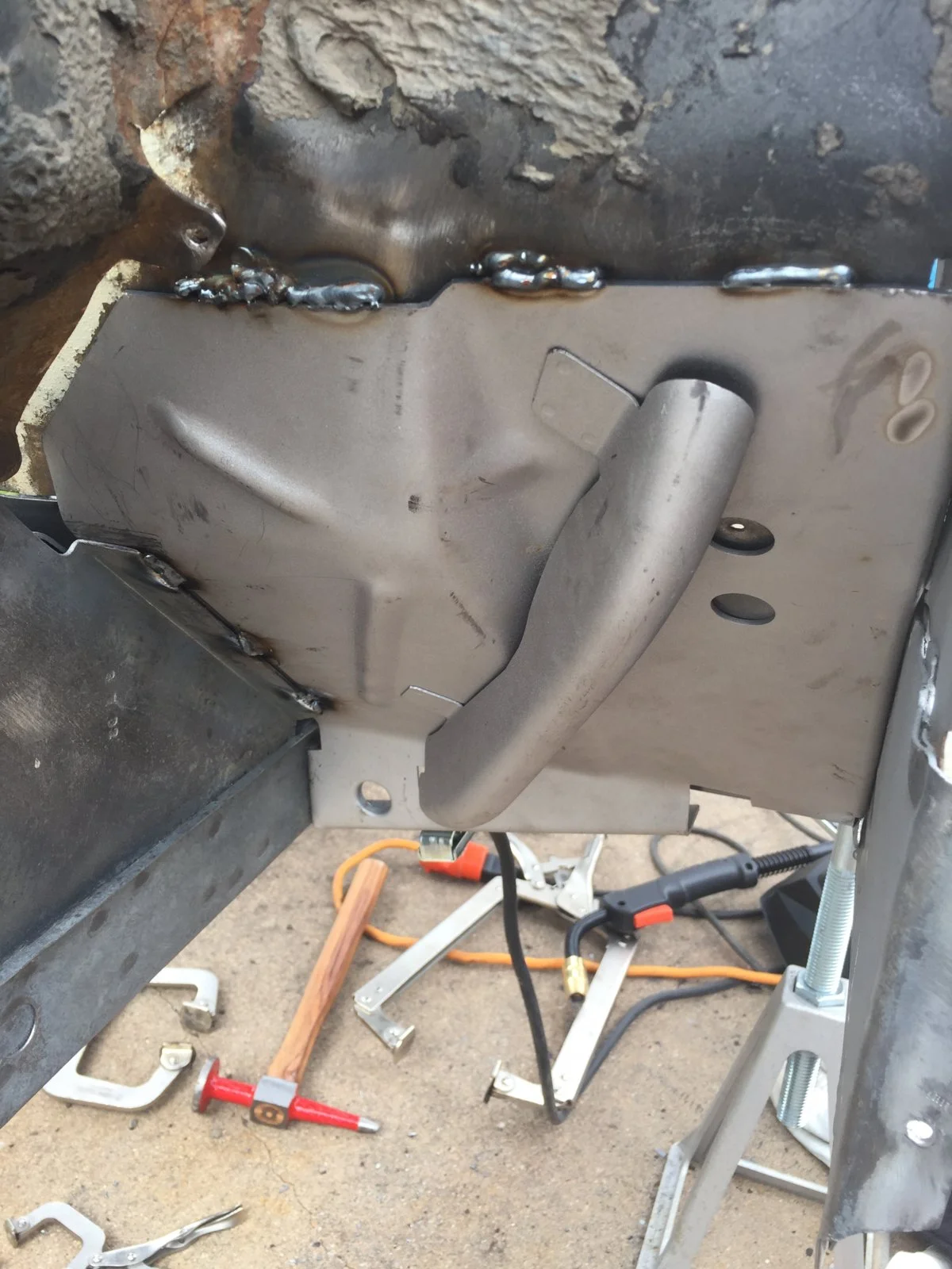

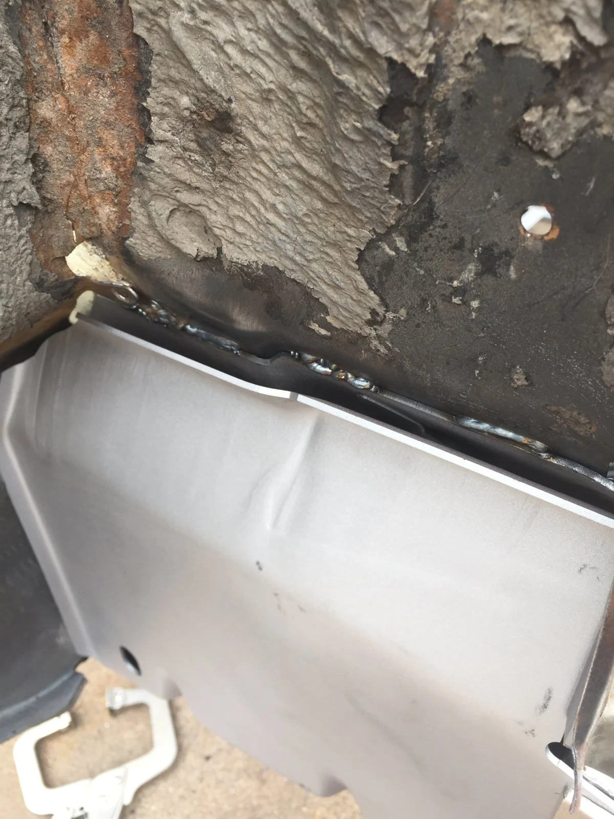

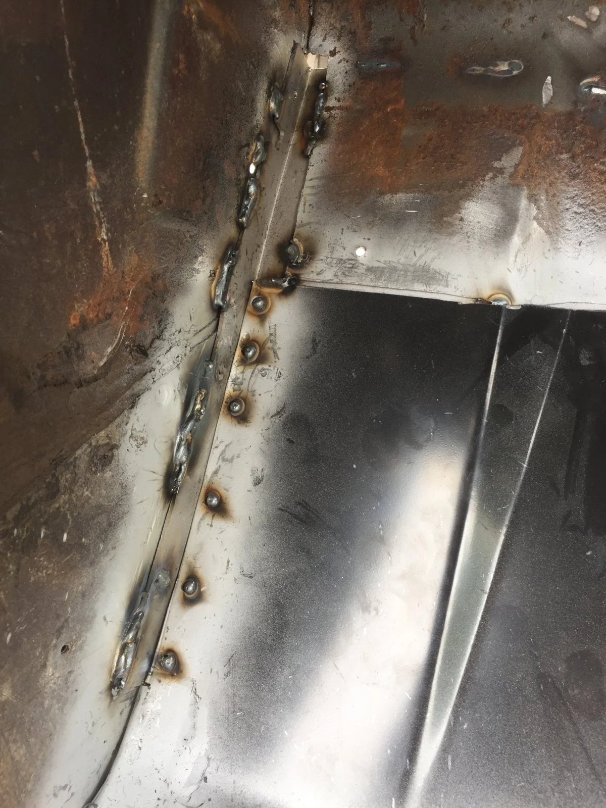

My welds are kind of ugly, but functional for the most part. I’m struggling to get the settings right.
