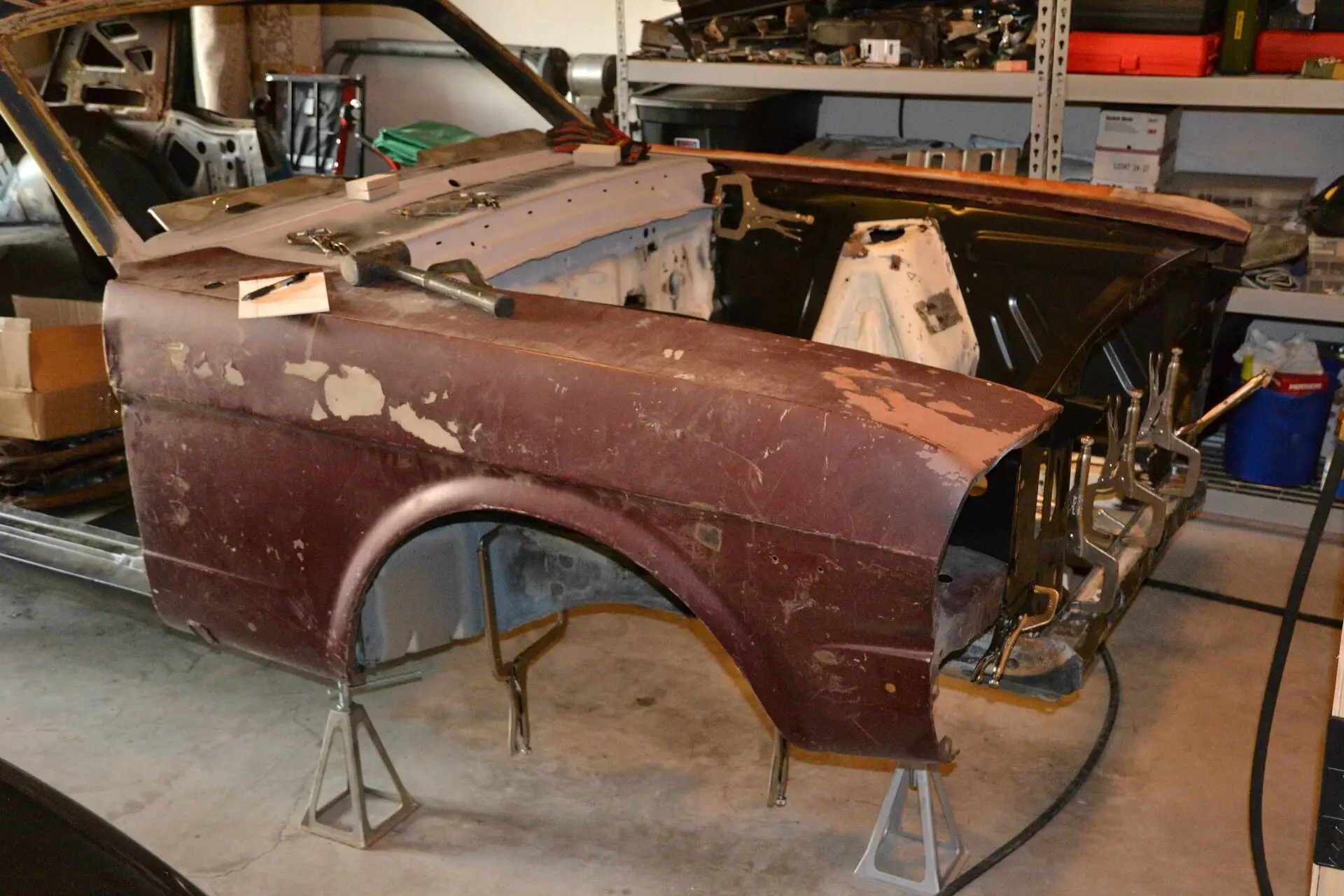

The replacement passenger fender apron arrived yesterday. I spent some time fitting it today. I was able to get the measurements from the cowl to the front of the firewall pretty close. The new apron is a nice thick gauge metal, but I'm thinking it isn't Dynacorn. The driver's side apron is a much sharper stamping with a lot less wrinkling. The new one is also one piece where the driver's side is two pieces spot welded together.

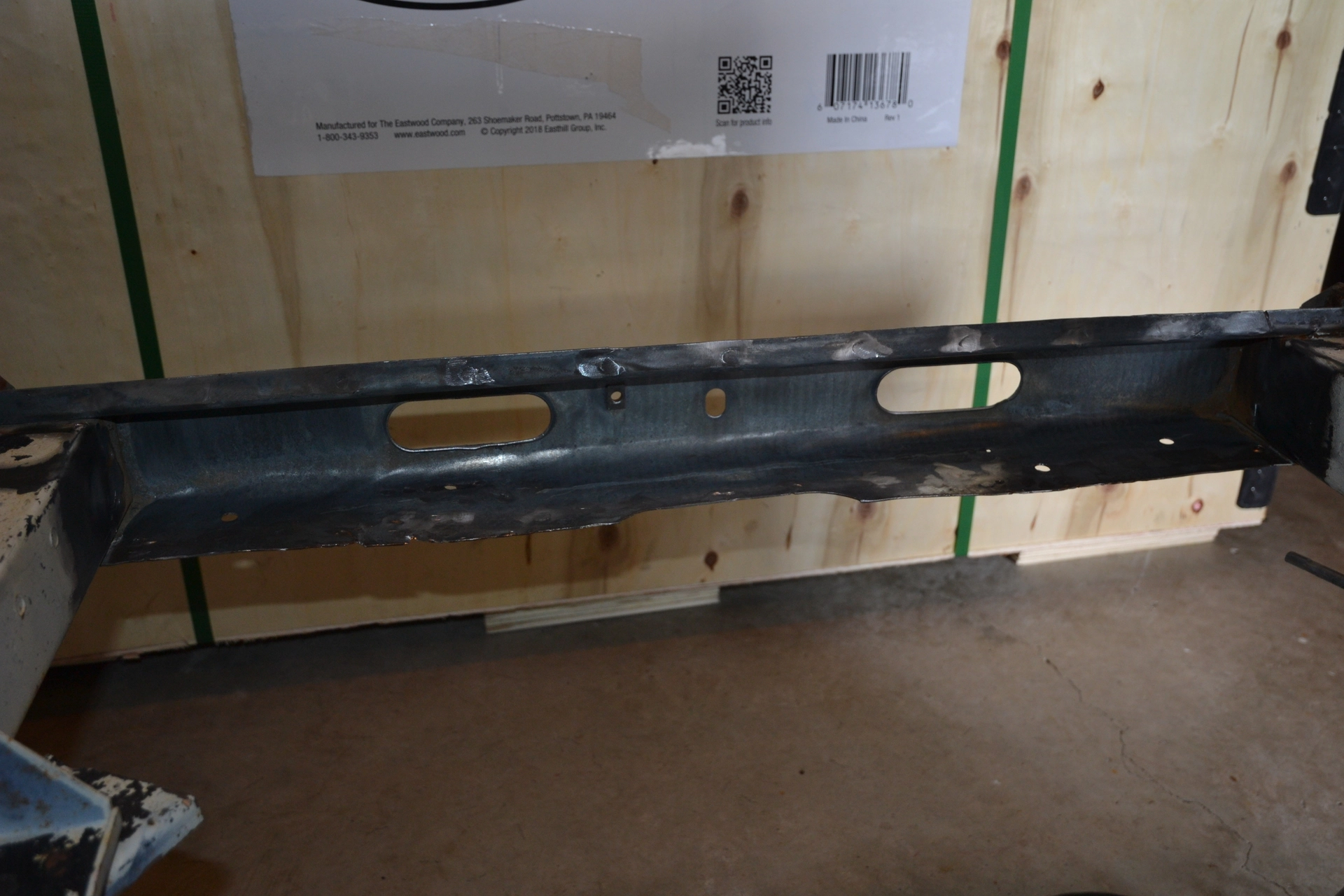

I was able to get the crossmember pretty straight.

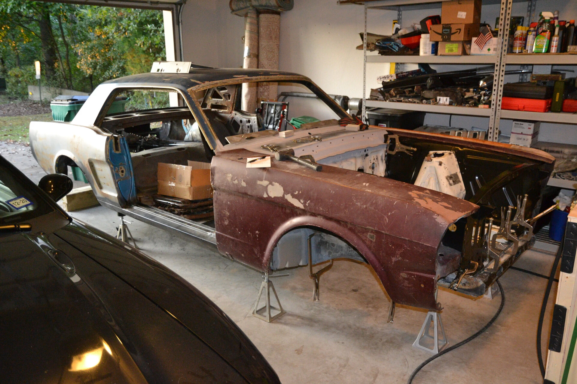

After straightening out the crossmember, I refitted the aprons and radiator support. I brought out the fenders to see how it all looked. I picked up these fenders in Dallas as a set along with a hood from a '66 GT. They're in better shape than my originals, but they'll still need some work.

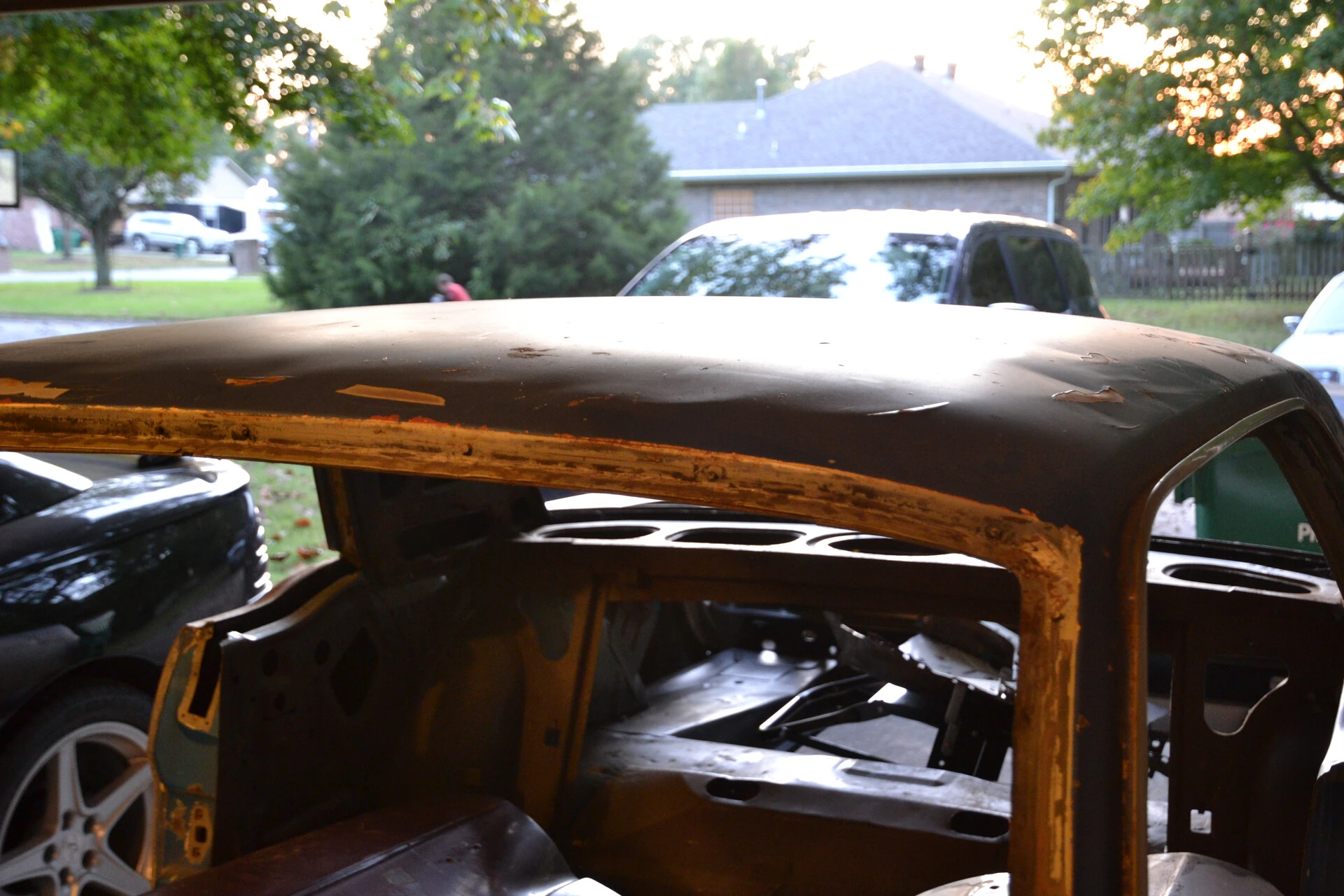

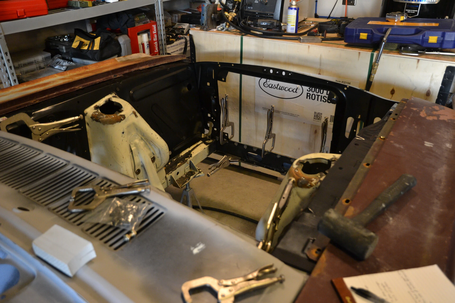

In other news, the roof is in a bit of a sorry state. This is what happens when your father-in-law uses a car as an ad hoc storage unit. How would the body wizards among you handle this?

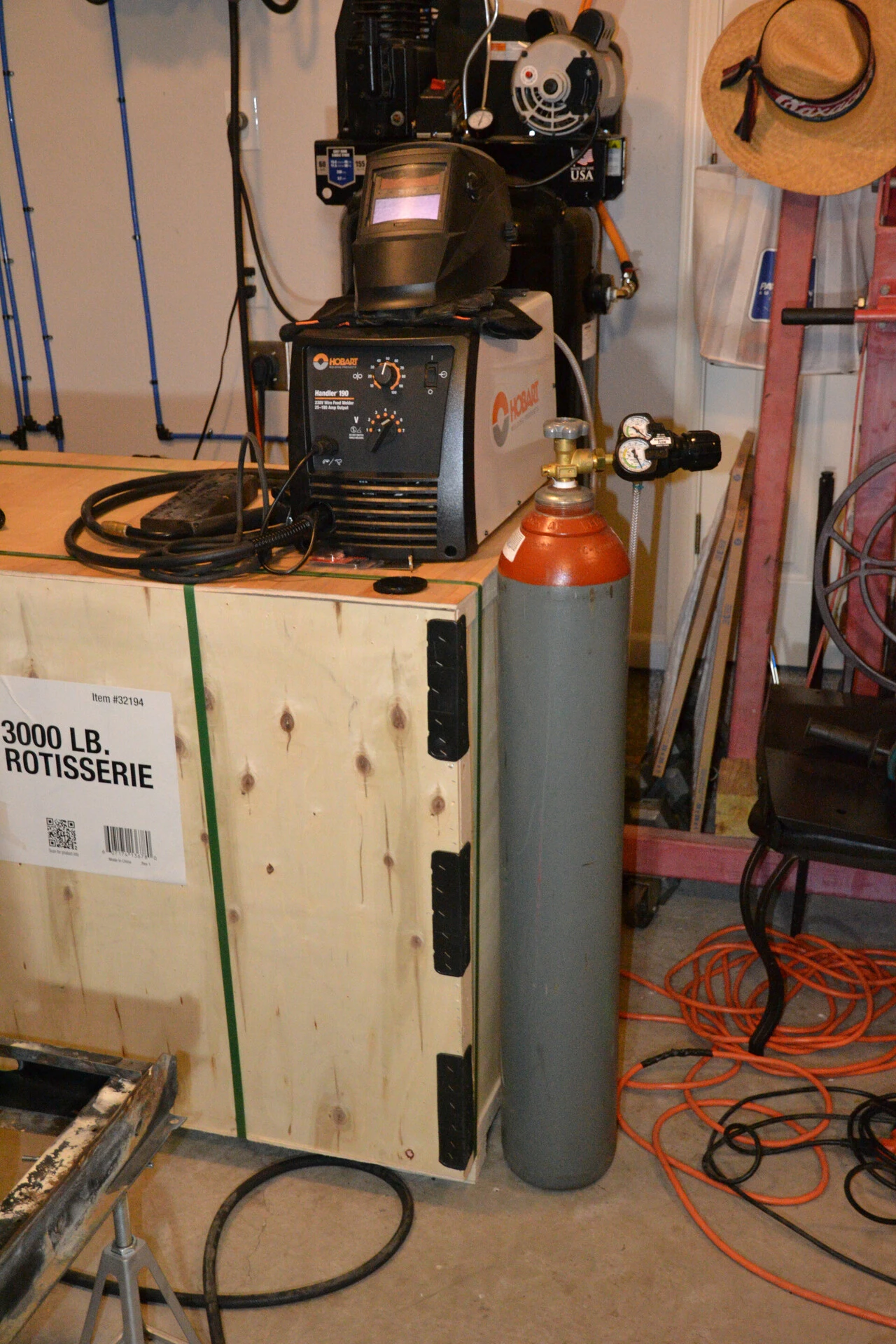

Minor progress today. Spent part of the day picking up a gas bottle for the welder. After that, I decided to go ahead and remove the factory sway bar mounts along with the small part of the shock towers that is sandwiched between the bottom corners of the aprons and the frame rail. As I've mentioned before, I'm going to be installing an IFS on this car at some point.
The new regulator is sturdy and fancy.

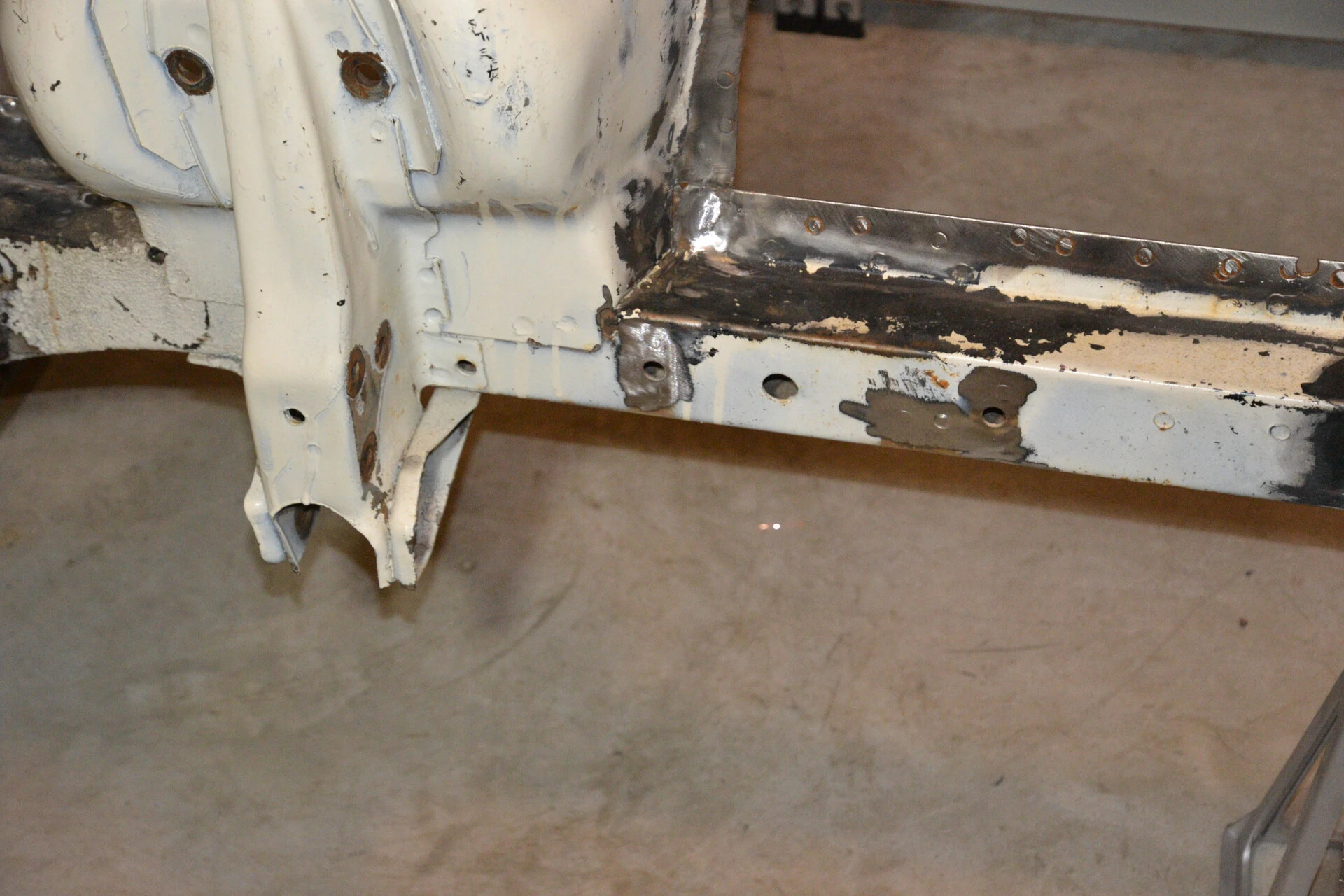

While under the car, I noticed that there is even more accident damage to the lower control arm mounting point I hadn't noticed before on this side. I'm glad I'm just going to be pulling all this out.

A little tweaked, but I honestly doubt it would make any real difference with the way the LCA on these is designed...nothing that couldn't be aligned out anyway. I cut out the shock towers on my last '66, but I don't think I would ever do it again. What I would do is replace the '66 towers with 67+ towers...I have seen a 5.0 Coyote fit between those...really limits you on headers and the like...but I am pretty sure you could get end up with a completed swap if you were determined to keep the shock towers.
I don’t know. I’ve been spoiled by all the room on the sides of the engine in the fox platform and my Mercury.
I’ll give it some thought. I have plenty of time to think it over.

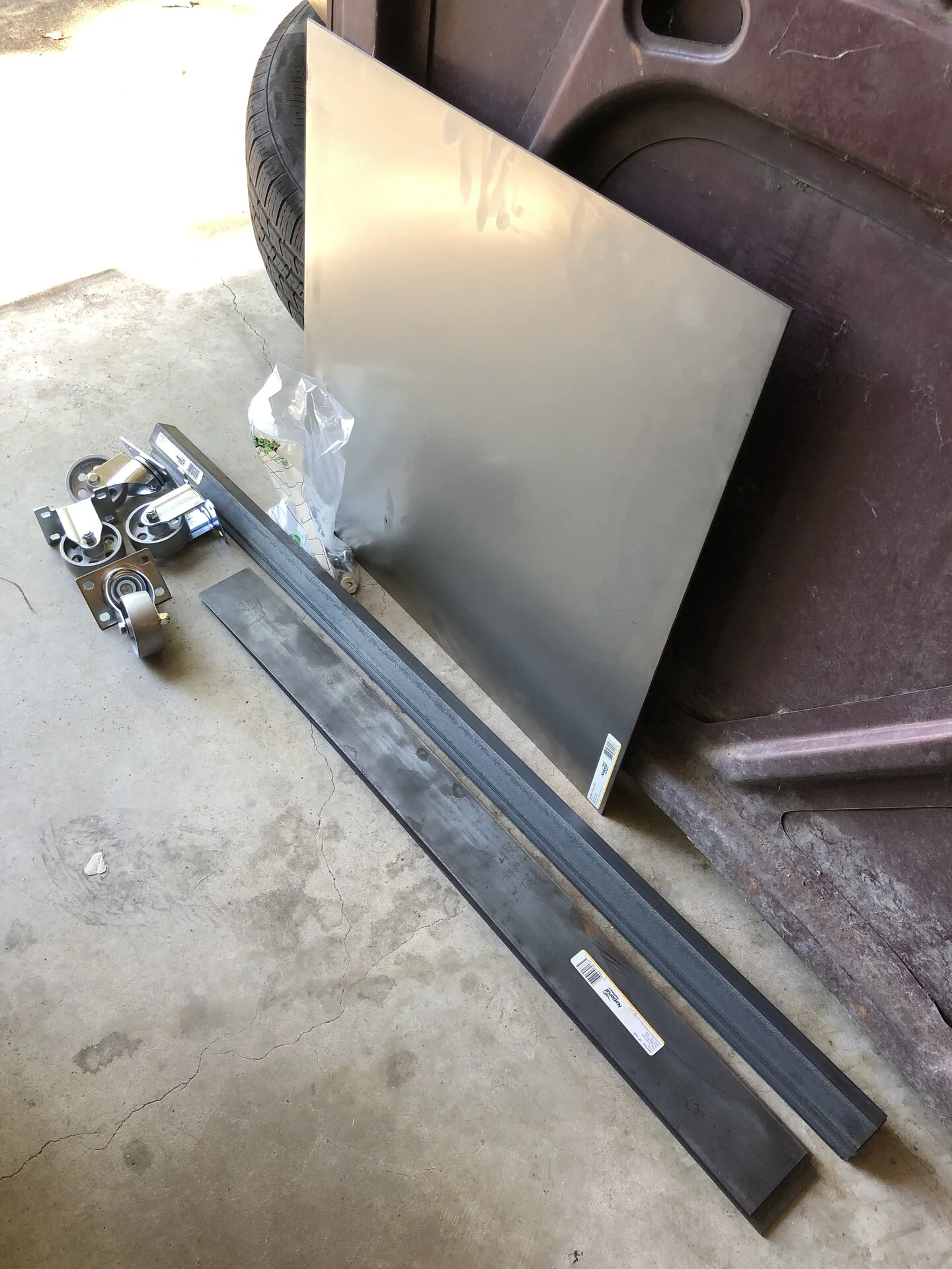

I at least got the bottom tray done. I may not have enough angles for the sides of each tray. I may have to improvise if I can’t get some more tomorrow. I think I bought all TSC had.

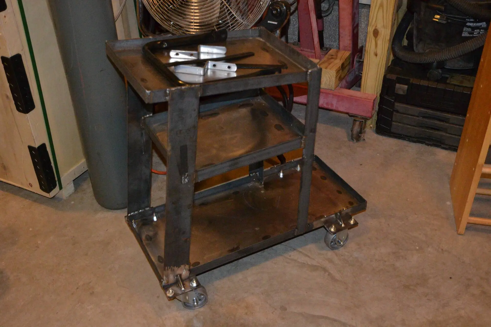

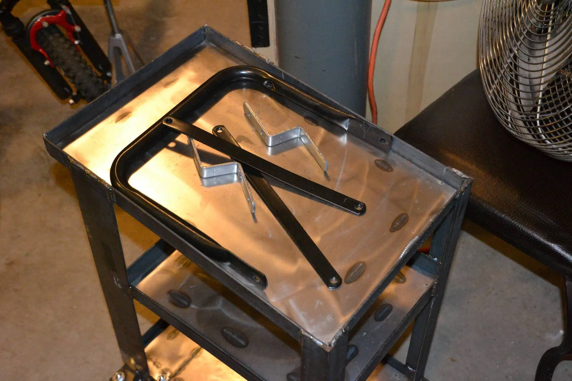

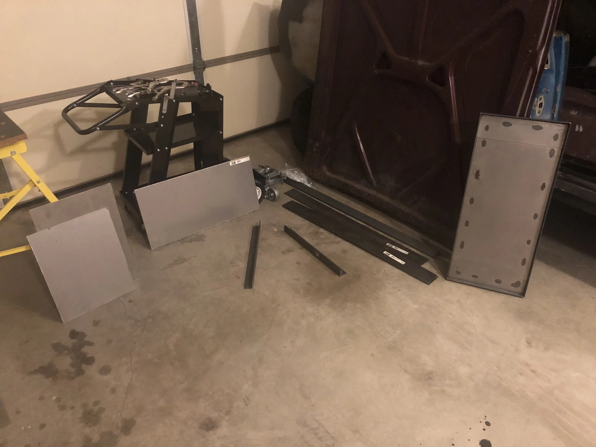

Going to hopefully finish the cart tonight. I had a plan of how I wanted to secure the bottle, but I got an idea and decided to purchase one of these instead.
I can weld it directly to the cart. It ought to keep it pretty stable. Once it’s complete I want to look into a way to store the 100’ extension cord I have on the back end.
The cart is 95% done. I just need to finish up some finer details and then paint it. That'll have to wait until the bottle holder arrives on Saturday.
I probably could have completed this much sooner. However, I was taking my time since this is my first real welding project besides plug welding on the Mustang.

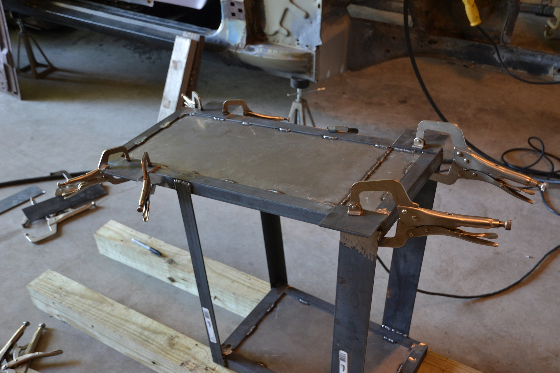

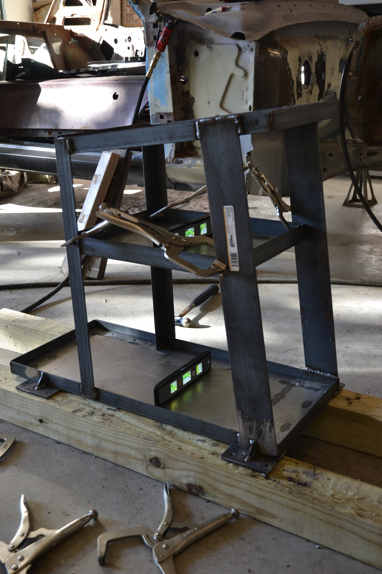

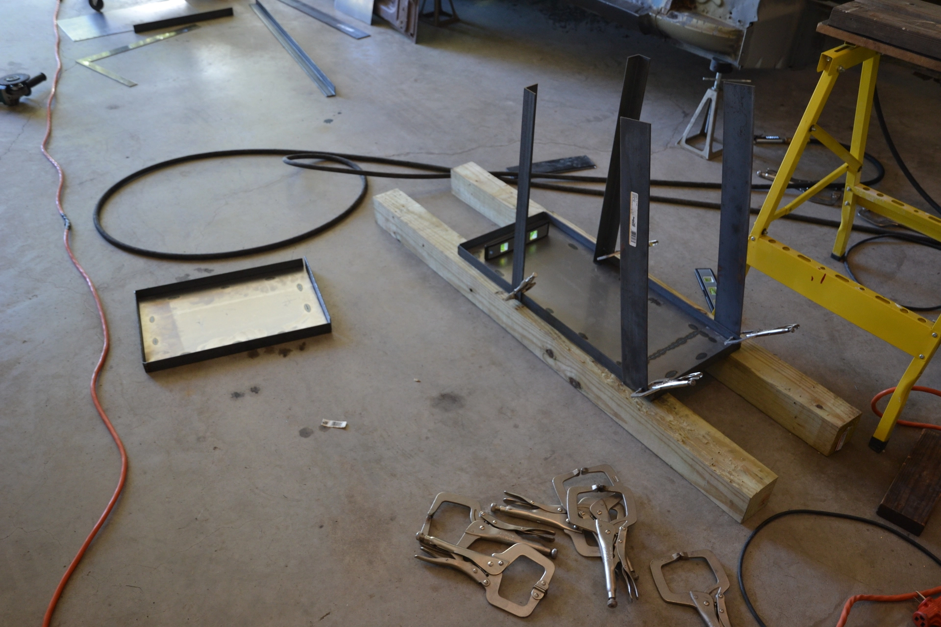

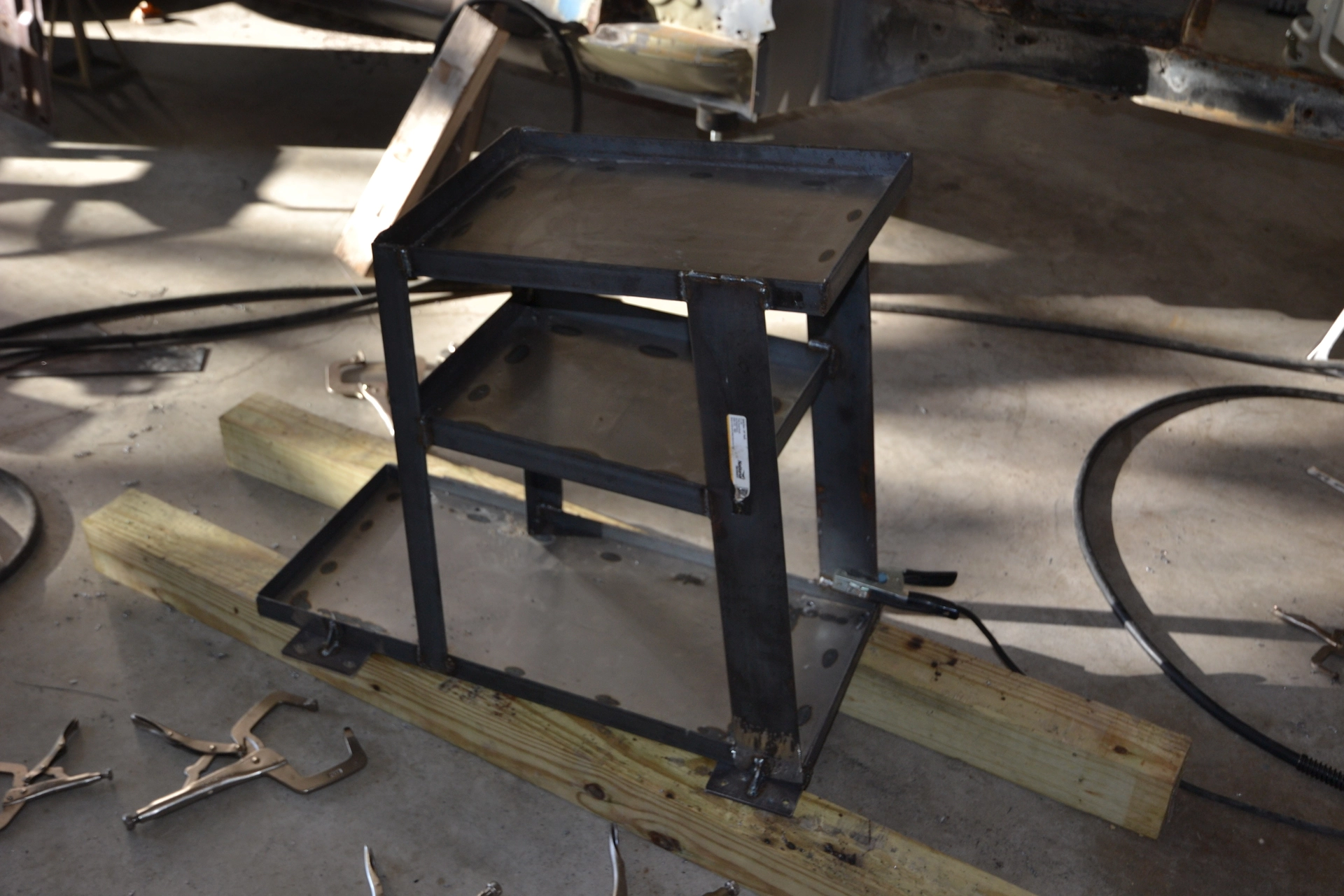

Got the top tray built. Getting the uprights situated so I can get the top tray welded in place. I actually made a mistake with the top tray. The Chinese cart is open on the front of the tray. I built it with four angles and made it enclosed. It's not long enough to fit the welder, so I'm going to have to cut the upright portion of the front angle.

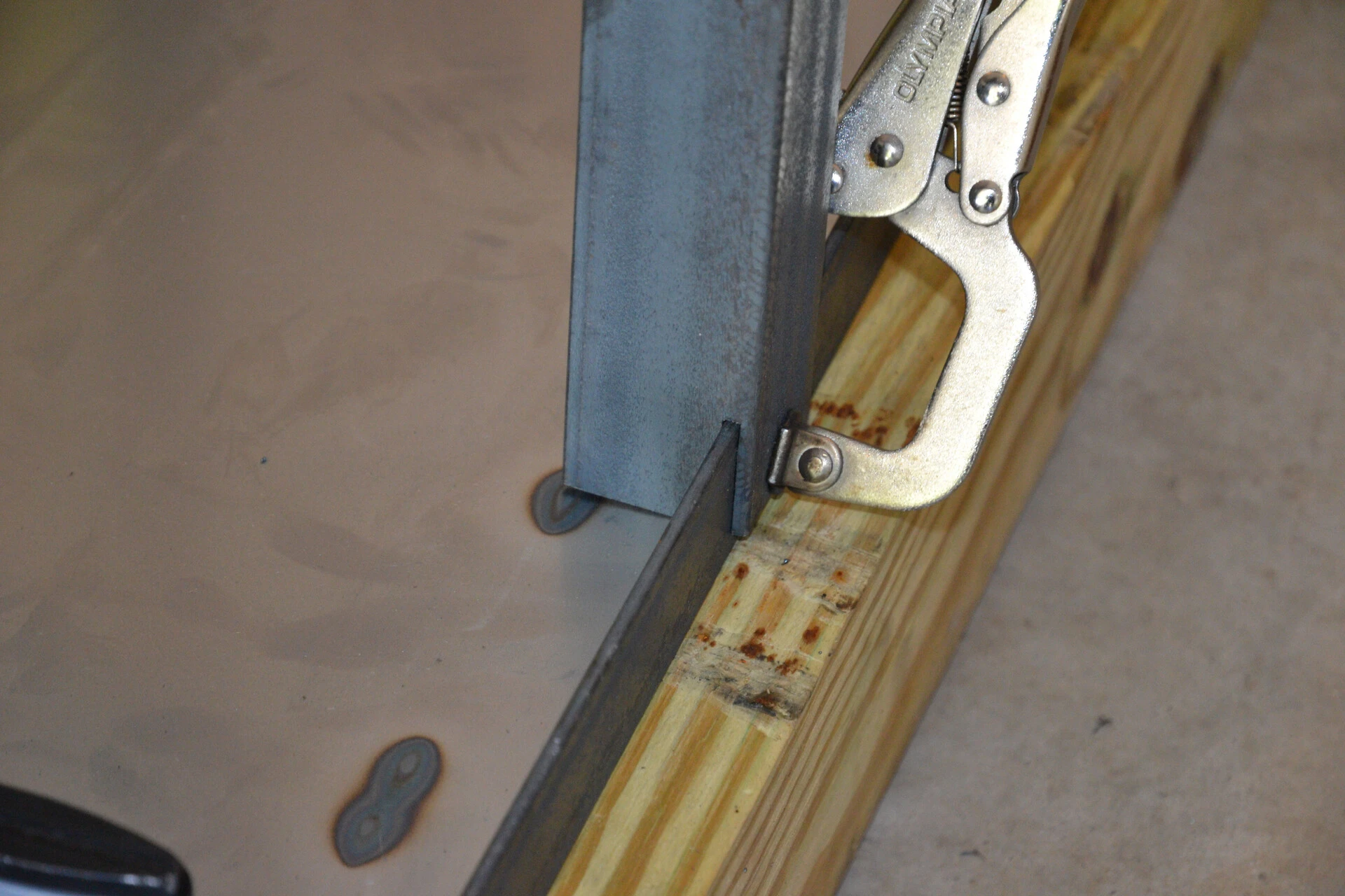

I decided to notch the angles in the rear so I could get as much weld area as I could.

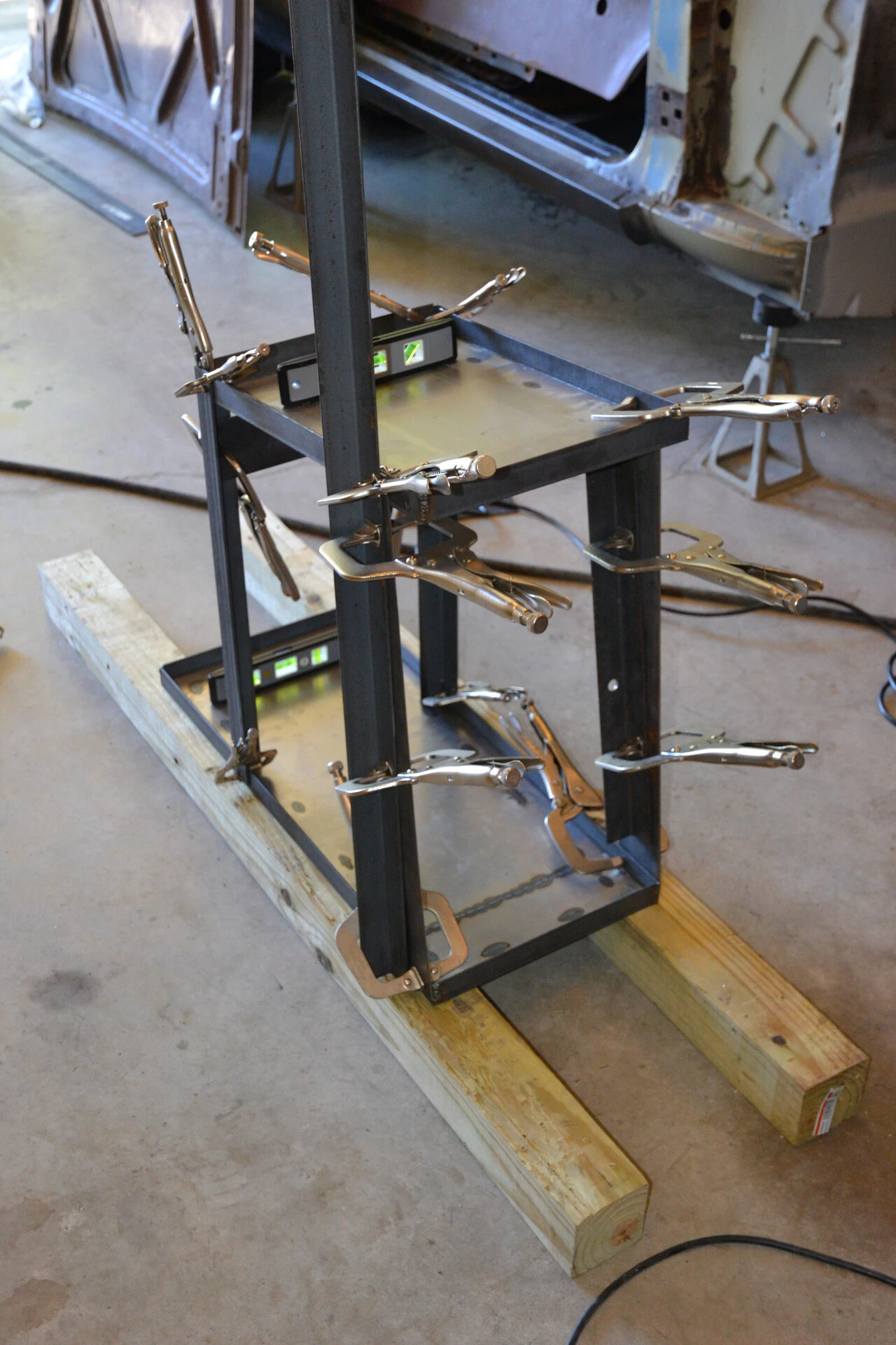

I got everything clamped in place. I ended up clamping the remaining angles I had to the front straight pieces since they had a little bit of a bend that was skewing things.

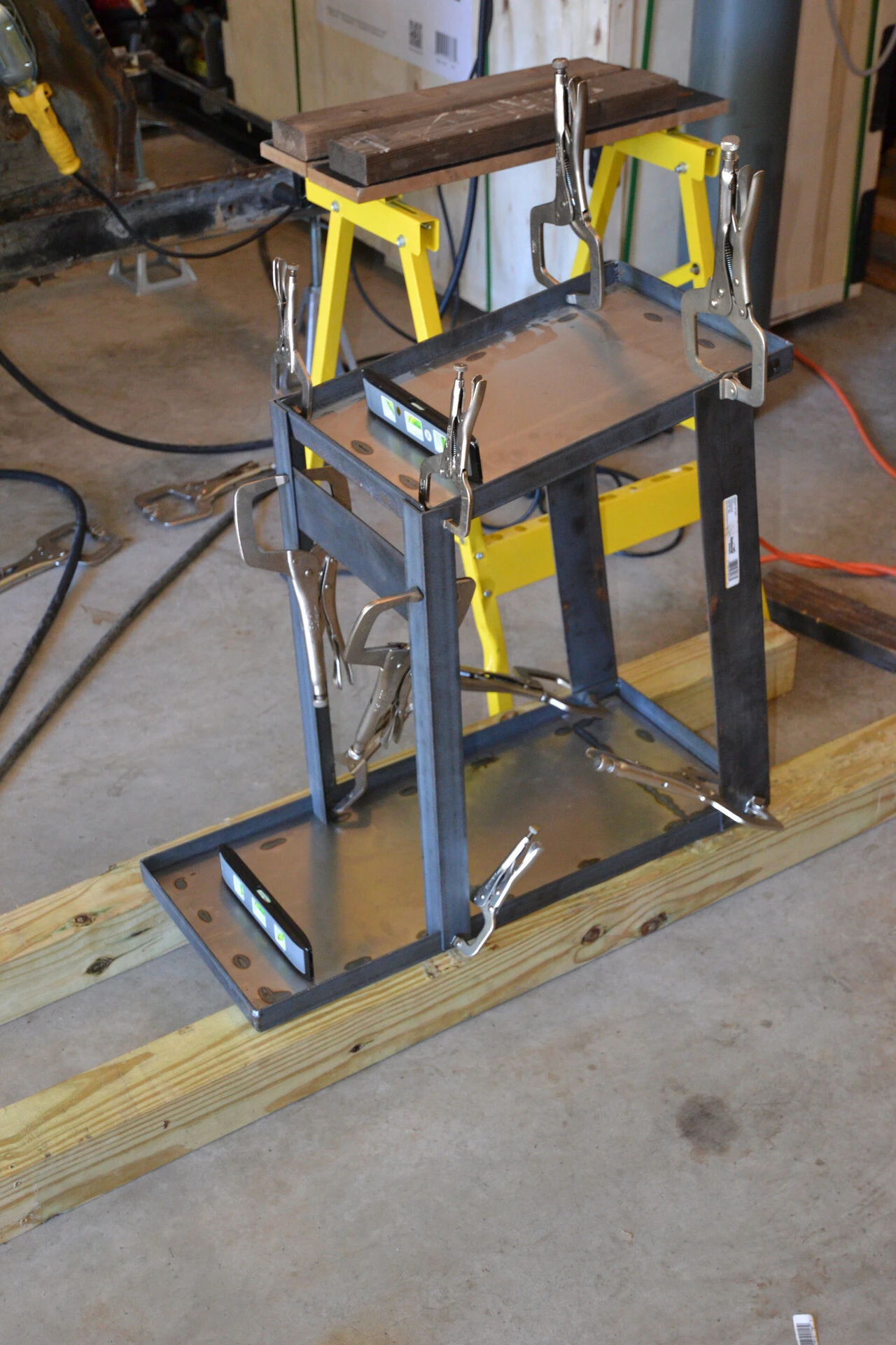

Got that done and moved on to the caster mounts. I was initially going to weld them on the outer edge of the cart body with gussets for support. I ended up deciding against that and welded them partway underneath the cart. I still added small angles for gussets. Two bolts for each caster go into the bottom tray area. This will give it much better support when it's loaded down with the welder, bottle, 100' extension cord, and whatever else I happen to put on it. I'll probably store my clamps on the bottom tray. The caster mount pads are 3/16" plate.
With that out of the way, I built the middle tray and clamped it in place. I had already drilled the holes for the casters at this point. Boy was that tedious.
@Noobz347 For some reason, the forum wouldn't let me post this as one post. I didn't get any error message saying I had too many images or anything. :shrug:
All done with the casters installed. I still need to grind welds and sharp corners down in some places. This ended up turning out much better than I expected. I was worried that it would be tweaked somehow and never sit straight. Thankfully, the combination of a lot of clamps, prodigious measuring, and some levels gave me a result with which I'm very happy. This is straight as can be and rolls very nicely. I may change out the casters in the future for polyurethane. We'll see.
I took a few bits off the old cart that I'm going to reuse. The bend pieces were bolted to the side of the old cart for places to hang the ground and gun leads. I'm going to weld them to the front straights on the new cart. The front handle and its supports will also get welded to the new cart. I couldn't be happier.
The only other things that remain are to grind the aforementioned sharp corners and welds that need it and to weld on the bottle holder when it arrives. I will also likely add an 11-gauge 3"-wide flat piece to the bottom underneath where the bottle will sit for extra support since it will only be sitting on the 16-gauge that comprises the bottom of the trays. I would have bought 14-gauge, but 16 was the thickest TSC had.
