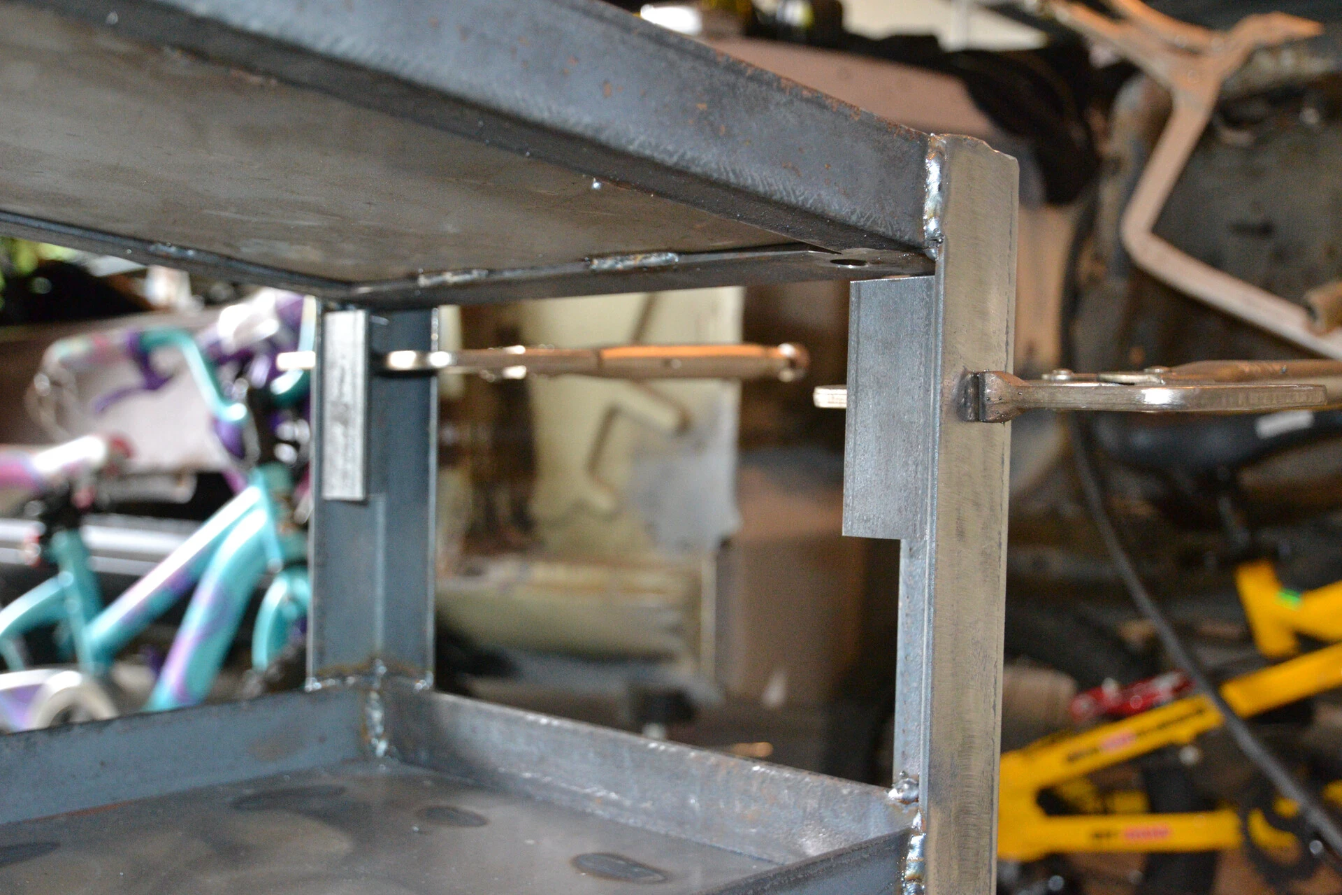

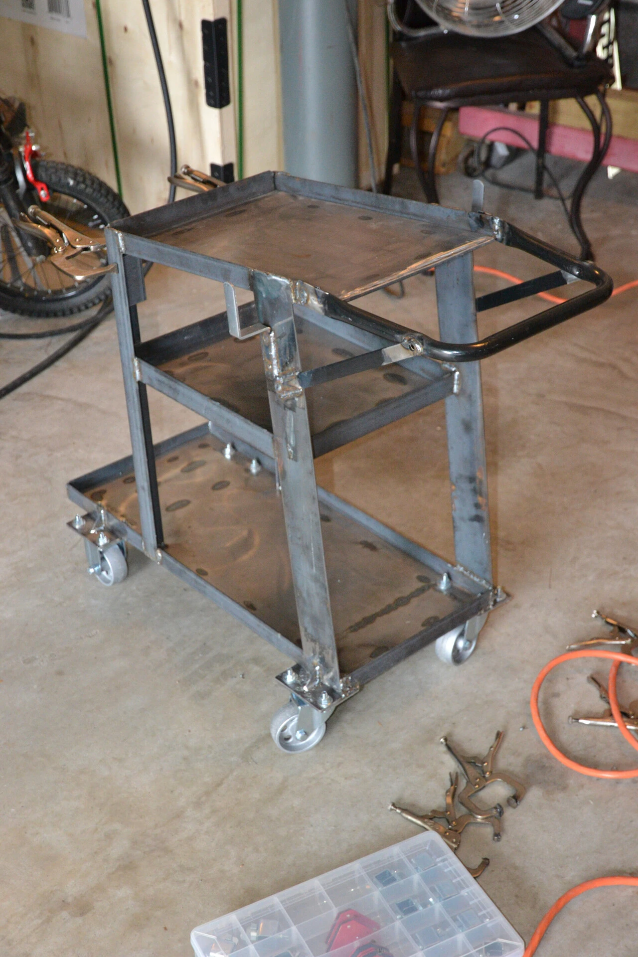

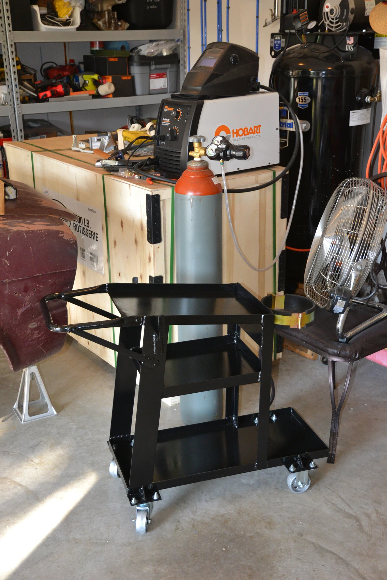

Spent the last couple of days putting the finishing touches on the cart. Welded the components I salvaged from the old one yesterday.

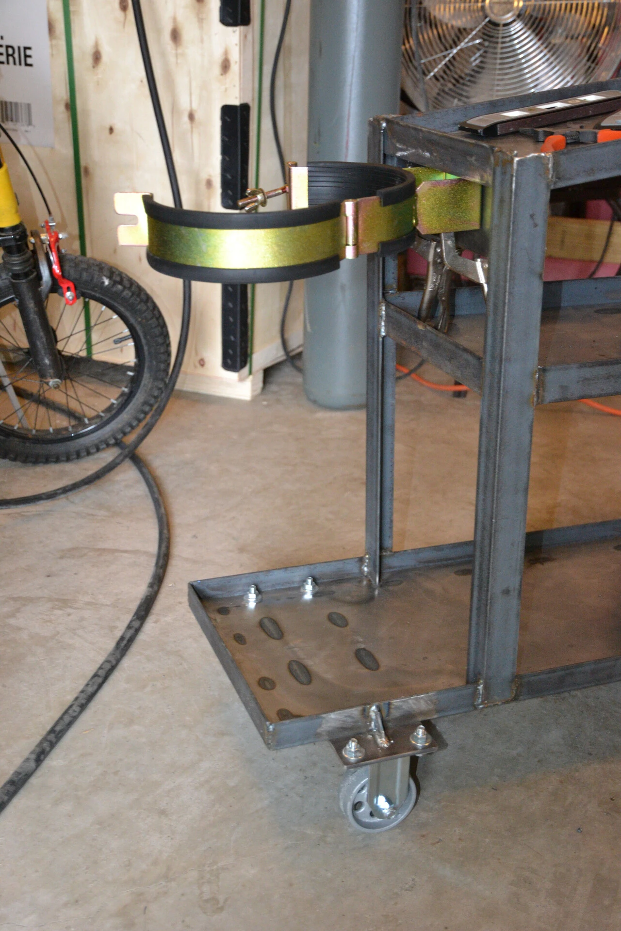

I use a coupe of short lengths of angle I had leftover to build a standoff for the bottle holder. The mount is deep to allow long bolts to be use to secure it. I didn't feel like cutting and welding it back together.

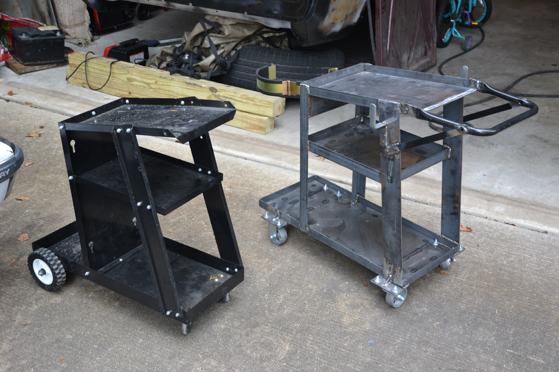

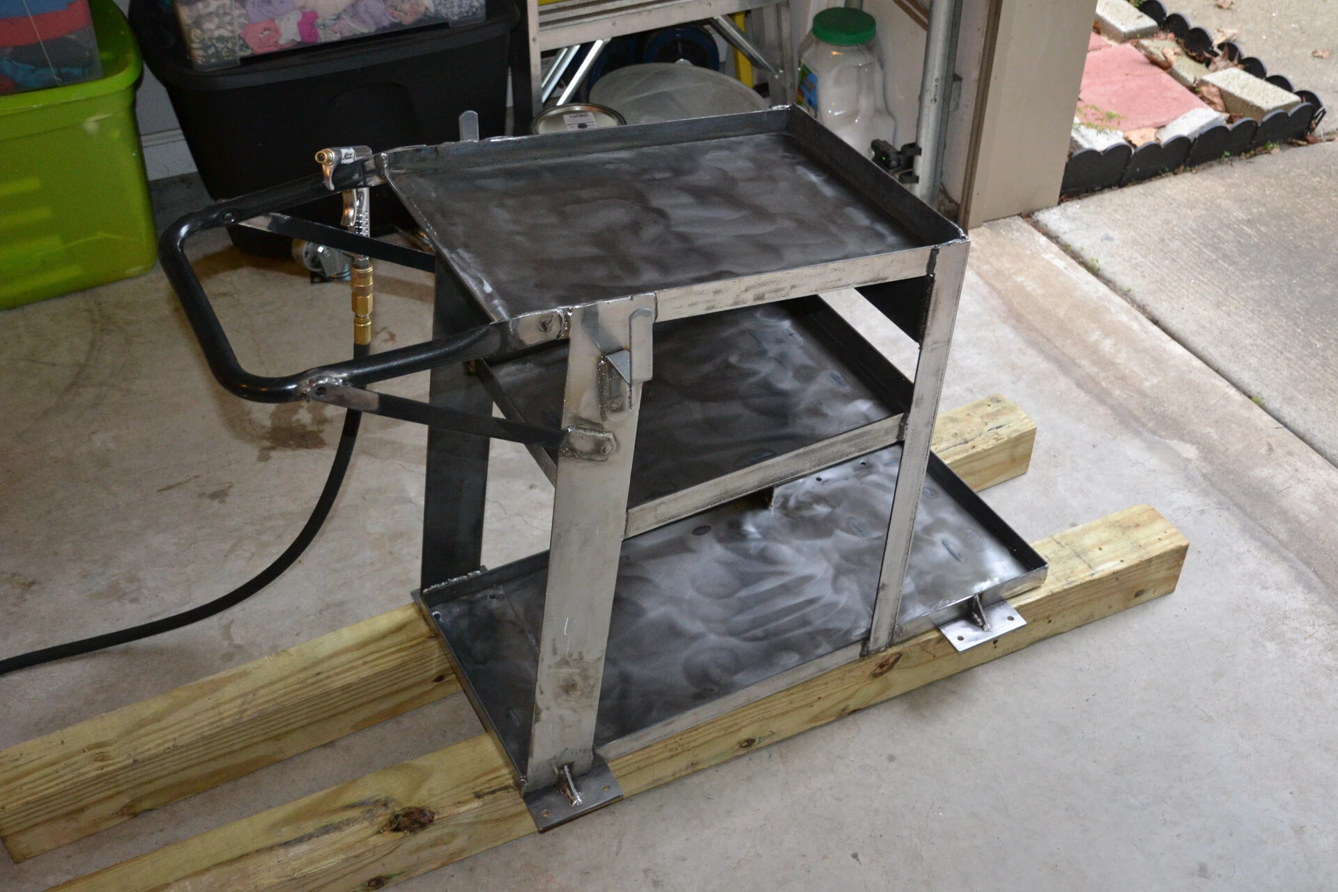

Next to its predecessor. I'd bet that this would probably be at least a $700 cart if one were to buy one similarly made.

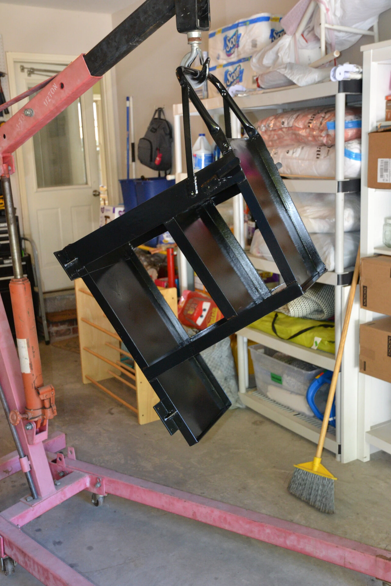

Stripped down and cleaned up for paint.
I was trying to figure out how I wanted to paint it when I had a stroke of genius. One coat of primer and gloss black enamel later:
Still having to split these up. No error messages, but no post.

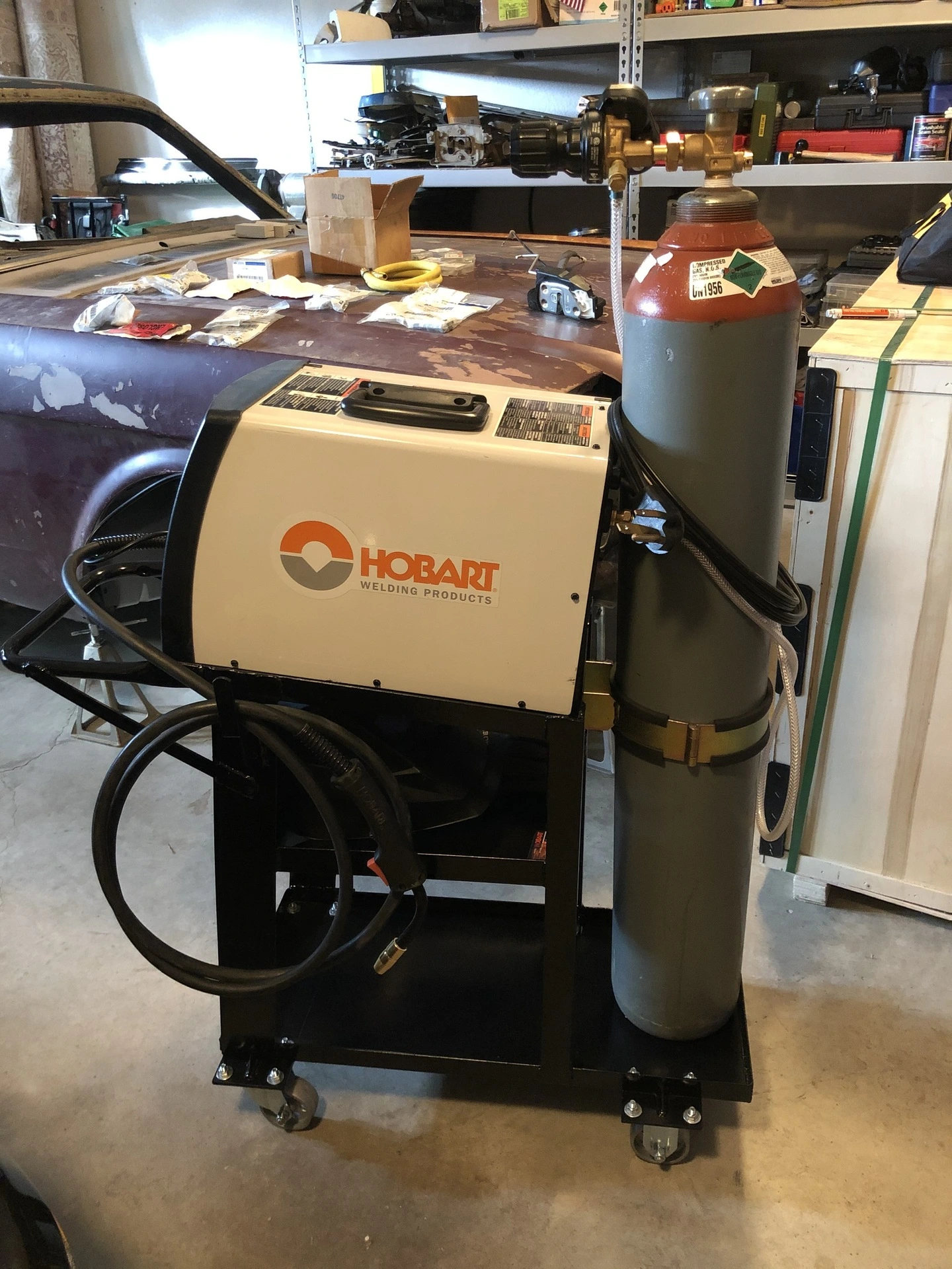

Ready for war. Almost. I'm going to give it a couple of days to cure before I go ahead and put the welder and bottle on it.

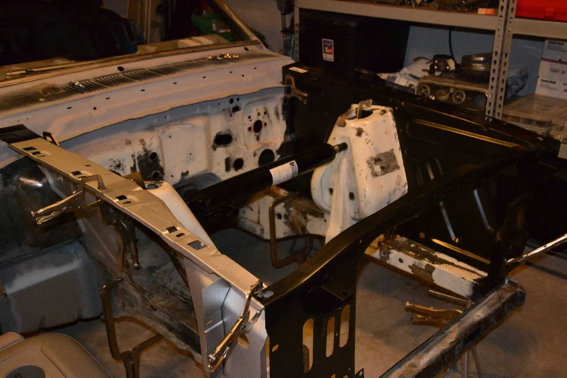

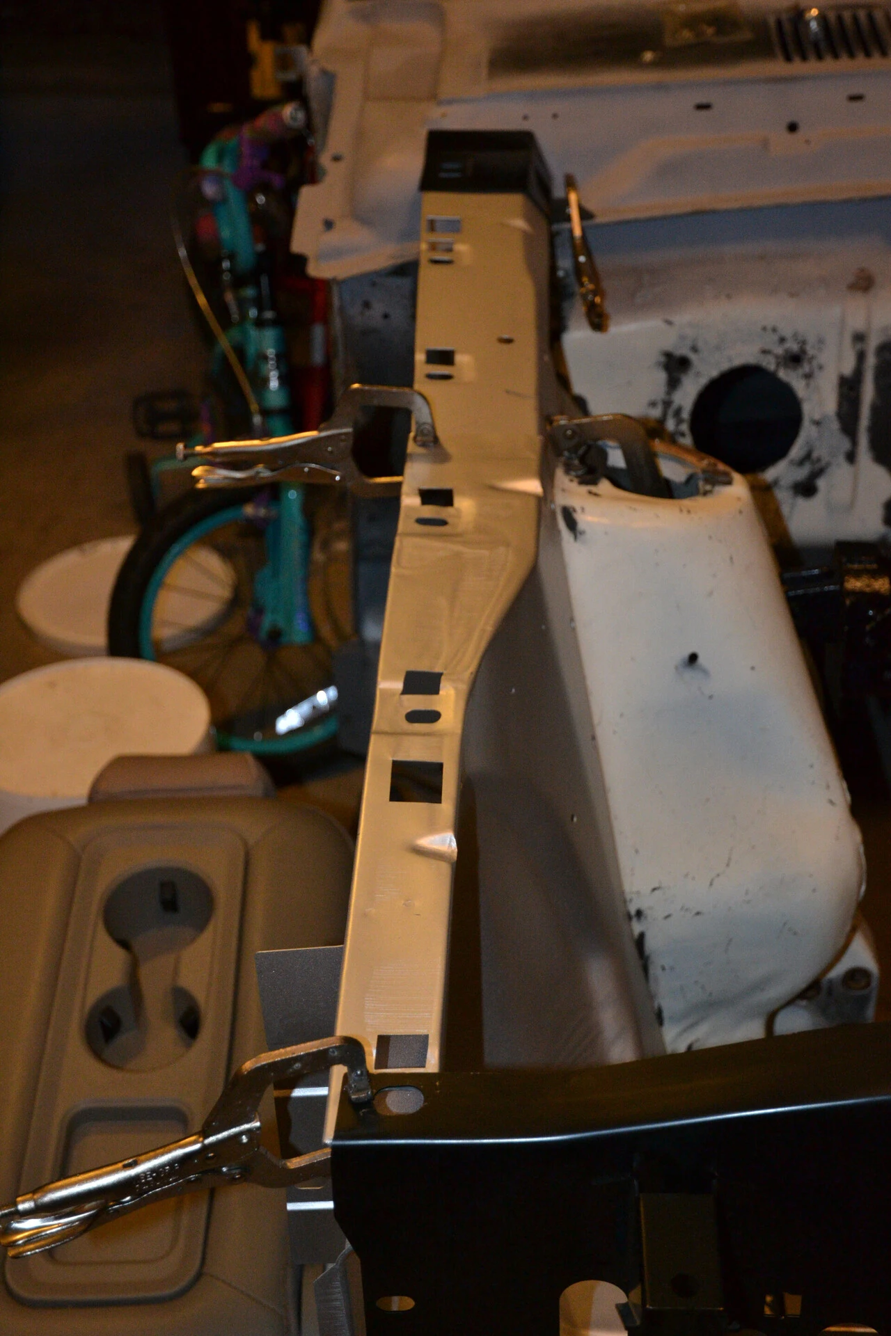

After finishing the cart, I sort of just muddled around the garage. I managed to once again mock up the fender aprons and radiator support along with the hood and fenders. The one-piece apron on the passenger side is bowed with both the front and back ends being too far inward. They fight each other when I try to pull either side where it needs to be. I decided to get a Dynacorn battery apron since I already have the rear Dynacorn piece. This way I won't have to deal with the current apron. I don't think it's a Dynacorn piece. Another lackluster reproduction with a Dynacorn part number from CJ Pony Parts under their CJ Classics line.

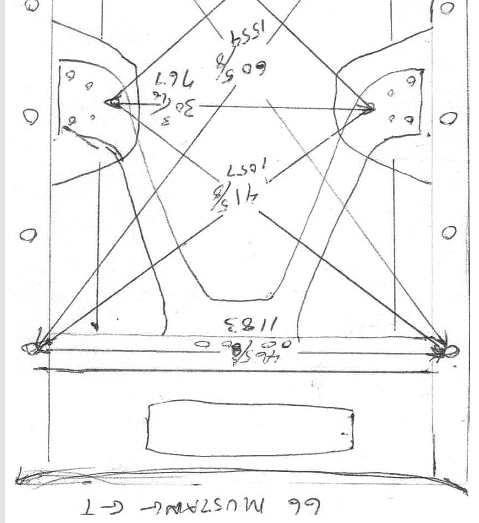

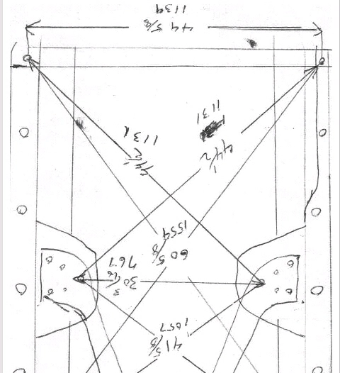

Thanks! So far I've been using the measurements that @horse sence gave me earlier in the thread. I can't really find any diagonal measurements anywhere.
I'm going to go with the measurements I've already been given. I'm also going to follow my gut and assume that the engine bay is intended to be square. Once I get the radiator support to cowl measurements correct, I'll measure the diagonal of both sides to see if they match. If they do, I'm good. If they're within 1/8", and as long as I can get the fenders and hood square with good gaps, I'll also consider it good.

Here are some hand drawn ones that helped me a lot:
Upside down, but you will live with it I am sure. Note that they depend on an export brace correctly locating the shock towers. You can always buy and resell an export brace fairly easily and only lose some of its value.

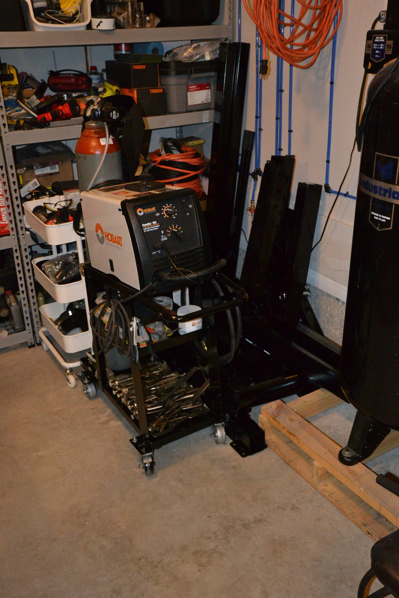

Decided to finally unbox the rotisserie so I could free up more space around the car. It worked like a charm since there was a lot of unused space in that box.
Pretty much all of it tucked nicely between the air compressor and the shelving.

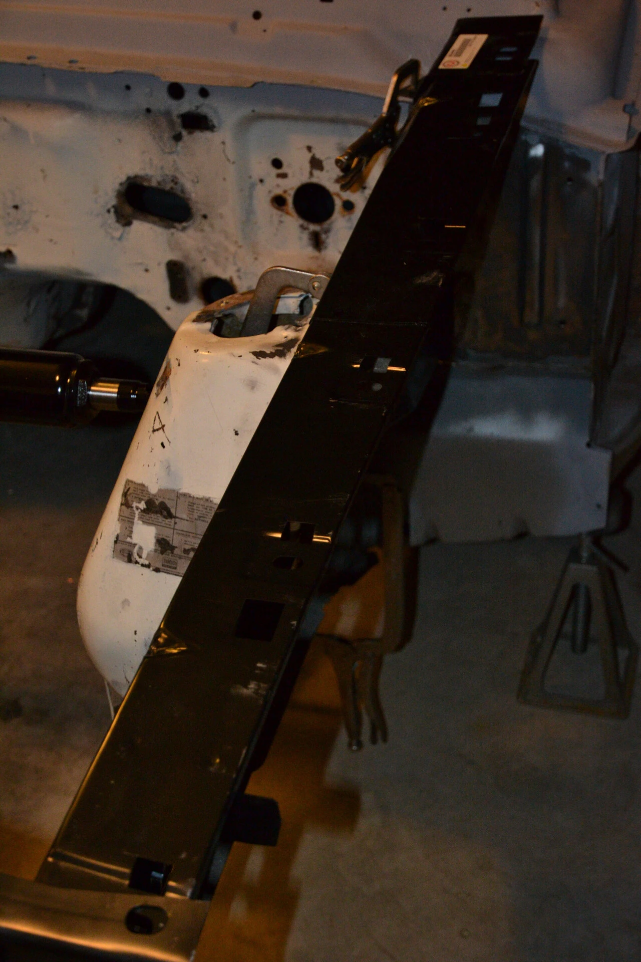

After that I did a little on the car. I removed the fenders and hood to fit the Dynacorn battery apron that arrived last week. This one, along with the rear apron I bought when I was expecting to use the '67 battery tray with no mods, fits much better than the single piece stamping.
I do think that my shock towers have sagged inward. I took advantage of having the extra hydraulic rams from the rotisserie and used one to force them a bit further apart. I'm getting right at 40" between top inside corners of the aprons. Is the shock tower bolt measurement made from the center of each hole? I'd like to make sure everything is right before I make anything permanent. Even though I'm not planning to use my shock towers eventually, I still want to use them to help get things looking right.
The driver's side apron still isn't wanting to sit quite right. I'm going to drill out the spot welds to help me manipulate it more. It looks like it wasn't spot welded together quite right anyway.

Yes, the guy I got those measurements from said they came off of an original unmolested car...center to center for all the holes. Do realize though that if you take the shock caps off, those mounting holes for the studs are slotted...meaning if you found another original unmolested car to measure from it might be +/- 1/16" depending on assembly. Judging by your pics though everything is lining up the same way mine did.
I did the exact same to mine yrs ago and it then took an alignment correctly for the first time in yrs
Had to do bottom and top to get em right. I think my car spent time as an airborne ranger
