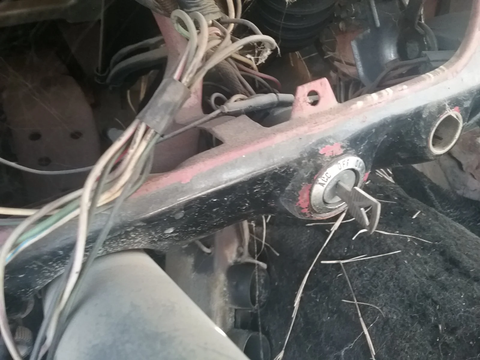

Key switch is still in place on my junker 64 1/2 so the opening must still be good if you need it

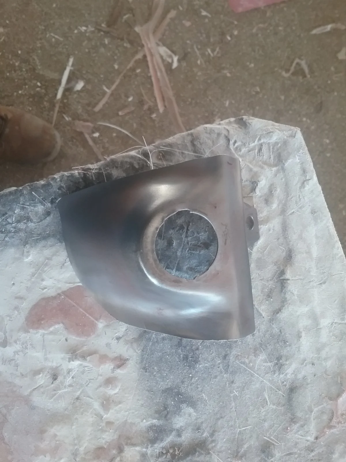

Awesome. I think I probably will. It will save me the cost of buying a dash. How about the HVAC controls opening?
Being a body guy, do you think someone with some skill might be able to fix the opening on my car's dash?

One cant help but to look at that mangled key switch hole and wonder what in the world someone was thinking. It might be possible to straighten the area around the heater controls. Or you could slice it at the area between the steering column and dash on one end, between the cluster hole and the radio hole, and across the ash tray and graft that whole section in with minimal welding and bodywork.
