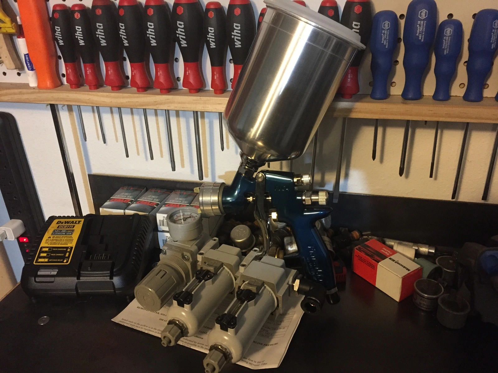

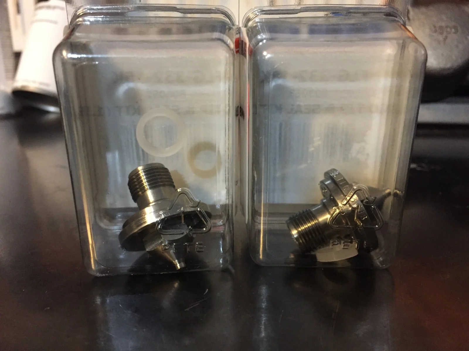

@Davedacarpainter @horse sence These tips came with the gun I bought. What's the difference? I need to read the manual for this thing.

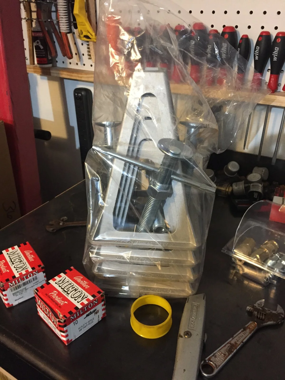

I also bought these stabilizing jacks (just under $35 at Amazon) to level the car out. I'll use the other regular stands I have for support once it's level on these four.
