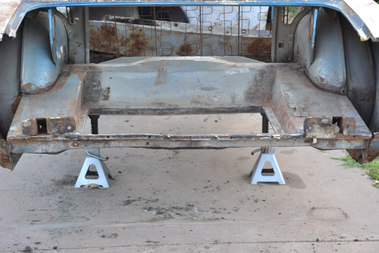

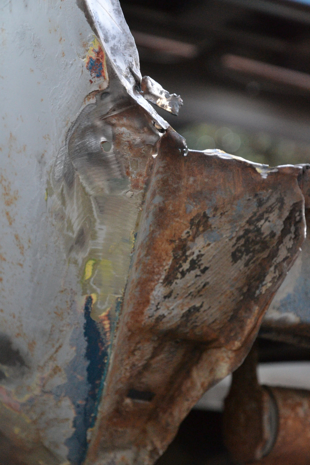

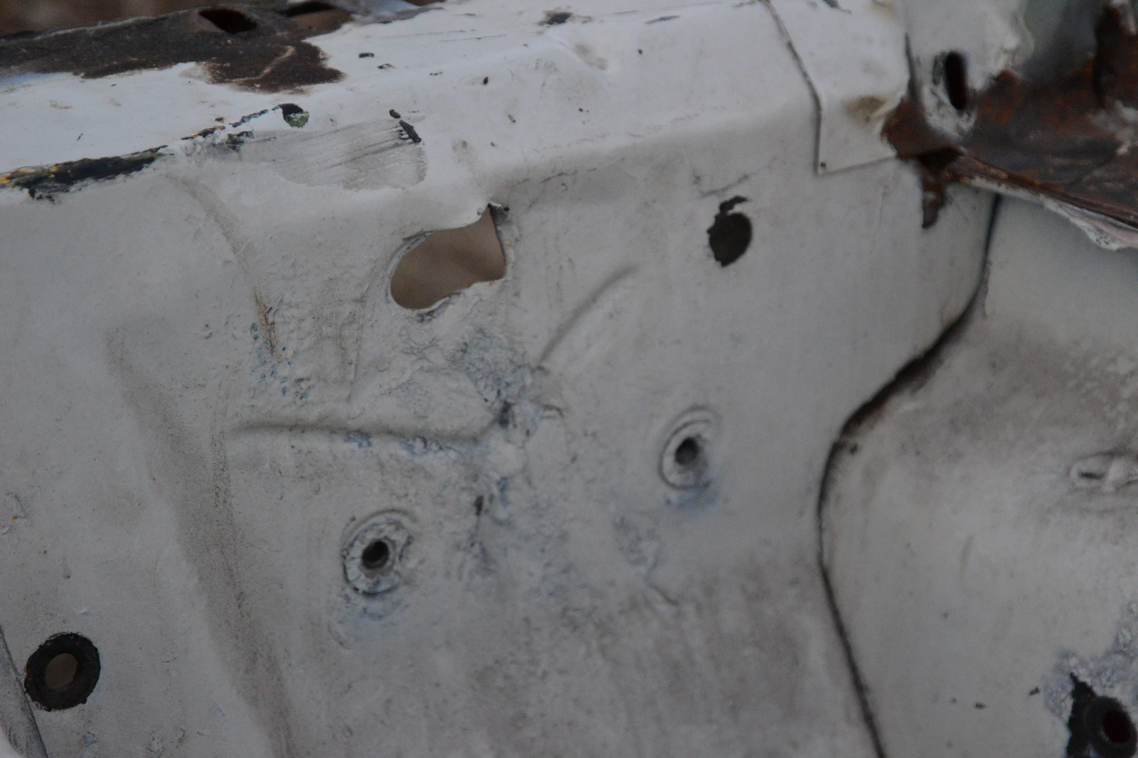

Looks like someone may have patched some holes in the tailpanel at one time . I dont think that the pieces under the end caps can be bought seperat from the quarters . I will be pulling the quarters off mine soon and i can save them if you need them ,if you have to do the quarters new ones come with the new quarters.
Is the trunk floor bad enough to need replacing or can you just patch the rusted area?
There isn’t really any rust. It’s just damage to the sheet metal that looks like it was from an accident. You can see it just to the right of the driver’s bumper bracket. The rear trunk support is also pretty mangled and looks like someone tried straightening it out before. That’ll get replaced too.
So far, all the rust is just on the surface except for the floor pans and possibly some areas of the cowl. I wouldn’t need to replace much if it weren’t for the accident repairs and bad bodywork.

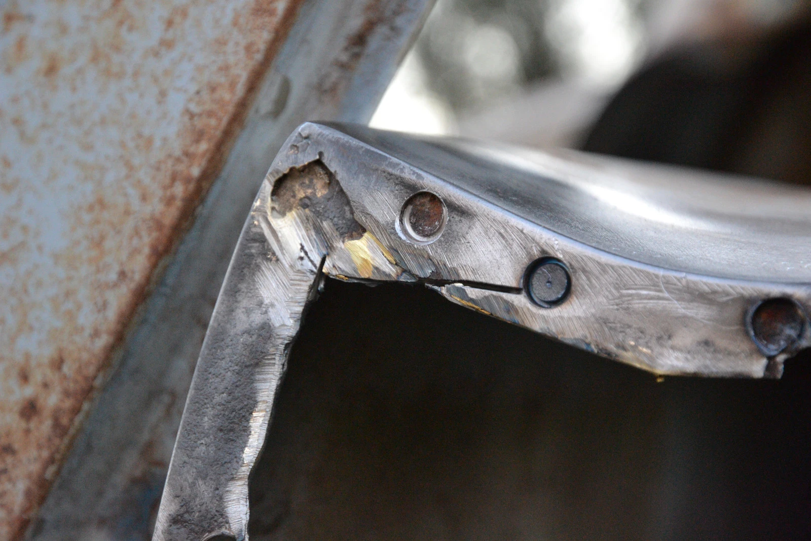

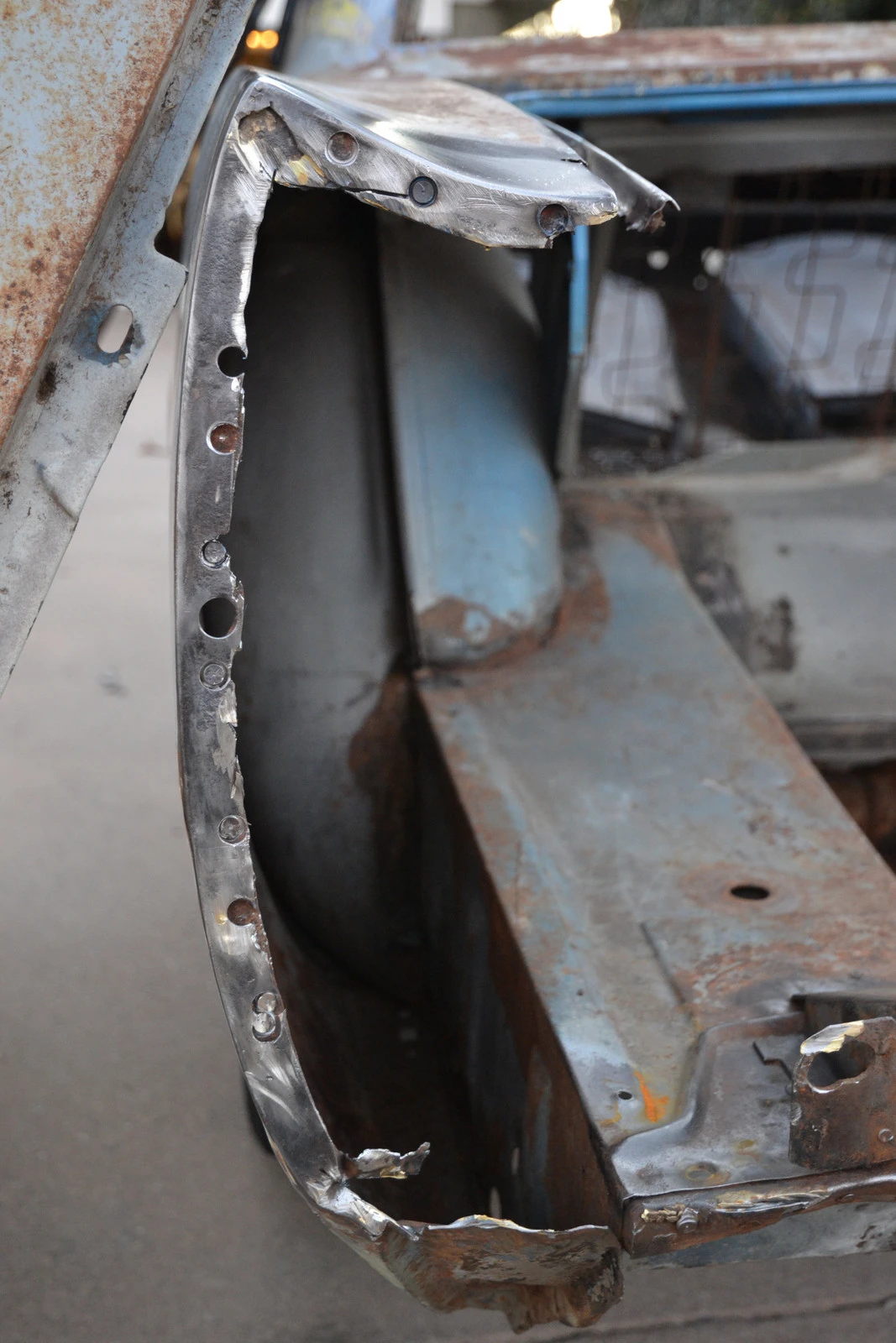

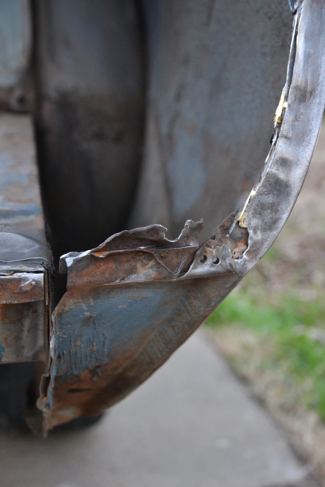

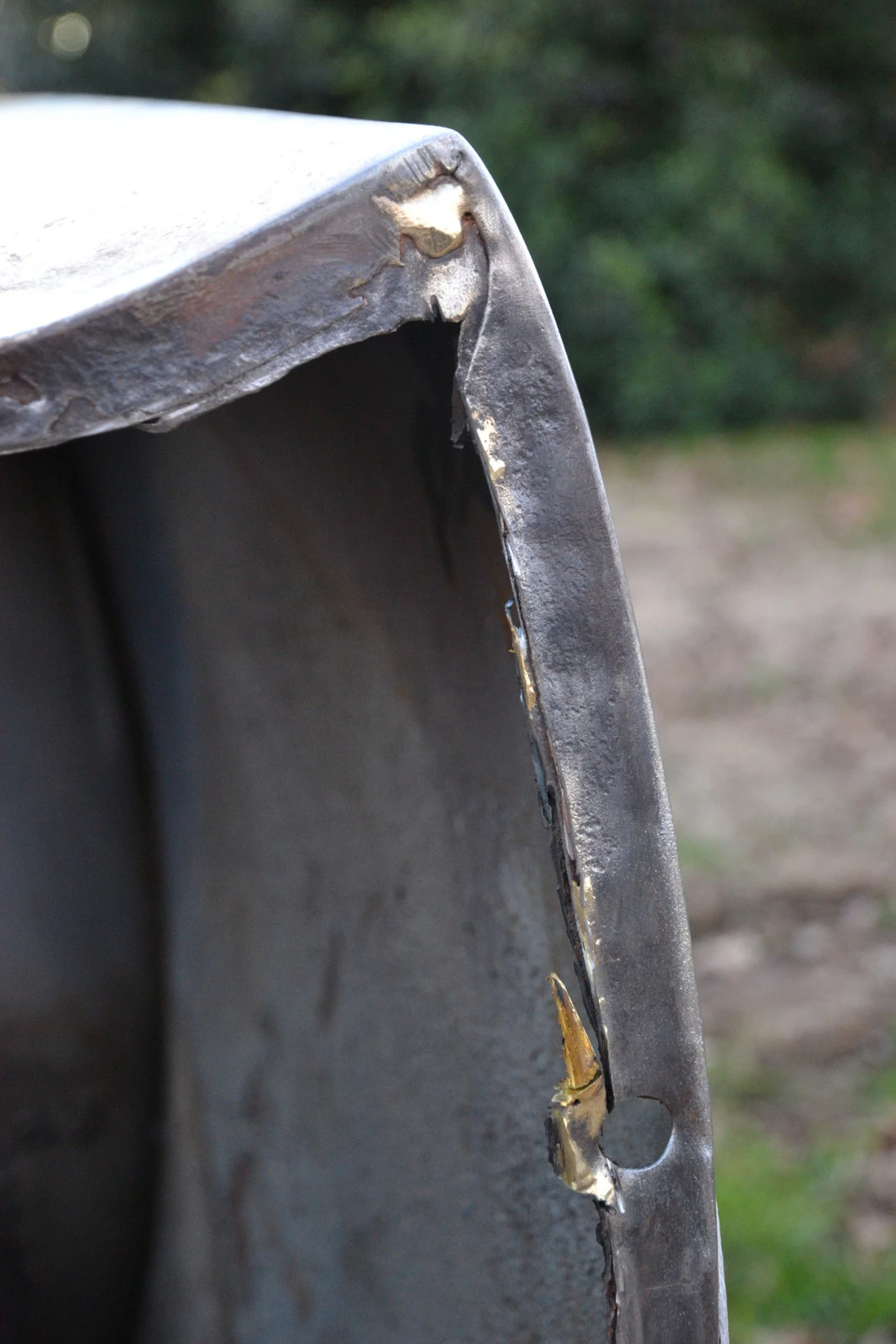

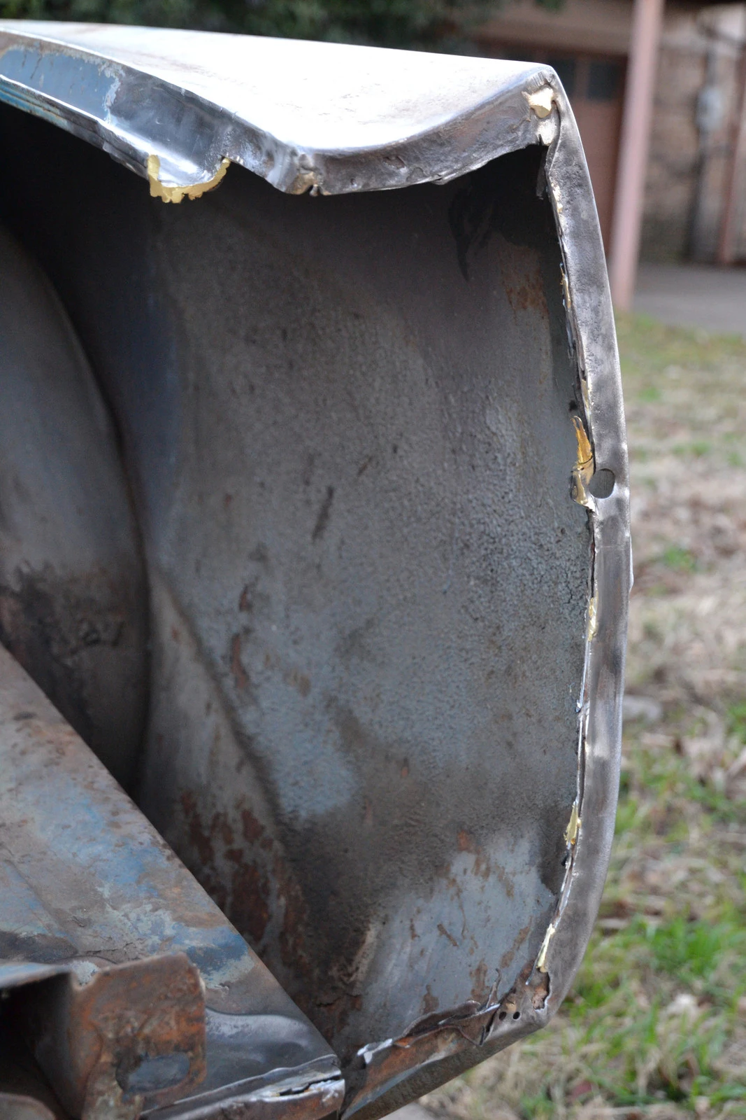

That said, there is a TON of that brazing crap all over the ends of the quarters. What is the best way to remove this stuff besides just grinding it away? There seems to be precious little metal left at the end of these quarters. I really, really don't want to have to replace these quarters. I think I can handle installing new metal, but I'm not sure I could handle fitment issues that may arise from aftermarket panels in the event I'm forced to replace large pieces like the quarters.
I'll take some pictures when I get home so you can see what I mean. The original flanges spot welded to the quarters were completely rusted through. They were only attached to the car by brazing.

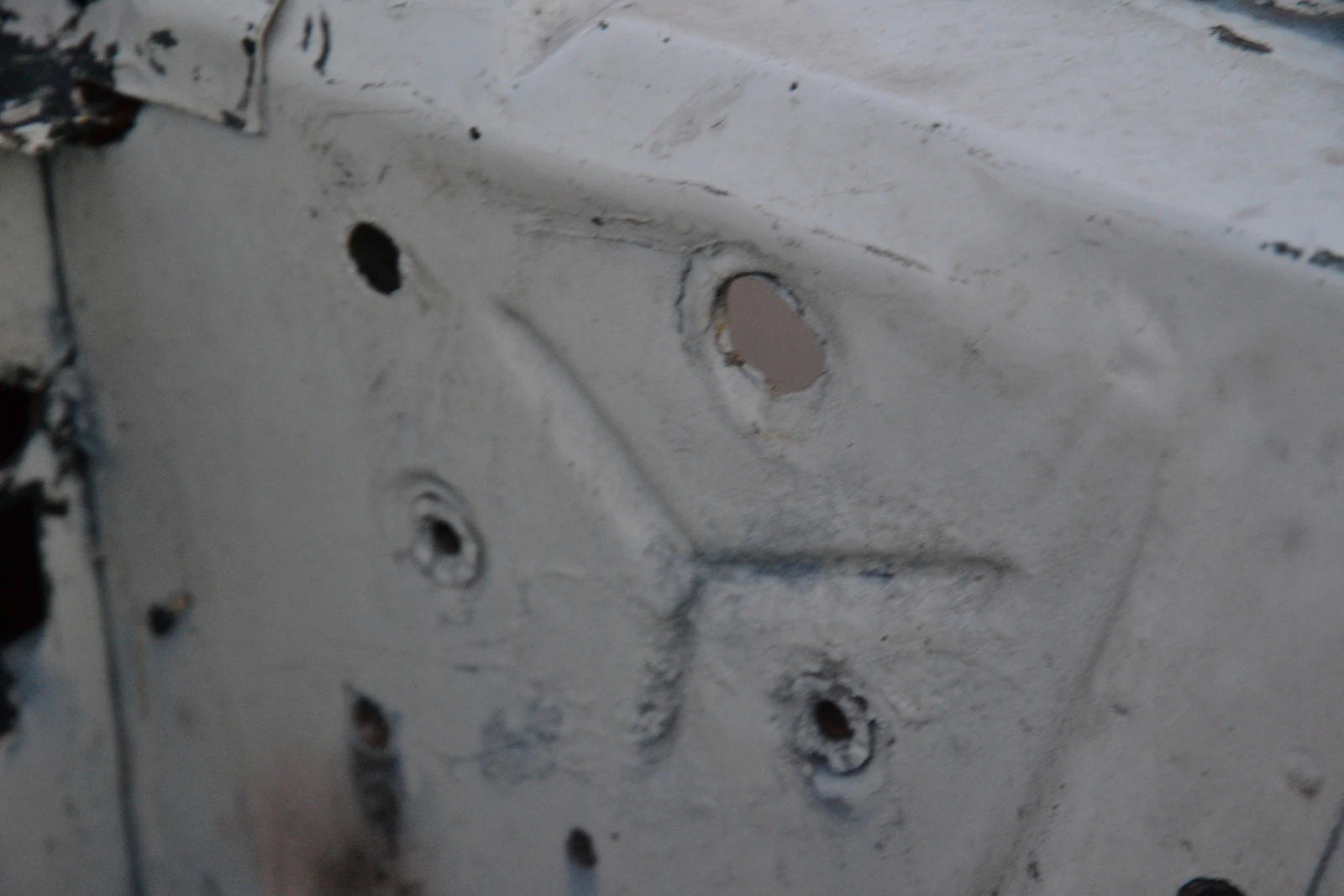

Pictures. Driver's side isn't as bad as the passenger side.
I was able to at least salvage a good deal of the quarter panel flange on the passenger side.
Someone's effort at dent repair on the driver's side.

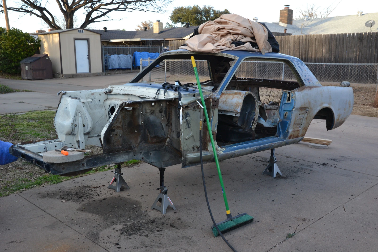

Back at it today and the car has no more suspension. Going to have to fabricate some means of moving it around, but I'll worry about that later. Can anyone recommend a good, decently priced cart or rotisserie? Or should I just try to fabricate something once I get my welder?

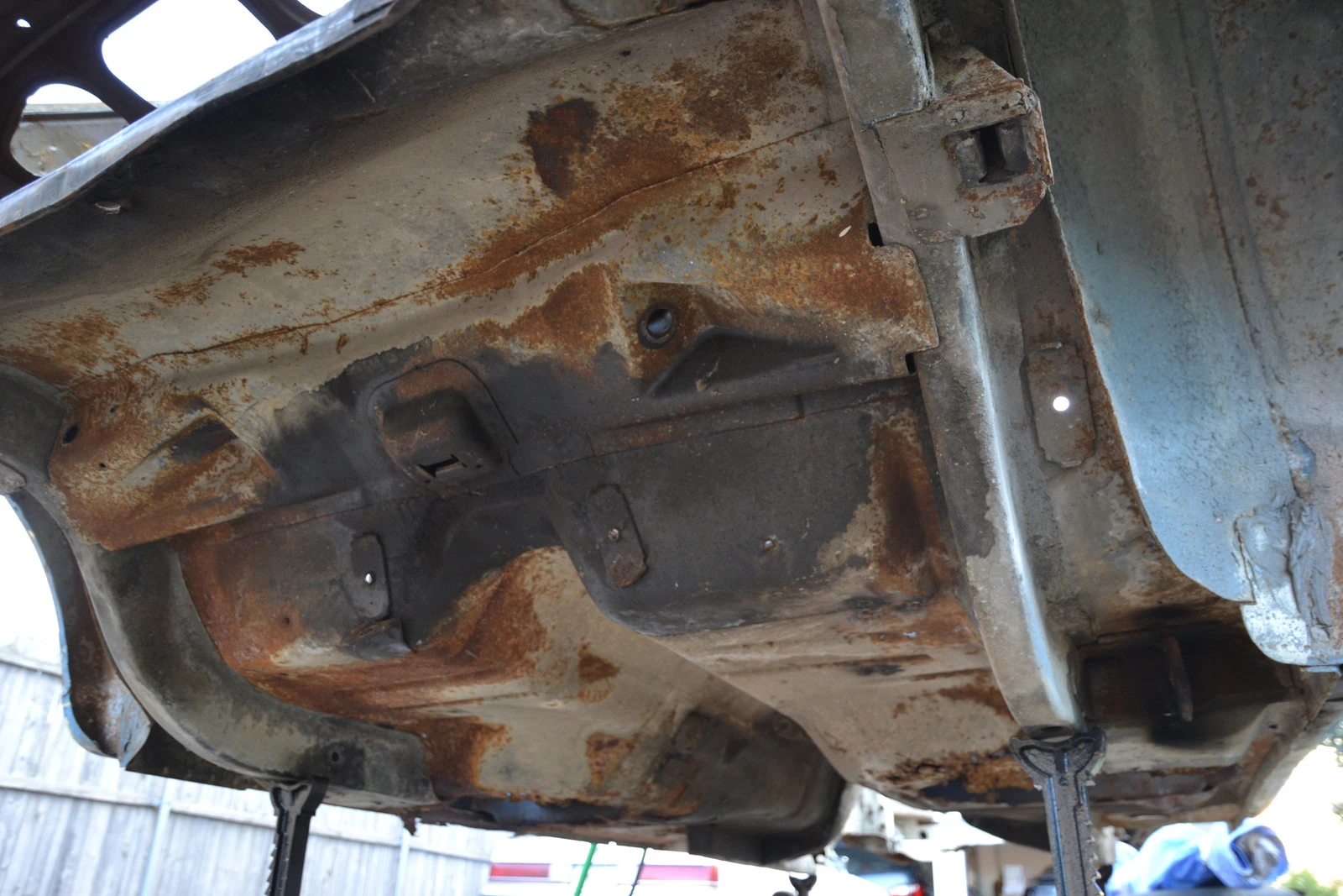

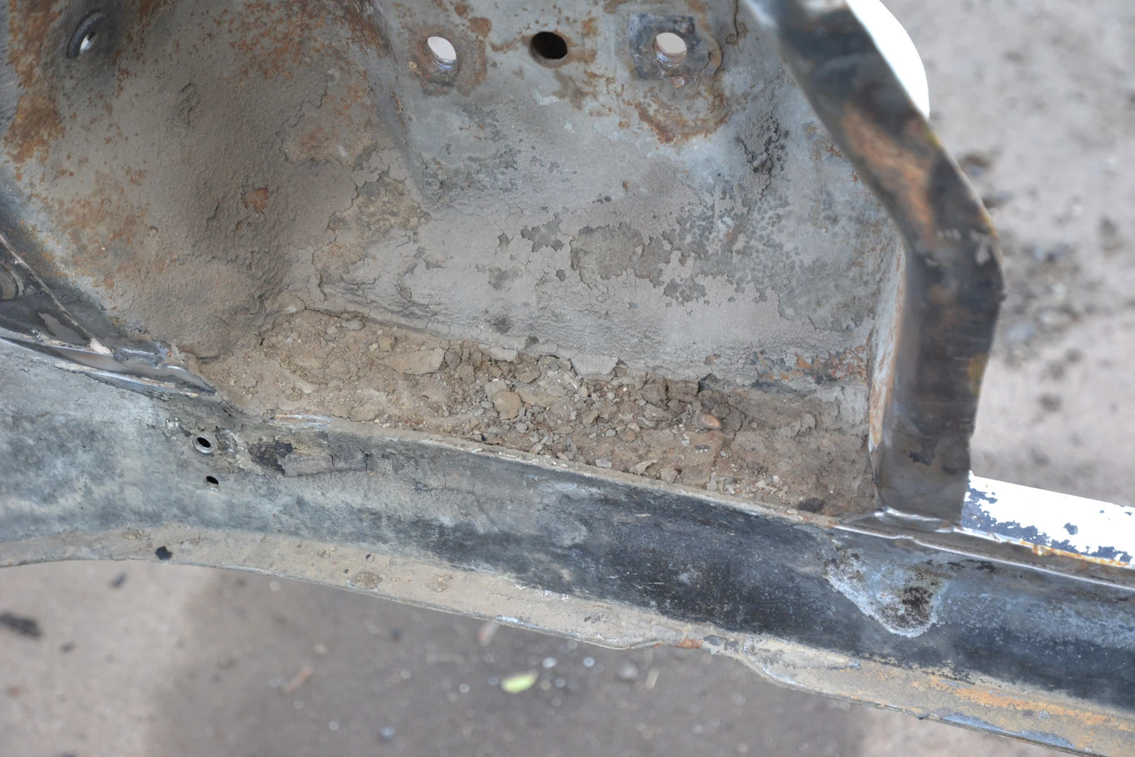

This appears to be a dirt collection tray.
Underside looks fairly good.
The front leaf bolts were rusted into the bushings. I was worried about this, but I ended up coming up with a good solution. I used my MAP torch to burn away enough of the bushing to where I could get a vise grip on the metal insert. Didn't take much effort with the impact to break them loose.

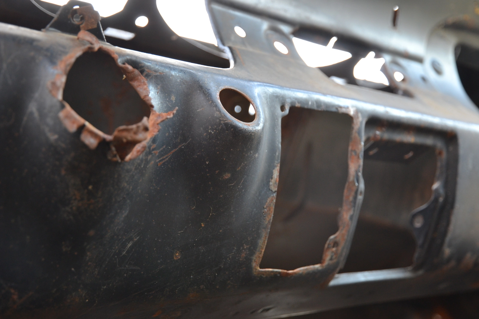

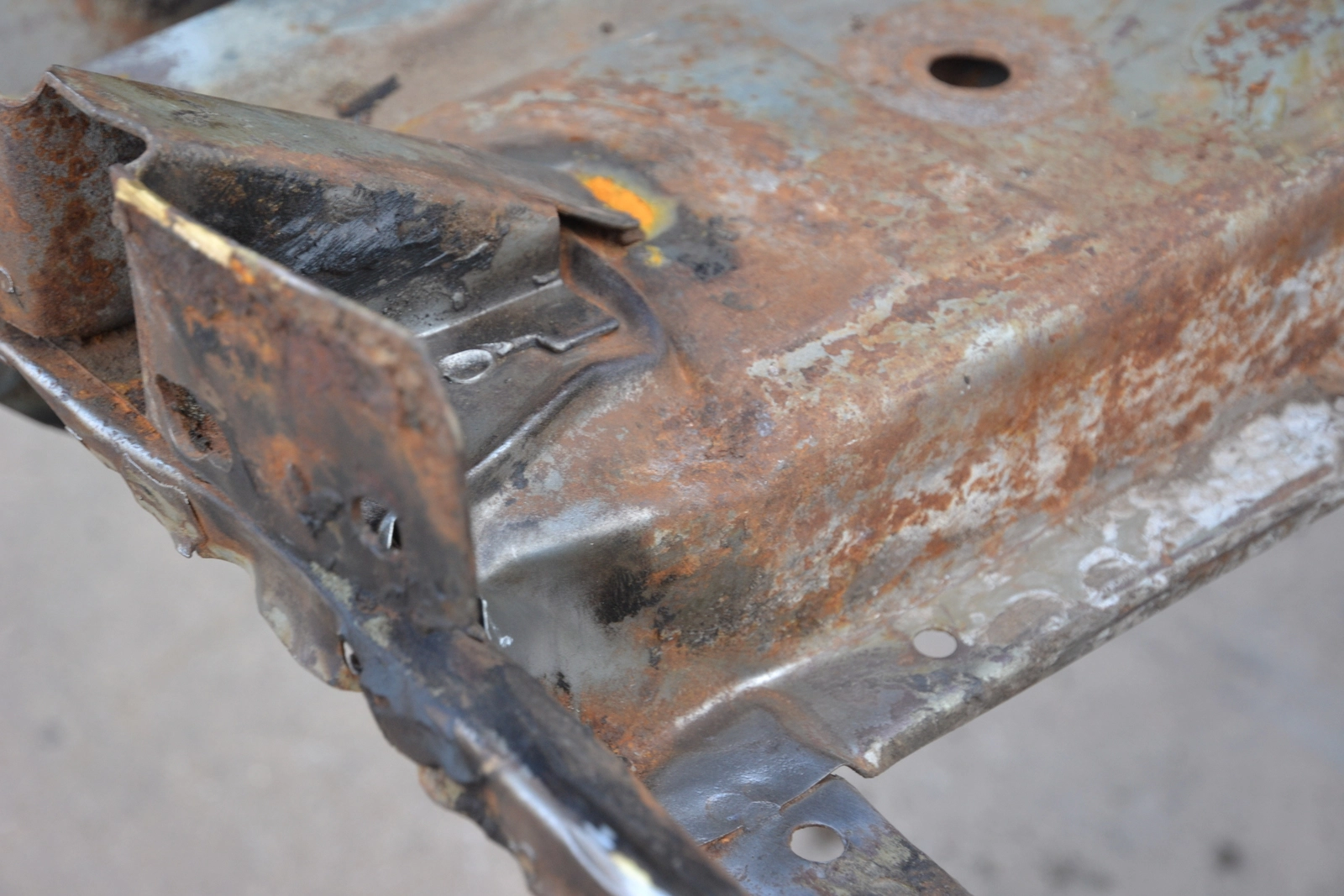

The left side bumper bracket is tweaked along with the trunk floor in that area. Not sure how I'll go about remedying this. The metal is solid with no rust.
Also, is it possible to get patches for the dash other that just the radio hole? Someone ripped out the old ignition cylinder and there is also damage around the HVAC controls. I'd rather not replace the whole dash, and I don't want to buy a new dash just to cut it up for what I need.
