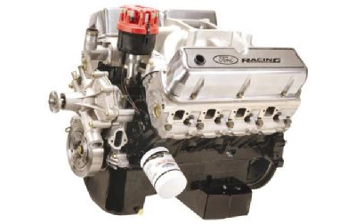

Here we are...
Specs...
9:1 compression ratio (nominal)
Forged pistons and forged steel cap screw connecting rods
Hydraulic roller camshaft (.552'' lift and 228° of duration @ .050'')
High-performance T-sump oil pans available in front or rear sump
MSD billet distributor
Ford Racing GT-40 cylinder heads and valvetrain
Edelbrock single plane Victor Jr intake manifold
Billet steel flywheel
Harmonic balancer
Basics of JEGS Cam is nice and lumpy... will do decently with 8-10psi!!!! :D OUCH! This is now a $8,999.99 motor...! I paid significantly less than that!
Heh heh heh heh!!!!
