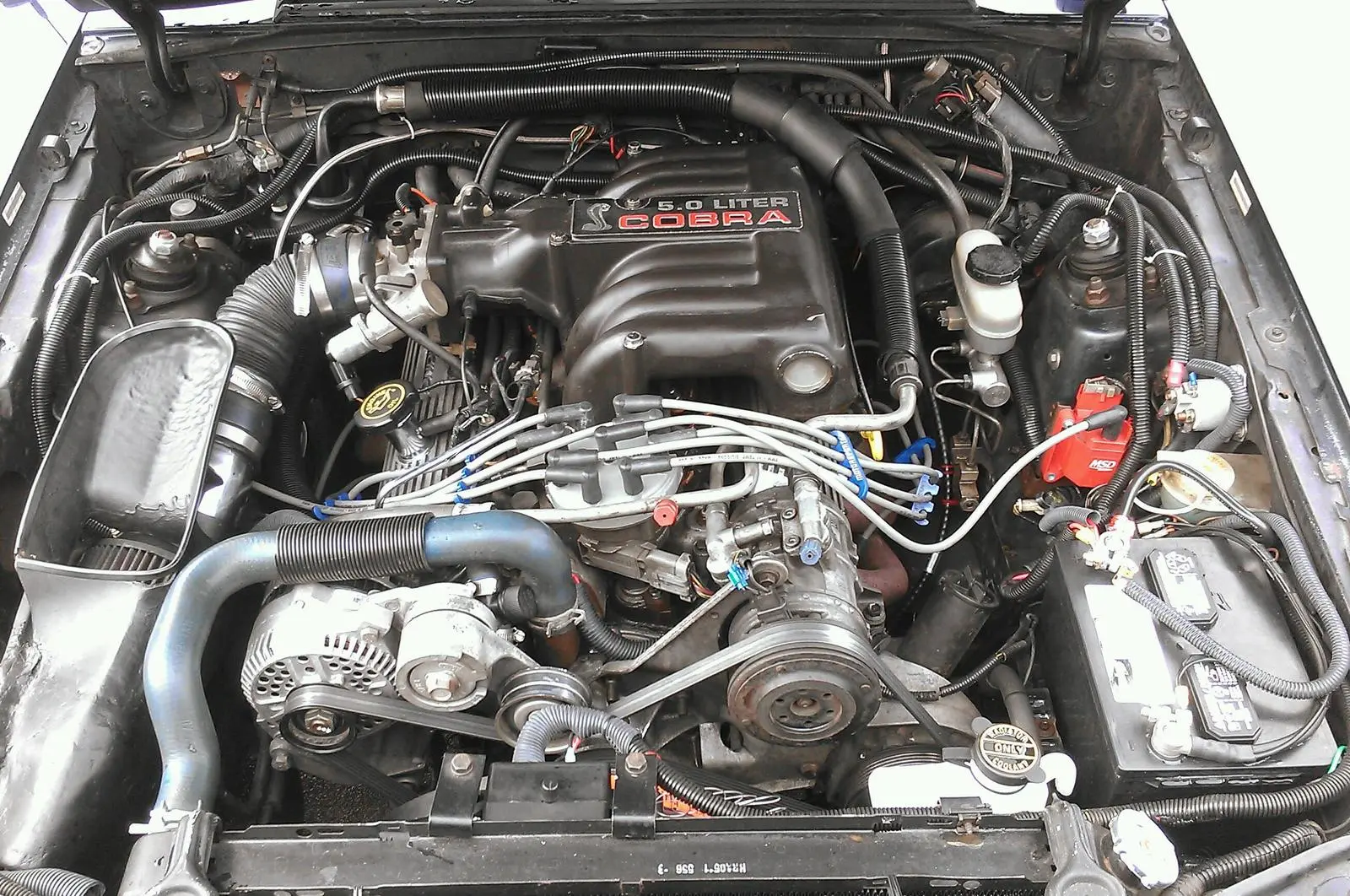

So im doing this quick and easy engine trick right now, report back soon. I'm at the close your hood and bake it part.
****Alright all done with my trial run. In this i did the VERY min of cleaning, meaning no using any type of brushes etc to get into tight spaces etc or scrubing so we could really see with any effort how much more can be had.
I just used the Gunk spray-(original blue top can) then I replaced the Turtle Wax tire foam with Meguiars tire foam. So before I post the pics here are my exact steps at the very min of cleaning.
1. Cold engine
2. Sprayed Gunk, set for 5-10 min
3. Rinsed with light water spray and let dry with hood open.
4. Used blow dyer on electrical places that were exposed, had no air compressor but it worked well.
5. Lined the engine bay sides with a towel for over spray used the Meguiars tire foam.
6. Sprayed A LOT Everywhere but on the Atlternator, you can see i left the back left top firewall, left fender side unsprayed for a side by side view.
7. Finished spraying and closed the hood and started the car and let it run at idle for 15-20min. It started smoking outta the hood and i could smell it getting baked or burning off the headers, valve covers etc.

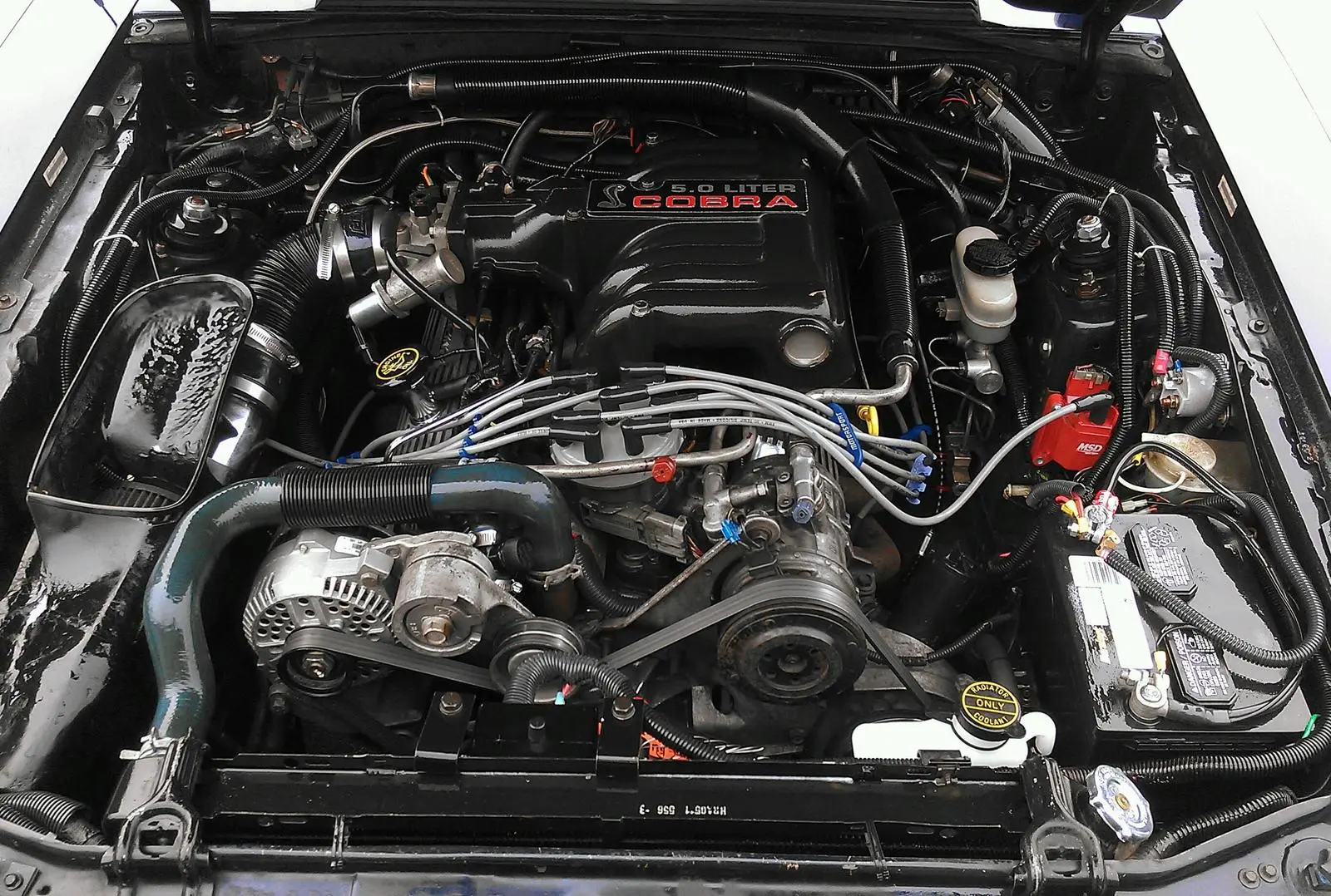

After all the smoke cleared and engine was nice and hot, I opened the hood after and this is what i got......
Reactions: A5literMan
Now that was pretty damn easy for the results I got.
I'll use a paint brush to get the edges better and do my own detail later but that was a general spray and go trial run.
But now that trick is in the bag for sure :nice:
That looks pretty damn good to me.
I'm going to give it a shot next weekend as well. It's pouring rain here today.
I'll post up some before and after pics too.
Thanks for the test run.:nice:
