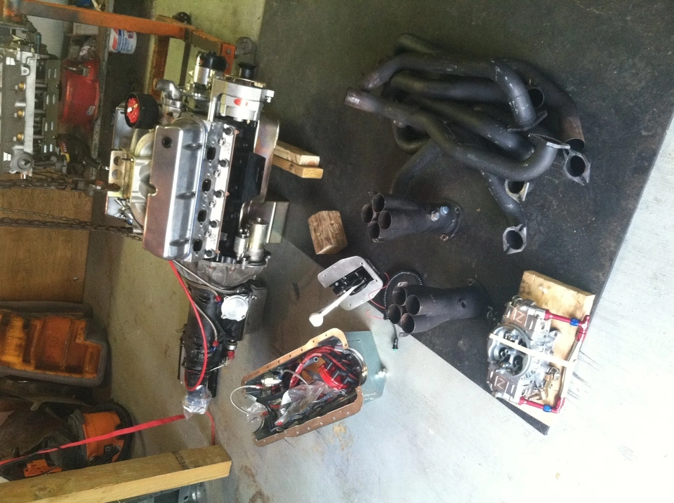

ANYWHO...... Now for the main event.
This makes my groin tingle.
By hoopty50 at 2012-04-26
And everything I got in the deal last night:
Holley HP ultra 950
Vic Jr
AFR 225s
Custom Erson Solid roller
Kooks headers,
NOS big shot kit
Art Carr C4 with quarter stick and trans brake, 4,000 stall
New oil pan - one on it has a pin hole and needs to be changed (eBay junk)
MSD coil
CSR water pump
Lots more little ditties
So basically, all I need to DRIVE this thing is a fuel pump/regulator and plumbing, and some gauges.

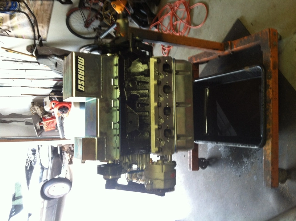

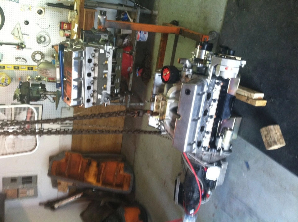

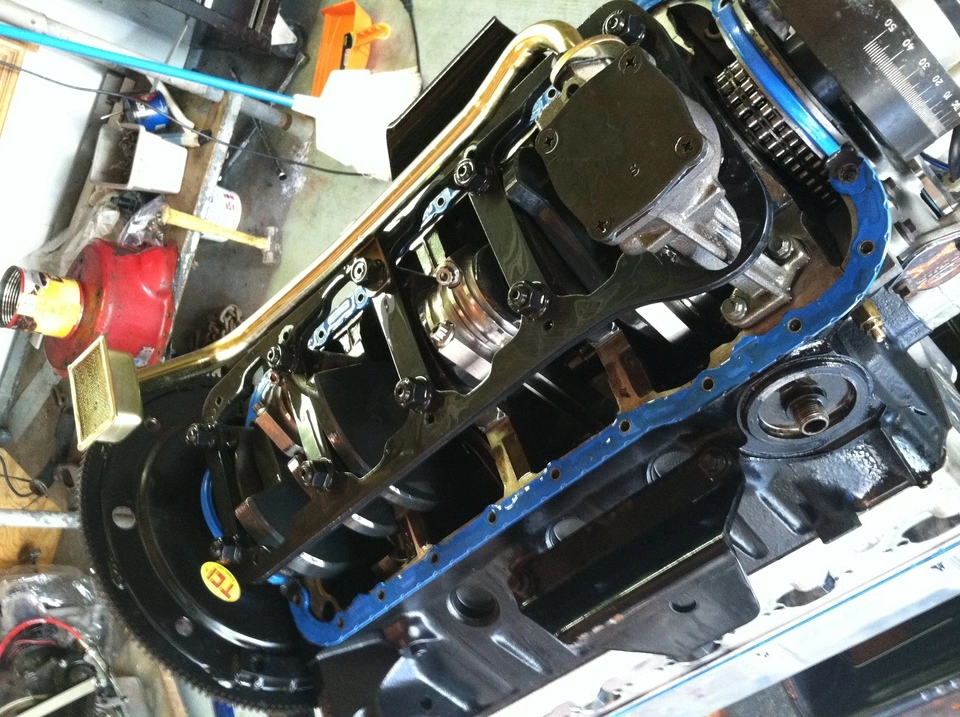

Well, I had some unforeseen, unexpected, un... well you get it. Anyway, it took a little longer to get this thing ready to drop in.
Didn't take as many pictures, but everyone has seen an engine before. Here's the guts of this heifer:
By hoopty50 at 2012-04-27
New Mororororoso pan on (this one actually fit)

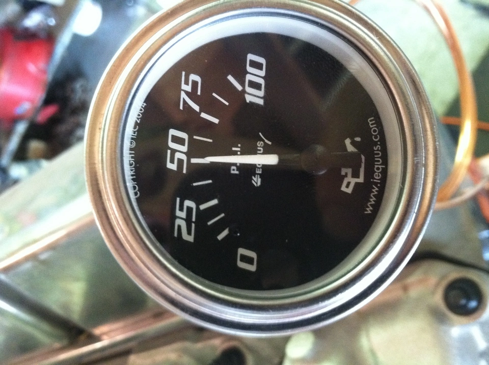

Tested the oil pressure with the drill

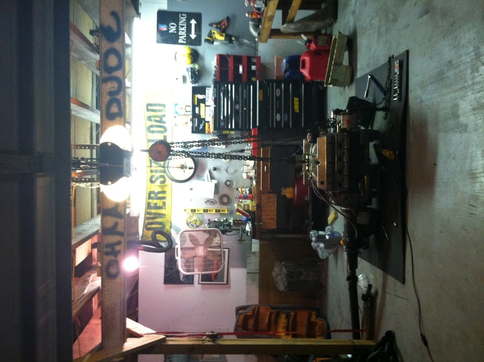

And 2 days later, its waiting to be dropped in.
Unfortunately, the NHRA race is this weekend and my family has had the first motor home spot for 20+ years. Its a ritual that I go. So it will have to wait until I get back and can con someone into helping slide this pig in.

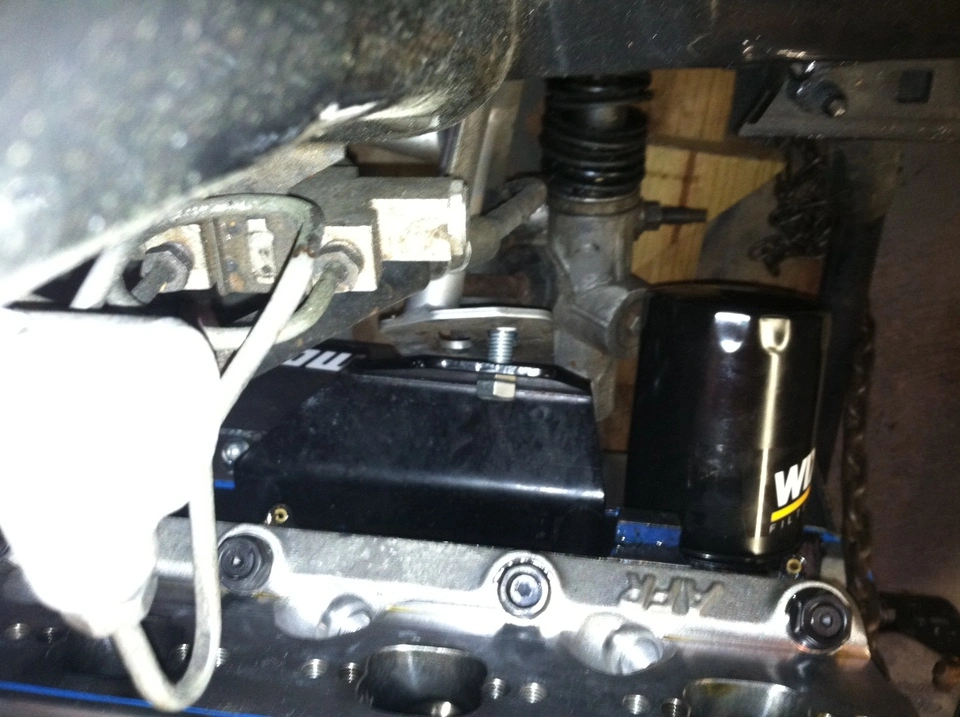

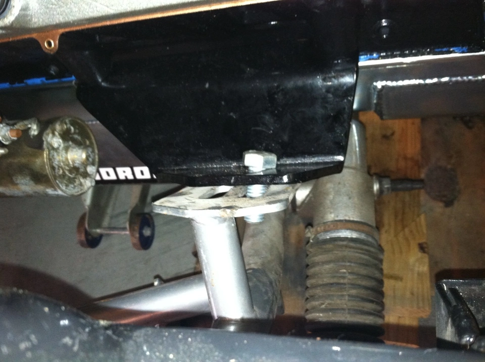

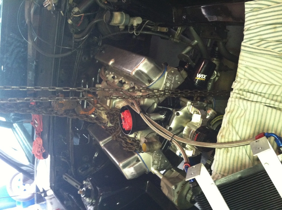

Well the engine and trans are in.... Kind of.
By hoopty50 at 2012-04-29
The passenger side motor mount looks ok:
But the drivers side is way off.
Any ideas? Also, the oil pan is sitting on the rack. I know they do this, but the engine looks like it needs to sit down in the cradle more. The oil pan would prevent this from happening. All suggestions are welcome.

Made some half inch spacers to go between the block and motor mounts. Also, the drivers side mount on the k member was a little off but it moved into place when I tightened the bolt.
Now, the trans sits to the drivers side on the cross member. I'll deal with that tomorrow

Got everything bolted in the right way. I'm happy.
Also found out why Kooks headers are so expensive. I put them in by myself with the engine in the car in about 30 minutes. Only 1 F bomb. That's unheard of.
