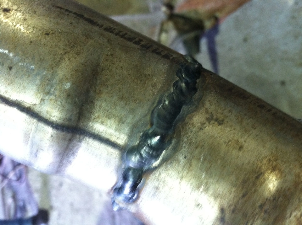

Well, suffice to say that today was nowhere near as productive as I had imagined. Moroso thinks it's hilarious (apparently) to sell their windage trays without the necessary hardware to install them. Ok Jegs, here's another $45. While I was at it, I ordered some other necessary hardware, like oil pump studs and pan bolts. When building an engine from scratch, the hardware is just as necessary as the pieces/parts themselves. Who'da thunk it?
So with engine assembly out the window, I ventured over to the resto shop to try my hand at TIG welding.
Cliff notes:
Just because you're a rockstar MIG operator doesn't mean you can waltz in and make beautiful beads with a TIG. I only had 30 minutes to play with it, but this is my first ever attempt with a TIG.
By hoopty50 at 2012-04-18
I'm almost too embarrassed to post this. But as I get time, I'll keep practicing until I can make beads presentable enough to leave unground.
Cliff notes:
Tomorrow, the GF wants some attention and then Friday I fly to Alabamer to visit the grandparents for the weekend. No updates til next week...
Hmmm. Looks like my tig work, (only w/o the holes)
It obviously takes time, lots of it. I even cheated by spotting small tack welds w/ my mig, then I used the tig to flow out those spots.
Alabama? where in Alabama? There is a big car show going on on Saturday here (praying that it don't rain) maybe you can stop by?

Collin, take the ceramic cup of the tig torch and set it on the base metal to steady it. Adjust the stick out of your tungsten to give you the proper arc gap, i.e.- don't leave the electrode hanging too far out. Walk the cup back and forth to move ahead, this will help you keep steady and you can adjust the width of your bead with how far out you swing while walking. Practice makes perfect!
Thanks Allen. Any/all technique tips are appreciated. How far should the tungsten stick out of the cup? I had it out .25". I can't go try again until next week, but looking forward to sitting down and trying it again.
What I didn't like is instead of a foot pedal, he had a finger adjuster on the torch and it kept moving around. Made it difficult to control the torch.
