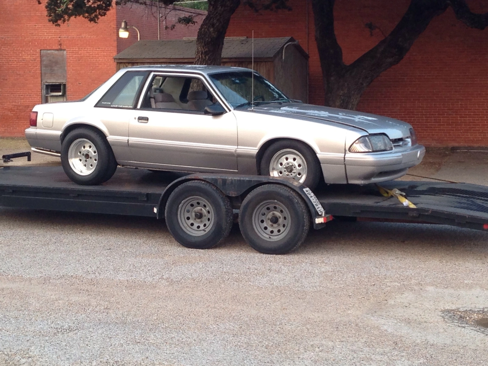

Well it's home. Will update more tomorrow, I'm beat.
I did manage to ruin the paint by almost ripping off the front bumper getting it on the trailer. I'll write that up later too.
Sweet. Is it missing door trim or painted? It seems different. I did the same thing to my front bumper, surprisingly held up.
Ditch the draglites for the wheels you were looking at and it'll be bitchin
It's painted. It needs a lot of detail work to clean it up aesthetically. I already committed to buy some wheels off corral, so that's done. I'm going to attempt fixing the water pump bolt without pulling the engine also.
