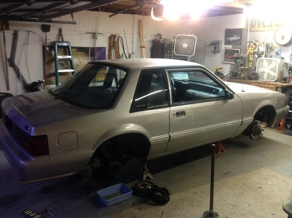

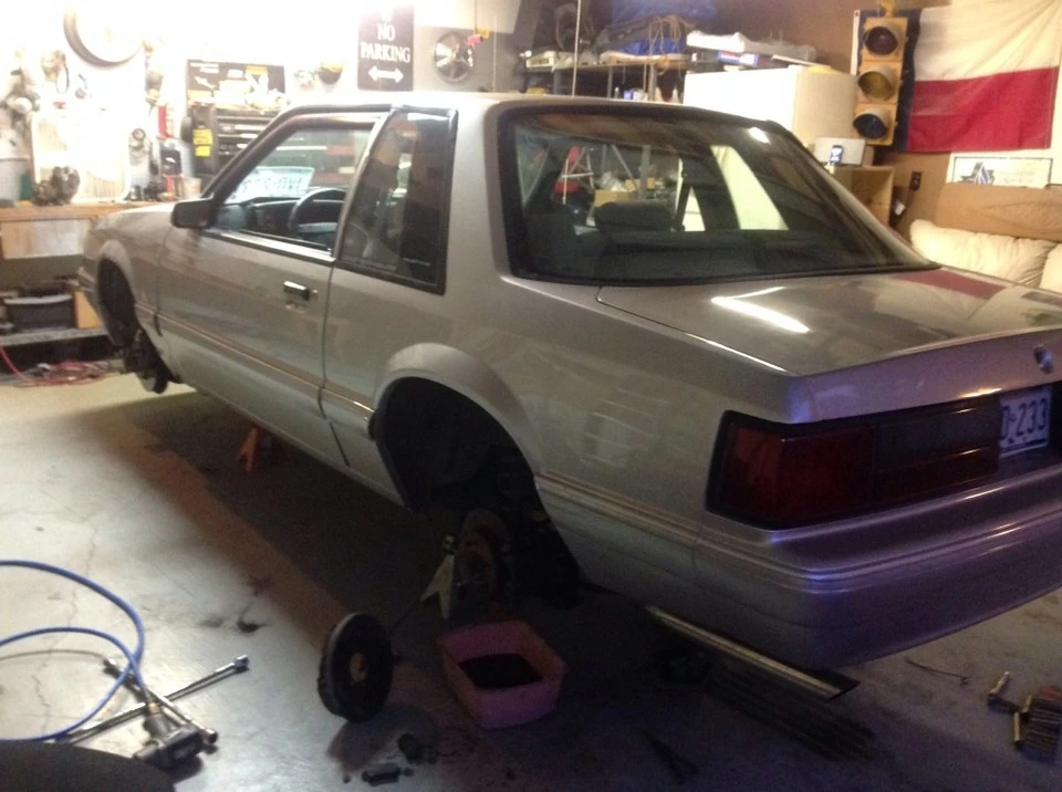

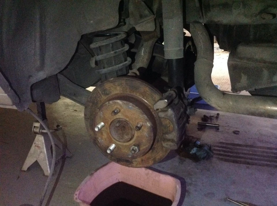

Rear brakes are done less soft lines and bleeding. Need to buy the lines and still have the fronts to do.
Don't know why I never did a rear disc swap. If I did it again, I could have it done and driving in 2 hours or less and it all cost me $120. Can't beat that.
I have $200 invested in the front setup so far, will need another $50 or so, but all in all it's very affordable and well worth it.

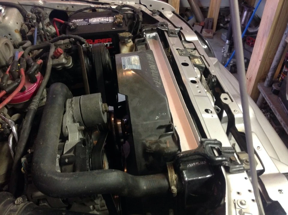

Swapped in my new Champion 2 core radiator. Also dug out a fan and shroud I had stashed away to replace the bent fan and broken shroud that was wired in place.
All is well now except the A/C system. @jrichker what voltage at the compressor clutch should I be seeing when the A/C is switched on inside the car? I put my volt meter in the connector and was getting roughly .2v whether the A/C was on or off. The 20a fuse was good, the controls all seem to work. The compressor moves freely. Not sure why it doesn't even attempt to engage. An tips/ pointers?
If there is no charge in the AC system, the compressor will not engage. Maybe you know that, maybe you don't.

Good news! I ran a jumper across the low charge plug and the compressor turns when the a/c is switched on. I also scored a 3G alternator tonight for an impending electric fan install. Thanks all for the input. The system still has some pressure, so I think it may be as easy as a recharge.
