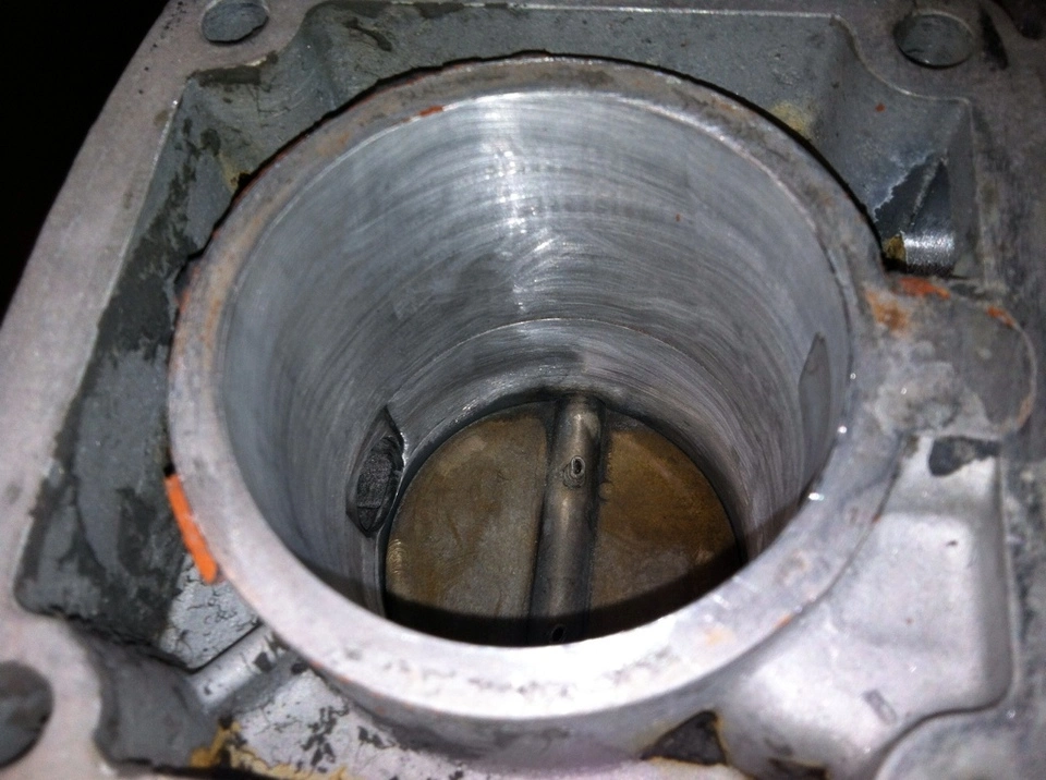

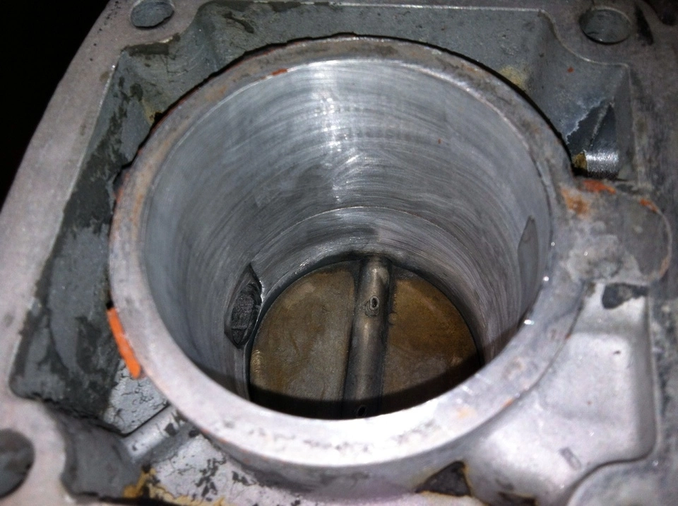

Cleaned up the transition between throttle body to egr spacer
