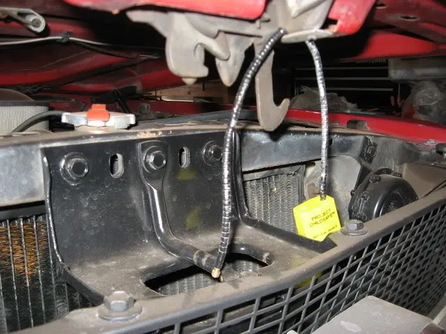

I've used 2 options, first I started with a gun lock just because it would take a while to cut being a fairly strong linked steel. It could be tucked up where you can't see it and the tumbler painted black over the yellow. I mainly use this as a back up now if I am away from the car for a while. Used to park it at the airport for a week business trip with this. It is pretty easy to loop through the hood and latch and gives just enough room to get the end out where I can get the key to it:
