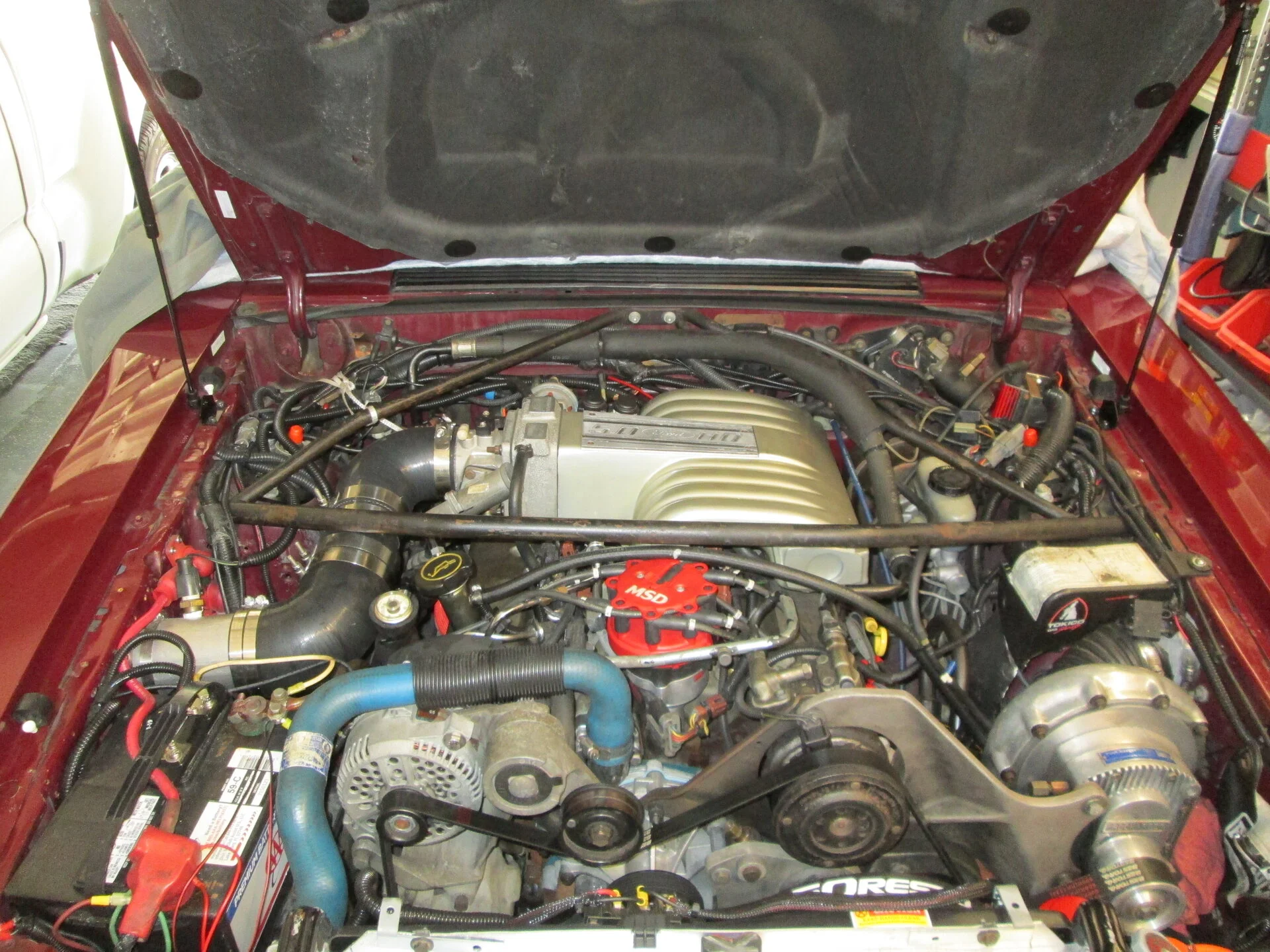

There's room inside the fender for a conical air filter. Remove the stock airbox & use that hole with a 3 in pipe.
You can see it on the passenger side. In my case, that's the outlet of the intercooler & the MAF is inside the fender.
You can use the hole on the opposite side if you remove the washer reservoir which is where my conical filter resides.
Mine is routed to the fender with a 4" AFM Power Pipe. I won't likely change the routing but I could def see myself making an air-box for the fender to contain the conical filter. I'd also incorporate a drain hole in the bottom and debris vent out the back.
