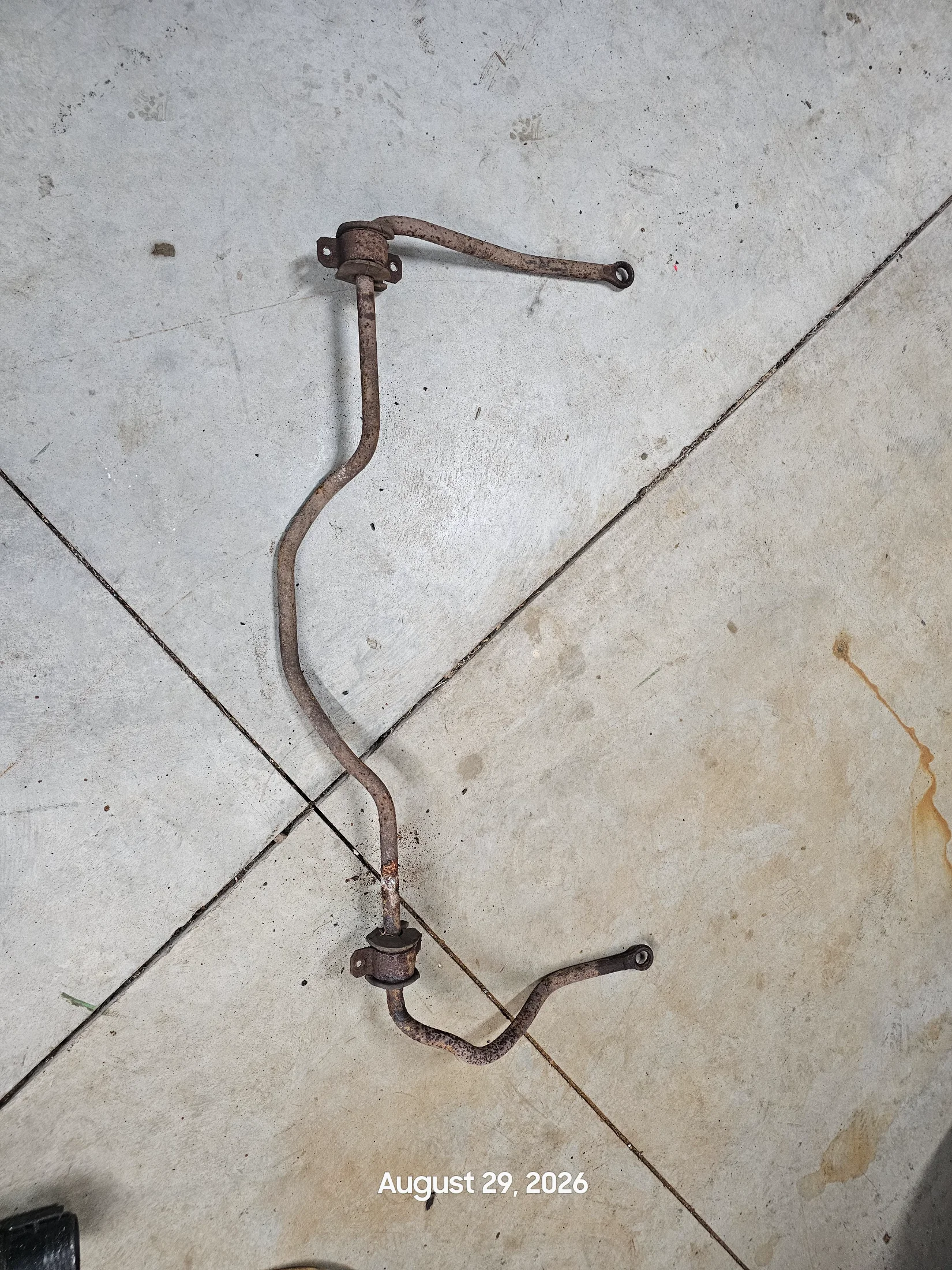

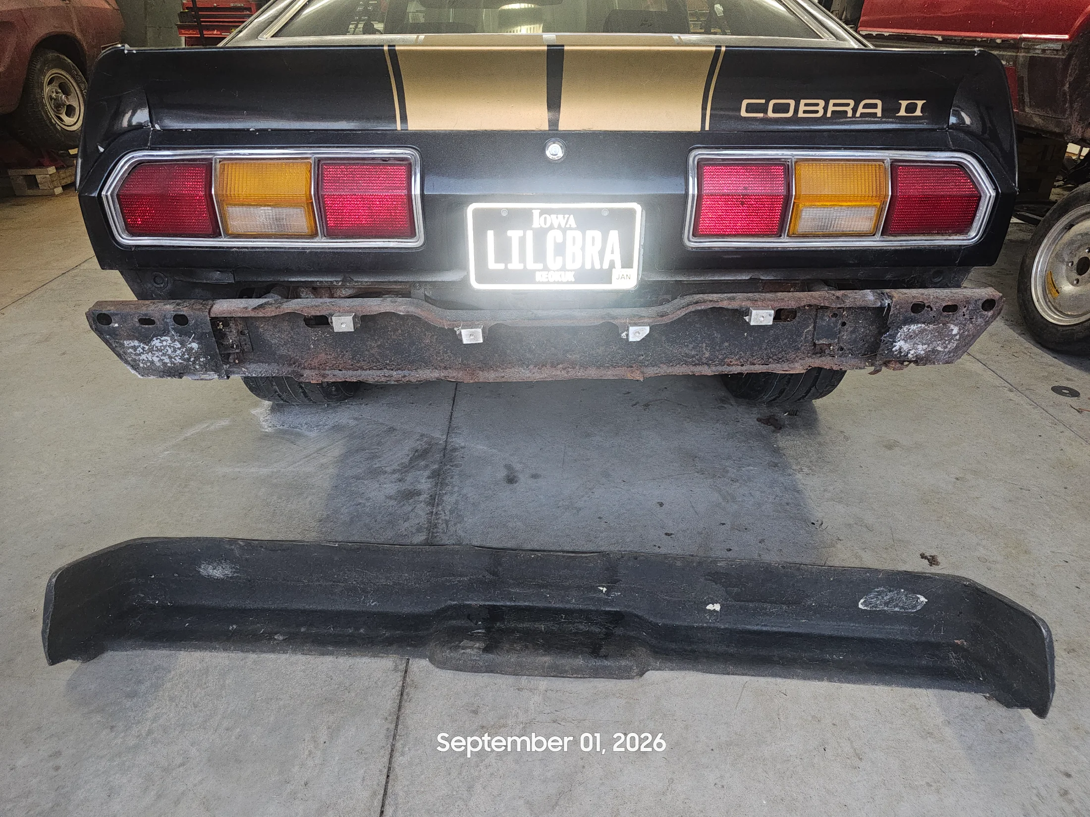

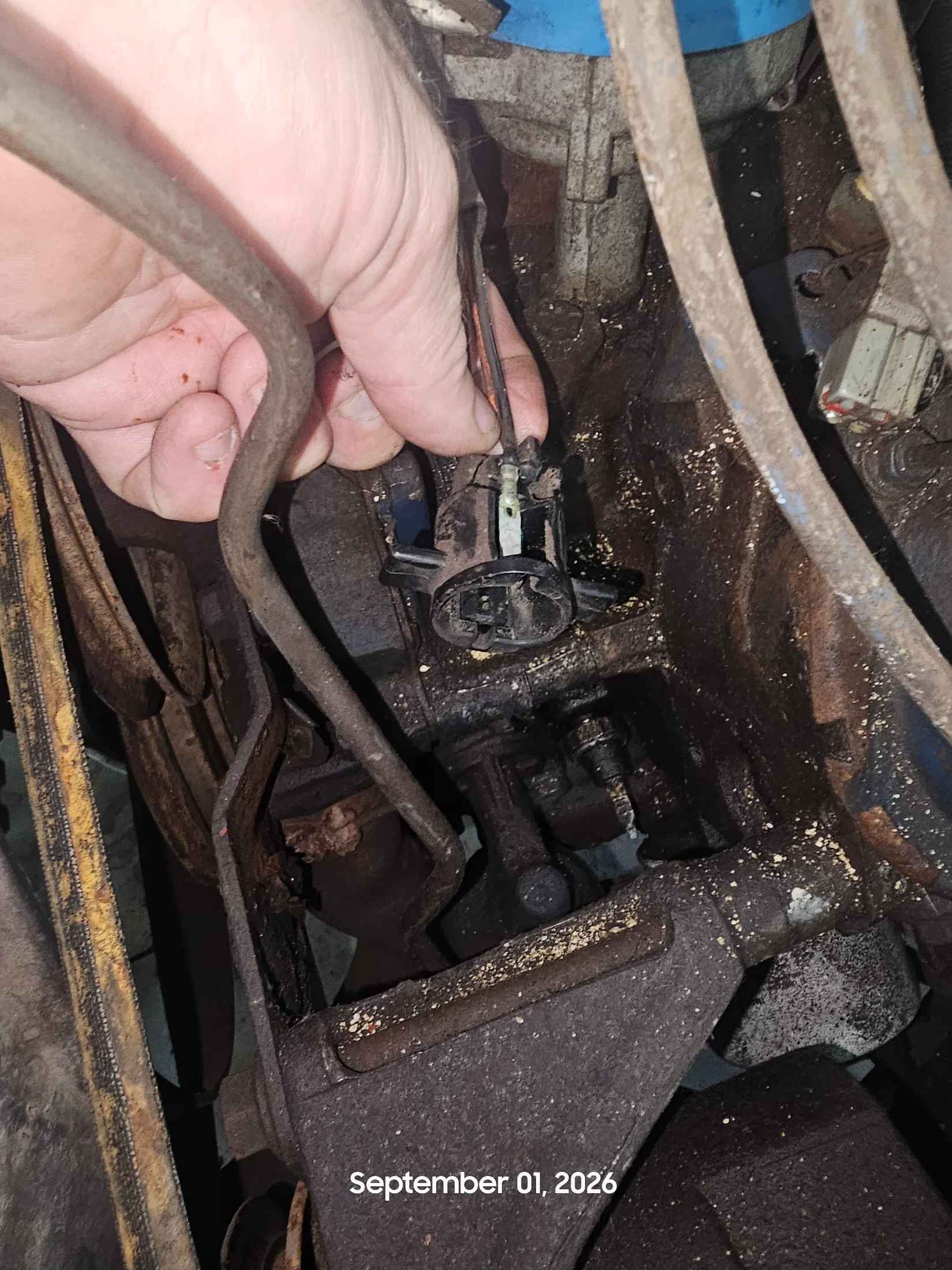

More time in the garage this afternoon. Got the rear sway bar removed and pulled the trim from around the T top openings. The sway bar:
Someone broke a drill when they converted this one.

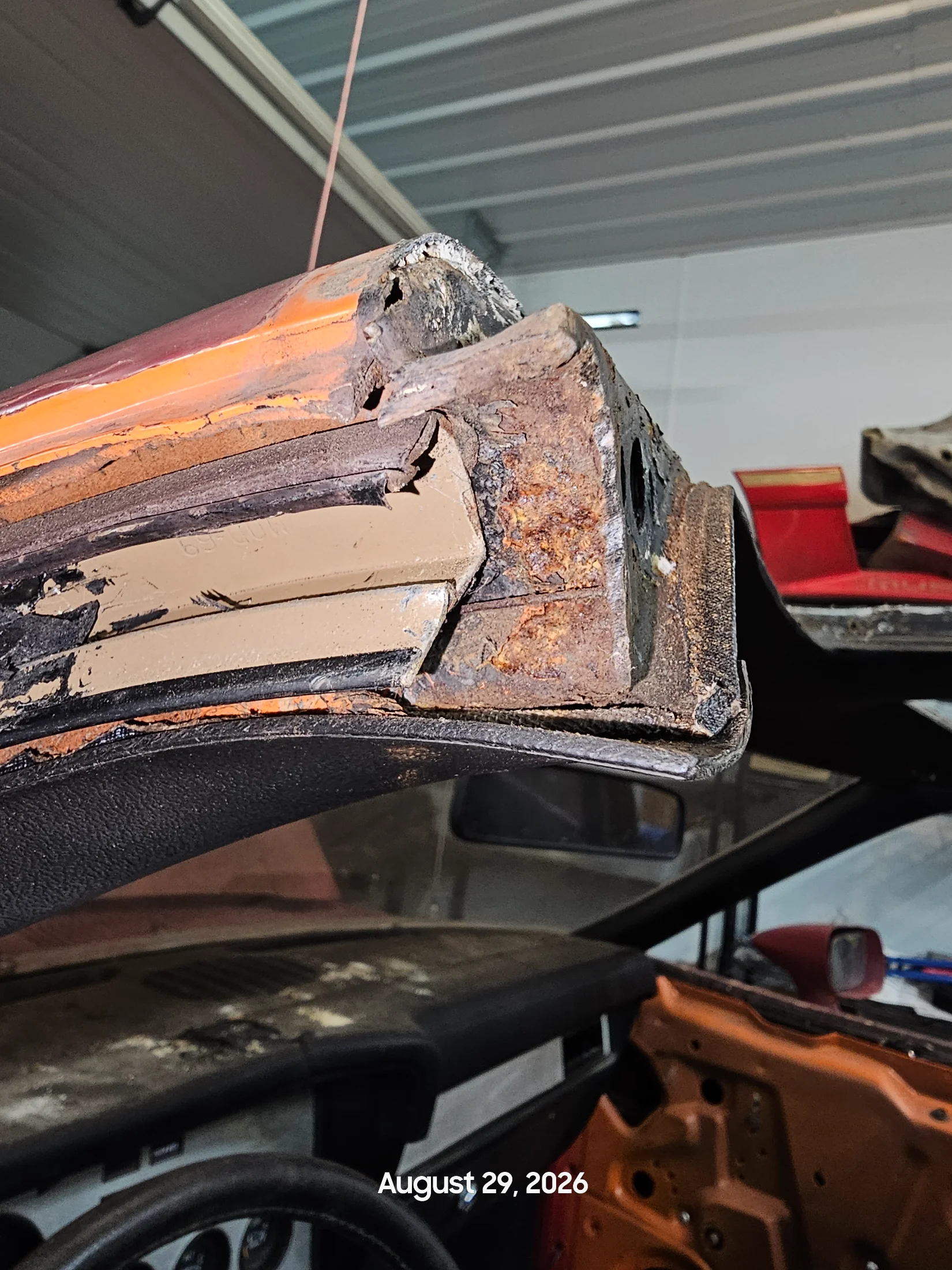

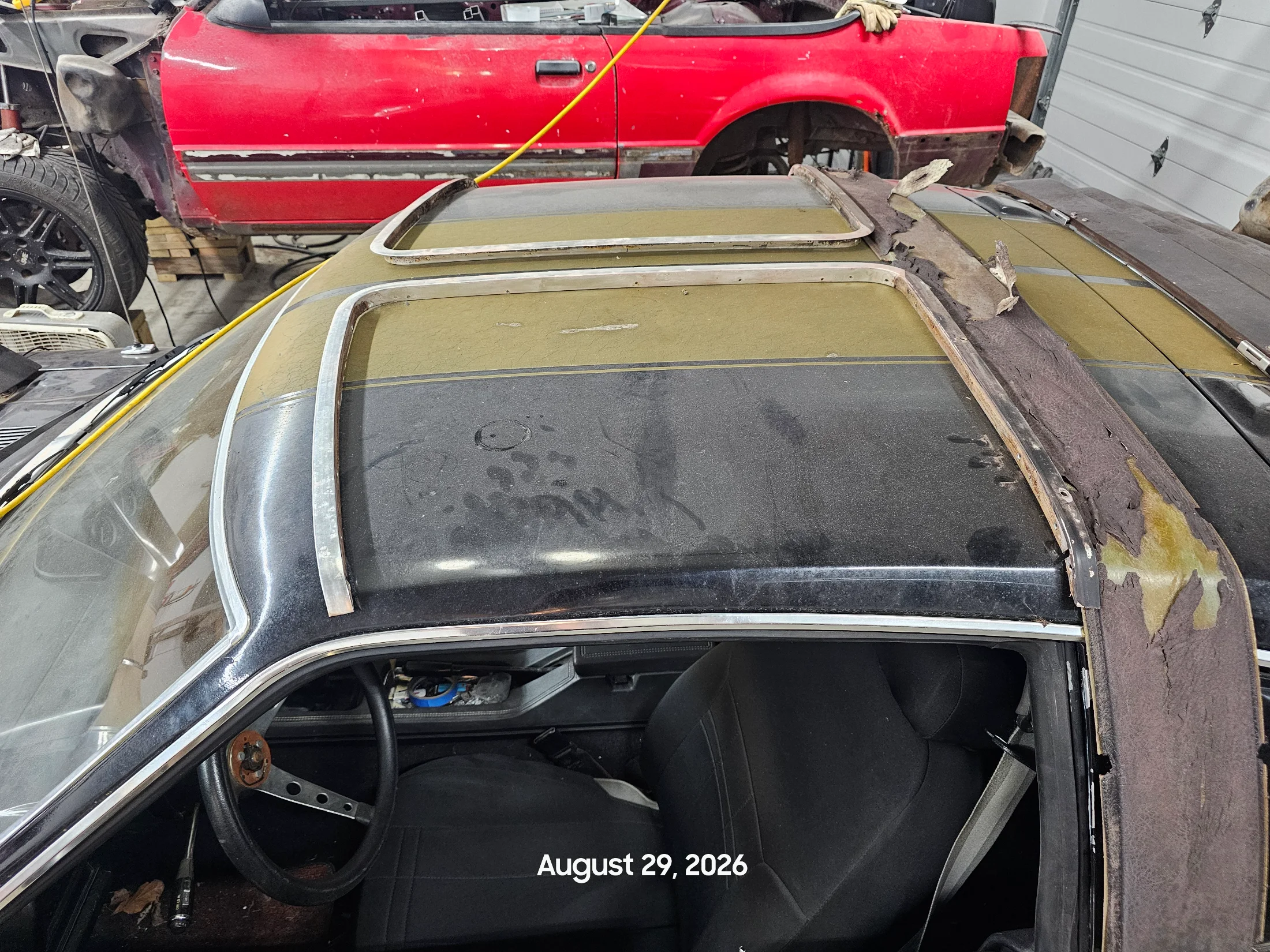

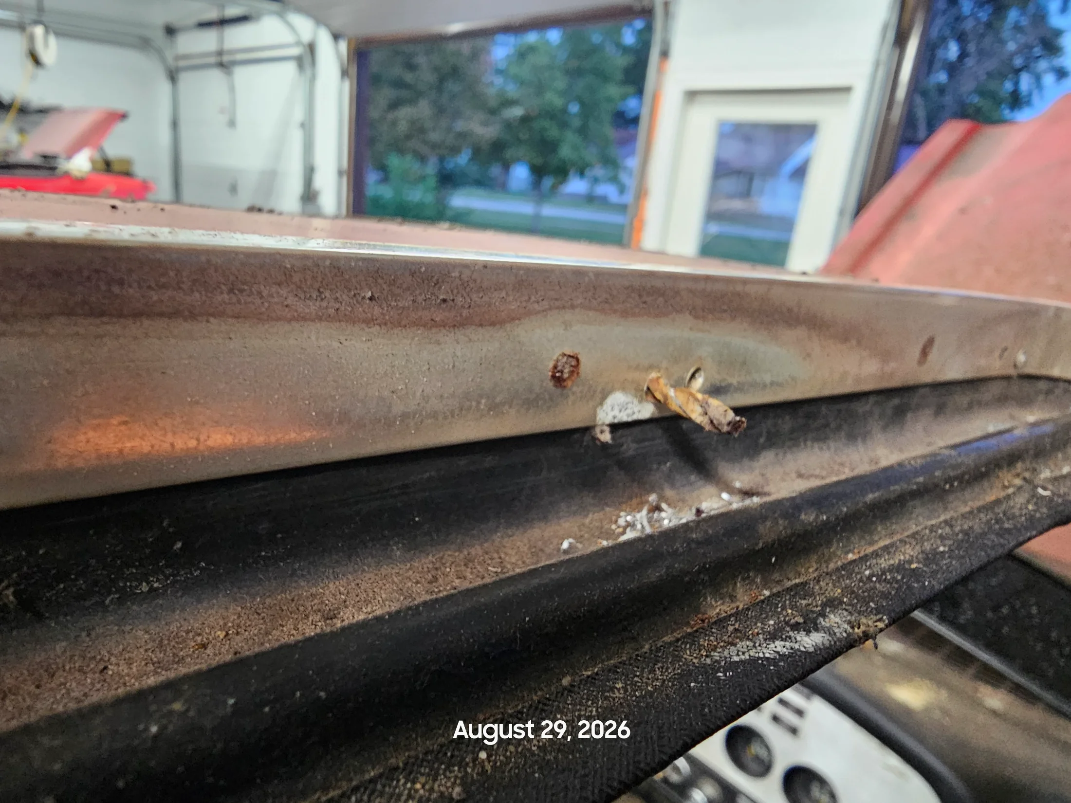

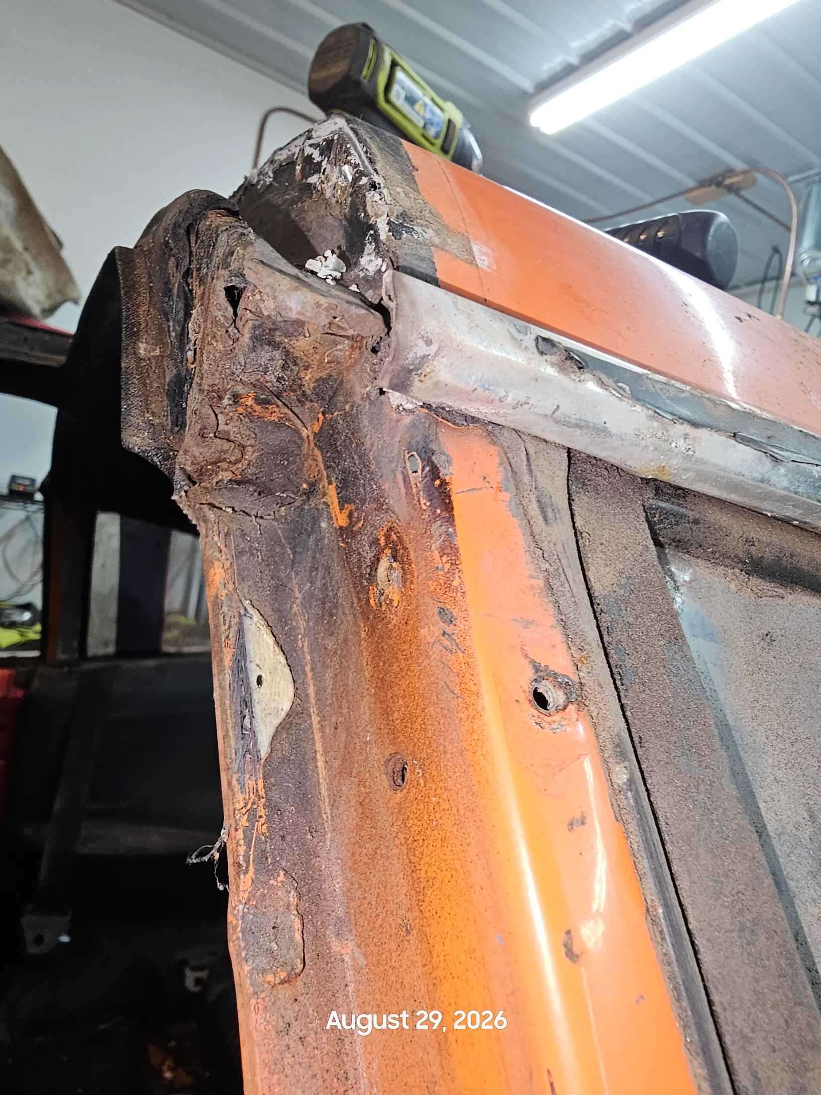

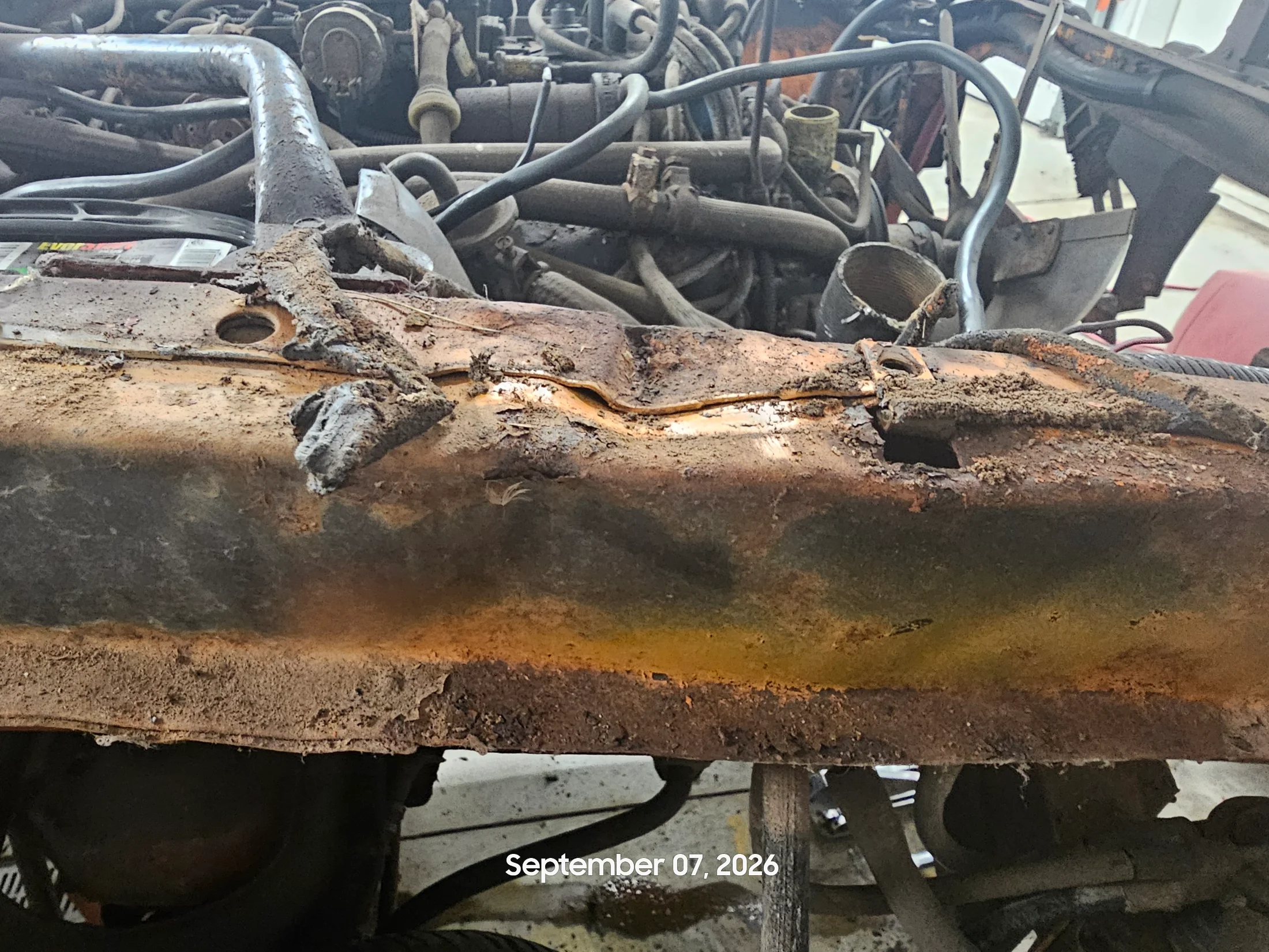

And this might be a reason that they all seemed to leak - there was only sealant at the front and rear, none in the center between the two glass panels. But you can see that the roof panel was spot welded to the inner brace.

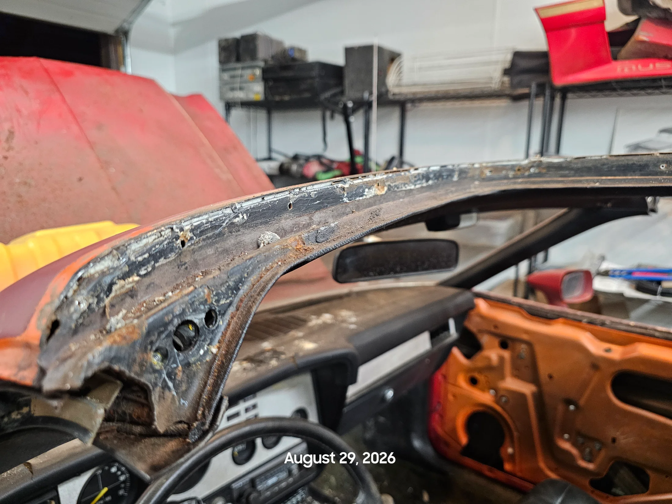

I believe, after watching the video I shared in an earlier post, that the brace is welded at the A and B pillars. I took a pic of each for reference, hopefully they'll come in handy.

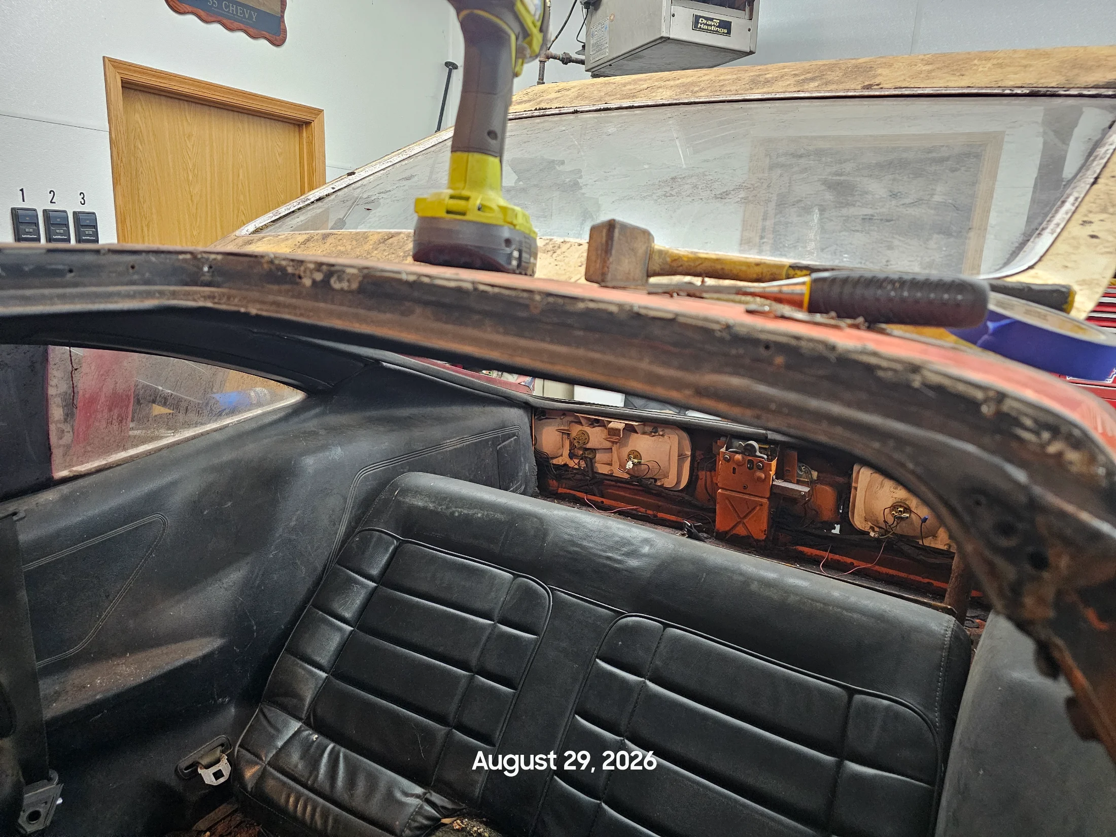

And I laid the trim out on my car using the fiberglass part of the targa band for reference. There are 2 holes in each of them that I'll need closed back up before I can use them on my car.

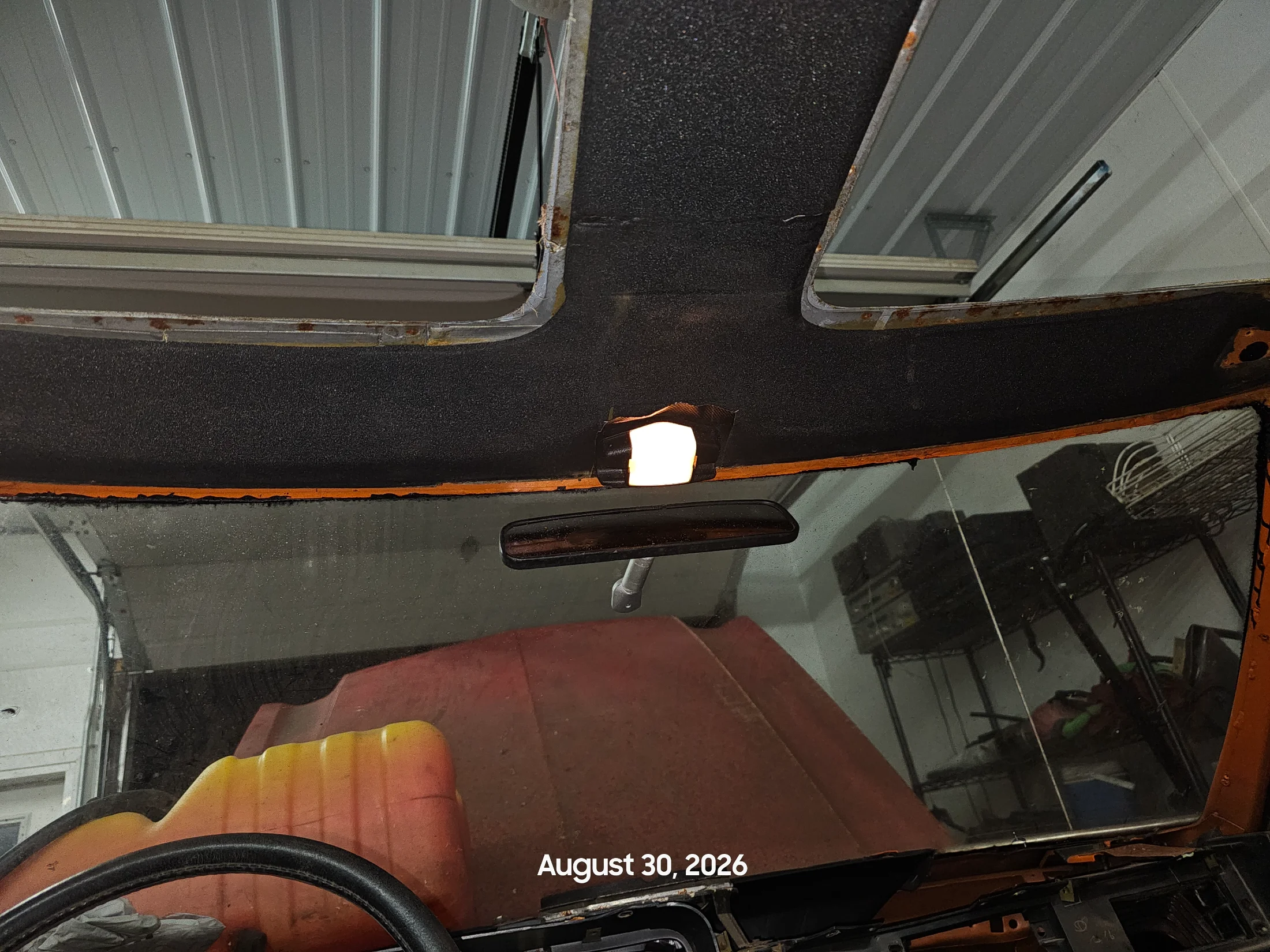

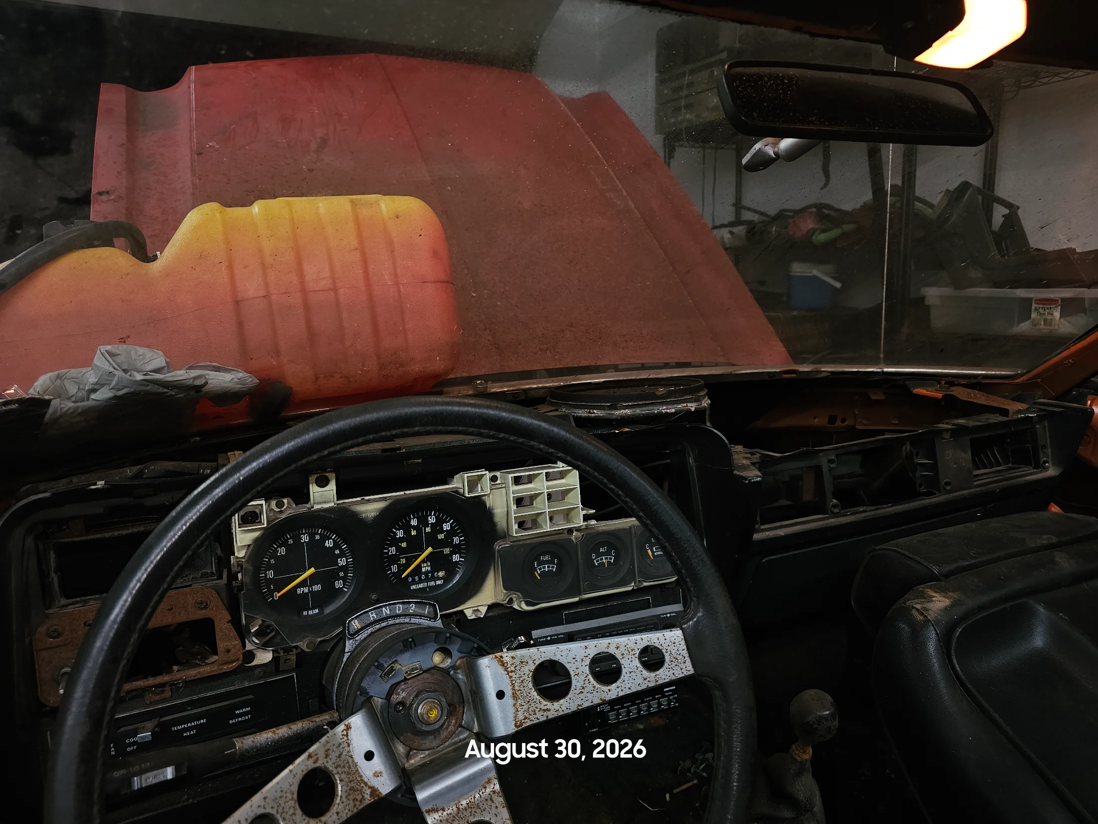

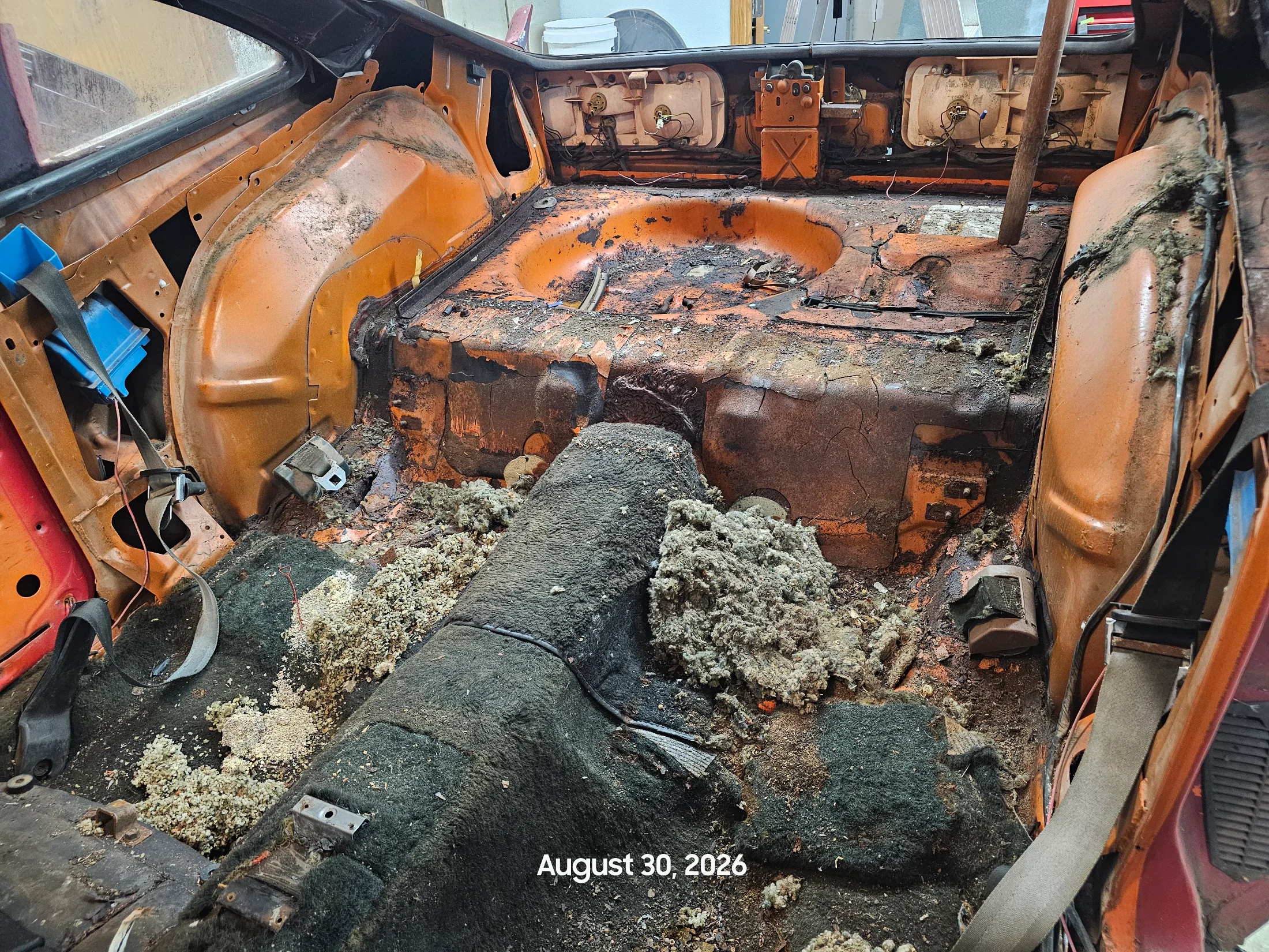

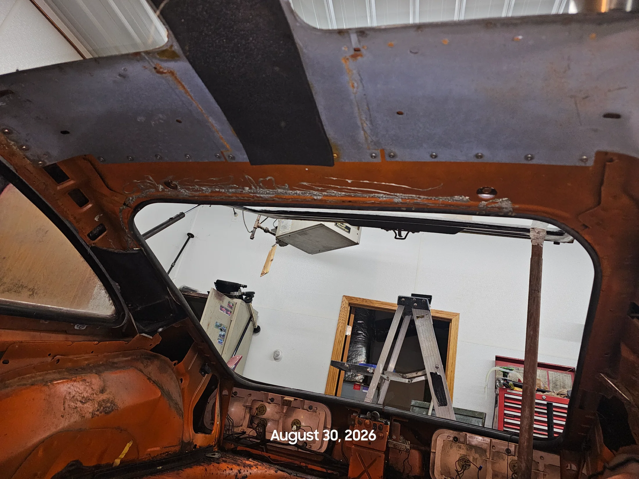

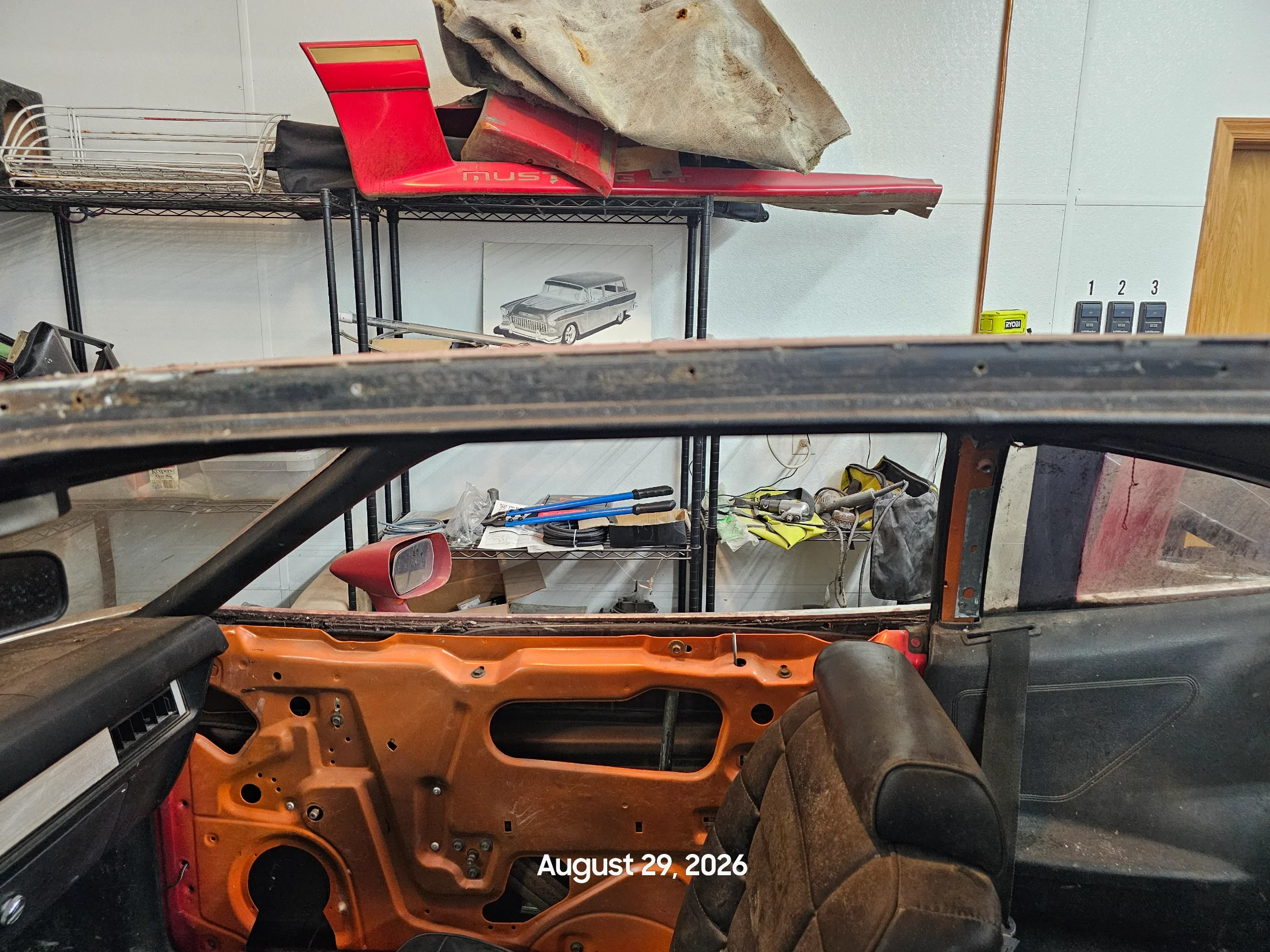

More teardown tonight. Got the rear seat, cargo panels, dash cap and bezels, all of the interior trim removed, and like 99% of the headliner out.
As bad as it looks, it's surprising that there's no mouse urine smell.
Here is the inner T top structure showing probably half of the rivets. The front and center are covered with foam. I'll have to dig along the front to locate all of those rivets.

I think thats a rear sway bar. That make me think, that I ask if the car has a 1 inch front sway bar?
Yes, it's a rear sway bar and was one of the things that interested me about buying it. It's not a Mach 1 nor does it have the 1 inch front sway bar. It seems that all 78 cars had the rear sway bar from the limited research I've done. My car is actually a 78 and had one too way back when. Unfortunately I foolishly got rid of it when I tore the car down in 2001.
