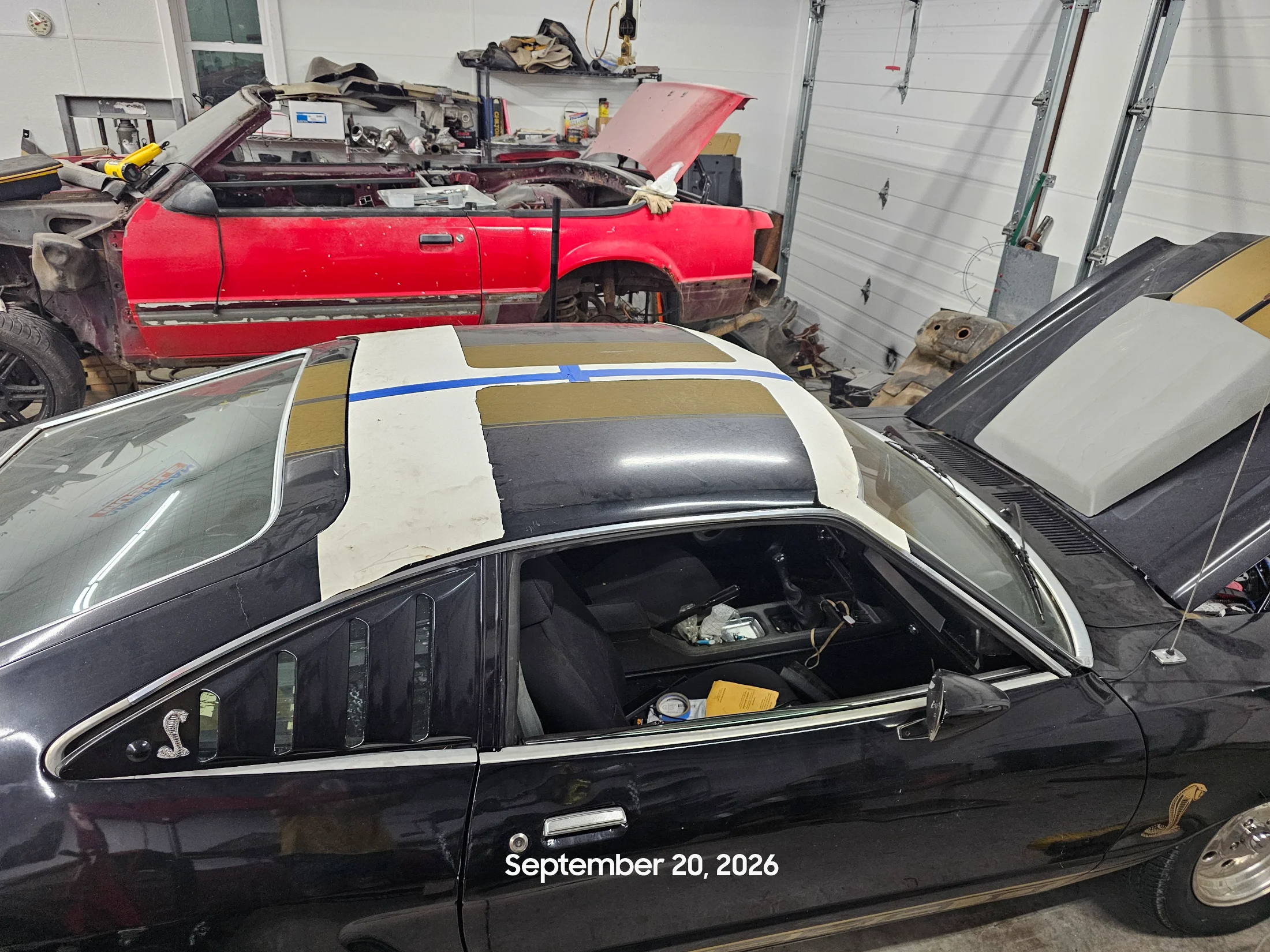

I have been contemplating swapping roofs on the rotted orange t top car and the Mach I. I was considering how to do it. I was not looking forward to cutting both roofs off and trying to get it lined back up right.
Just taking the t top bracket out never entered my mind.
And here you are documenting it.
Thank you for another tutorial.

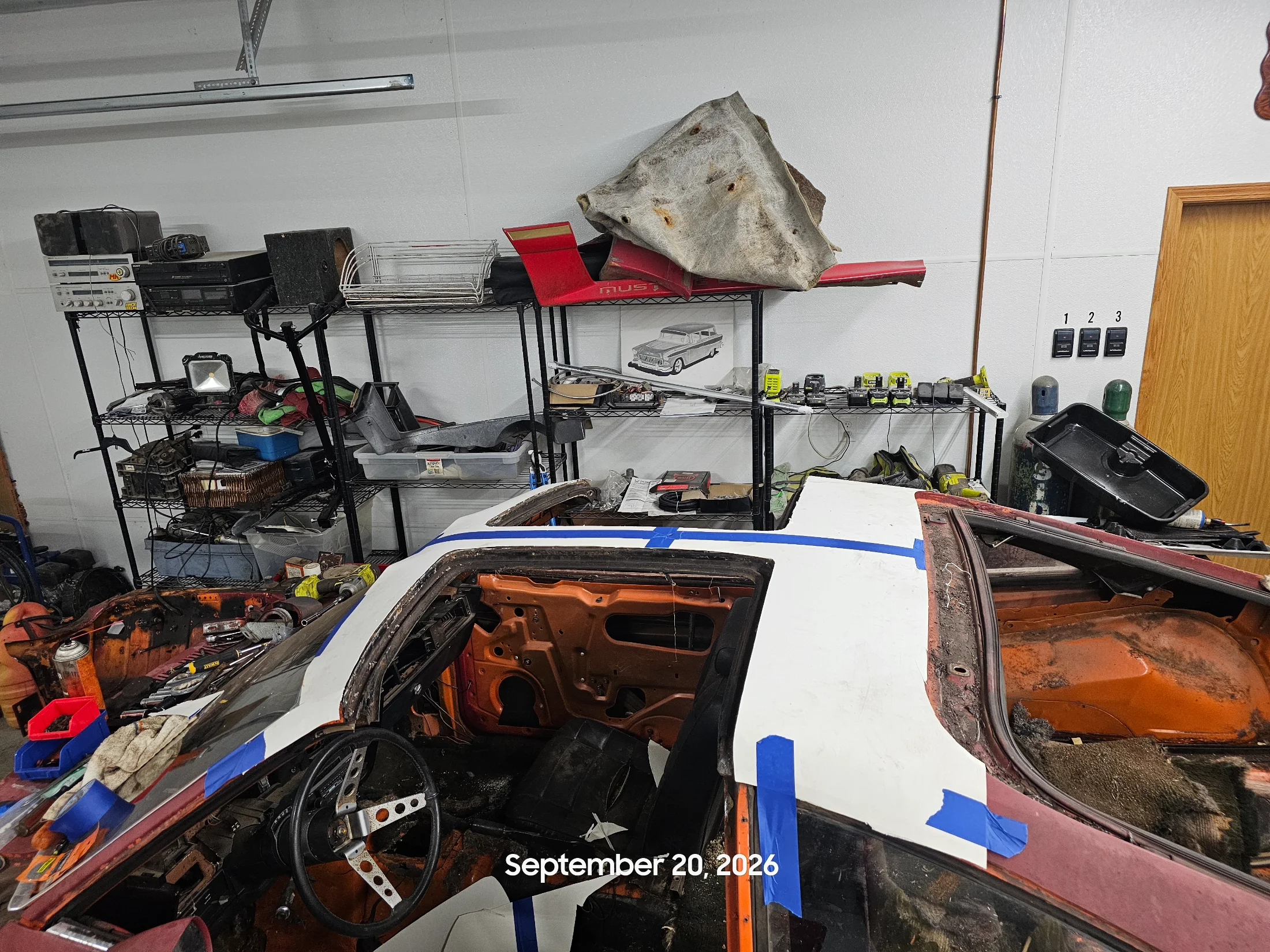

Documenting slowly but surely. ;)
The idea came from a YouTube video I ran into a while back of someone converting their Foxbody into a T top car. I didn't really think too much about it other than it seemed easy enough. I mean I knew these were converted somewhere before Ford took them in-house, but didn't put a lot of thought into it until I found this wreck on Craigslist. The thought then re-entered my mind but wasn't a serious thought until I saw everything else that this car could provide for mine, so I decided to give it a go - and here we are! I don't really think it'll be all that bad once I get into that part of it all. But I think someone would want a good, solid base to start with before cutting the roof apart, which led me down the rabbit hole I'm currently diving down. I have roughly $500 worth of parts in a couple different online carts to more solidify my car before I get into the swap, so it'll be a relatively long term project. First things first though, I think I've gotta get the T top car stripped down so I can get rid of the shell. That would give me more space to get it all done.
Reinforcing the car led me down the next rabbit hole of creating the web brace that I have a rough plan of building. The idea came from my convertible - I'm using Stiffler's subframe connectors and will be buying their web brace to strengthen that car. I thought that that would be an excellent idea for the T top car since it's the same basic principle. I've kind of been thinking of whether or not it would be something that might interest other II owners and if it might make me some extra $ since I don't know of anyone making anything like it for our cars. Then I think "f-it - just share it" because it's not always about money. I'd almost have to team up with Stumpy's fab shop since I'm using their subframe connector. It seems that he/they could actually build it when they make the connectors and sell them through whatever network they have and just share a royalty or something since it'd be my design. I really think that it'll make a difference with our cars, especially T top cars....

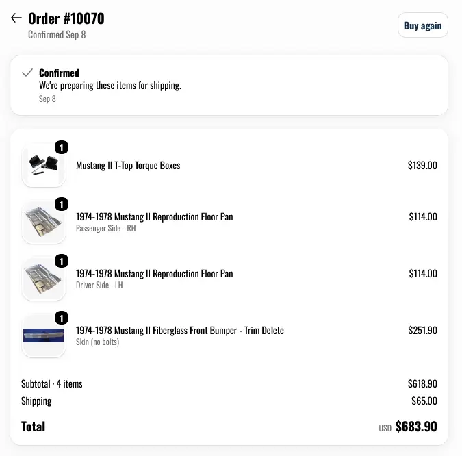

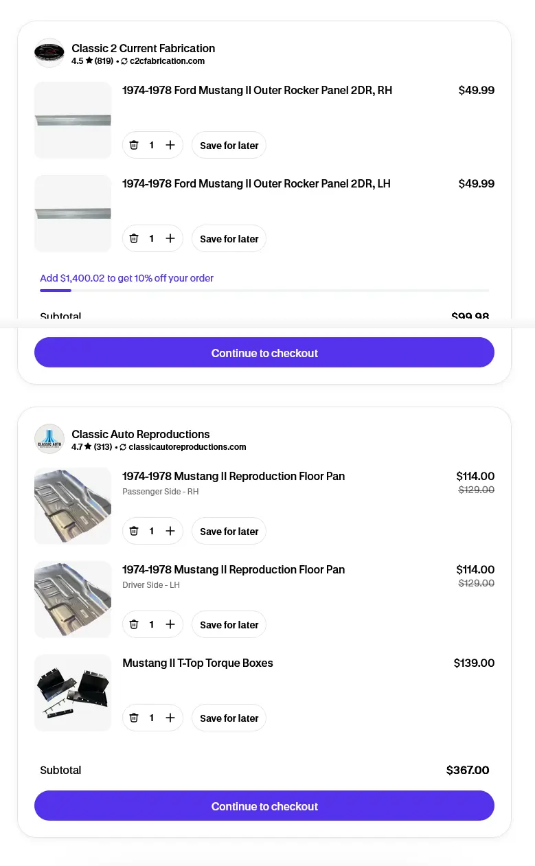

Orders have been placed.
I went ahead and added the front bumper cover to match the new rear I've been working on getting mounted. I added it to combine shipping which will end up saving me in the long run. I'll have to order new weatherstripping from them before this is all said and done. :shrug:

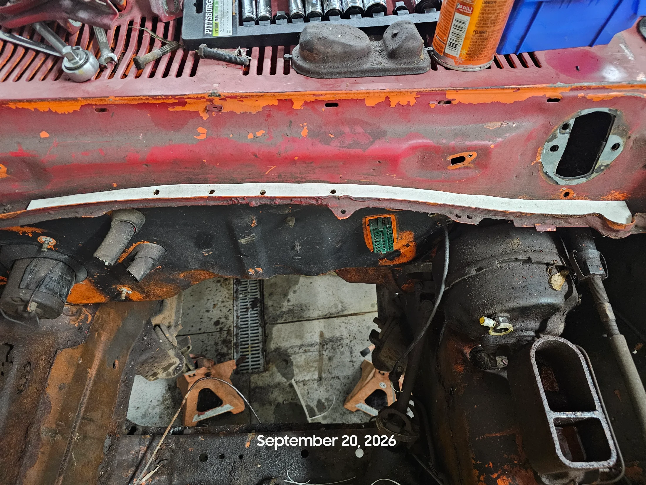

My t top car has a lot of cowl shudder on clutch engagement as well as when hitting large bumps or expansion joints. It has a new mdl clutch and flywheel. The factory bracing, stumpys frame ties and traction bars. I think I am going to copy your rocker reinforcement at some point in time. So thank you for taking us along on yet another adventure.

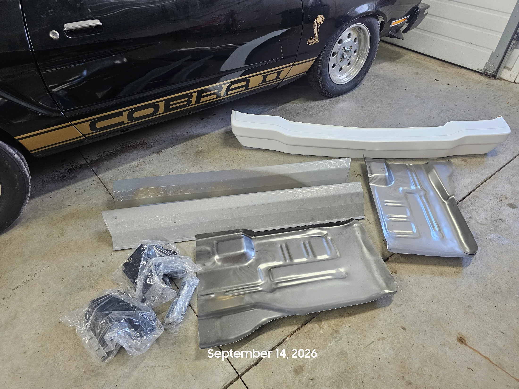

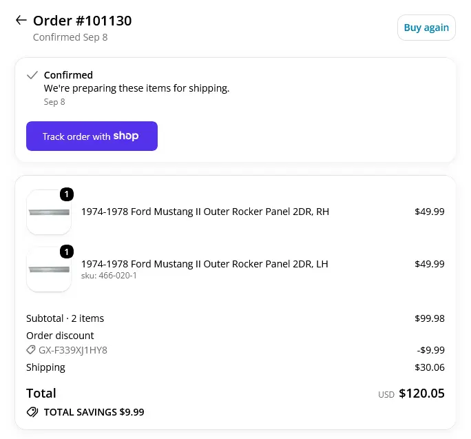

I have parts! :D

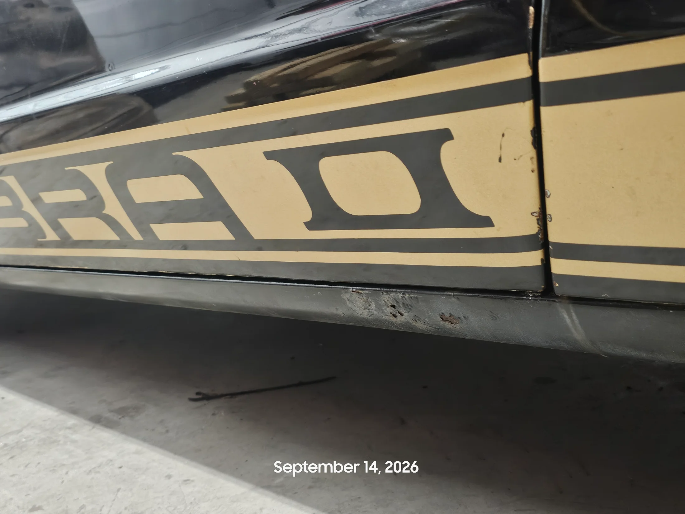

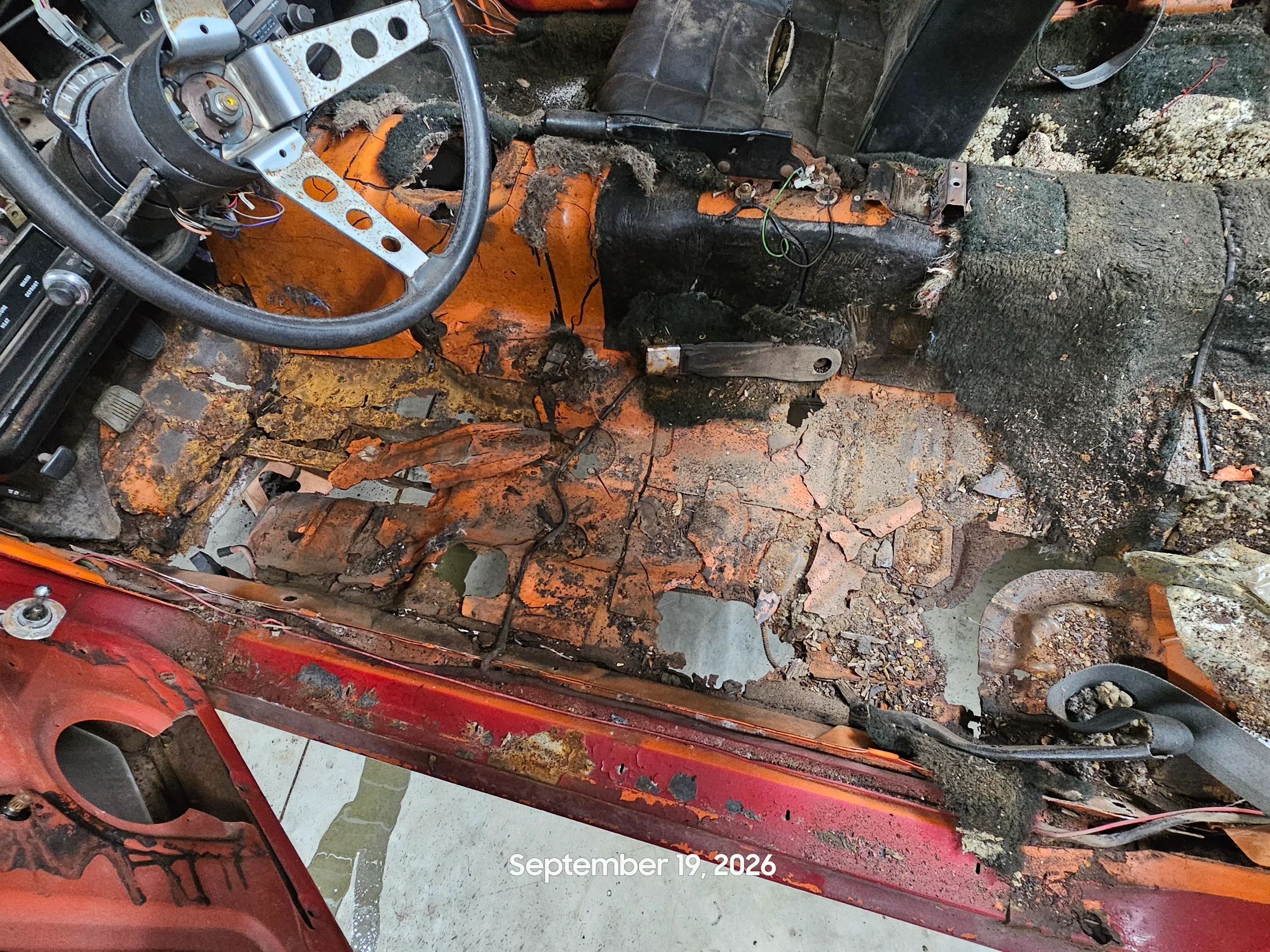

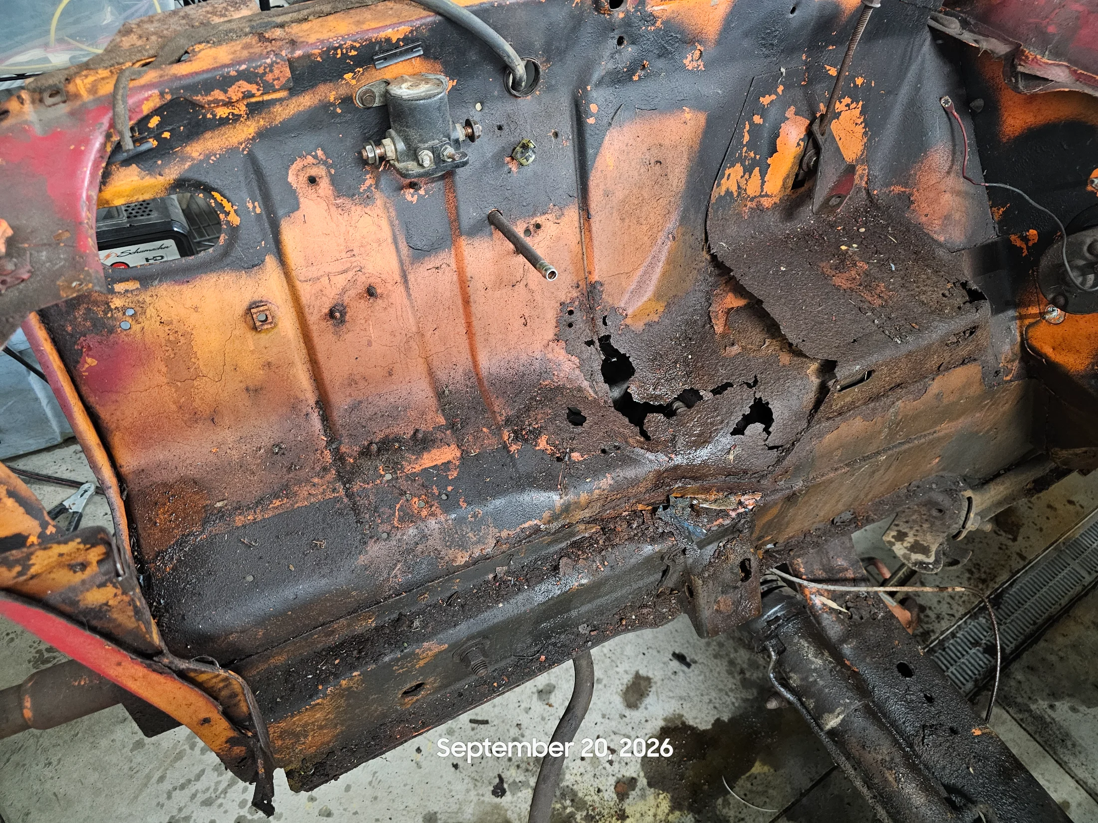

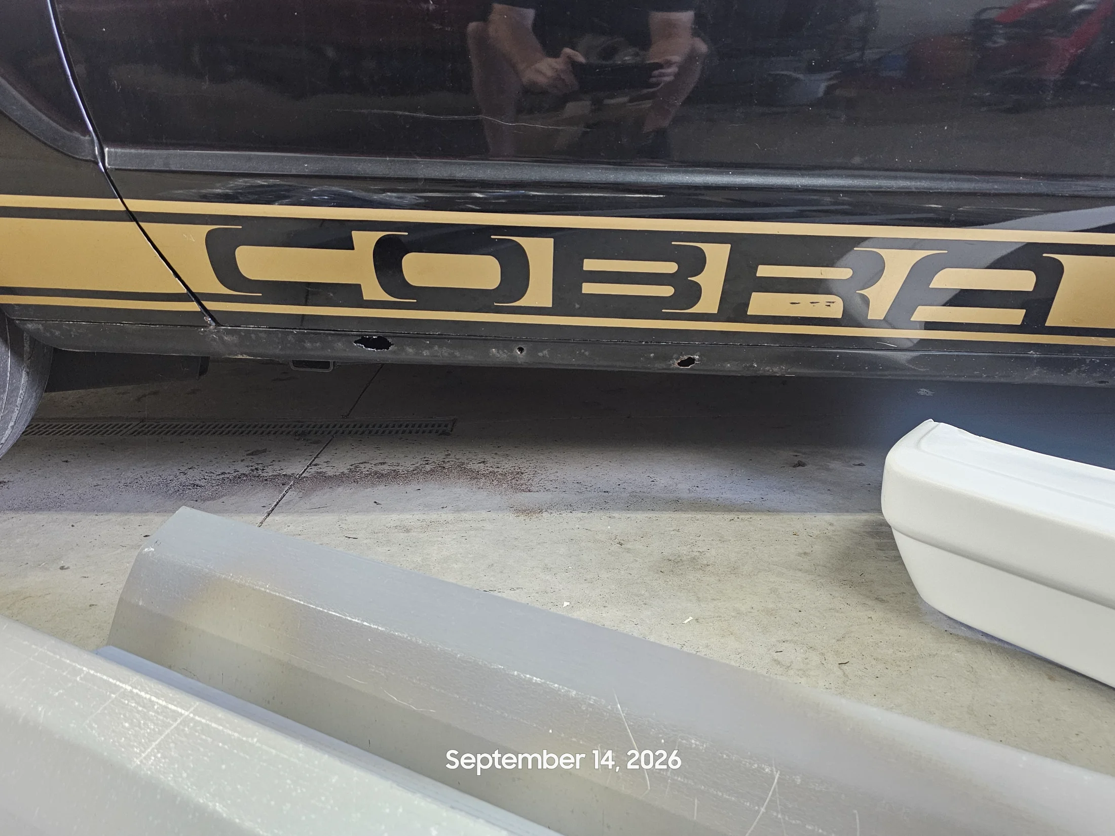

And here's the ongoing battle with the rockers now - they're doing nothing but get worse.

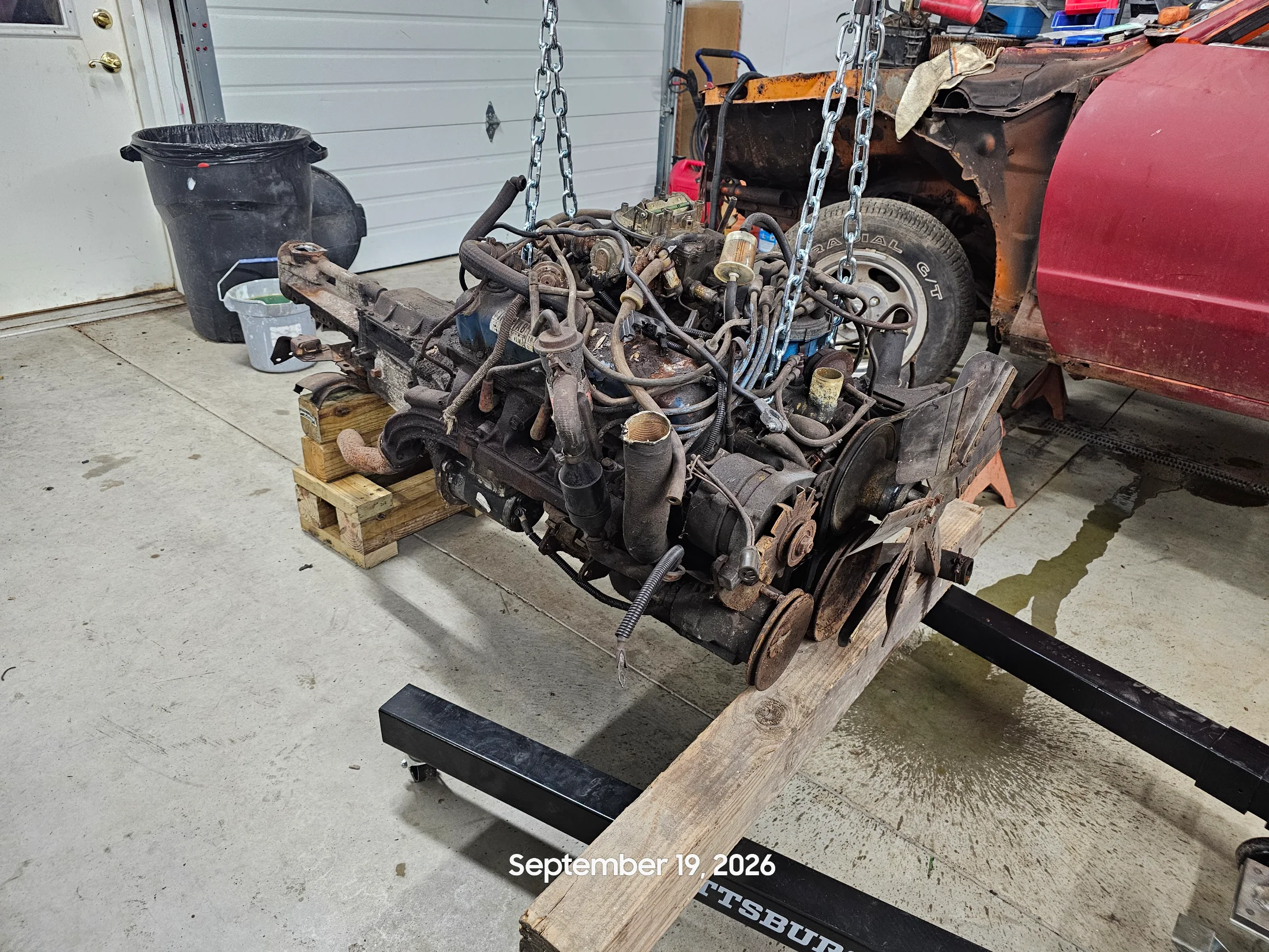

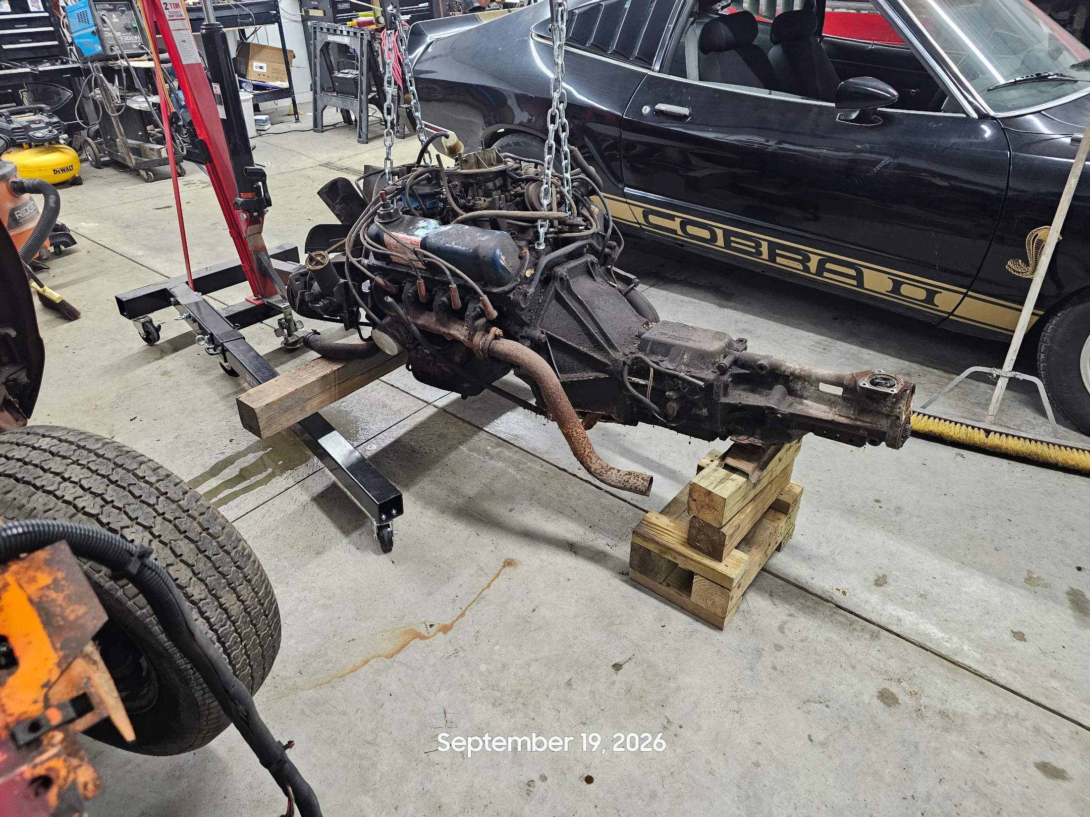

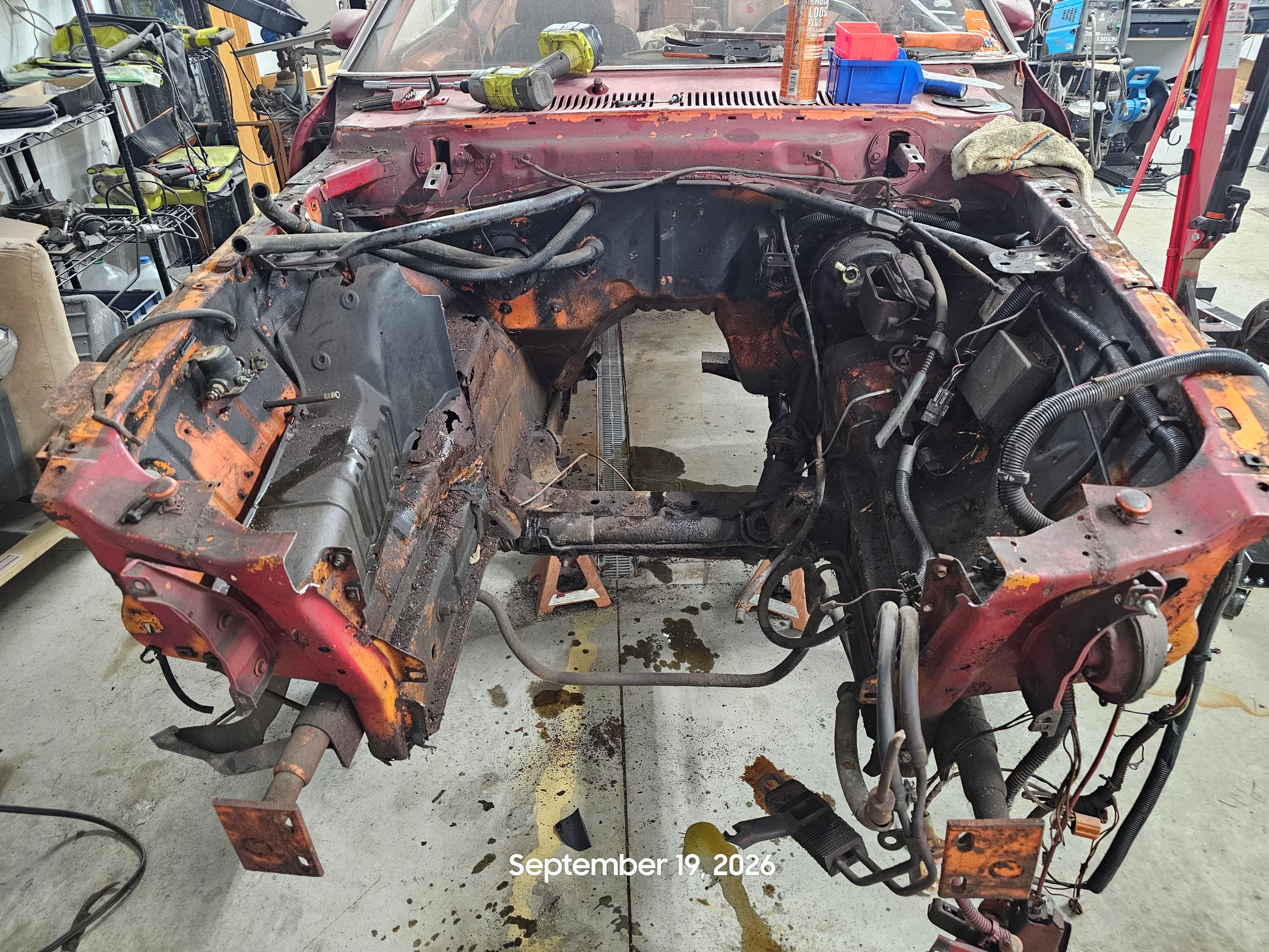

I was seriously planning on starting the process of tearing the engine and transmission out of the T top car tonight, unfortunately my lower back screamed "f-off!" so there will be no crawling around on the garage floor tonight. :(
