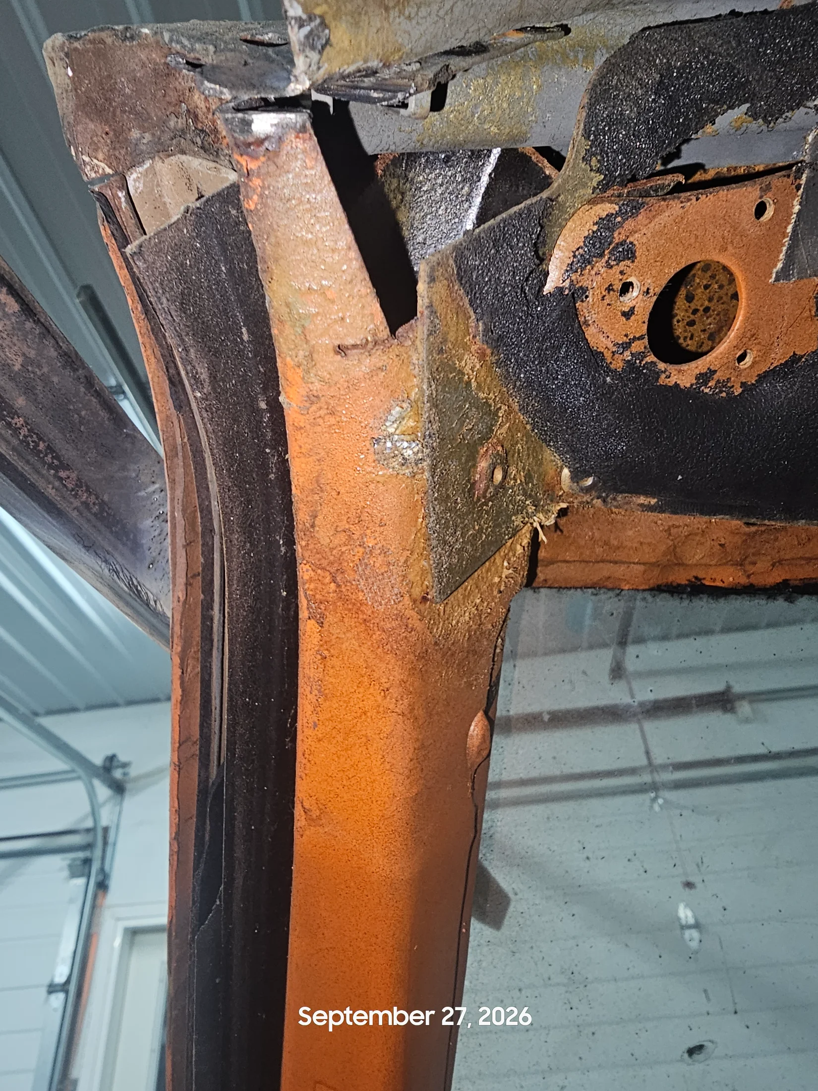

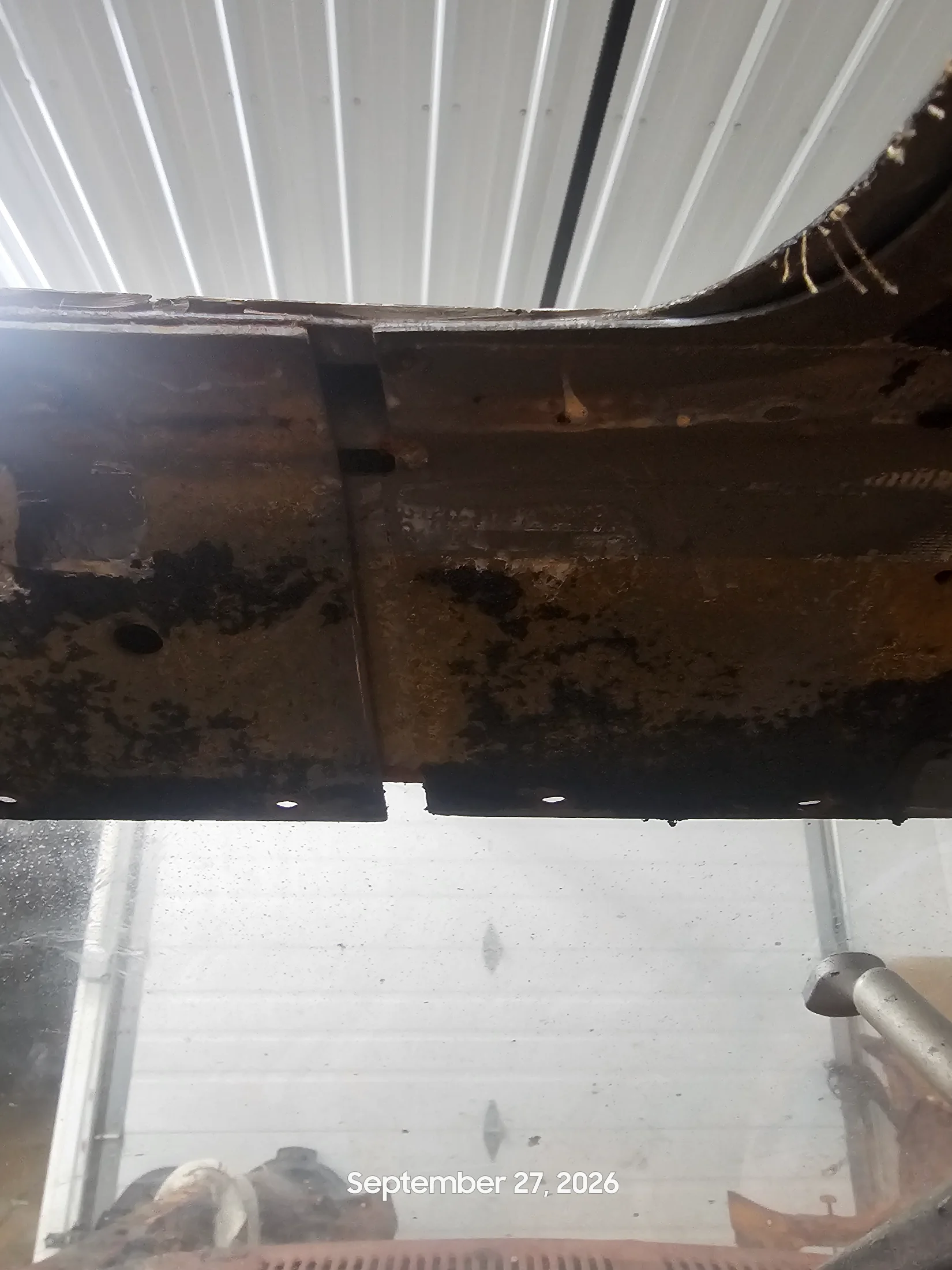

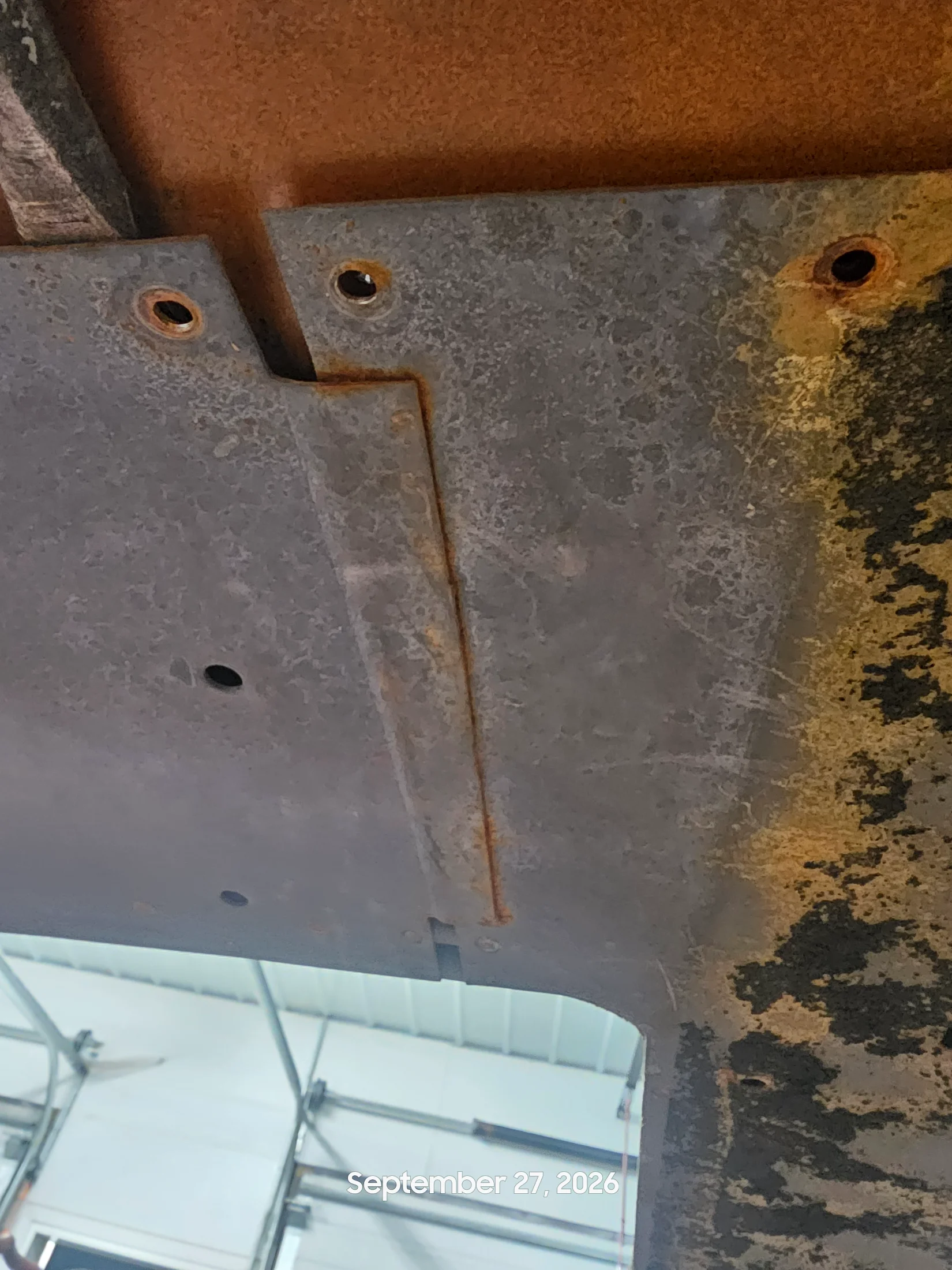

extra_stout said:
One hint: keep the plastic cover in front of the battery to hide additional electrical installations. With cover engine bay looks much neater... at least to me.
Beside that: could you please measure roughly and make pictures of the brace between cowl and fenders and the brackets at the fenders?
At some point I would like to build/install something like that. I have never seen some original pieces live.

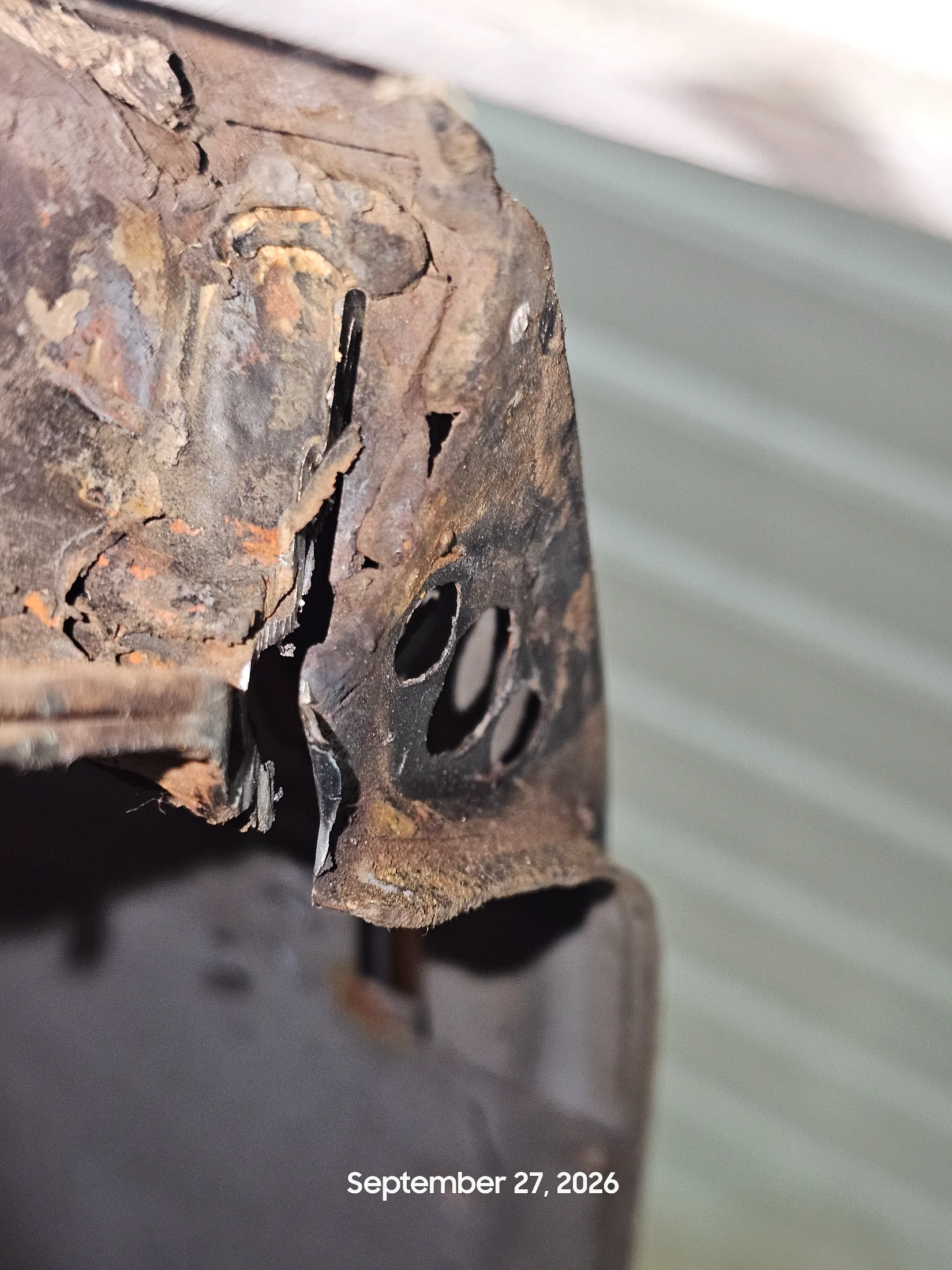

This cooling duct is cracked and missing a piece, but I've saved a few on Ebay since your last suggestion. I'll probably pull the trigger on one sometime in the relatively near future.

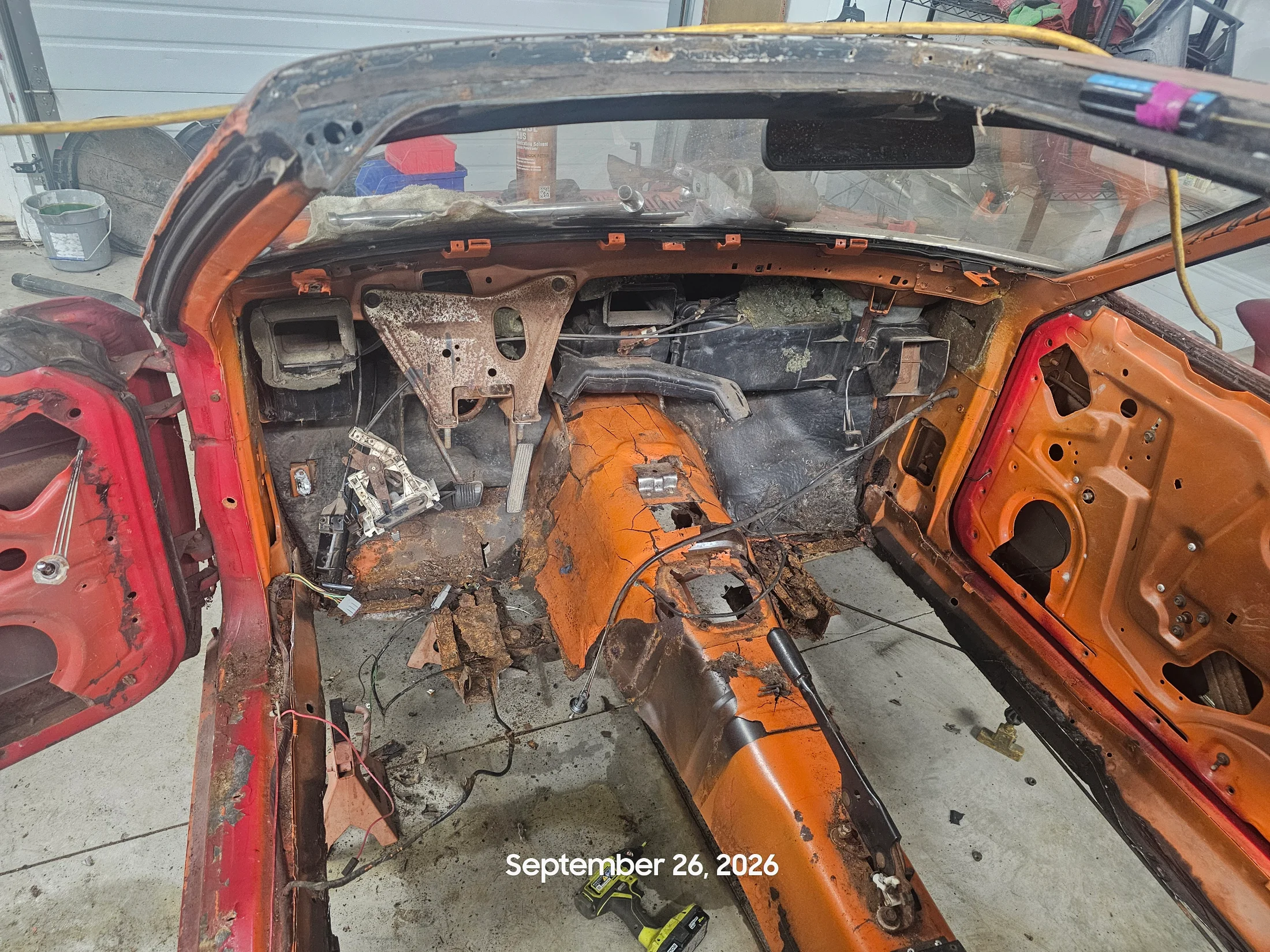

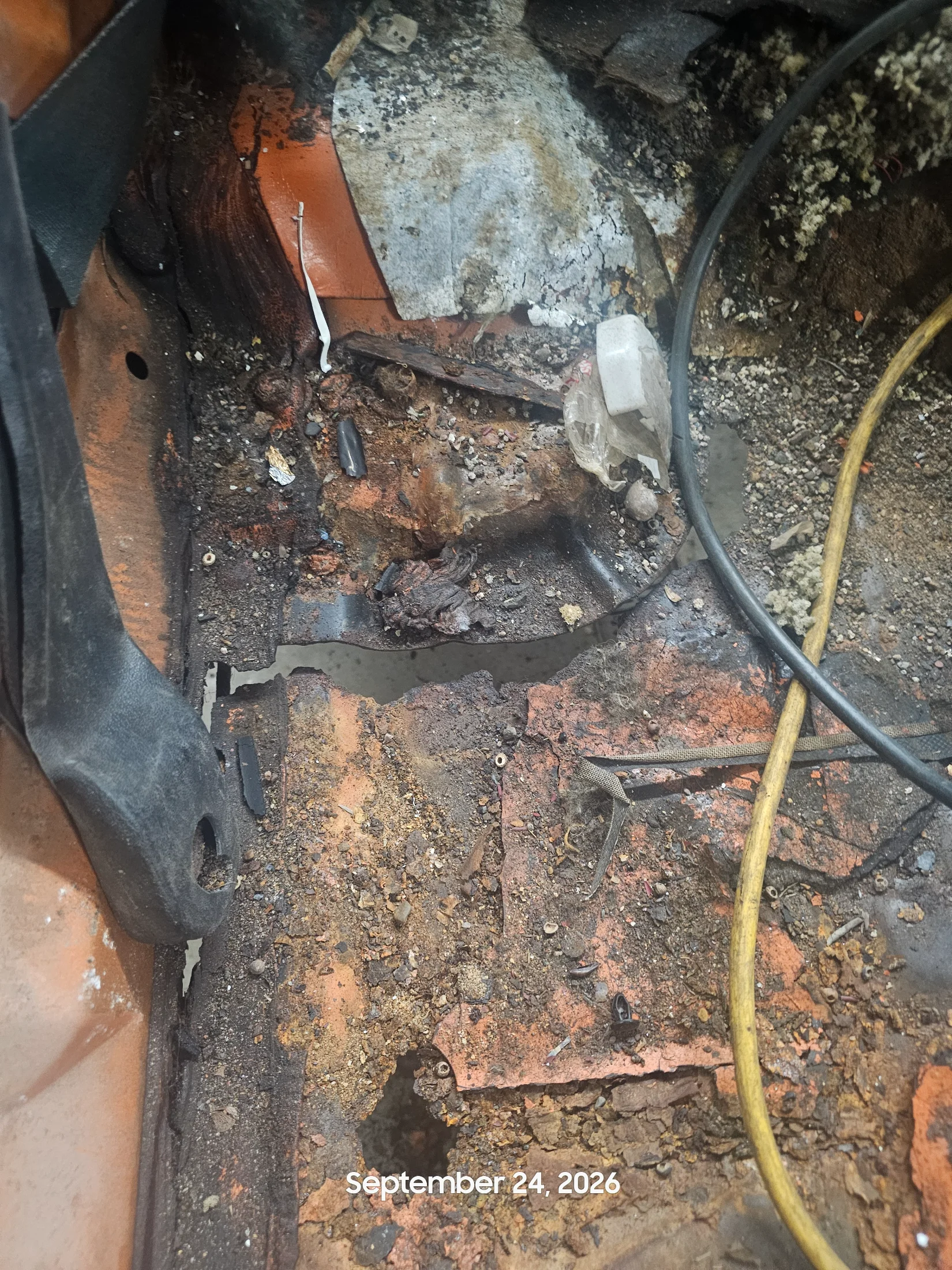

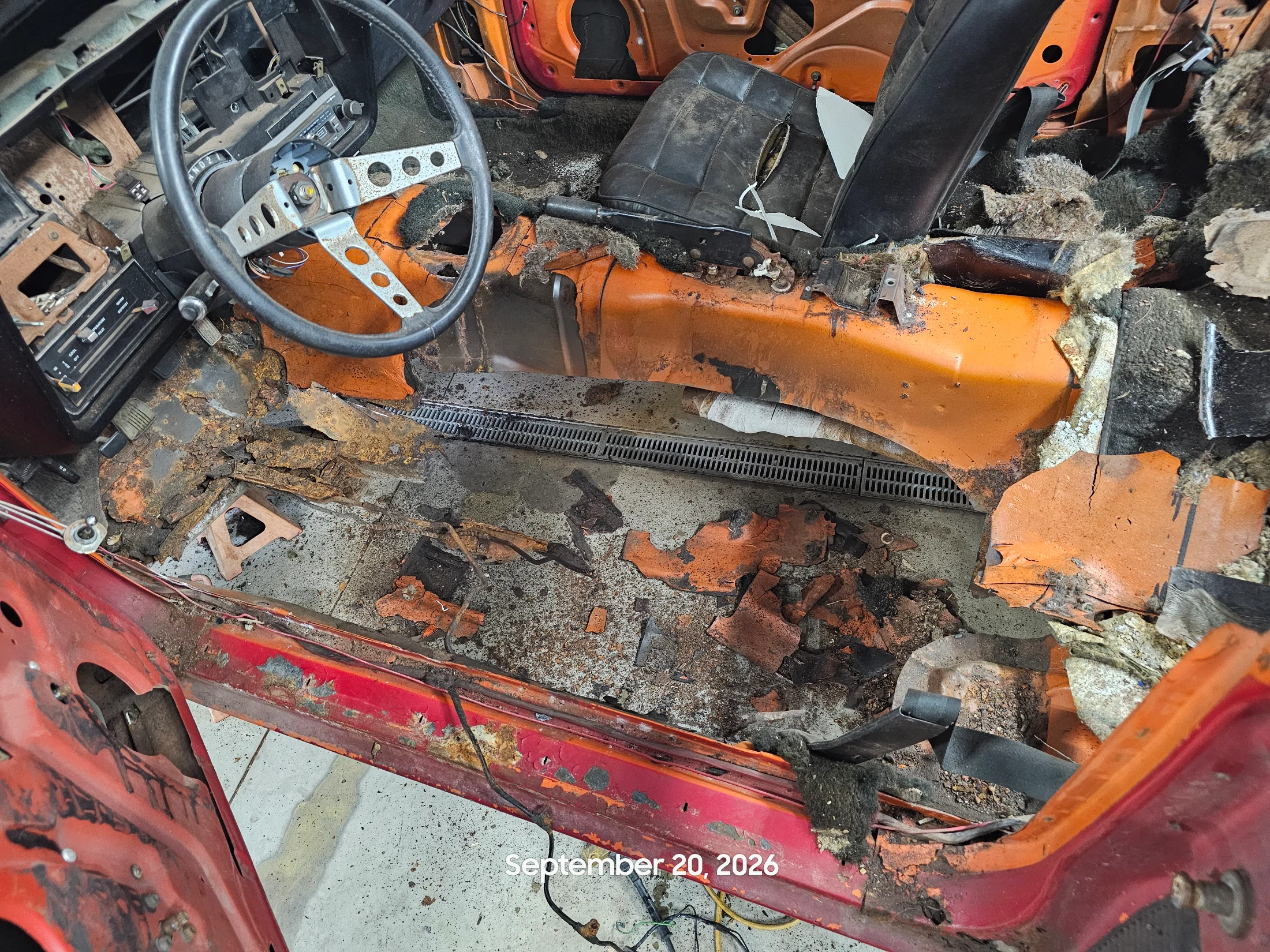

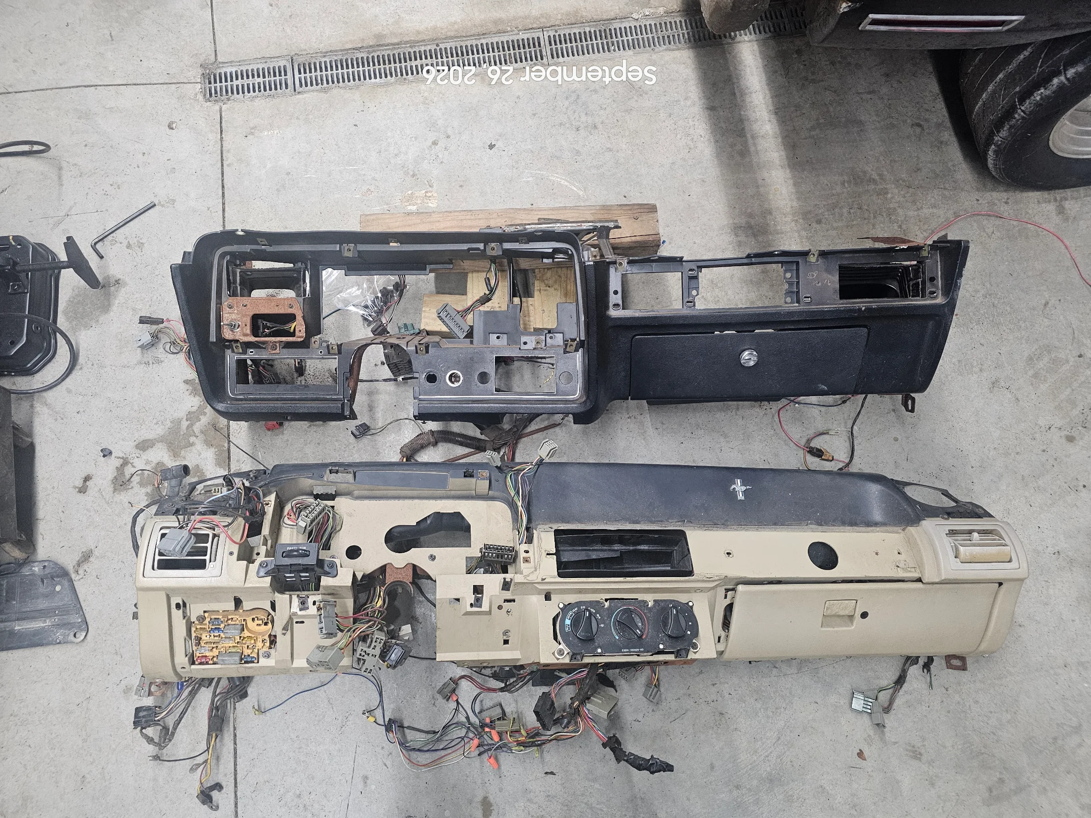

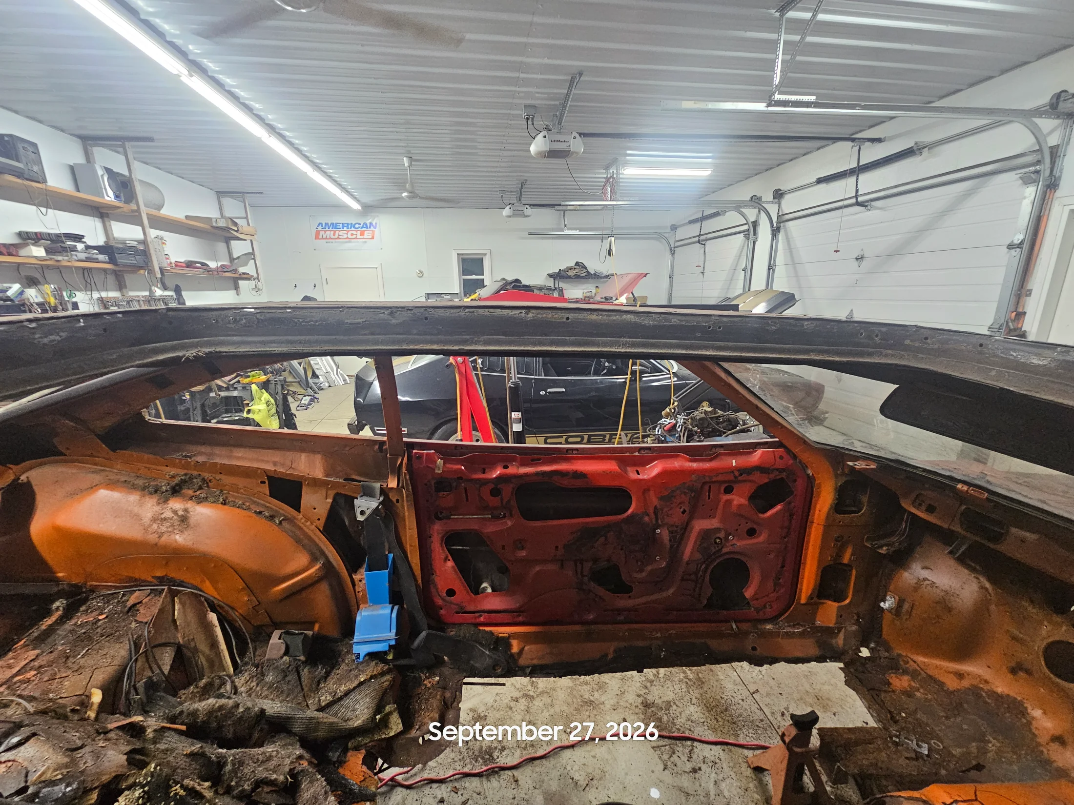

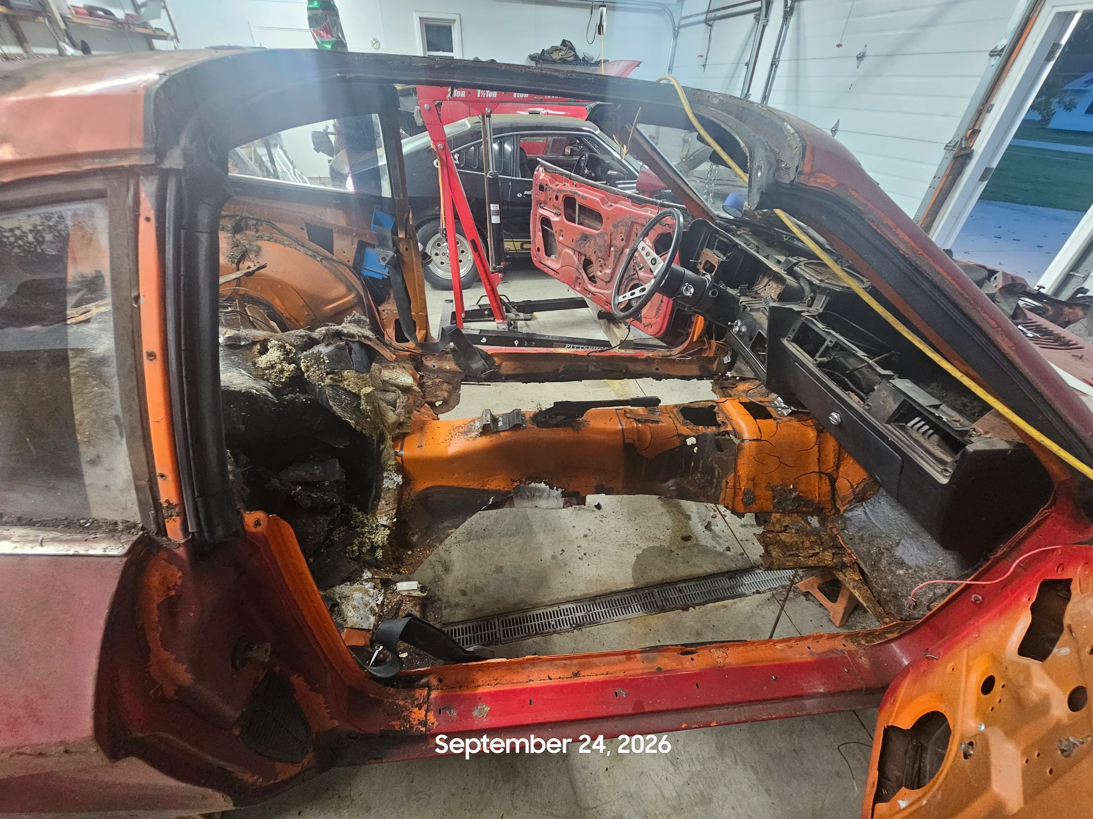

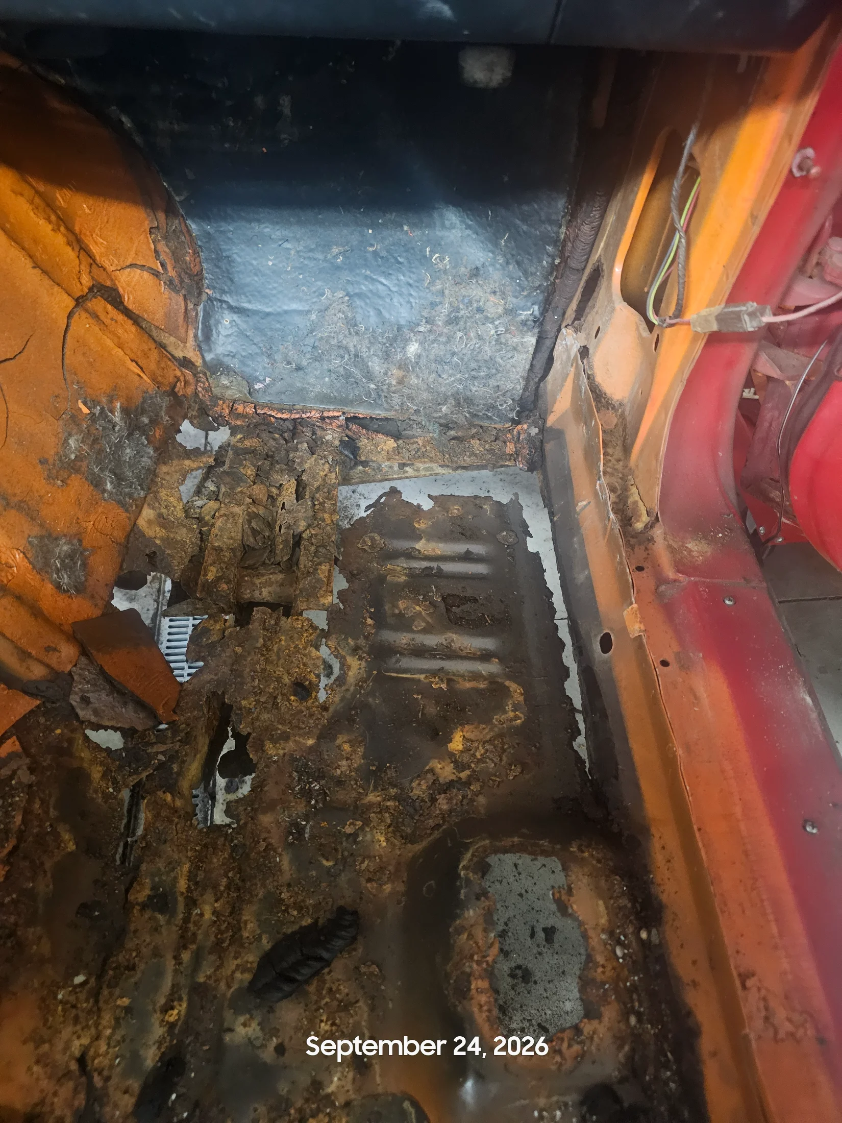

As for the dash removal from the T top car - since I've slept on it, I think the wisest path would be to just cut the driver's floor pan out. Then I can stand on solid ground and probably have more clearance to see/reach bolts and such on that side of the car. Time will tell what the passenger side reveals, but that may get the same treatment. I figure if I cut it at the front torque box all the way back to the front leaf spring mount that I'd have plenty of space. I'll leave the rockers and transmission tunnel intact as those are the structural pieces to keep the car from folding....

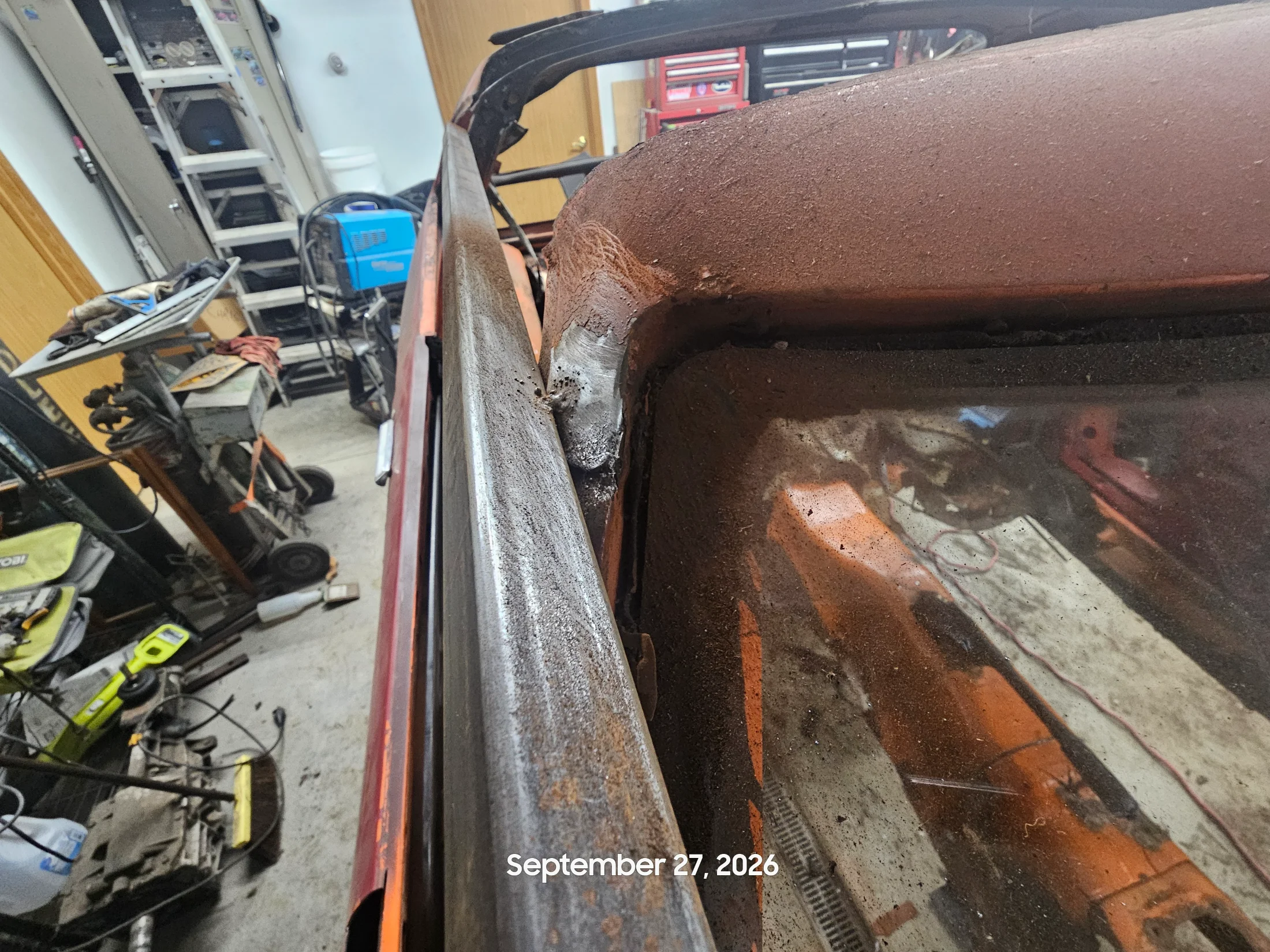

This should help.

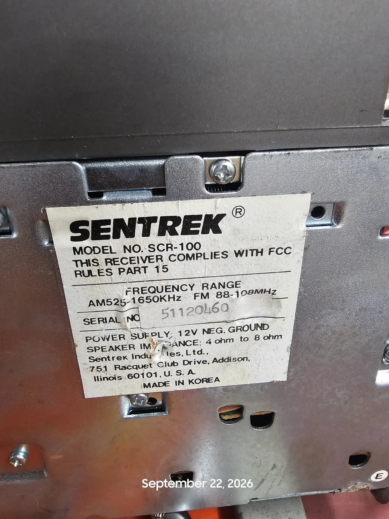

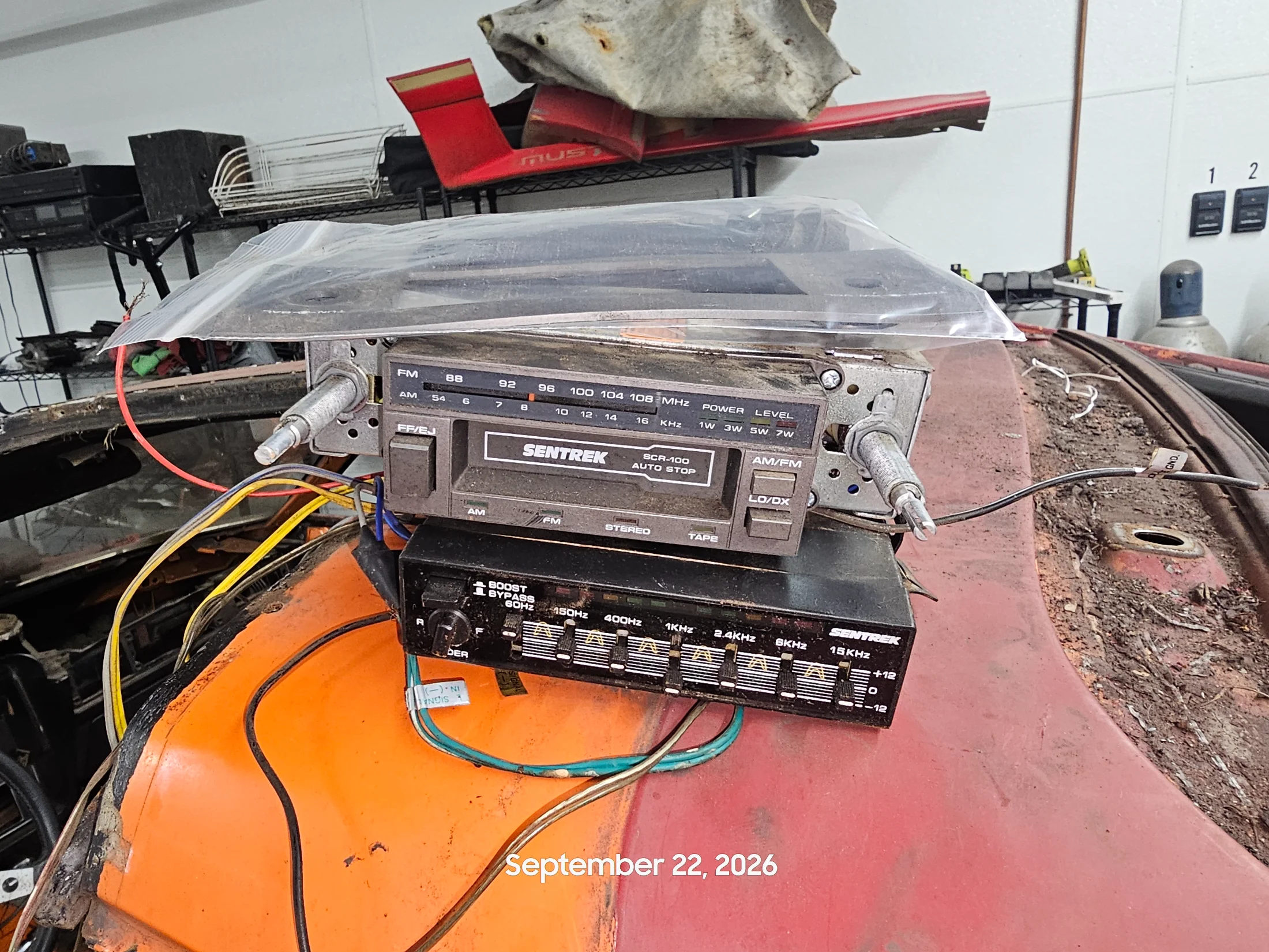

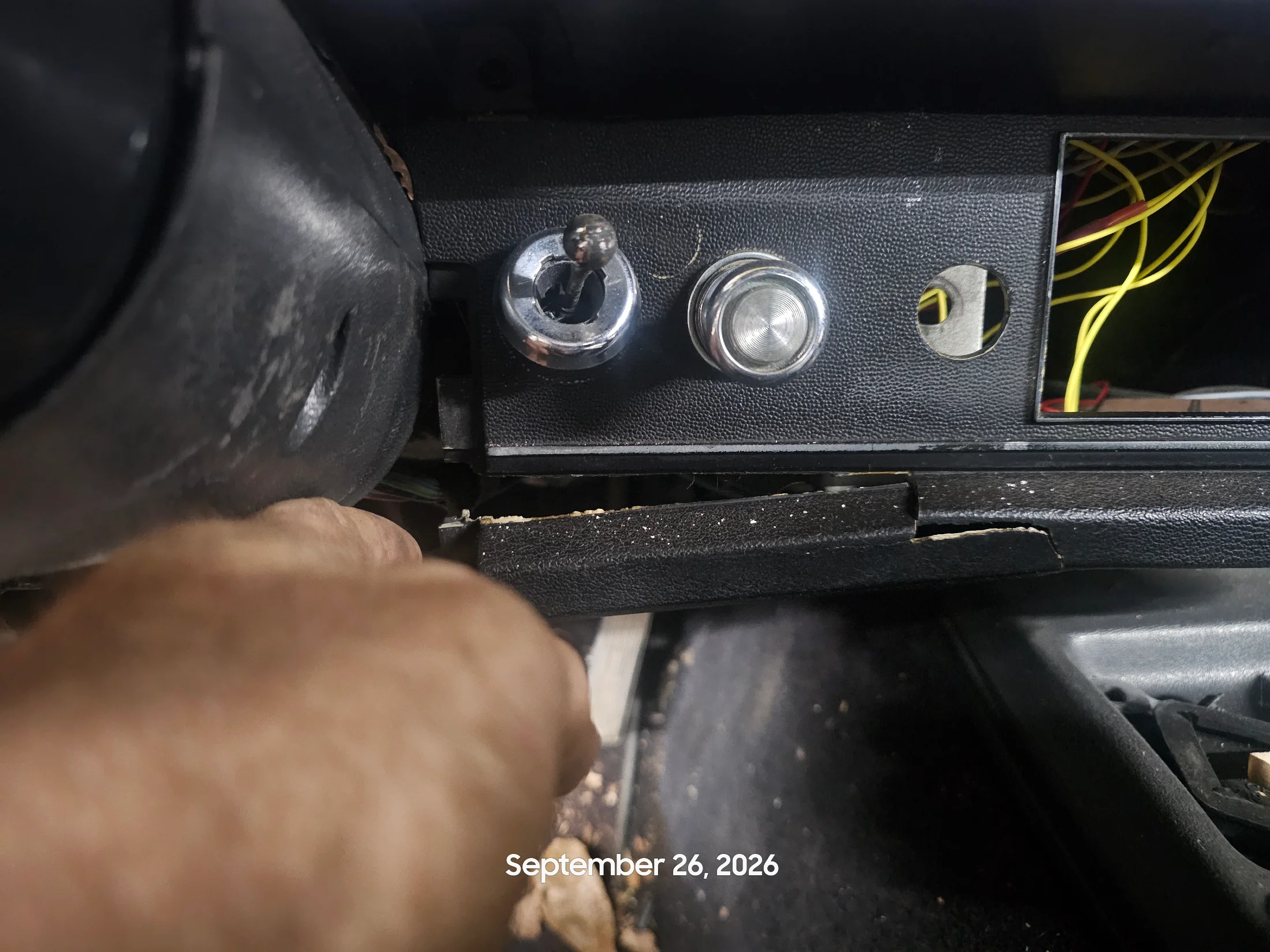

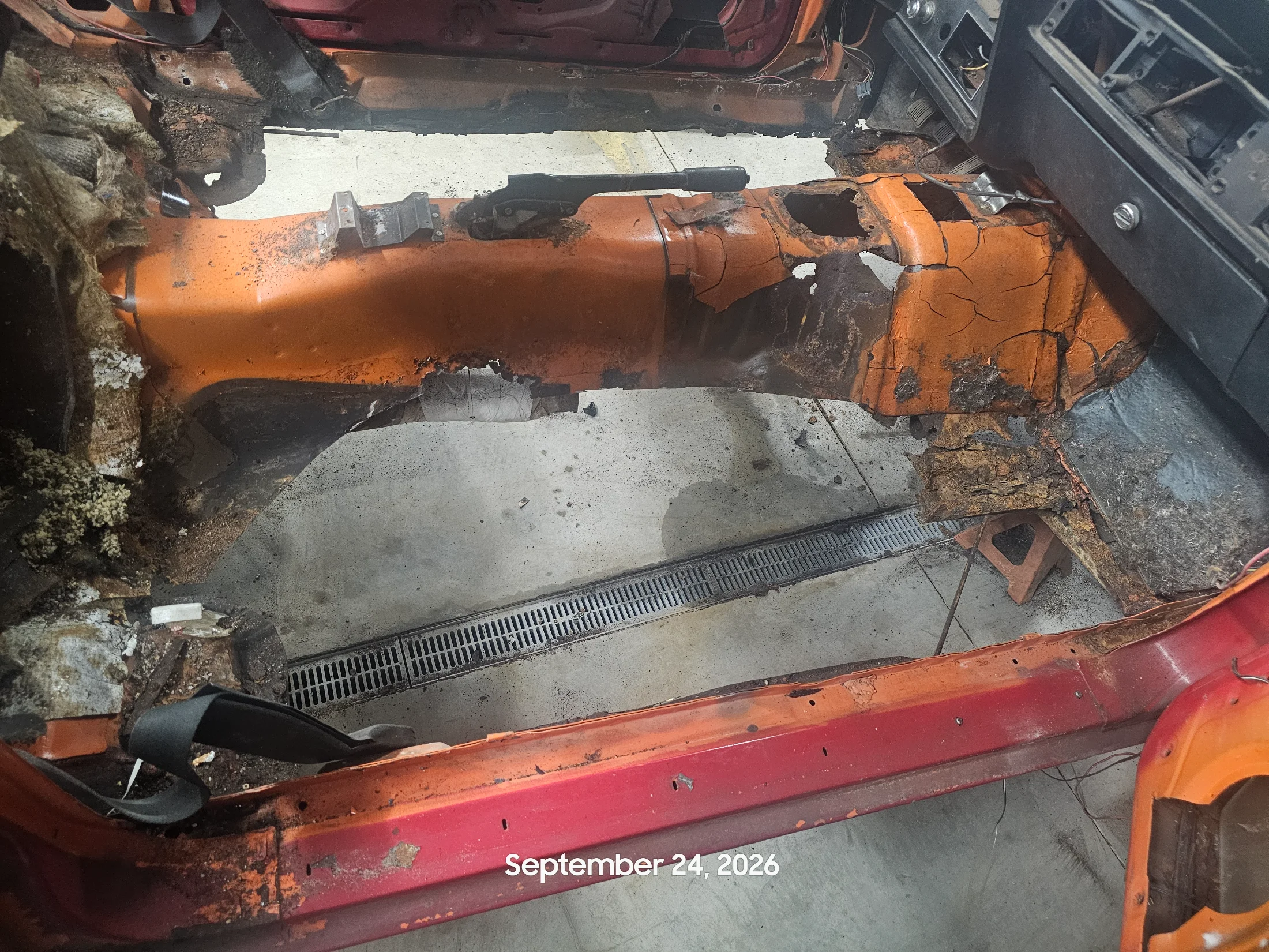

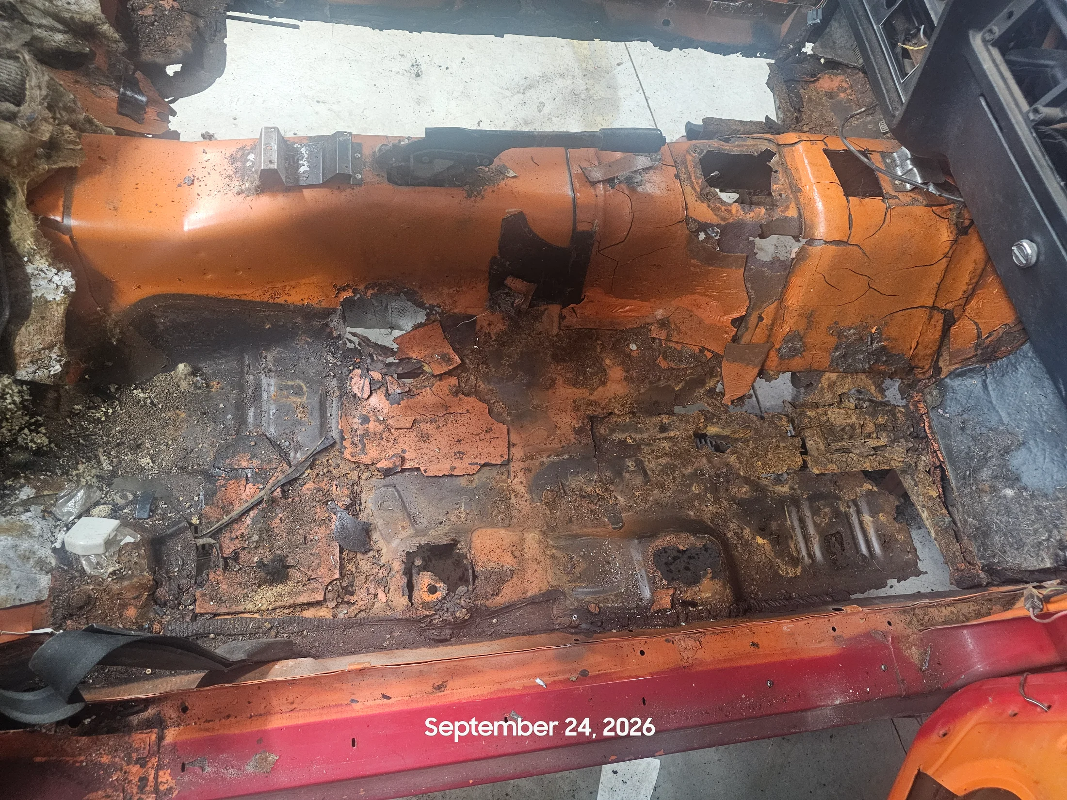

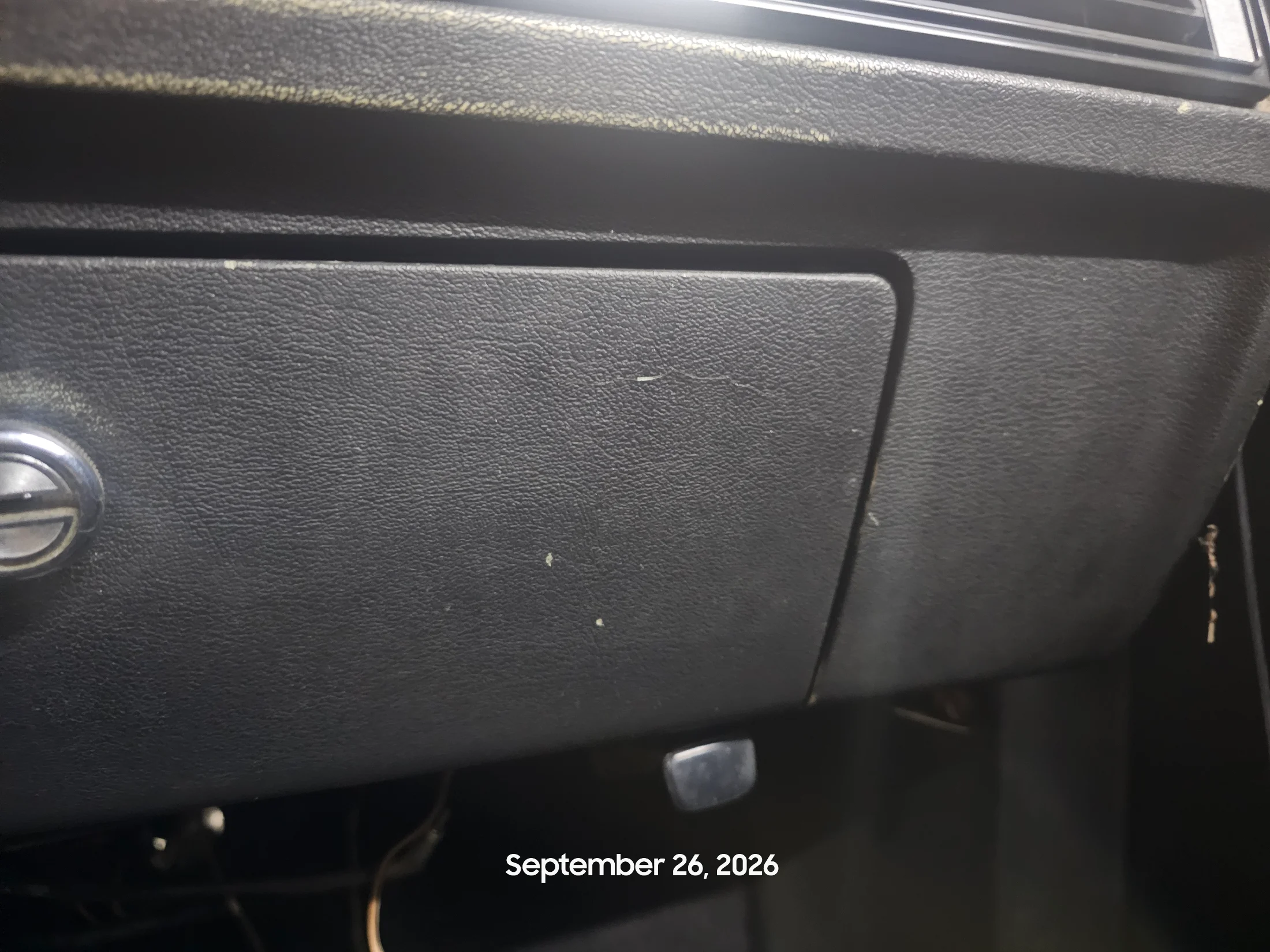

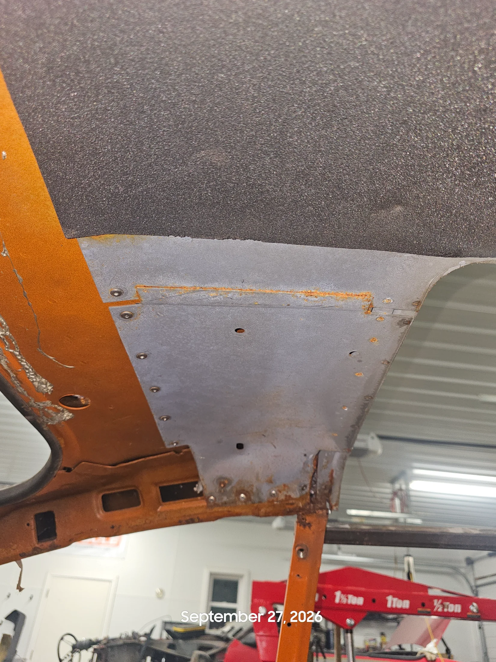

Tell you what - having no floor pan sure does make removing a stereo a breeze.

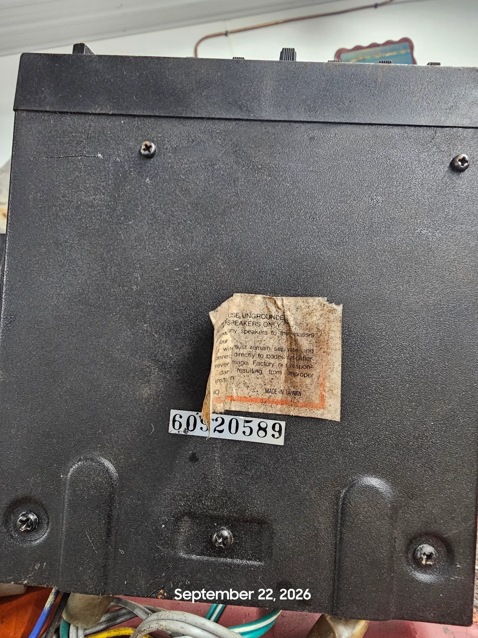

You know, if this still works it may just end up in my car. I mean why not? It's period correct....
