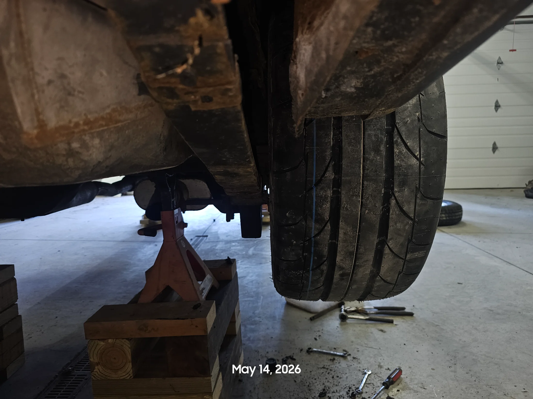

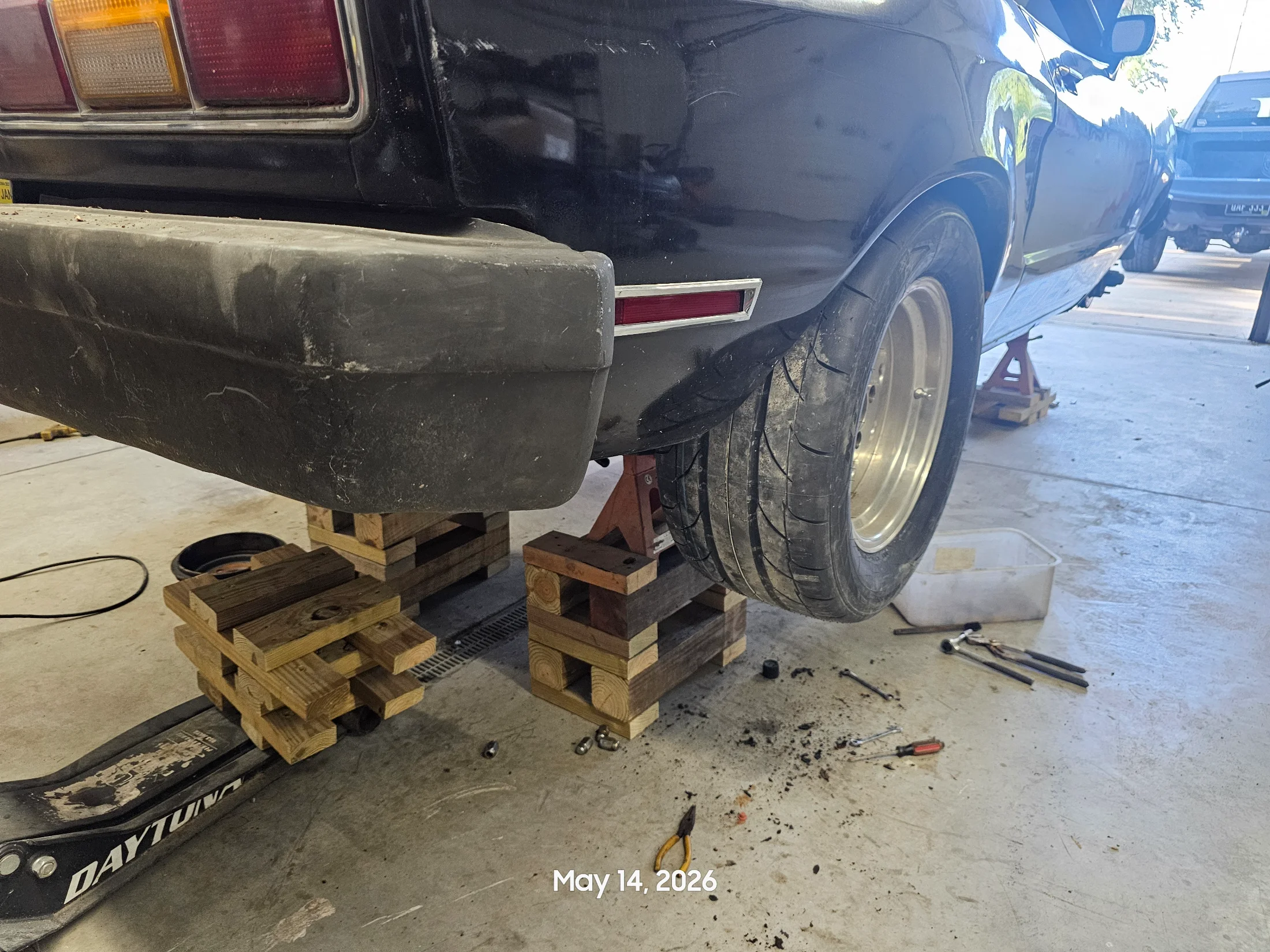

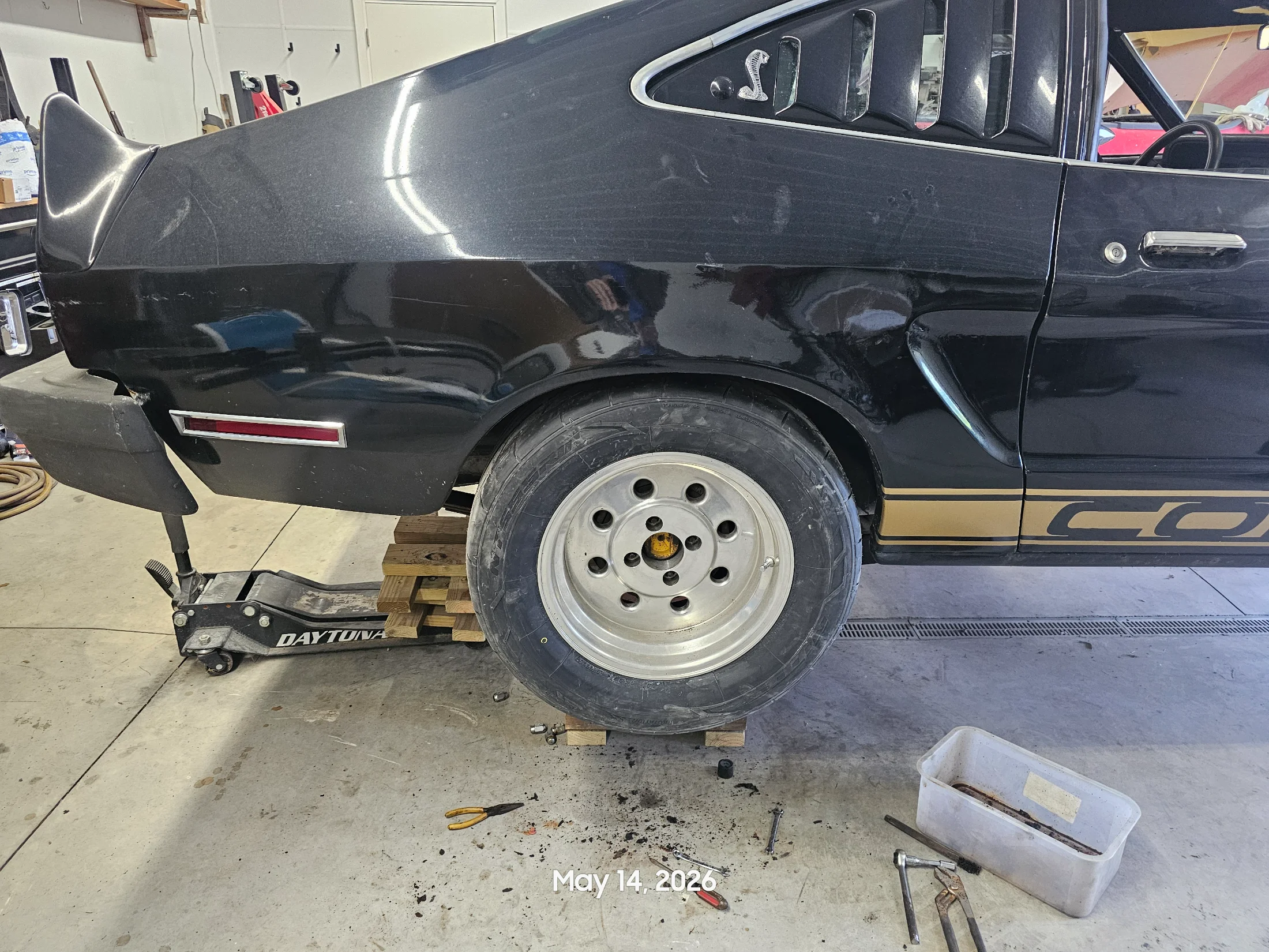

Didn't get anything done on the car yesterday, but I did notice while I was working on it the other day that I have a bad seal on the driver side axle. So I'm waiting on axle seals before I finish the drums. But I took the wheels and tires in to a shop and dropped them off yesterday, picked them up on my way home this morning. Wanted to see what the rears looked like before I head to bed, here they are.

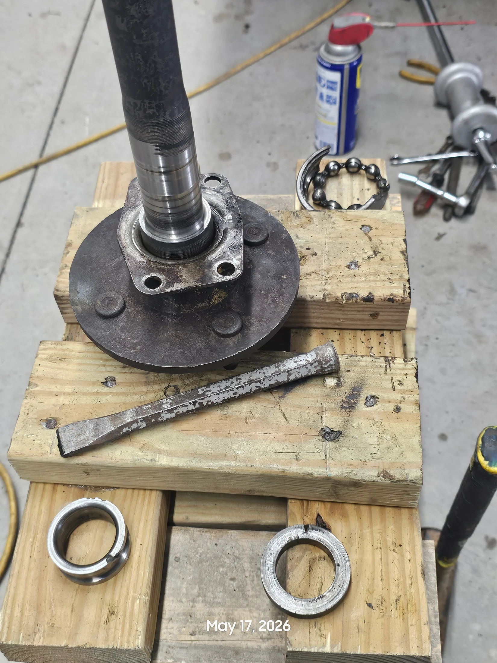

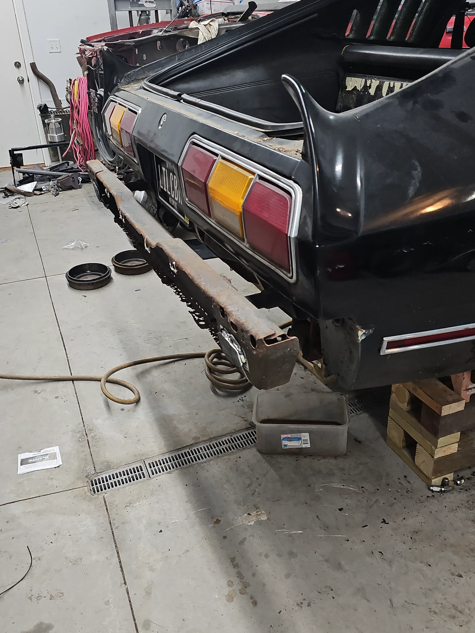

Didn't really get as much done on the car as I wanted to so far this weekend. But the axles are pulled, the bearings seem to be fine. Pulled the leaky seal and I decided that I'll wait until I get the replacements before I pull the other. Opened one bleeder on the front calipers the other day and I'm letting gravity help drain it. I tried to get both but one's stuck so I sprayed it down with some WD40, hopefully that'll work. While I was at that, I sprayed all of the connections for the soft lines, figured that soaking them would probably be the best approach. Decided that instead of spending more money on brake parts, the vert shares the same drum brakes as the Cobra, so I jacked it up off of it's cribbing and pulled the wheels and drums. And, while I had the wheels off, and the thought has crossed my mind about trying those wheels on the Cobra at some point (because I don't think I'll like them on the vert when it's time....), I mocked the rear. I have no idea how the fronts would work with my car sitting as it does, but I really like the looks on the back!
I also started prepping the car for the subframe connectors. As is the case with most other subframes that I've dealt with, they were kind of smashed up and needed some massaging for the connectors to fit. I got the passenger side more or less ready, just have to pull the rear seat bottoms to get to the bolts at the front leaf spring mount to deal with that end of it.

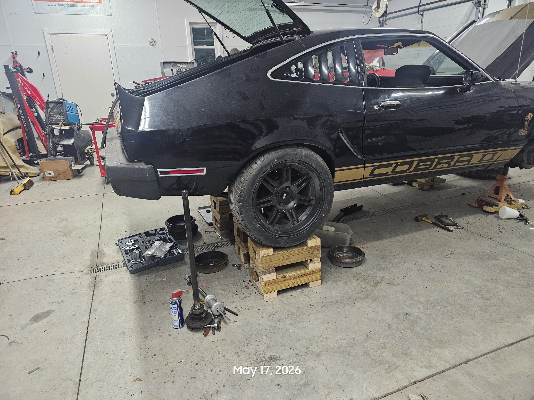

Slept a few hours this morning, then got up and decided to swap the bearings anyway as it only made sense. Made the trek into my nearest O'Reilly's for a pair of bearings and got that done now.

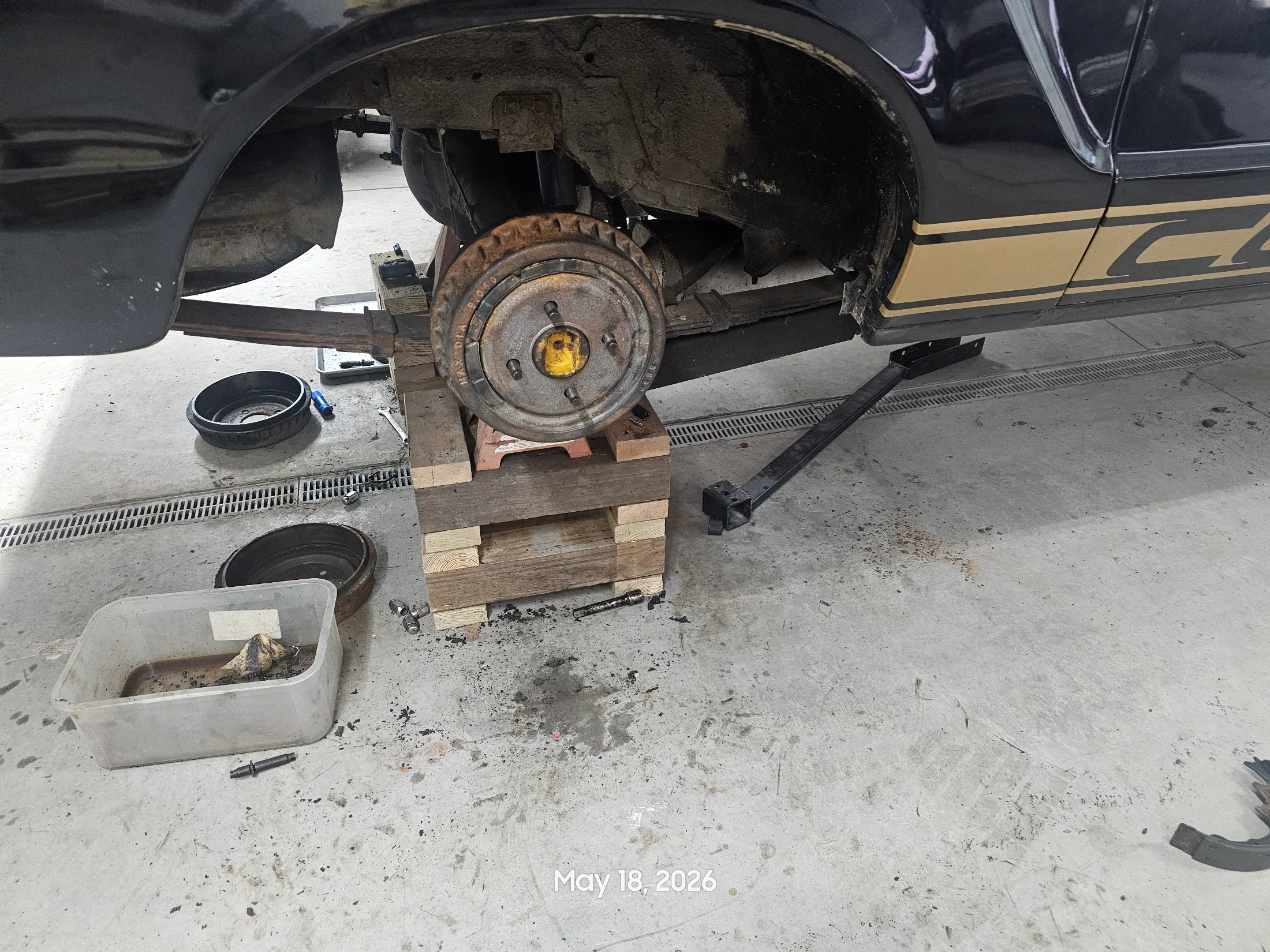

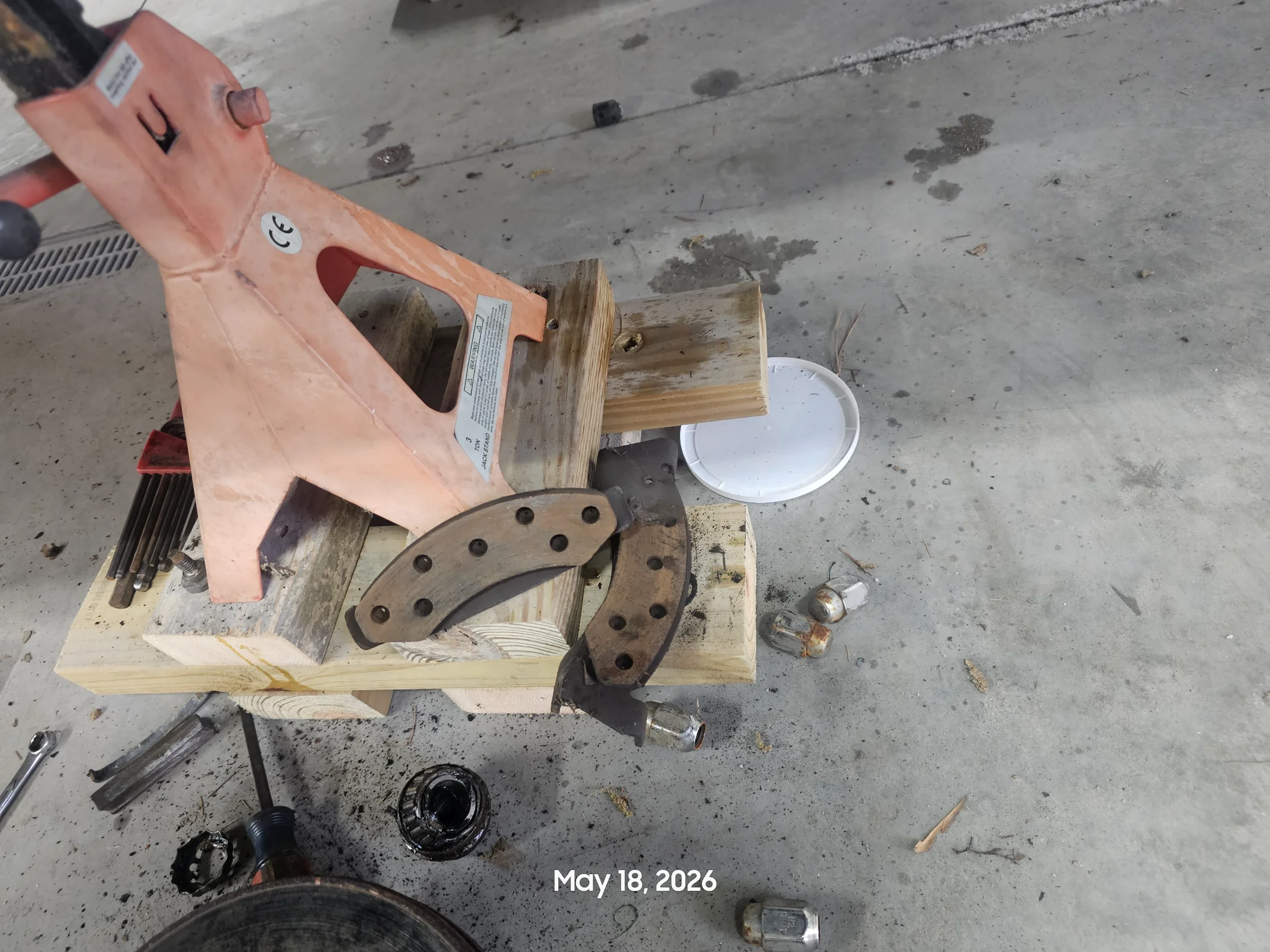

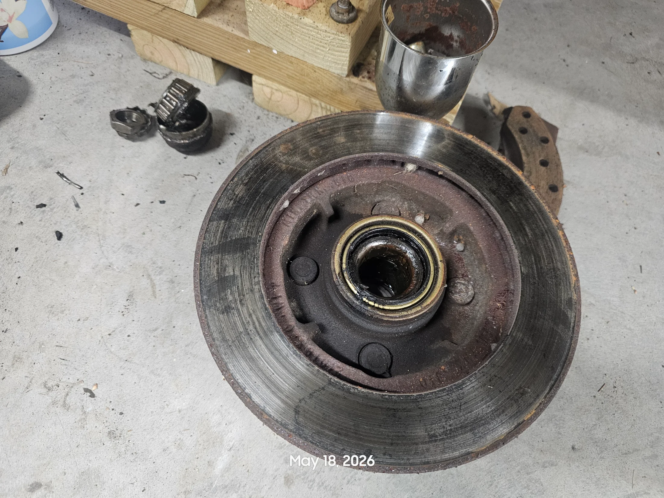

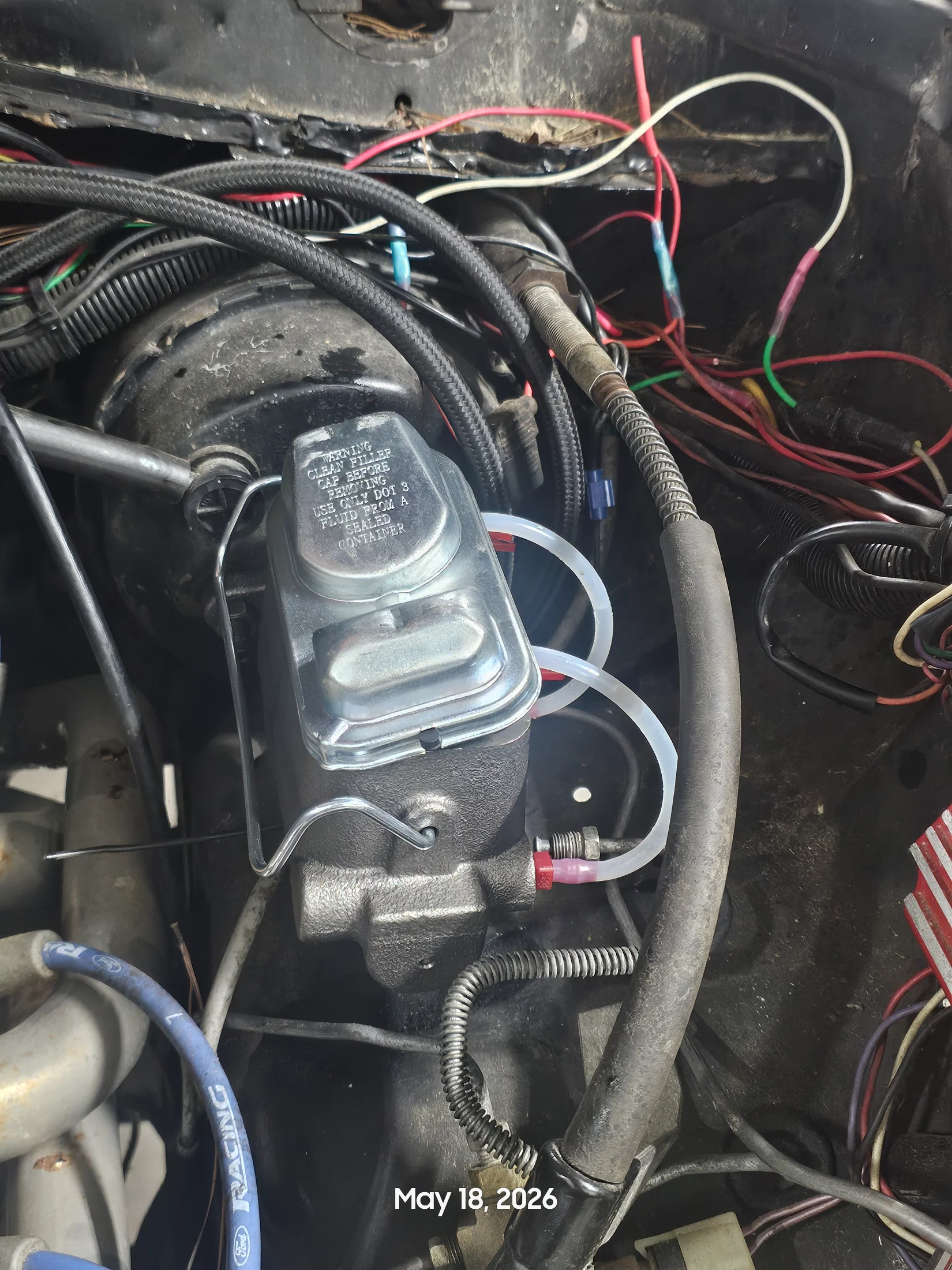

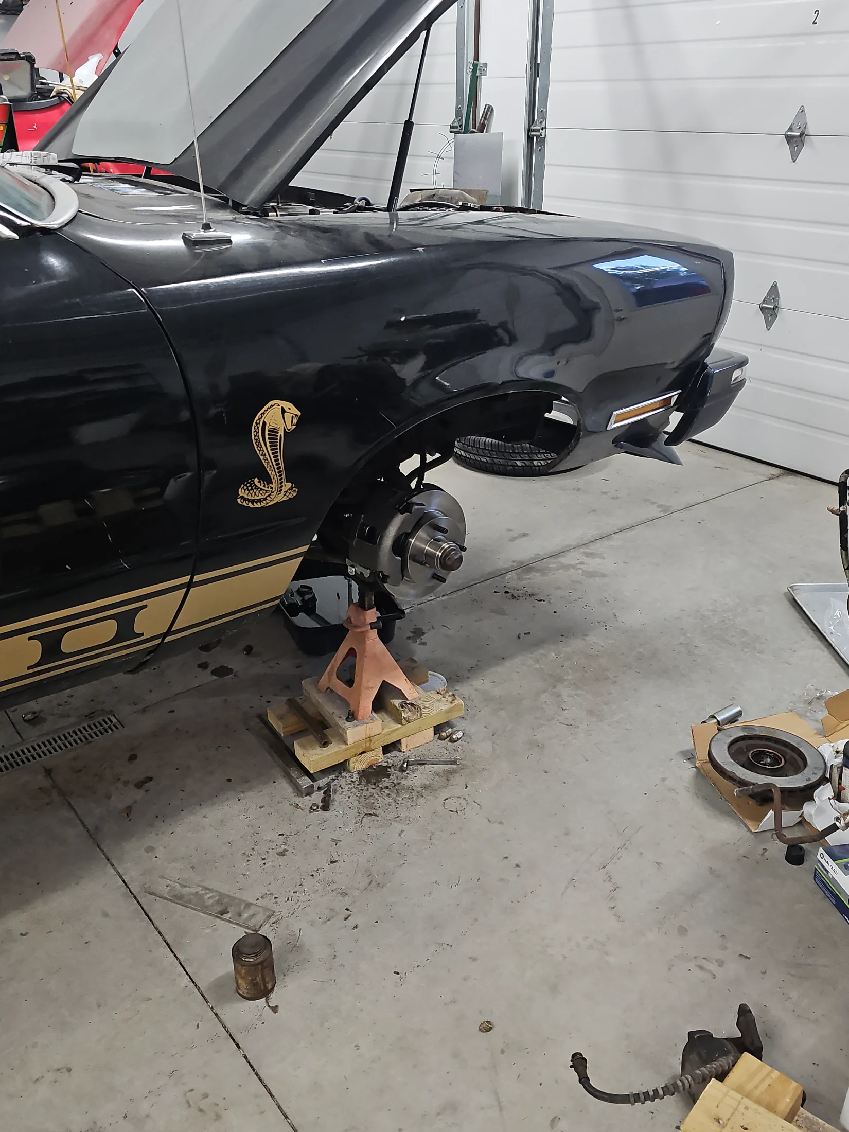

Rear brake shoes are swapped, the new rear brake hose is installed, and the axles are in. Got the front brakes torn apart now - calipers and hoses are removed and pulled the rotors to have them turned. When I pulled the passenger side caliper I found that the outer brake pad decided it wanted to break apart. Then when I pulled the driver's rotor I found that the wheel seal has seen better days. So I ended up ordering 2 new rotors, pads, and seals to be delivered from O'Reilly's. They have a deal going that when you buy 2 rotors you get a set of pads for free. I jumped on it since they can have them delivered to me by Wednesday. After ordering that stuff, I went ahead and installed the bench bled master cylinder. That officially puts me on hold for the brakes for now. Tomorrow's project will be to finish installing the subframe connectors and an oil change. Then, hopefully I can finish the brakes on Wednesday night and Thursday will be a serious bath for the car and loading it onto my trailer for the trip to my hometown for the holiday weekend. They have a show on Friday night and a cruise on Saturday that I've not attended in about 14 years. So I'll do all of that as well as visit with friends and family that I've not seen in a while.
