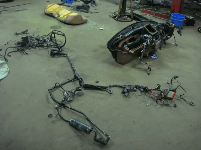

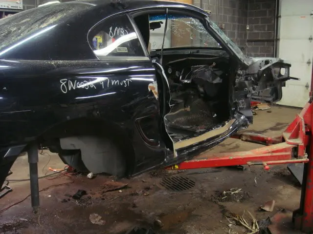

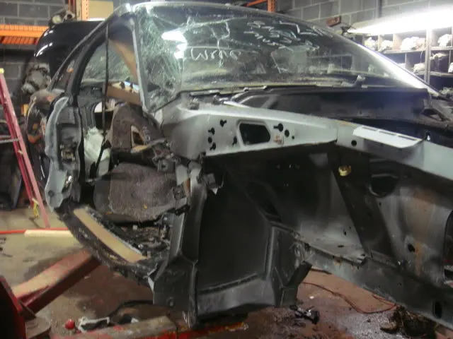

I had most of the Cobra stripped back February 2008. I had to get the last of the wiring out, the parking brake cables, some misc brackets I need. Tomorrow morning I am going to cut out the firewall area I need for the steering shaft bearing and the dash mounts. I also have to bring another Mustang to get some special transmission mounts off. I'm using the 99-04 trans mounts whick weld right to the tunnel. The 94-98 crossmember won't work in a fox body. It's longer and I don't feel safe about cutting the crossmember in half and rewelding it.
Wiring I needed to get out tonight.

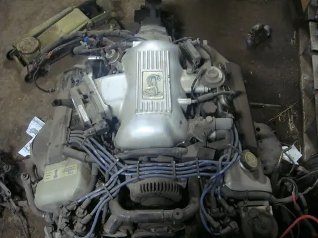

The heart.

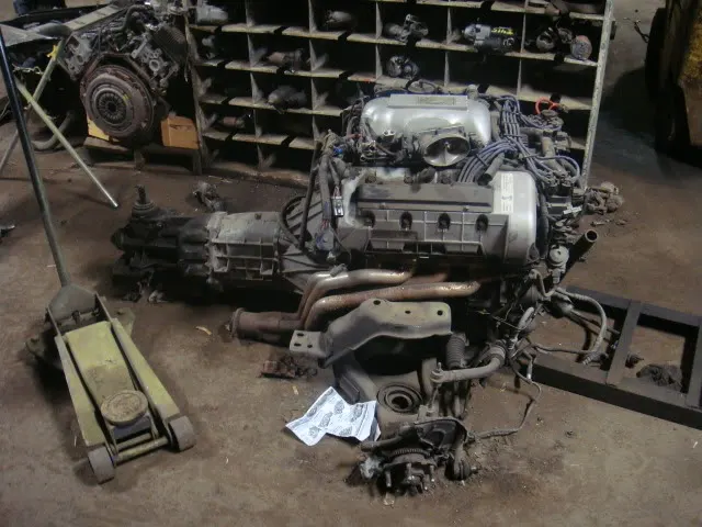

The longtubes are coming off. Going on are stock manifolds, new water pump, new oil pan gasket, Motorcraft plugs, valve cover gaskets and a nice clean up. Stay tuned. :nice:

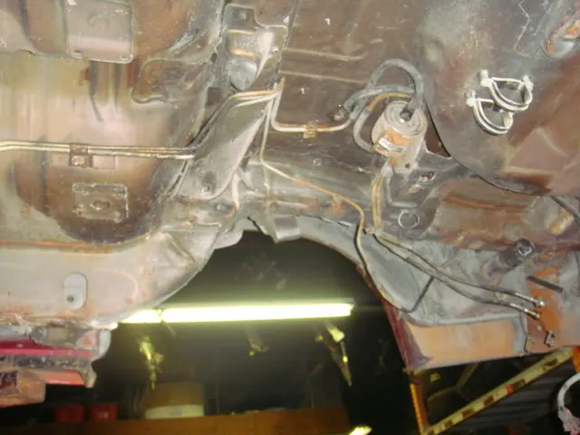

I went in early today (6:30am) and cut out the firewall/bearing plate I needed from the Cobra. Then I brought in a couple junk stangs sitting around and cut off the radiator brackets on the bottom of the core support and I cut off the 99-04 style transmission crossmember mounts from another stang. Cleaned up, worked 8-5, then brought in the car this stuff is going into. I pull apart the ground effects, the old fuel and brake lines, the front bumper and some old wiring. I also routed the 97 Cobra fuel lines and put a couple bolts in place.
Like I said earlier, I'm not wasting time painting the underside and making it pretty. It's pretty solid, a couple dirty areas and wet areas from gear oil, and gas, but other than that, it's pretty clean for a 91.

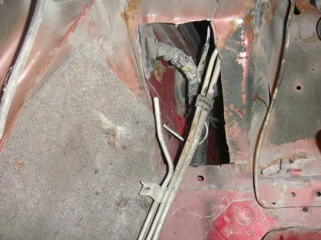

1997 lines in the 1991
I had to cut this area larger on Hack Job and this car for the fuel lines and the future wiring...
