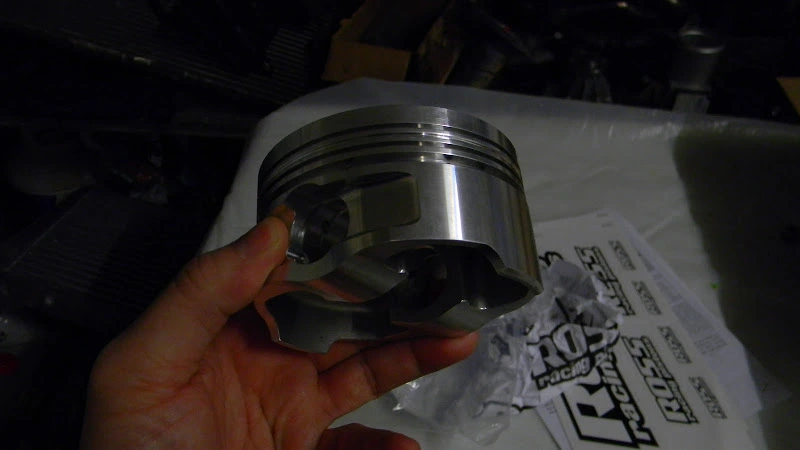

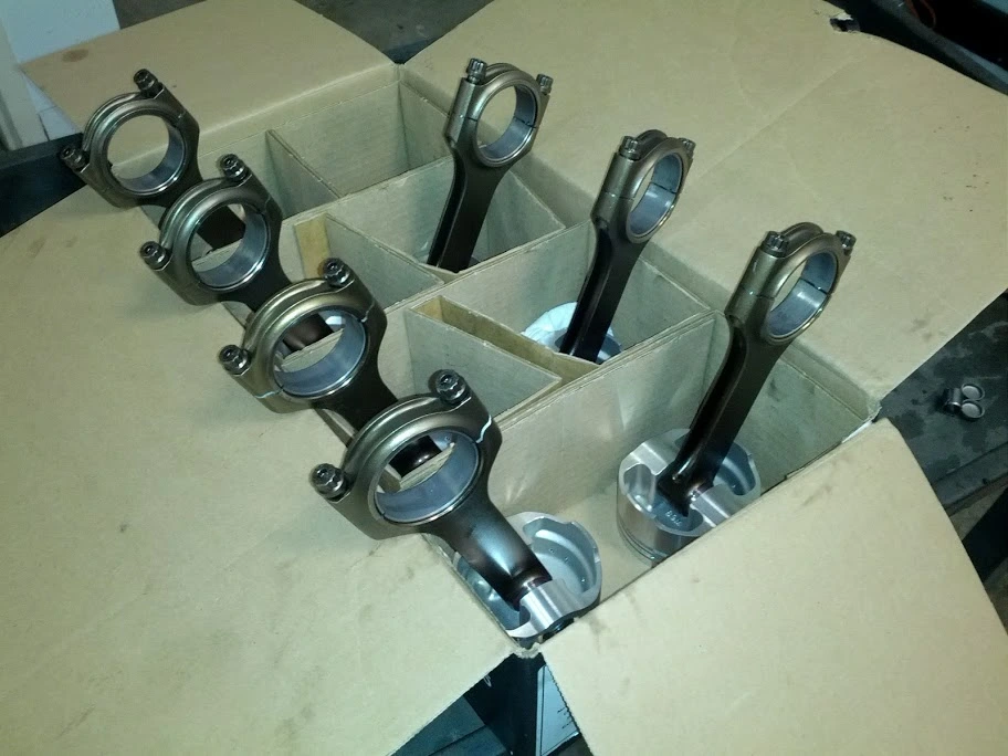

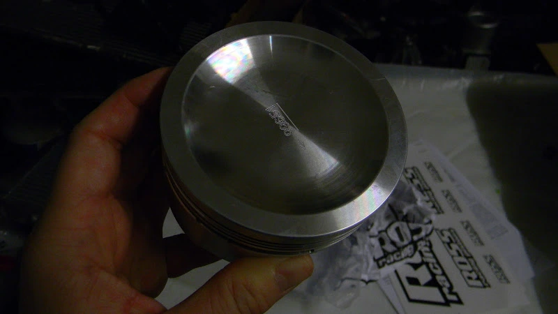

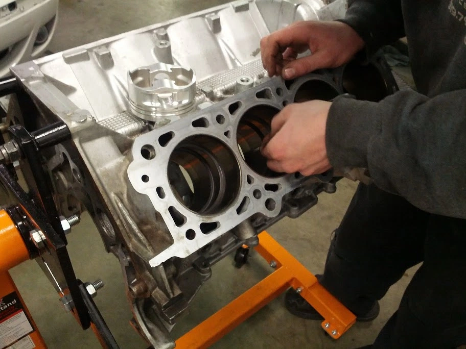

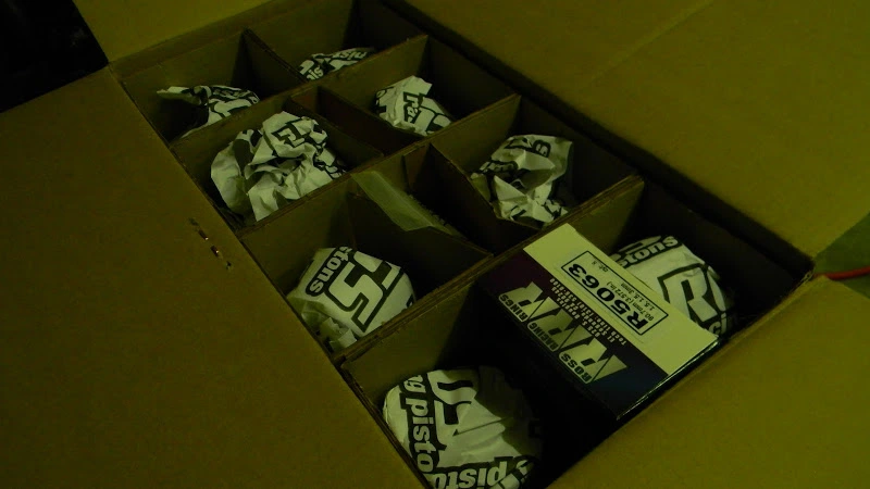

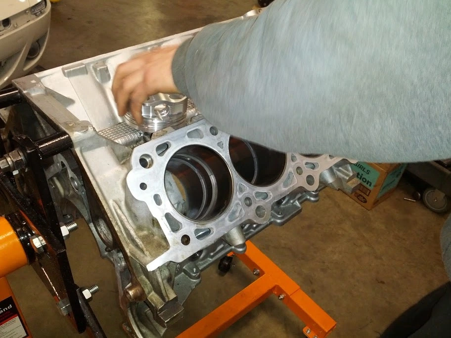

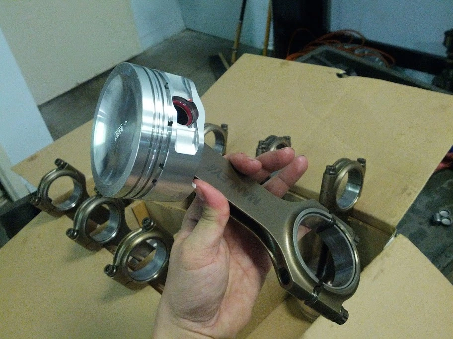

Its been sometime since I toasted my pistons, now I'm looking to get the beast back on the road. Just ordered a :poo: ton of parts and hoping to have them by the end of next month. Stay tune!
-Ross Racing Pistons w/ SS rings 99651, 16cc (9.75:1cr)
- ARP Head Stud kit 156-4101
-4.6 engine gasket kit (using stock head gaskets)
-Tokico HP blue shocks
-Meth kit (not sure what kit yet)
goal 600-700hp on 93, still stock heads and cams.
other engine parts
-Teksid block bored .020 over and decked
-Manley H-Beam Steel Connecting Rods
-ARP main stud kit
-MMR side bolt kit
-8 blot crank
-Trick Flow stage 2 valve springs

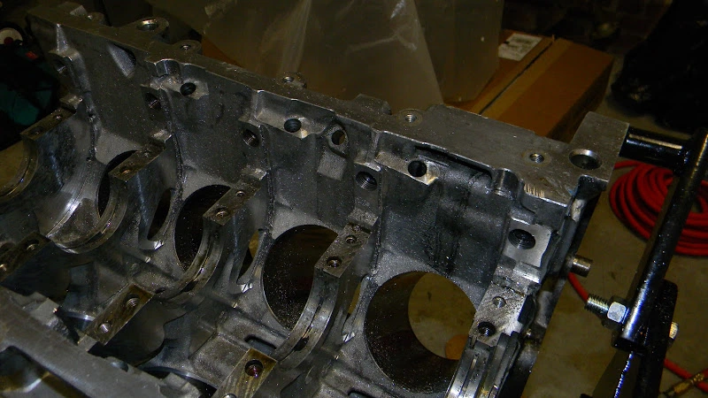

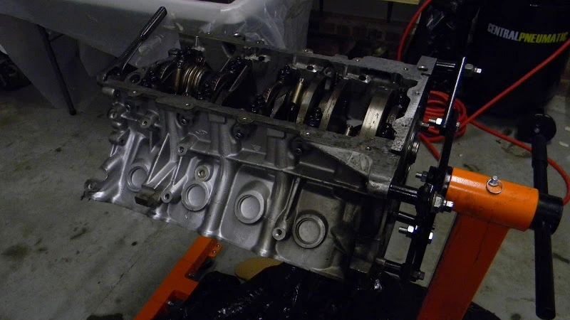

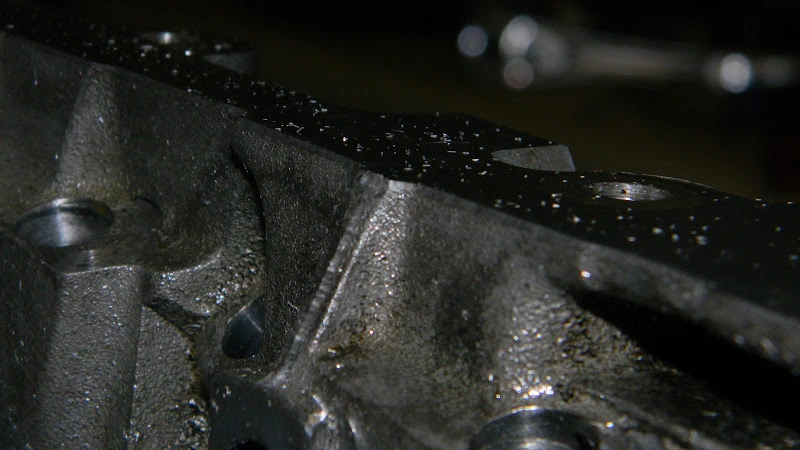

Block tear down and inspection. Deburred the block.
Next steps, take block, rods, pistons and crank to the machine shop for cleaning and balancing.
EDIT. Going to clean up heads as well. Light porting on the intake runners.
