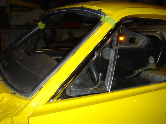

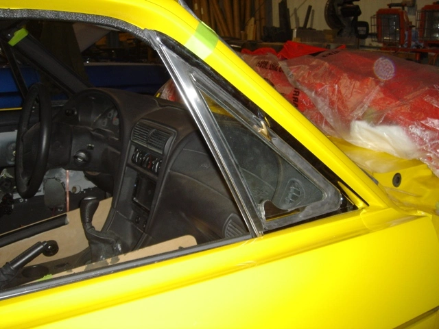

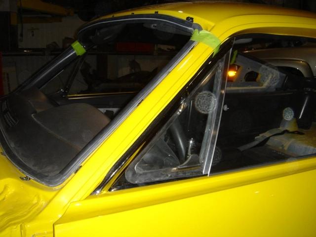

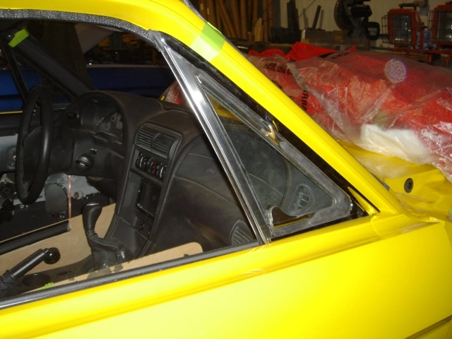

Yesterday we got a lot done in regard to assembling the doors, but we still have a way to go. There is only one thing that is holding us up right now. We need to find the material used to bond the stainless steel trim pieces to the drivers and passenger side glass. The material appears to be some type of fiber impregnated with some sort of rubberized material.
Any Clues???

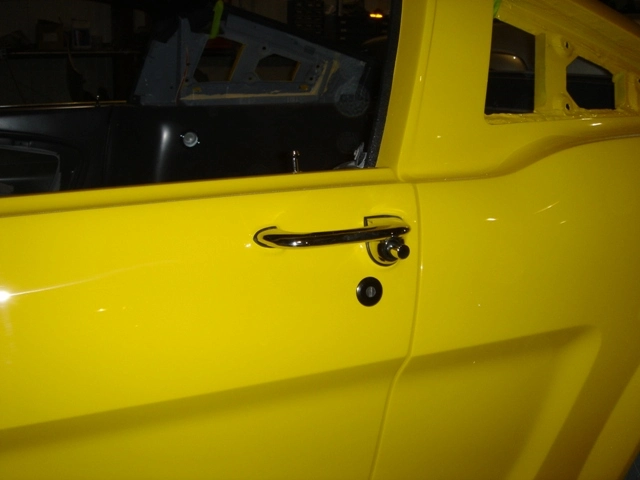

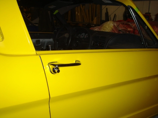

Here are some photos of the wing window assembly and the door handles mounted to the car. You will note that we have left the door lock black with a silver center section. We were originally going to make it all silver, but decided that the black fit in well with the "black" exposed rubber trim around the door handles.

Know the stuff you mean, no idea what it's called or where you get it. I'm re-doing all of those on mine too, 1/4 Vents and rear 1/4 windows included ('65 coupe).
I gave up trying to find the right stuff so I ended up using black Sikaflex. Once the old stuff's removed, there's about a matchstick's gap on either side between the glass and the window capping. So I used matchsticks as spacers, taped up the windows to minimise the cleanup required and went to work squeezing in the Sikaflex.
It's time consuming and messy, but it gets the job done if you can't locate the correct stuff.

66HertzClone said:
I bought some for my side windows from a local glass shop. It is a rubbery like tape material.
Its like double sided tape isn't it? Kinda gummy; stretches when pulled? Being in the window business (last job 4 yrs ago) its used between the glass and aluminum frame, then caulking is used to watertight this application.
Anyway, we called it Butyl tape. Like 66 said, try a glass house. It comes in different thicknesses and widths usually in 50' rolls.
SN65 said:
..... The material appears to be some type of fiber
I believe they call it glass setting tape. I had some in the door re seal
kit for my old Chevy Truck. Came from chevyduty.com, but I'll bet a good
glass shop should have it.
FYI, the stuff I used required some oil to make it expand and clamp the
glass. Several years later it's drying out and getting loose again.
Something more modern and permanent might be better.
