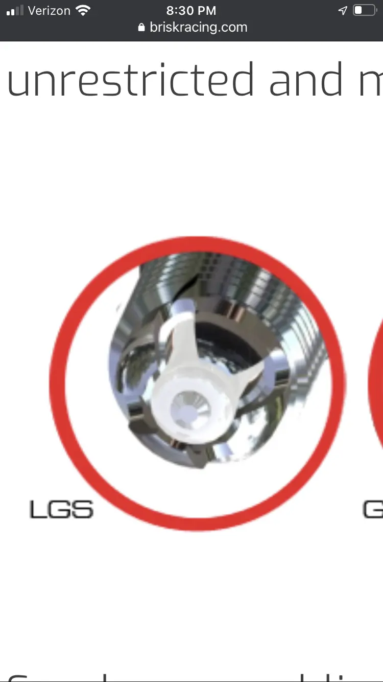

The Spark Plug Dilemma
I bought a set of Brisk Premium LGS Spark Plugs (GOR15LGS) for my mustang. Weather is getting better here, and I have all the parts for my spring build up. I thought of putting these in so I'm not having to index plugs again.
Anybody have experience with these? I could use your opinion.
Thank-you

I do like the silver electrode and the look of the plug but I did notice they say that plug is specifically designed for a GM 602 motor

What is your combo? Has ground electrode wear been a problem? With as open as the design is from the top and with four ground electrodes to the sides, how would this be properly indexed?
