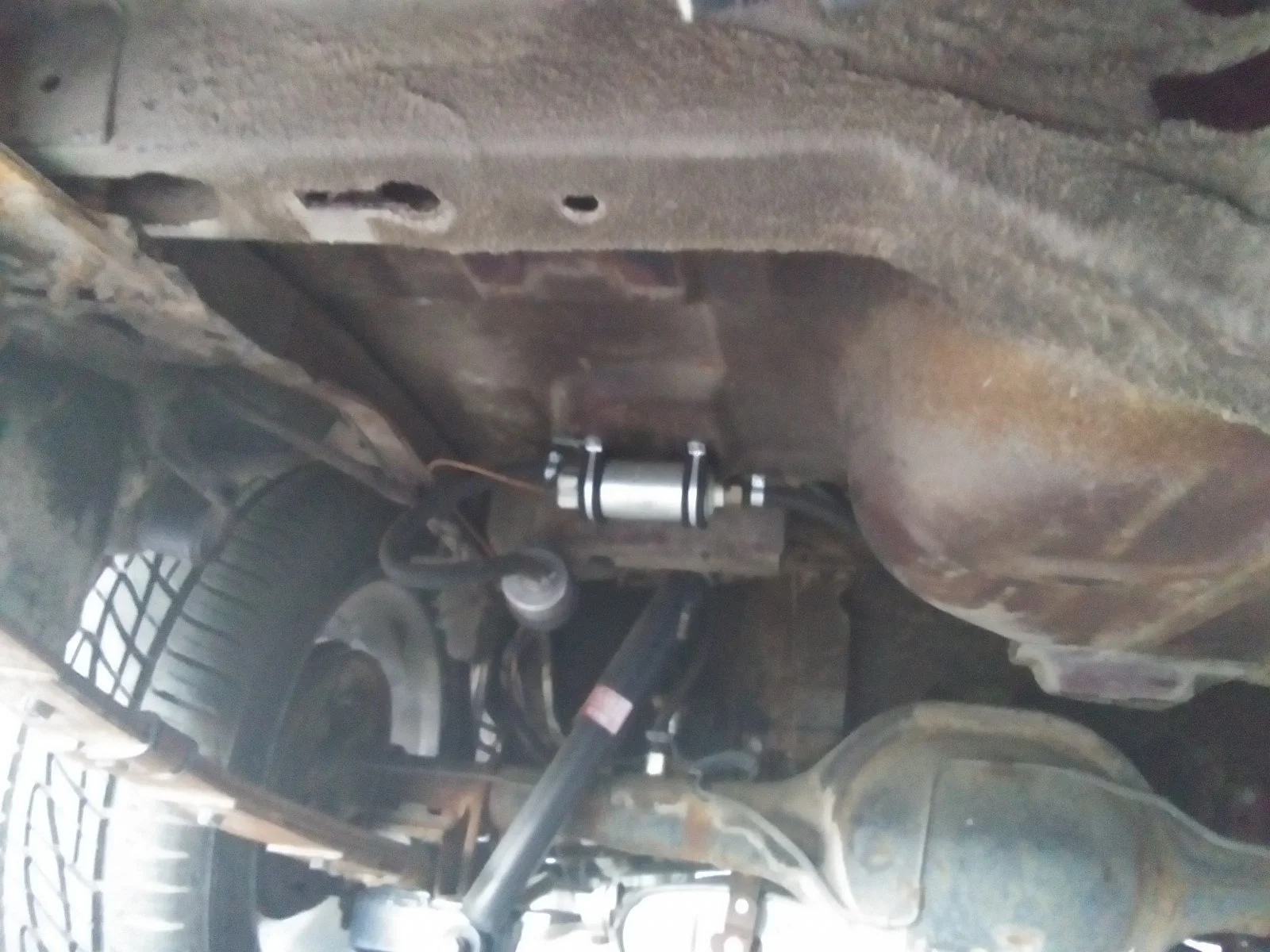

I need some advice.
Here is the current location of the fuel pump and fuel filter for the EFI system:
While they worked well enough with the fuel cell in the trunk, they happen to be in the way of the stock fuel tank I'm going to be installing.
Does anyone else that's spent time under the ass end of a II have an idea on where to relocate them (preferably very near the tank)?

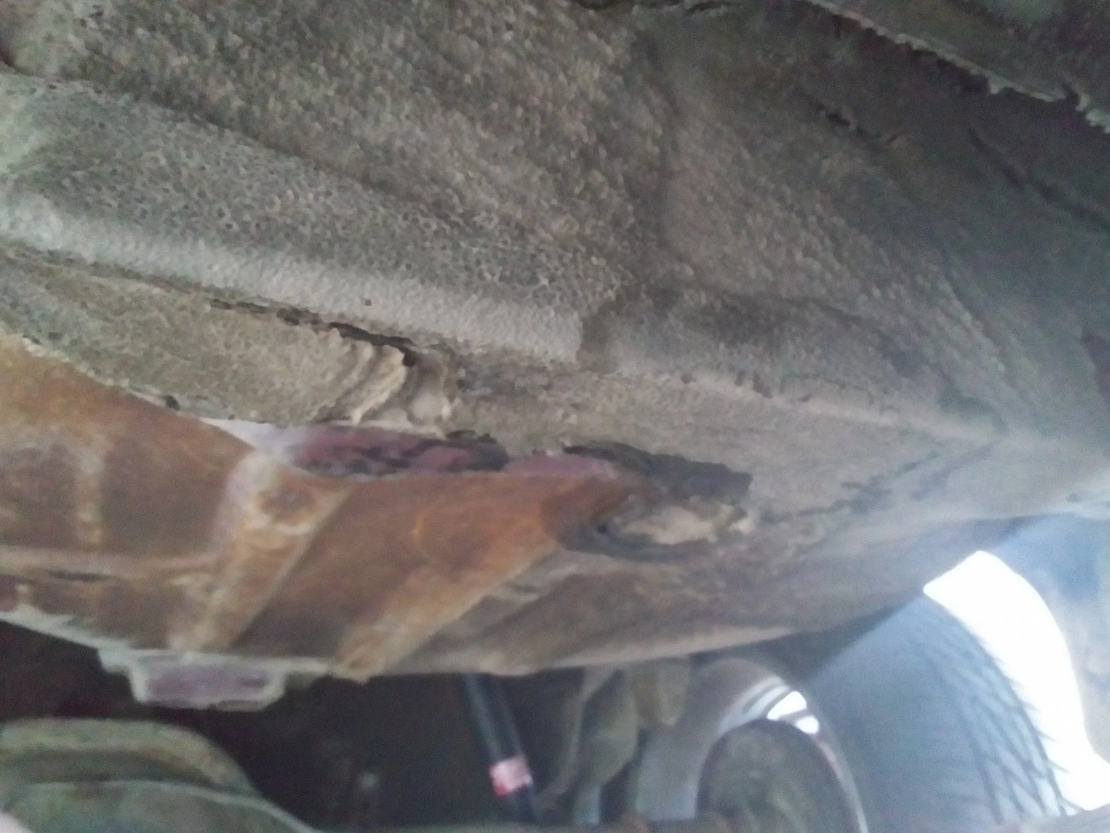

Also, the pinhole on the top of the right quarter panel by the decklid is now the size of a nickel, and it let rainwater into the trunk last night. I guess that's the new priority number one.

You installed the pump behind the support where the left fuel tank strap is installed. My thoughts where to make a sheet metal that I can attach in front of this support and put filter and pump onto this sheet metal. I want to use a thick sheet metal to reduce noise. Also the support seems to be an good attaching point, because it isn't a big shell surface that can radiate noise.

Does that style of pump need to be installed below the tank somewhere, meaning is it gravity fed to the pump? If not you could install it along the support where the shocks mount. Otherwise I can't think of a good place for it off the top of my head.
Ideally, it should be below the tank, but with II tanks running their sending unit at the bottom, it shouldn't be a big deal to run it above the tank so long as it's close to it.

One thing you could do.... The Fox tanks have in-tank pumps. Hell, pretty much all new cars do. You could replace it with an in-tank pump, you'd just need a sending unit and the corresponding connections from another tank and weld them onto the II tank. OR you could go the path I chose and modify a Fox tank to use. You might need a regulator to go along with all of that, but it's an option I was thinking of.

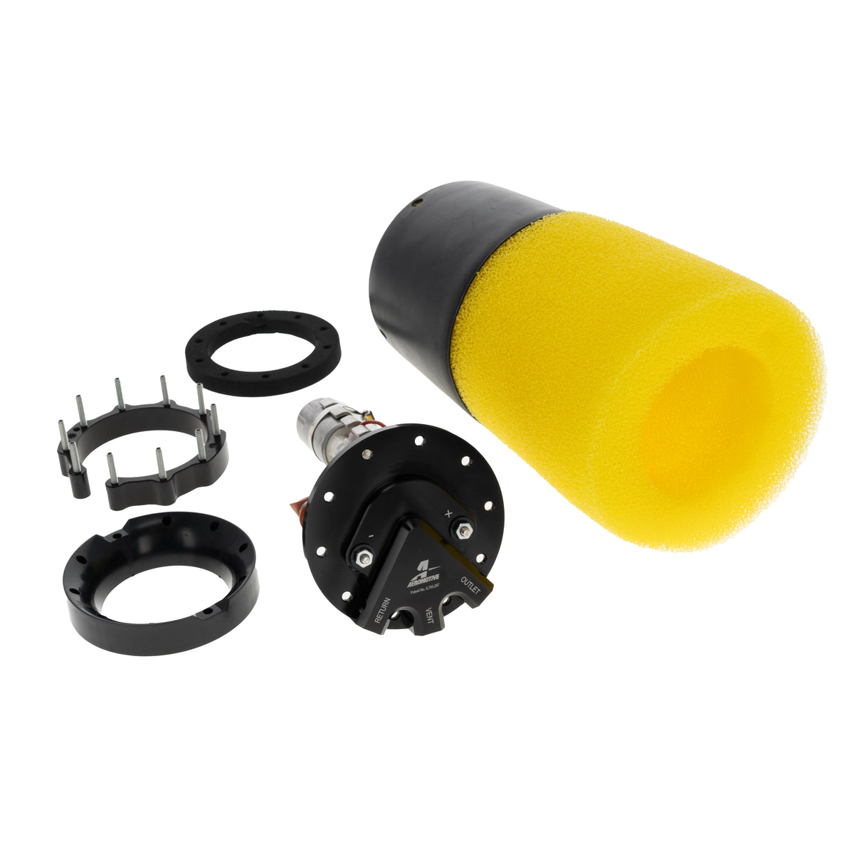

All aside...
200 LPH In-Tank Fuel Pump System
NEW RETURNLESS STYLE KIT OPTION: Introducing the New Aeromotive Returnless Phantom Fuel System Kits. Engineered Specifically for use with the Vaporworx Fuel Pump Controllers. Utilizing the Vaporworx controller, we are able to completely eliminate the need for a fuel pressure regulator and return...
aeromotiveinc.com
That or even one of it's bigger brothers is in the cards for the Coyote swap should it ever happen. It'll involve cutting a hole in the top of the fuel tank, and the modification of the car's trunk floor to provide an access panel at that point, but with all the that'll be cut out of the other end of the car JUST to fit the engine, that's small potaters.
