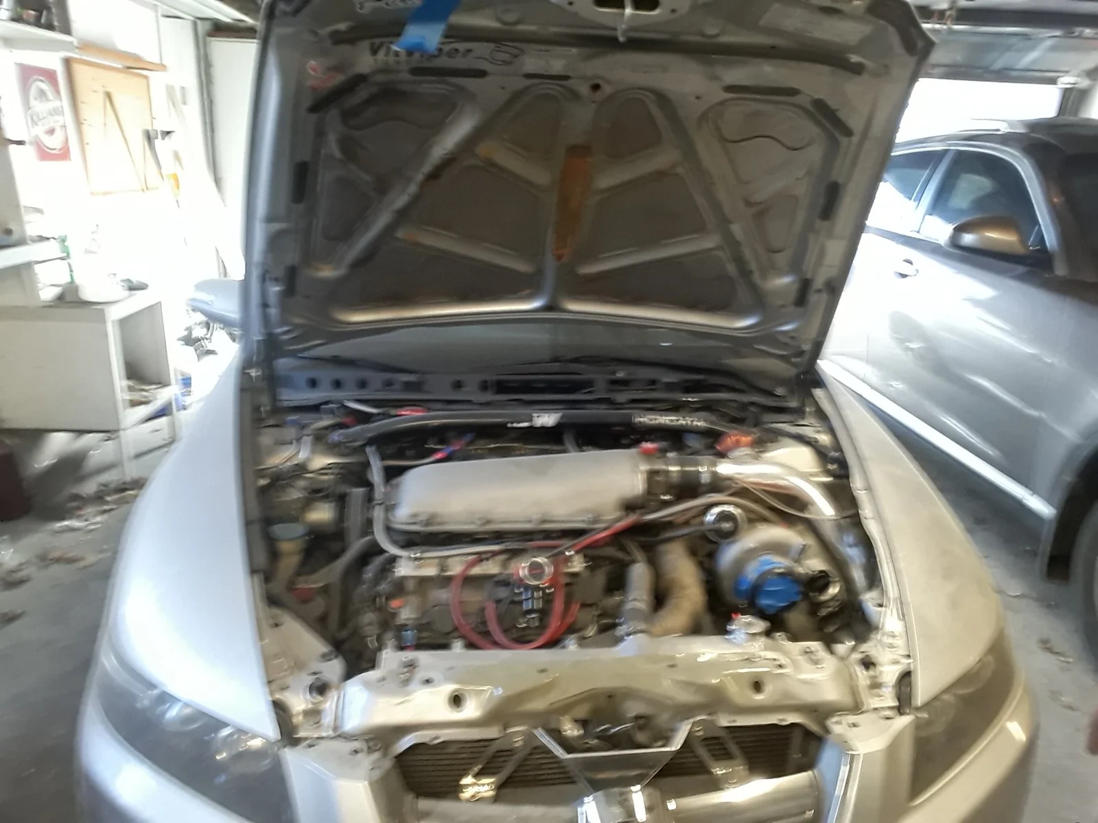

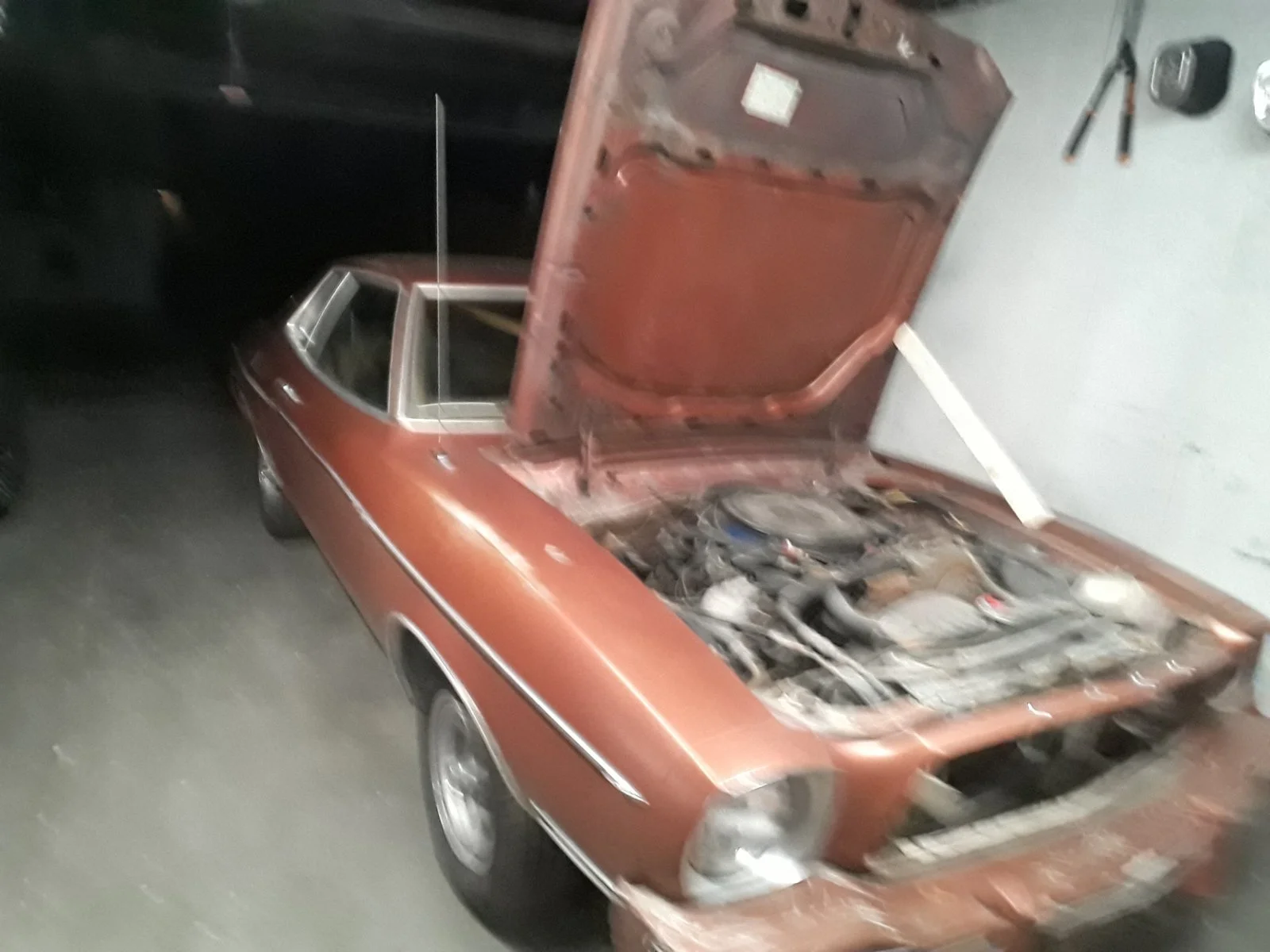

So decided to do a big displacement build, the original plan was an e36 bmw with a twin turbo ls swap in it but then I saw a mustang 2 going for sale locally and it reminded me of the story my dad told about the one he had and dropped a big block into so plans changed and now I've got the stand ii. So far ive got the motor out and I'm planning on doing a decent amount of restoration as well. Old car long forgotten and universally hated they are bound to have issues. A decent amount of rust and some damage from someone who didn't know where doing. Here's some pics of my last car as well as the current progress on this one.

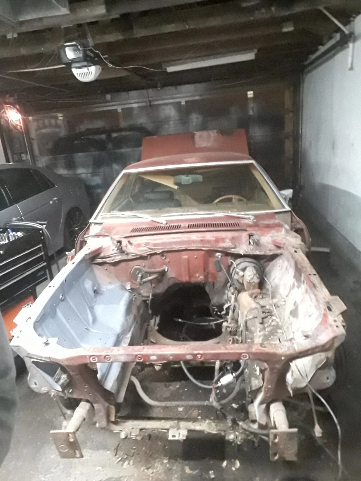

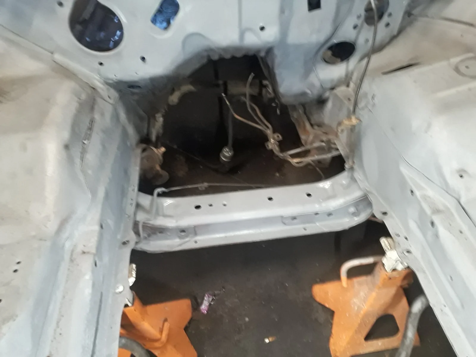

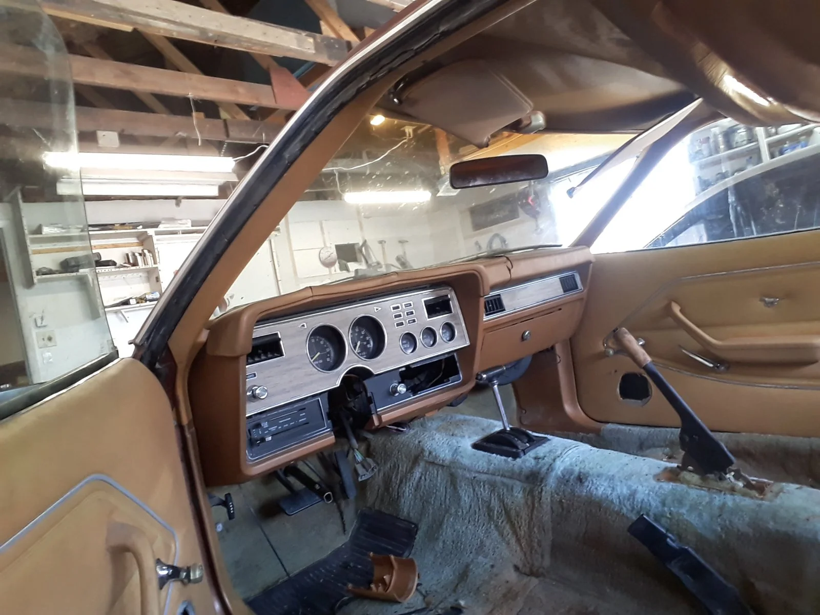

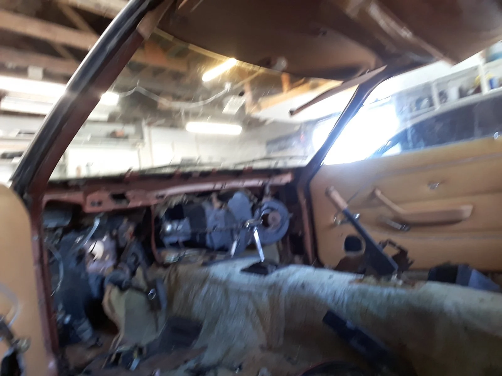

Small update I'm getting the interior pulled out as much as possible before work. Gonna Remove the brake booster too and start working on the engine bay this weekend.

Quick update, so I've been doing some measurements and its looking like I will need a gto oil pan to clear the cross member, not thrilled about having a front sump oil pan but if that's what it takes.....
Picking up a doner truck today a silverado 2500 the 6.0 is nice but really its the trans I'm after im wasn't yet ready for a new motor yet but the price was too good to pass up. And I've been reading up a bit on @429MII's thread and it gives me hope. If that thing will fit a small block shouldn't be a problem. Clearing the steering shaft will be tricky though. Been grinding and brushing away at the rust little by little got a full weekend to myself so more prep work will be done and ima try to get the old motor out of my garage.

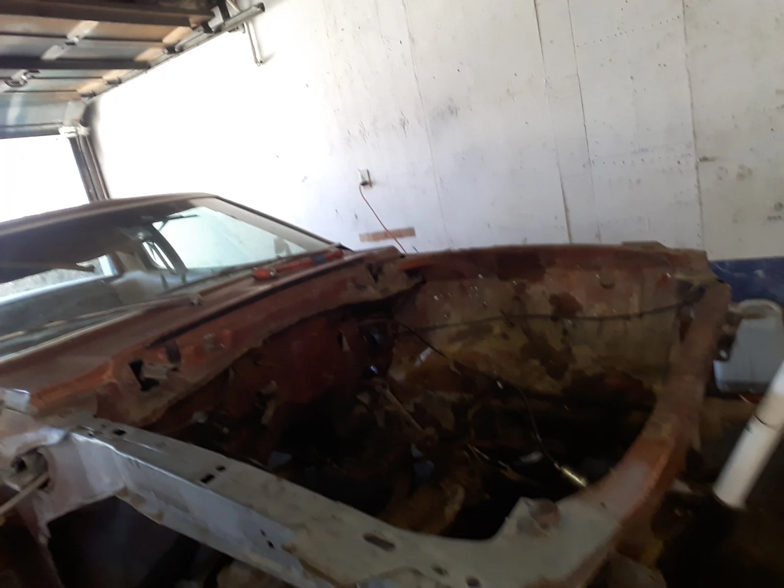

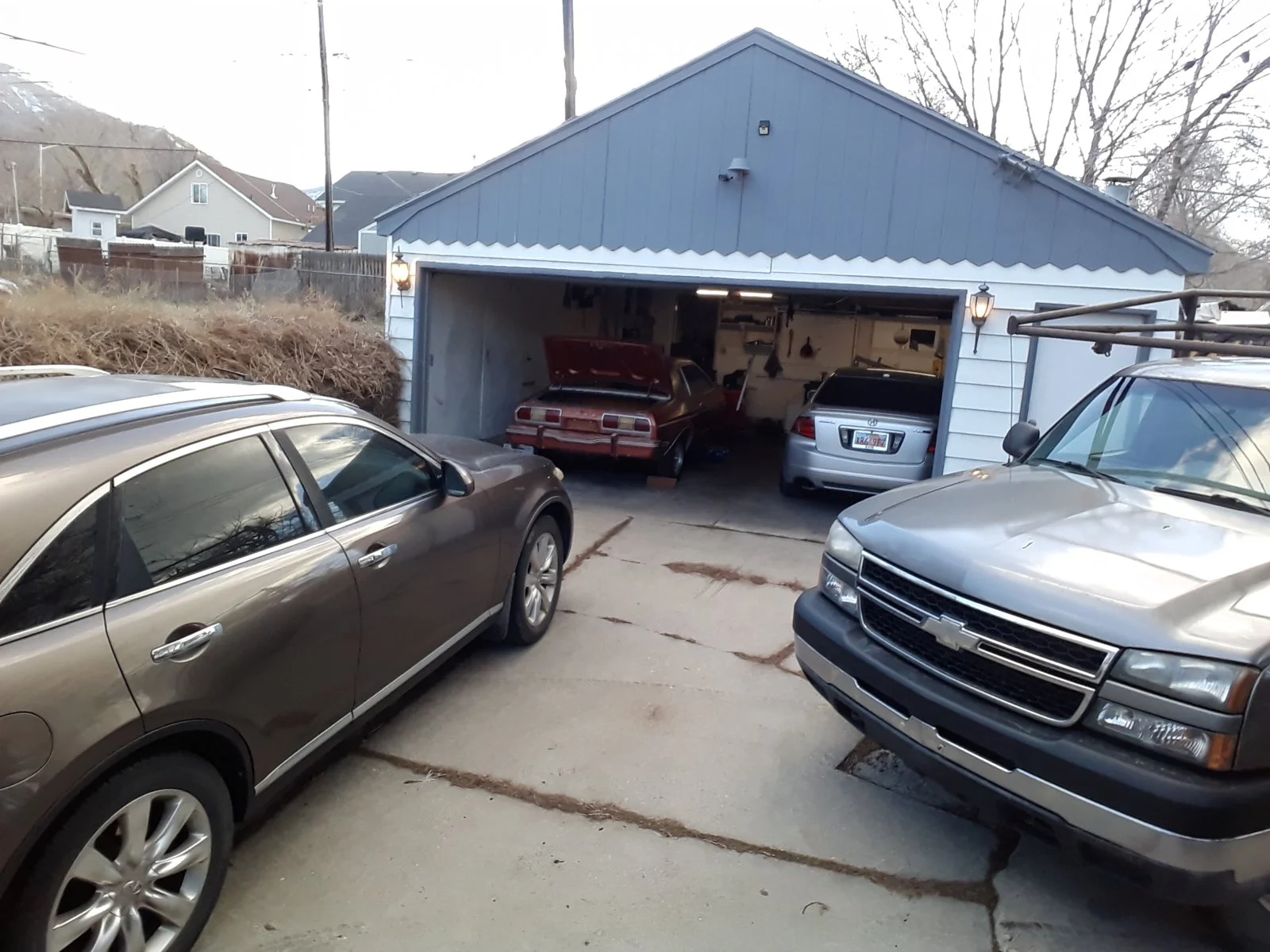

I got the truck here, got a way good deal and gave me enough spare in the budget for a pipe and tube roller and sone other ods and ends, gonna try to make a tube frame front end thats easier to remove and use the pipe rack the truck came with for the material. Lot of work but budget friendly. Read the thread recomended by 74stang2togo and it looks like i have the right idea with a front sump oil pan. Shame he didnt post a pick with the fit up of it on the cross member.

Small update, took out the k member going to order a gto oil pan and make a new k member to fit it. Looked up the canton front mount oil pan and they wanted an arm and a leg for everything though it would be nice to have. They didn't weld on -an fittings and instead sell a separate block that's tapped for an-12... F-n capitalists . Talked with a buddy of mine who said I stumbled upon a gold mine with the Silverado. Will take some time but I can part out a few things and make my money back and then some got started on making a new front end but only have 2 soft bends in it so far that pipe is freaking strong lol.finished cleaning up the bay and as soon as the gto oil pan comes in I'll pull the truck motor.

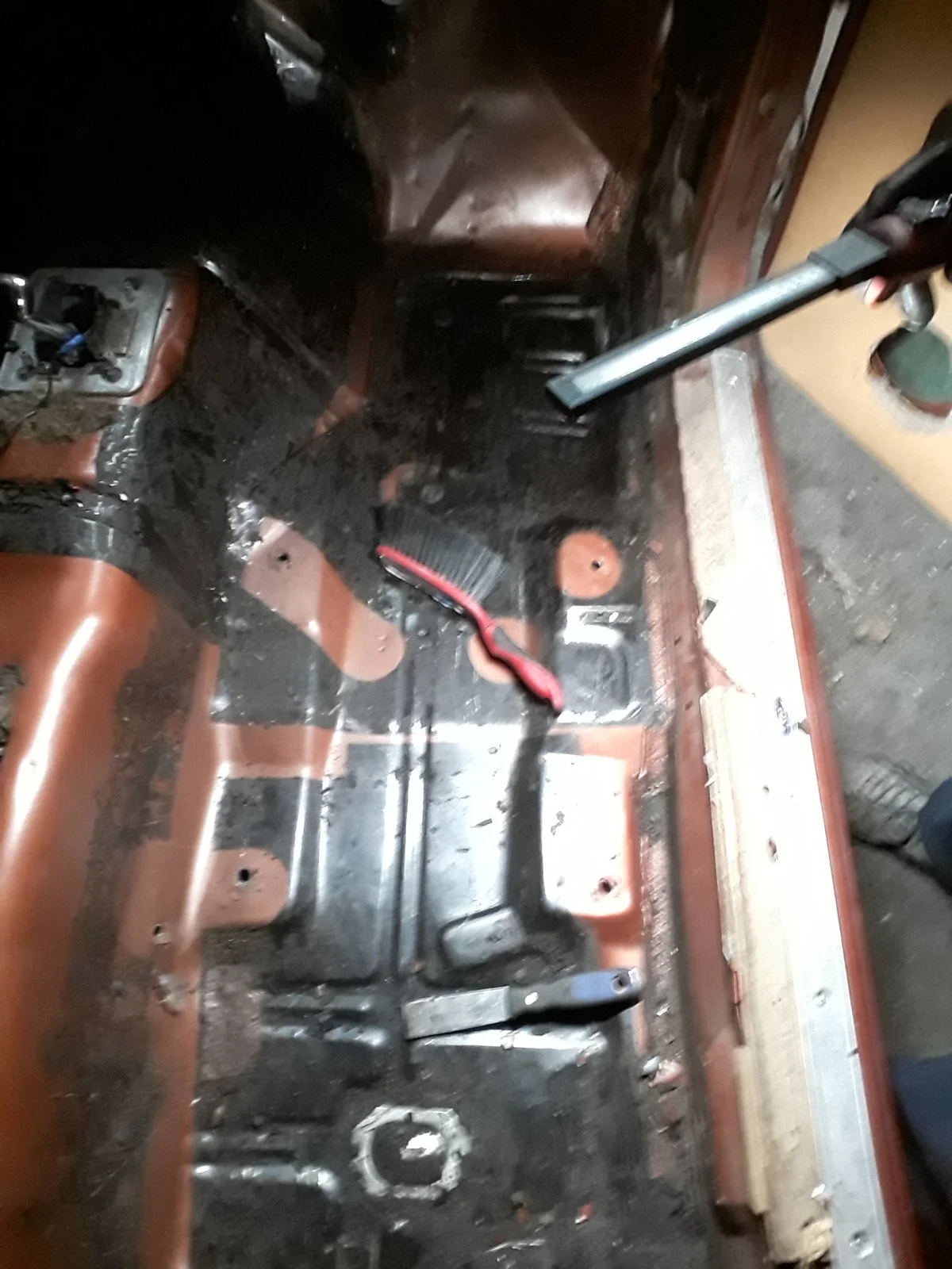

Got all the carpet out and now im scraping away the sound deadening. Got about 25 lb out of the passenger side so far. Feeling how flemsy the sheet metal is in places i may do some reinforcing.

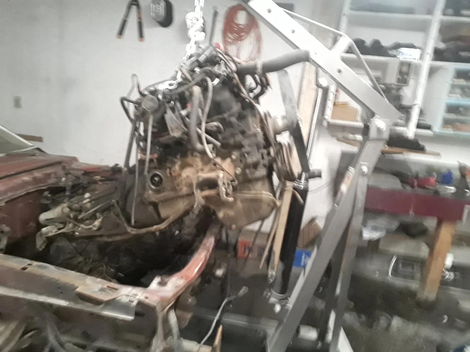

Working on getting the motor ready to take out this weekend, oil pan shows up monday.
