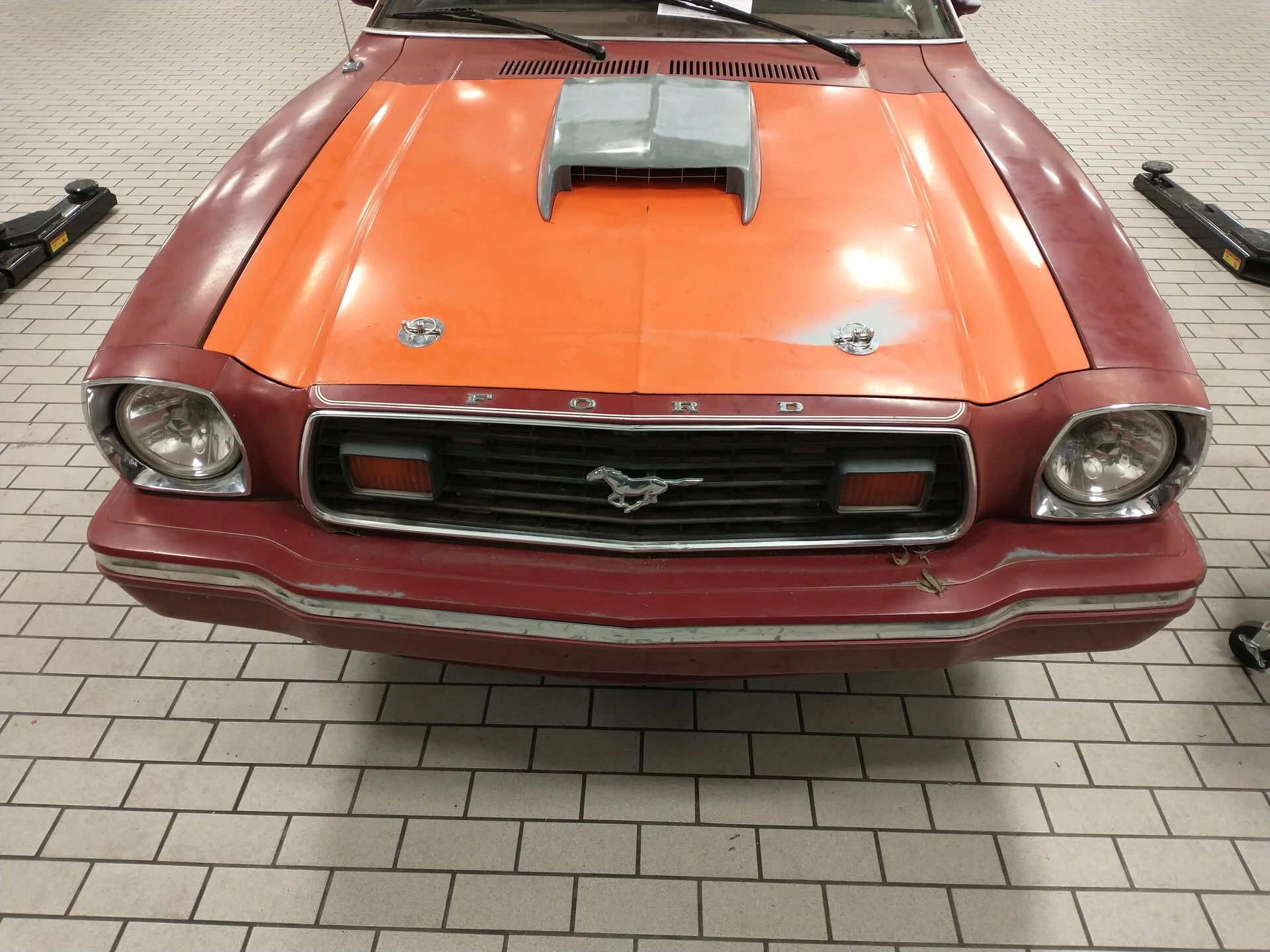

LILCBRA said:
I didn't necessarily mean today....
And, out of curiosity, are the holes there for the stock turn signals? I never did anything with mine but thought it'd be kinda cool to utilize them. I also had the metal housings when I got the scoop, so I had that option.
https://www.cjponyparts.com/hood-scoop-fiberglass-bolt-on-with-turn-signal-lights-mach-1-1969-1970/p/HDSC2/
Yup, it's got the holes and lenses. I'm playing with the idea of some LEDs. The scoop came with what seems like an aluminum grille, the turn signal lenses, and a stiff rubber flap that can be used to keep it mostly non-functioning or be removed to make it fully functional. I haven't decided which way I'm going in that regard yet. The scoop will be coming back off so that I can enlarge the hole directly below the rear center stud so I can install the nut and draw it down (it sticks up a tiny bit in the rear), and I'll be painting the area under it (and the inside of the scoop) matte black before laying down a bead of urethane to seal it to the hood.

As the newspaper people say, "Matt got the Scoop!"

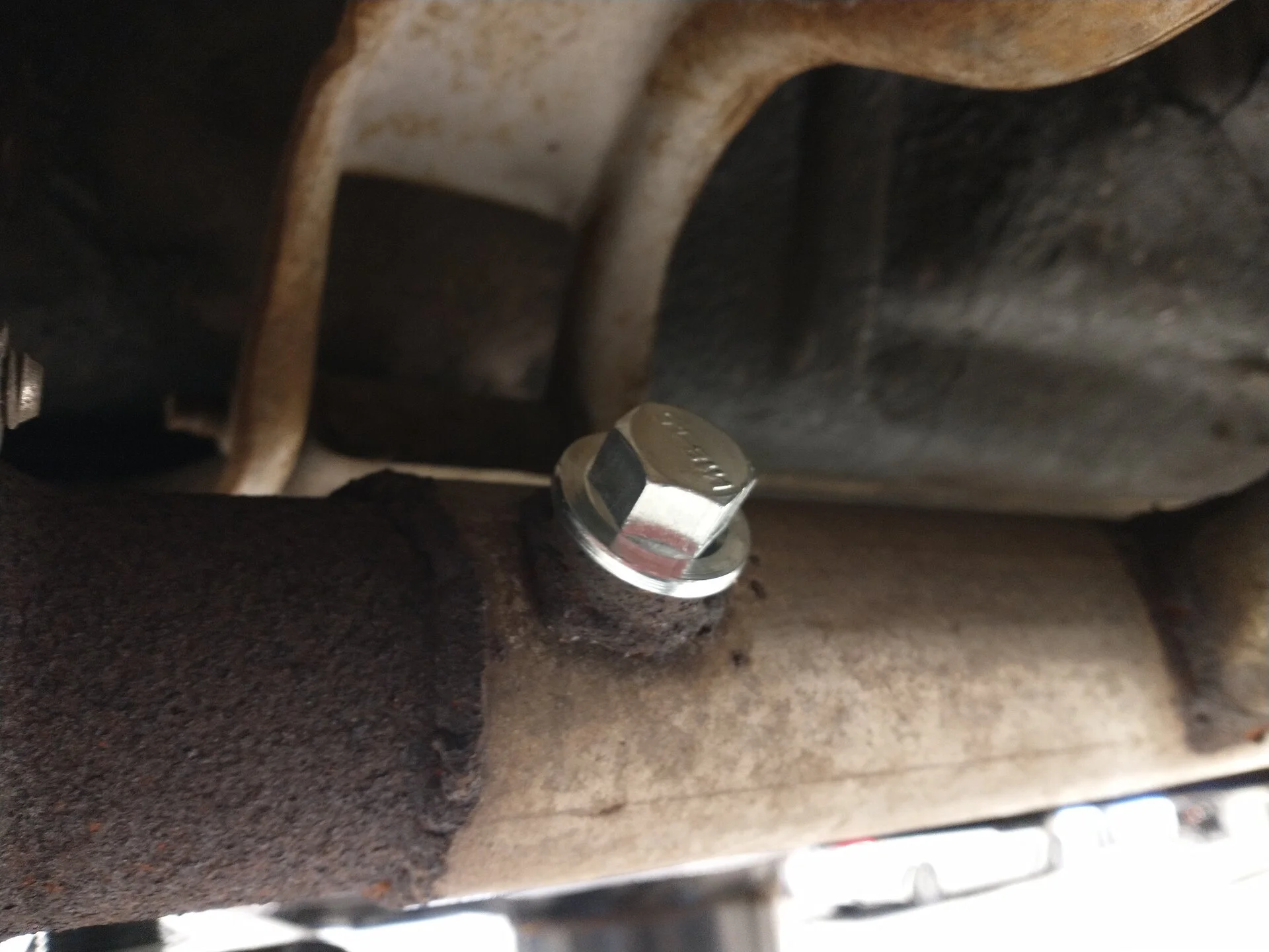

Hey, where did that rust hole go? I swear it was right here???

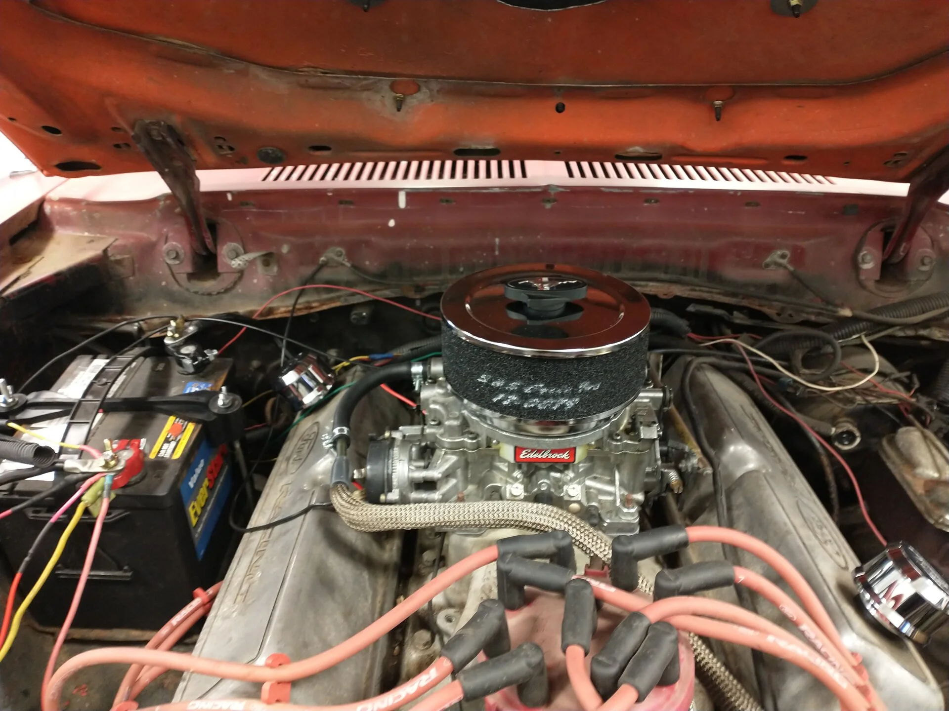

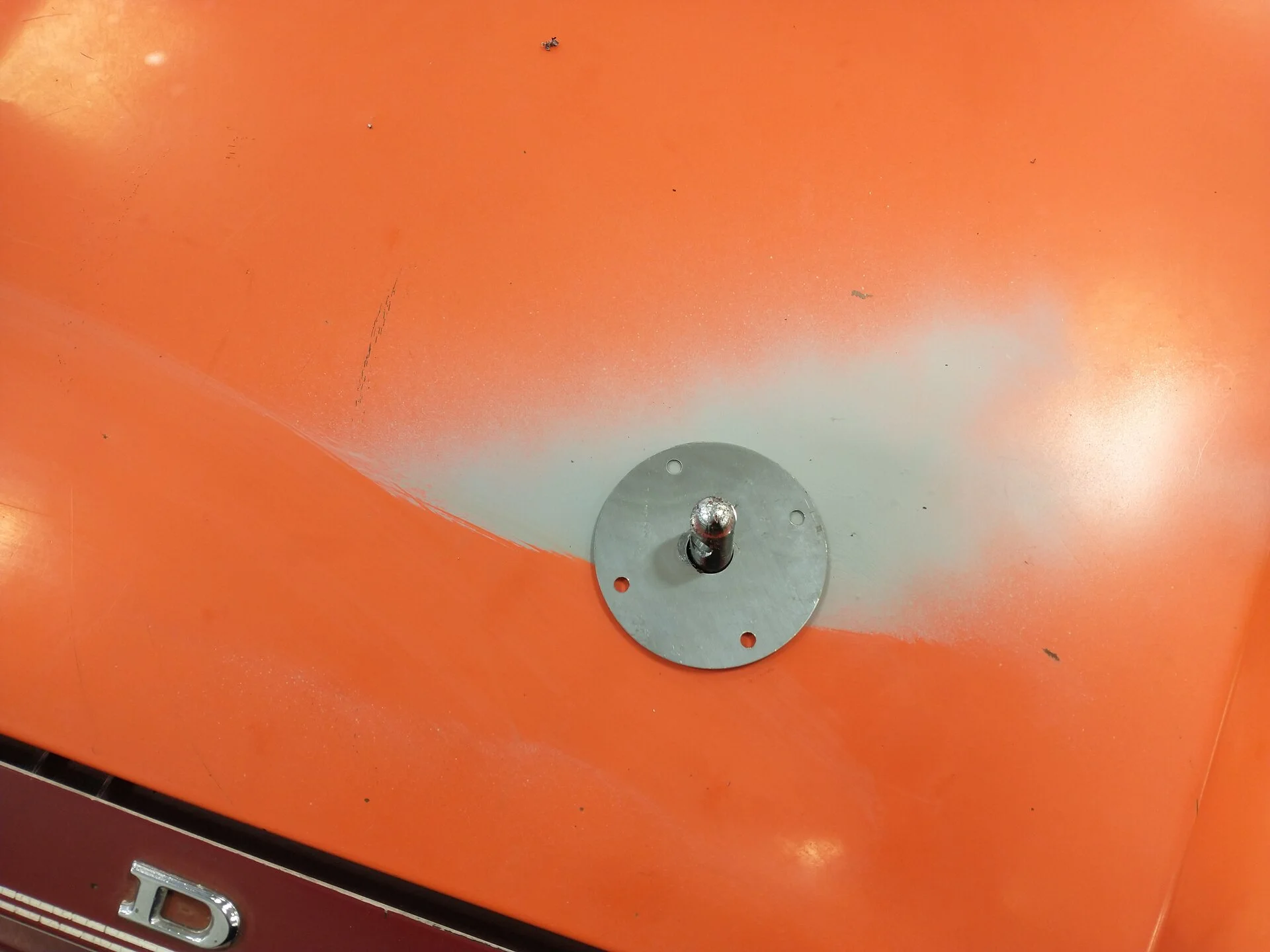

I've already driven further this year than last year, and we're only in February.
In the last two weeks I've installed new front shocks, ditched the Atomic and re-installed the Edelbrock carb (along with a new fuel pump, fuel line, and air cleaner) put a hood scoop and hood pins on it, ditched the fender-mounted solenoid, installed a temperature switch for the fan, and burned at least two gallons of gas.
All that remains of MSD's god-awful EFI system is that O2 sensor bung right there. Today I discovered that the engine runs a tiny bit rich with the S&S air filter... or that it's sucking the oil out of the foam. Either way, I'm getting a little puff of smoke off-idle when revving in park or neutral. I was advised by a co-worker to run a foam filter to cut down on any water getting into the carb through the scoop, but I may switch back to the paper filter anyway.

Looks like it's ready to install an A/F gauge.

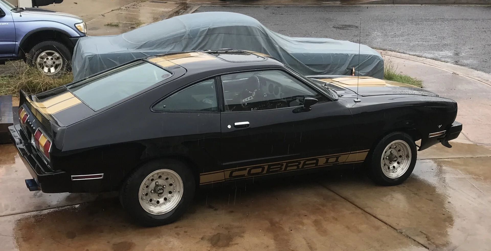

Thats a fine collection of Members CobraII’s, MustangII's, and i love the convertible.
All Very Nice!
This is mine, Fix it, now if we could just blot out the Toyota and weeds to enjoy the ' study in '65 and '77 aesthetics while raining.'
Toyota you say? More pics of said Toyota...

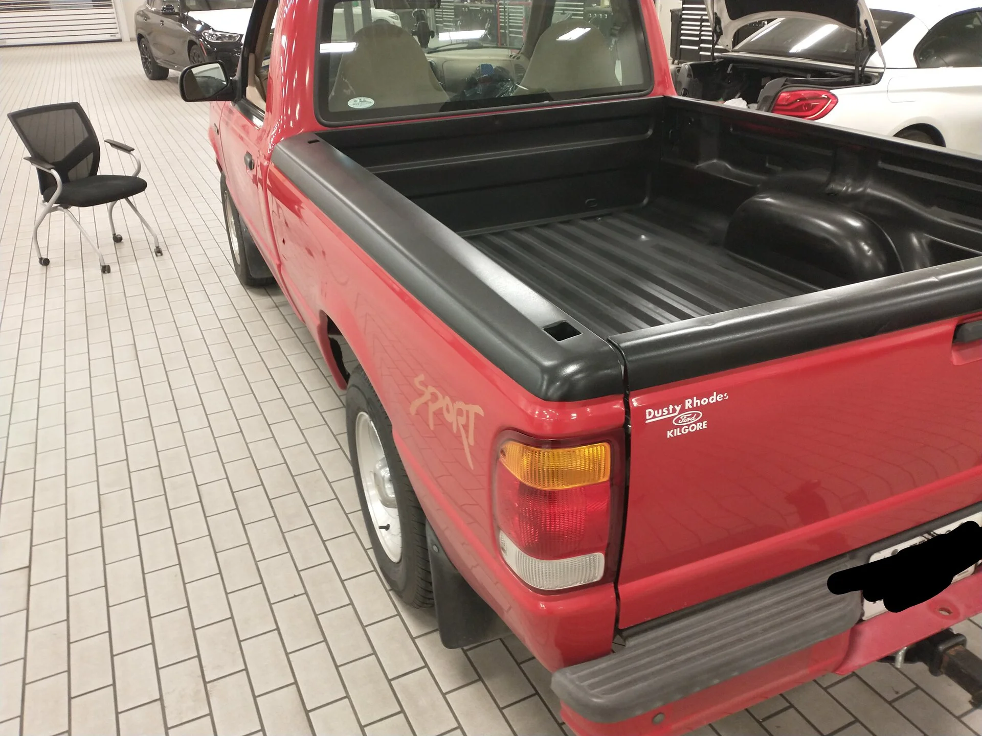

The Mustang moved outside for the last several days to make room for actual BMW work. That didn't stop me from spraying the bedliner I've been promising the girlfriend for the Ranger on Friday night.
