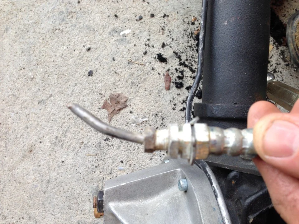

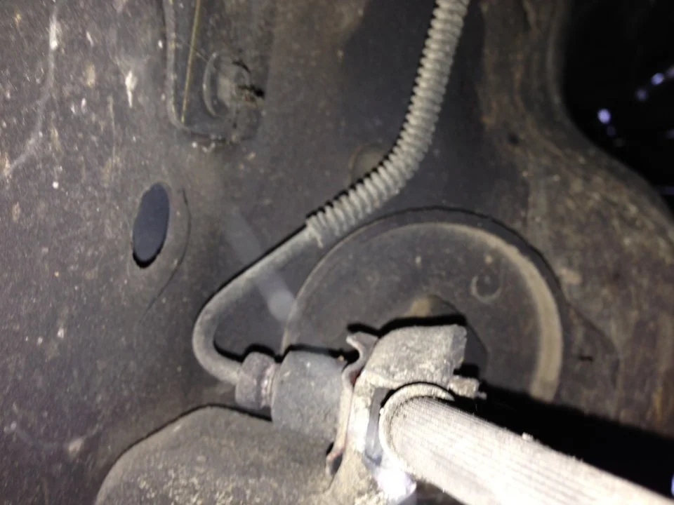

I have a built to rearend with fox length axels I flipped the brackets now I need to know what adapter fitting I could use for tc soft line
