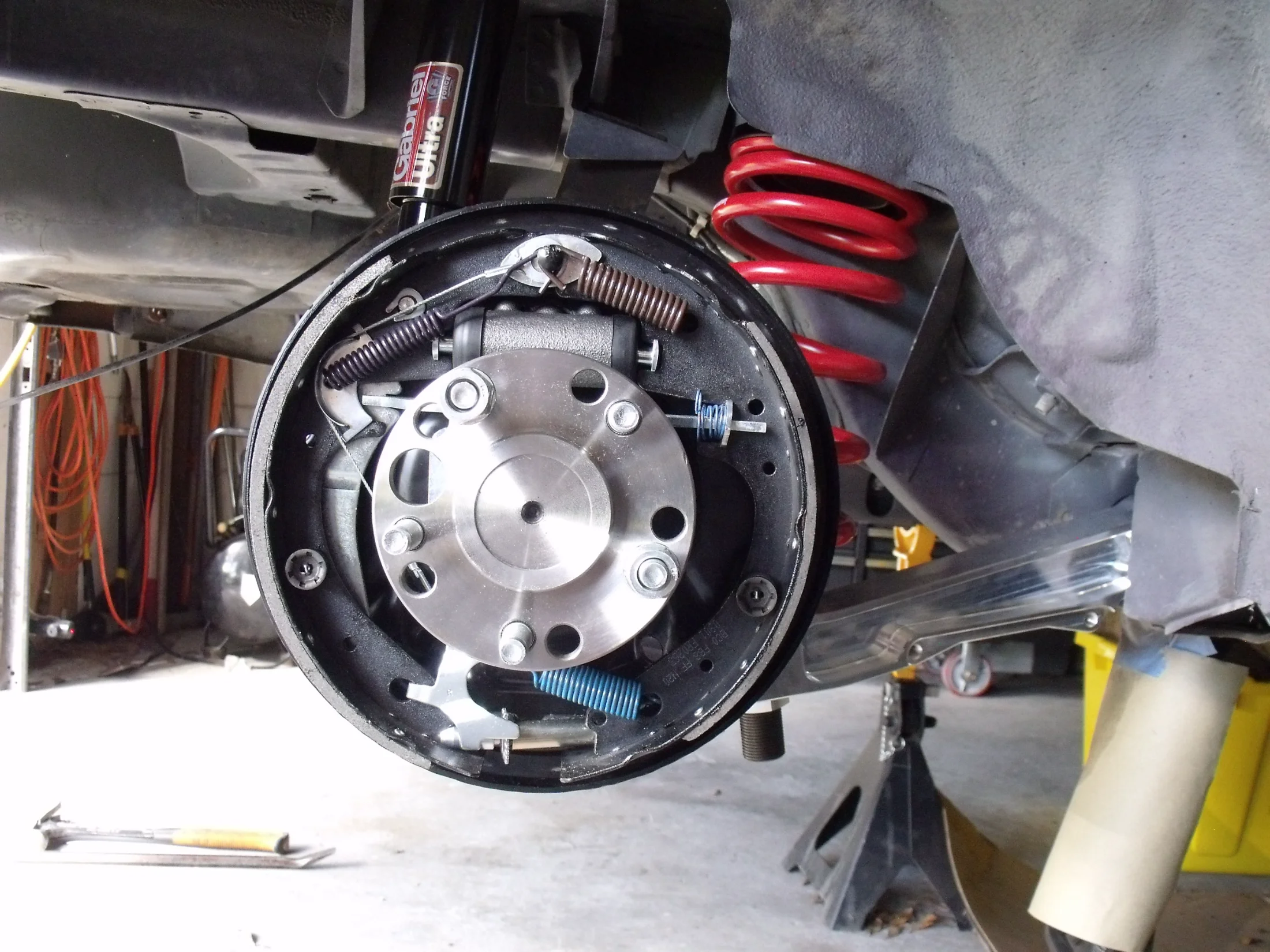

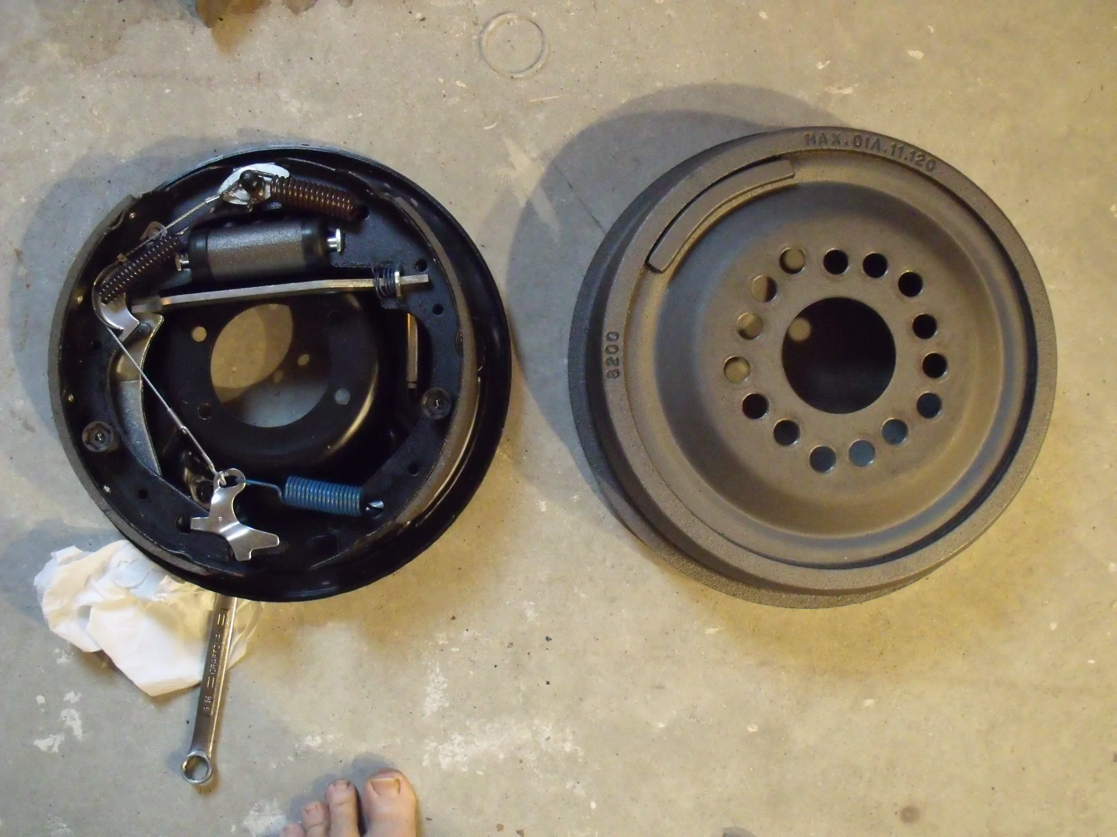

The emergency brake was one reason I kept my rear brakes drum..... Pulled out the E brake cable from the old housing and backing plates and it plugged right into my new 11" drums on my 9 inch .... I was pretty surprised at how well it went.... Works just like it was from the factory...

I am trying to figure out the correct part number when upgrading to the "big bore" 15/16" wheel cylinders on a stock fox body. What I have so far is Wagner part number WC 34876, but everything online is suggesting that these are 13/16" in size.
Can anyone please confirm or recommend the correct part number?
Thanks!
Mustang5L5
Mod Dude
Feb 18, 2001
43,298
18,003
224
Massachusetts
Jan 26, 2025
#439
  • Jan 26, 2025
  • #439
Thanks!
‘89 Ford Bronco had the 15/16” wheel cylinders.
Thing is I don’t know the compatibility with the Mustang drum brake. Given they are $10 each on Rockauto, might be worth buying one to test out.
Oct 28, 2001
6,092
4,186
183
Claremore, OK
Jan 26, 2025
#440
  • Jan 26, 2025
  • #440
Do the 9” and 8.8 cylinders interchange? I know Maximum Motorsports has large bore cylinders but they give no data on them other than what setups to run them in.
Big-bore rear wheel cylinders, 1979-1993 Mustang with 9" drum brakes (pair)
For $80 a pair I would just start looking at cylinders at the pars store until I found what I needed.
Reactions: General karthief
